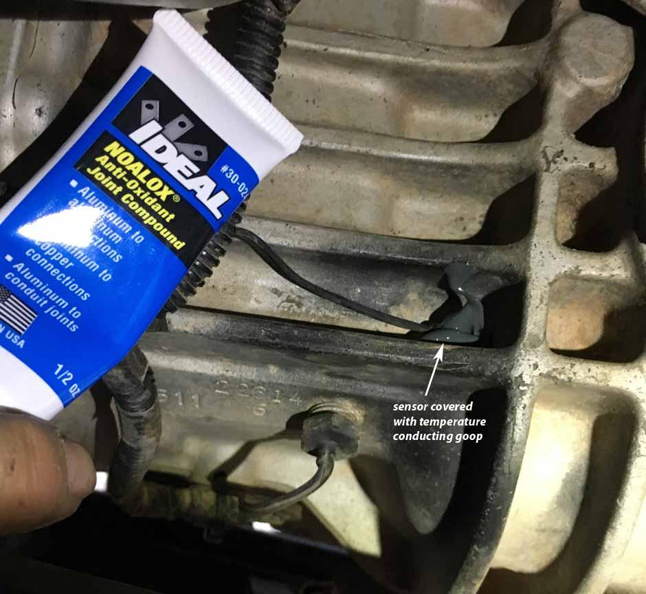

I have a temperature gauge on my trans, drilled/tapped into the case, with a sensor in the gear oil.
Making the assumption that my temperature reads 'correct' I compared this $14.99 solution with the sensor
applied to the external surface of the transaxle and found that with simple contact under foam insulation,
The difference in temperature with simple 'contact' was 12°F at temps around 140°F on a 50°F day.
So if the in-oil temperature read 140°F the surface-mounted sensor detected 128°F
There are heat-conducting compounds that you can buy, but being the cheap bastard that I am,
and just doing this as a Public Service Announcement for you thankless Samba fellers,
I was only willing to spend $3 at HomeDepot.
So I used Noalox, which is an electrical conduction enhancer, as a thermal conductive paste.
If I was willing to drop $4 I would have chosen Ox-Gard which LISTS thermal conductivity on their website. Lowes sells Ox-Gard.
They both have powdered aluminum and zinc in a paste.
Using Noalox paste reduced the discrepancy from 12°F to 6°F at appx 140F.
There are other heat-transfer compounds you can buy for computer heat-sinks, for those who hot-rod gaming computers. Some cost $20 for the size of a pea and others, not much more than the $3 solution.
But I neede one from a hardware store enroute to the campground.
It's very easy in the settings, to 'bump up' the temperature reading by 6 points to make it "correct at 140°F."
Someday soon (I hope) I'll get you the delta to be "correct at 160°F" but that has to wait until I climb a mountain pass.
The goal is to approximate internal oil temperature at highway speeds, correcting for 'outside cooling airflow'. I don't know how to get this 'correction' otherwise.

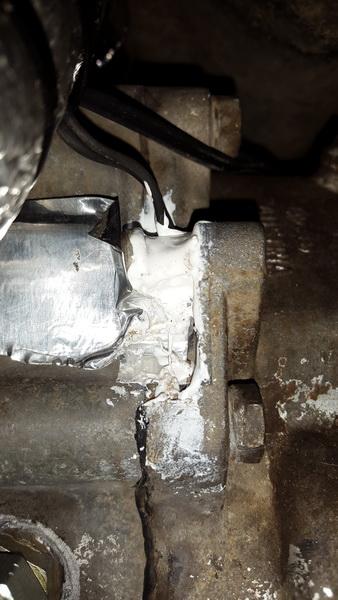

Here's the parts for the sensor mounting
A peice of packing foam, and a bent peice of aluminum to hold the foam on.
I set the sensor in a cavity on the trans
Then goobered it with Noalox paste
then packed foam into the cavity
Than jammed the bent aluminum peice onto an adjacent rib to hold the foam in.
The sensor is liberably goobered with Noalox and placed in the cavity then the foam peice is packed into the cavity.
The bent peice of aluminum holds the foam tight in the cavity.
This precision aluminum unit just grips the rib and holds the foam in.
There are many other ways this can be done.
You could shape a little cover that is epoxied over the insulation.
Clamp it on until the epoxy hardens.
Possibly you could simply pot the sensor into the hole with epoxy.
But the "6 degrees" calibration number that matches my gauge is with Noalox and insulation.

I used computer CPU Thermal Lake epoxy on mine 4yrs. ago and still holding strong on the side of the case as close to Fourth Gear as I could get it.
It triggers the cooling Fan and Pump as suggested by SODO way back when he first started do the gearbox cooling mods.
That's another good way.
I forgot about that stuff.
I wonder that the difference would be between oil temp and case temp.
I suppose you could insulate outside the epoxy too.
