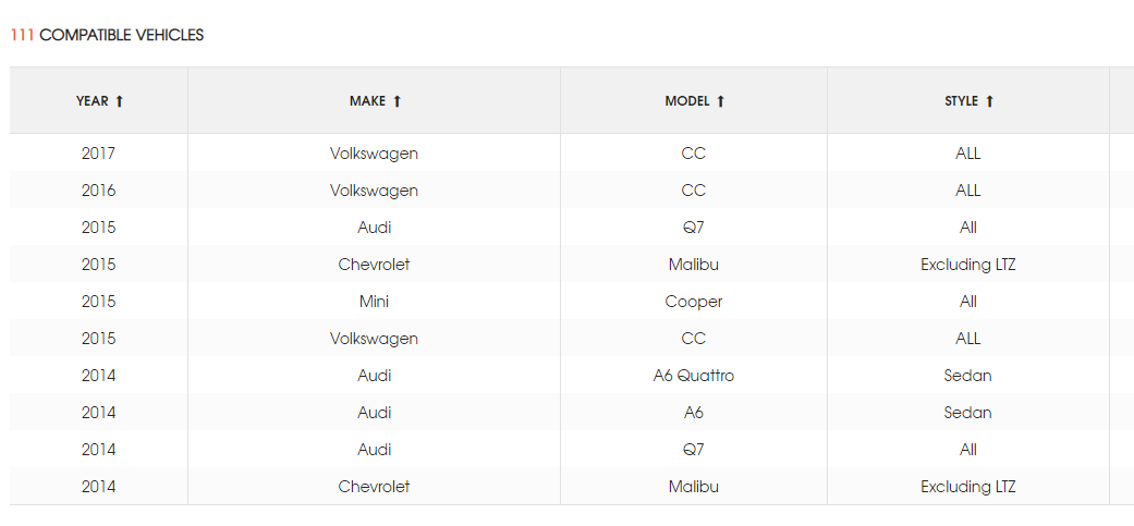

Yesterday I was able to sleuth out the following Curt models that are alleged to work with the Vanagon
Curt: C59236 (confirmed by @jimf909 and their Amazon link above)
C56175 (non powered)
and a Hopkins model HM48925
This was clipped from the Curt site indicating the models that fit the C59236. If you ask your parts store for a kit to fit these vehicles it may be easier than explaining that Yes, Volkswagen made a van "back then" and yes the motor is in the rear ...........
I built a basic hitch yesterday and was pretty happy with the result.
