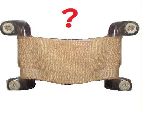

Hello.
I am restoring 55 Barn Panel and 54 DX now.
I am interested in cargo door strap.
My 54 DX has a wrong strap.
I intend to repair it.
(front side)
(rear side)
I look at the photos, Vintage photos in forum.
Most of DX have a strap in rear cargo door.
But, in the parts list, the strap of DX is one.
What do you think?

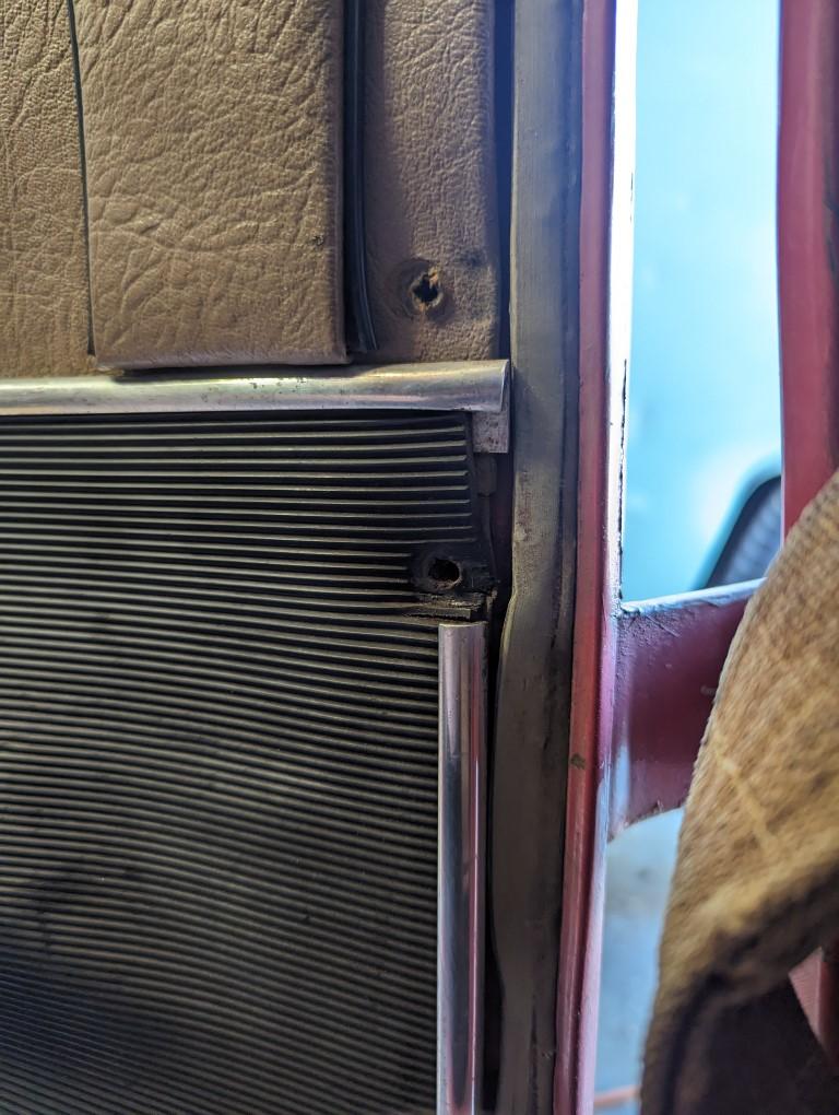

There is a hole (nut) attaching strap cleat to rear Cargo door.
There is a similar hall on the body side.
55Panel & 54DX has a hole.
By any chance.....
As for the rear door, does the strap attach strap cleat to the Body side?
Do you know it?

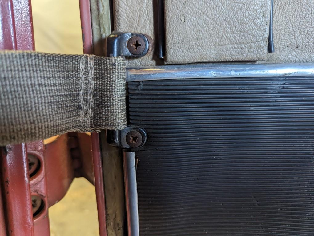

PostPosted: Tue Sep 19, 2023 12:48 pm    Post subject: Re: rear cargo door strap for dx Reply with quote
Yes, the Parts Manual is confusing here.
It only seems to list the forward/lhs strap, and not the rear/rhs strap.
The forward/lhs starap only has one [90] shackle (cleat), as the other end of the strap is held by a pin [91]
Cleat secured by 2 screws [89]
The rear/rhs strap has two cleats.
4 screws
The screws are M5 raised-head countersunk machine screws
I’ve assumed they are slotted…not philips…they *may* have originally been philips

PostPosted: Wed Sep 20, 2023 1:40 am    Post subject: Re: rear cargo door strap for dx Reply with quote
Yes, my deluxe
I’ve had to recreate the strap detail here, so don’t assume it’s all original
Straps were black I believe…but this dye fades to beige
I read that deluxe cleats are slightly taller…so I used taller cleats (16mm when you sit them on a table)
Repop straps are sold with two cleats, btw
-StockRocks-

PostPosted: Thu Sep 21, 2023 5:06 pm    Post subject: Re: rear cargo door strap for dx Reply with quote
The taller one above is to help clear the deluxe exterior aluminum body trim when the door is fully open. I've pulled three of these off of original 55,56 rusty deluxe buses
Your panel should be black in color

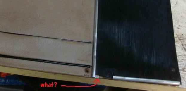

PostPosted: Fri Sep 22, 2023 1:48 am    Post subject: Re: rear cargo door strap for dx Reply with quote
The VW factory should have cut this partial trim.
Then, it was not necessary to prepare Cleat for DX into the VW factory.
My door card does not have the aluminium trim.
......... d'oh! Shall I repair the door card? To OG design.
Then I must look for the cleat for DX. Wink

What is this? Shocked I was thinking about this.
The aluminum trim is this shape.I see, understand. Very Happy

PostPosted: Sat Sep 23, 2023 12:48 am    Post subject: Re: rear cargo door strap for dx Reply with quote
Small details, but WW strap is probably longer (check), and has the seems sewn in different places
But will work ok
Cleats may be the low version
Looks like that strap comes with only one cleat
Trim is your version b
Allows the ribbed mat to slide under

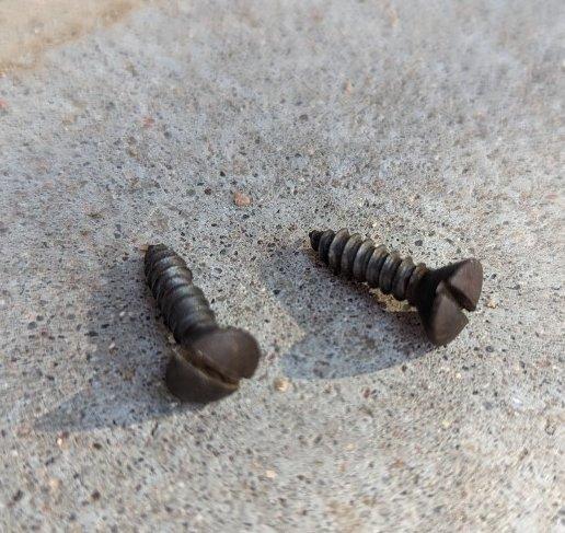

Just to add to this, I coincidentally just came across 2 straps while looking for something else a few days ago. I dont exactly recall what bus they came from unfortunately.
I also have 4 cleats, 3 tall 1 short.
The straps definitely at one time were black, now faded on the outsides. One is longer than the other. judging by the condition, look like they may have come off the same bus. anybodys guess though.
Also because Ive been a real hardware nerd during my bus restoration, got curious on the screws. I looked in the parts book and they are a philips head countersunk M5x10 ( start pickin Chris Laughing ). Same screws used for the optional rear hatch/truck decklid latch mechanism as well as all the screws holding the locking mechanism onto the header bow of the sunroof.
The screws in the photo, both left are new JIS (A secret of mine, found that a lot of JIS hardware is very close if not exact to original german stuff) , rights are original replated.

PostPosted: Sat Sep 23, 2023 3:31 pm    Post subject: Re: rear cargo door strap for dx Reply with quote
Good work on the Philips screws
Would like to see where they are mentioned in the parts book
Thinking the cleat on the rhs here doesn’t need to be the tall version. No trim to clear.
I wonder if it was tall, or short?

PostPosted: Sun Sep 24, 2023 5:12 pm    Post subject: Re: rear cargo door strap for dx Reply with quote
ISP selling a strap set now. On ebay.
https://www.ebay.co.uk/itm/403185138923?mkevt=1&am...;recoPos=1
Tall Cleat two. One short.
Two pieces of straps. (long & Short ?)
Six screws.
Is it right? Question
WW, ISP, CIP1,C&C ... etc. Tall cleat? For versatility.
right? Question
Through Mid 1958:slotted screw.
Mid 1958 through 1967:Philips screws.
ISP says.

PostPosted: Wed Sep 27, 2023 7:16 am    Post subject: Re: rear cargo door strap for dx Reply with quote
Six screws.
At a quick glance, this ISP kit looks decent to me
Yes, I understand the pin strap is shorter
Screws, I’ll trust MR over ISP 🙂
Would be nice to have some photographic back-up/evidence from an original bus…
-StockRocks-

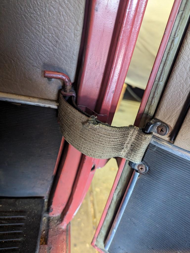

PostPosted: Wed Sep 27, 2023 4:20 pm    Post subject: Re: rear cargo door strap for dx Reply with quote
Here's my '55 Deluxe
Front strap (probably original screws and everything:
Rear strap cargo door side:
The body side of the rear cargo door 100% has the wrong screws (No photo)
Screws from the rear cargo door shown directly above:
These are probably from a later Bus as they are the same as my '63 15-Window
