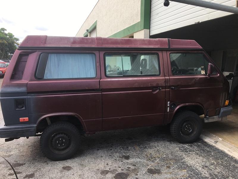

Two weeks ago I flew with my buddy to Denver. We rented a car and drove out to his newly purchased Westy in Steamboat Springs, CO. After having extensively camped in my Syncro for the last few years, I immediately saw how good a Westy is. My camper set up is fairly crude. So I asked Dobryan about where he sourced his cabinets and I started looking into swivel sweats and pop tops,.... Yeah I was looking at an easy 10k. Dave mentioned that Valley Westy had a Westy and maybe the better solution would be to swap the Syncro drivetrain on it. Which, even when I bought my Syncro I had kind of expected on doing that since it was basically a parts van. At this point I have put a crazy amount of effort into it and it's not a parts van. But it's still the van I learned to weld on. Body work is an art and I still haven't put in the hours, it's a good 30 footer.
So I went to go look at it, cash in pocket, and walked away with another project. Smile Keith at Valley Westy is a great guy, super personable, awesome to chat with. If you're in the Staunton, VA area or passing through, he certainly knows his stuff.
So here's the classic, "ran when parked," project.
It has a little bit of damage in a few places and a few rusty seams. Above the passenger headlight.
And behind the kitchen cabinets is the worst of it.
Overall, fairly clean exterior.
The interior is another matter. Everything I've found points to this van sitting for about the last 20 years. It is covered in mold. I found one mouse nest in the pop top, although thankfully they didn't chew the sleeping mats. Looks like they pulled the insulation from behind the kitchen cabinet or maybe from an external source.
This seat will never go back in, lol.
So loaded it up and hit the road back home to DC.
Back home, I pulled as much crap out as I could. Raised the pop top. Opened all the cabinets. Turned the garage fans on. Air out as much as possible.
Please excuse the bike getting in the middle of the shot.
Found a pair of CV boots, W Germany stamped. Rubber feels new.
Found in the fridge, seeds, maybe I'll plant them and see what happens.
The window sticker, which is cool.
The passenger crank was broken, but in the glove box was a replacement from GoWesty. First thing fixed on the first night!
And it's cleaned out! Now to start cleaning
I always thought the 2.1 engine bays where a ridiculously bad and confusing layout. The 1.9 is worse. What scatterbrained engineer thought this was a good layout? I checked before I bought and the AC schrader valve didn't seem to do anything, but I checked again when I got home and the AC system has pressure. Hilarious. And the computer is just in the engine bay? Exposed to everything? That is just dumb.
Syncro peaking in
So the current plan is clean as much as possible so I don't get mold incurred respiratory issues while I work on it. Get it running if possible. Then decide what to do. I'd rather not scrap my Syncro to make a Syncro Westy, but if that's the only way then maybe. If I can build a new steering rack mount for the Westy, then maybe I can leave the one on the Syncro. I don't know too much yet. But it's a bridge to cross for the future. Interested in everyone's thoughts of course.
