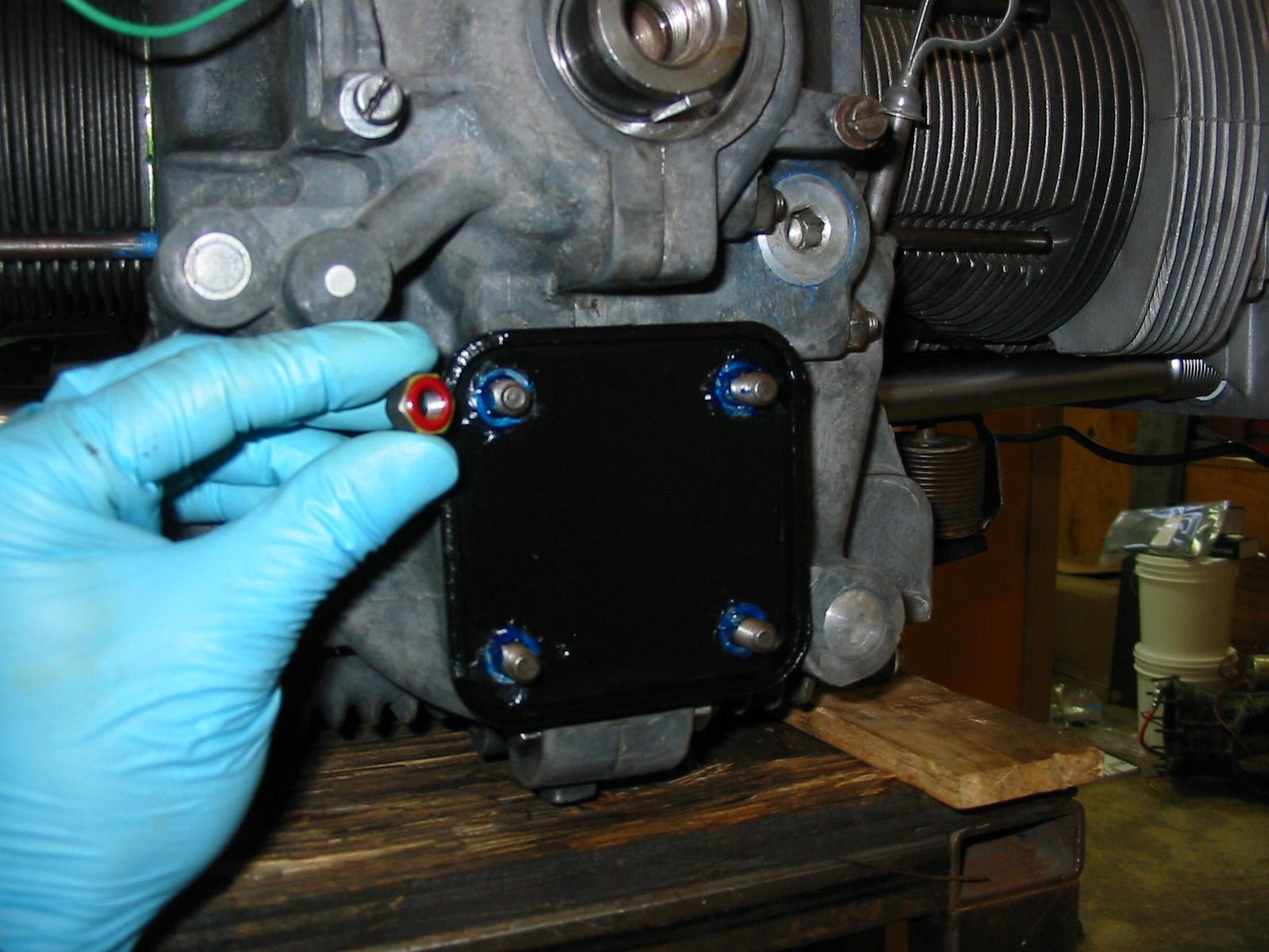

As of today, the oil pump cover or somewhere near it is leaking again, and the engine dies when coming back to idle from open throttle. I'm not really sure what else to do about that oil pump. I want to JB weld it and its cover to the case...
There is a small possibility that the leak is actually coming from one of the oil gallery plugs - I saw dampness there, though maybe not as much as I might expect if it were the sole source. I'll have to take the rear tin and the pulley off, yet again, to be sure.
Before you do anything drastic, get a tube of Hylomar. It is unbelievable. It is, or at least at one time, used by Rolls-Royce, Porsche, VW, and many others as a sealant. It's expensive, but worth it. I got mine on ebay, but you can get it from others. Fantastic stuff!

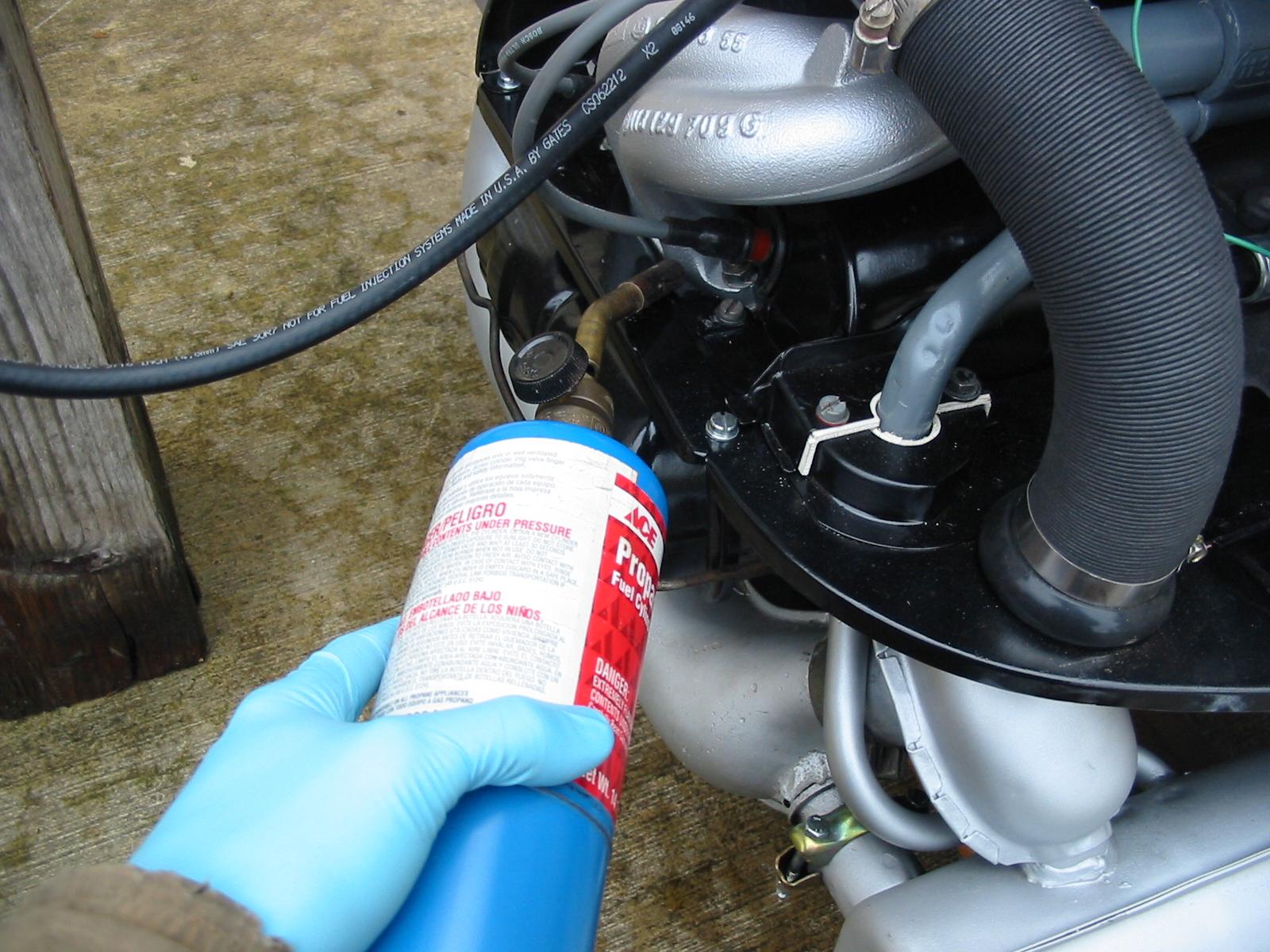

I did some more test running this afternoon, having decided to get a handle on the running issues before going after the oil leaks. I'm glad I did, because others appeared or were identified - suspicious darkness that slowly developed under the fuel pump pedestal was indeed a very slow oil leak. There's a nice one around the oil pressure sender as well.
Today I couldn't get it to die coming off throttle as it had been doing before. The idle dipped as low as 750 RPM when coming down from 4000 RPM, but it didn't quite die. Because of the temperature outside (7 C / 44 F) I ran it with the preheat tube flap held open, and I think that made the difference. The last time I had frost on the intake manifold, and this time it started to form but then disappeared.
I did another leak check with propane, this time blowing it at the bases of the intake end castings. I also tried everywhere around the carburettor. I could hear no effect on the speed of the engine. That means no leaks, hopefully.

As for the oil leaks, the big one from the oil pump happened because it blew the small bead of RTV right out of the crack. When I took the pump out I found it sitting on top with some Curil squeeze-out.
I replaced the stud that came out and held it in place with red Loctite.
I cleaned the surface and placed another bead of Dirko, this time leaving it slightly proud of the surface. The last time it was flat or even slightly undercut. I expect that without pressure from the cover holding it in place, its own adhesive ability isn't up to the job.

When the RTV on the oil pump was cured, I reinstalled the oil pump with a generous helping of Hylomar, and with new sealing nuts. Torque was 20 Nm.

With the engine warm, I first used an IR thermometer to see how hot the heads were running. I shot the exposed area indicated by the laser dot in the picture. I held the gun close and tried to get the dot right on the crack.
(Temperatures and pressures are given in the cylinder pattern
#3 #1
#4 #2)
For temperatures I got
93 C 97 C
97 C 100 C
Cylinder #2 is the hottest, more evidence of a lean condition. None of the temperatures seem to be dangerously high.
I shut the engine off and did a compression test. It took a few tries - I was timid about how far I screwed in the spark plug adapter, and that distance changed the readings significantly. I turned the engine over with the throttle and choke open, and kept turning it until the readings stabilised.
975 kPa 950 kPa
900 kPa 950 kPa
The Bentley says that all cylinders should be within 1.5 kg/cm2, or about 150 kPa, of each other, so these numbers are very good. Good compression should be 800-1000 kPa.
From this information I concluded that the short block is OK, and that the leanness had something to do with the ancillaries. It was at this point that I found the thread that I referred to in the previous post, and went looking for exhaust leaks again. I found the one on the heat riser tube, and believe it to be the source of the air leak - its location so close to the exhaust port makes it very suspicious. I removed the muffler and added more weld, lamely. It's very close quarters - I had to have 10-12 mm of MIG wire sticking out to reach the spot because the flanges fouled the MIG nozzle.
Now I have to wait for paint and RTV to cure. I may also check the exhaust flange for straightness.

To fix the oil leak, I took the sump plate off and resealed it, with Hylomar this time, and new gaskets.
