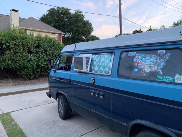

Thanks for the update. I have a 5000BTU air conditioner hanging out the window behind the driver’s seat. It runs on 450 watts. The generator is idling to power it and the noise is not so bad. I would not think twice about running it in a Wallmart parking lot all night long from 30 feet you can’t hear it. A state camp ground with other campers is a hole different store. I have no other AC in my van so I will run it going down the road you can’t hear it except at stop lights. The hole set up is a little Mad Max’s but it will have to do for now. I had to do something with the heat in Dallas getting in the mid 90’s most days. I will post pictures in a day or two. Not that I think others should follow my lead. Great to here you are happy with the zero breeze. John
Just curious, where are you mounting the generator as you're driving down the road?

Here we go. Try #1.
Generator on the roof. Just to big a pain to get it up and down from there, and start it and put gas in it.
Air conditioner between the seats blows cold air exactly where you want it when driving. Unfortunately it blocks my access from the front of the van to the back of the van which made me very unhappy, not to mention how ugly it was from the back. On top of that the portable air conditioner is a power pig taking about 9 amps to run and sometimes would overload the generator. With the air conditioner being the one hose design it blows hot air out but all of the air that gets blown out comes from inside the van no matter how long you ran it, it would never cool of the van because of the volume of the outside air being moved it.
Next move I mounted the generator on the rear bumper as the van is in Texas and most of my tools are in Massachusetts I had to accomplish this with minimal tools. I bought a winch mount from harbor freight and bolted it to my rear bumper (my rear bumper is re-inforced) but I can’t leave the generator out in the rain and would make it an easy theft item. The air conditioner between the seats would probably still be there but it died after 3 weeks.
Now I have 5000 BTU air conditioner hanging out my window. When parked this air conditioner despite being less BTU’s cools the whole van even when 100 degrees outside, but it still does not have enough power to cool the whole van going down the road but it gives me a nice cool blast of air on me. I also built a box around the generator. This air conditioner runs on less than 4 amps so the generator is at idle and is much quieter than when it was running the other air conditioner. If you really want air conditioning driving down the road this probably is not your answer. Also if you have the camper windows they don’t open wide enough to put the air conditioner in. So because I had one I changed the window to one out of the tin top so that the air conditioner would fit. I general I’m not a big fan of AC but in Texas you need it. I assume that come the end of august I will remove all of this and it will be out of the van until the middle of June when I will put it back in the van. John
The box is nice but you should put a light on that license plate.
Illuminated rear plates are generally required.
