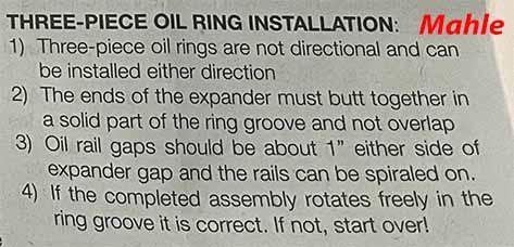

The Mahle oil rings look kinda wimpy, but the expander does the deed.
The piston has resistance with just a Mahle oil ring on.
Whereas the (used) Subaru oil ring had almost no resistance.

The tiny, and lazy oil ring is likely a bid to increase fleet fuel mileage by reducing friction losses.
The difference in resistance is significant.
The old Subaru oil ring feels like there's nothing there.
The new Mahle oil ring has a lot more resistance in the bore.
Clearly the Mahle is going to scrape oil better.
The Mahle oil ring is NOT staked and has a sheet of paper that says "NEW INFORMATION".
It looks like a generic sheet tending to lots of partnumbers.
Here's how the old oil ring inserts.
It seems real lazy.
I suspect it's the smokin' gun reason for the consumption.
The engine had great compression, 190+ and ran great too.
The upper Subaru oil ring is staked, the lower oil ring is not.
If I made a video of inserting the Mahle oil ring it would be much longer as it takes a lot more effort, and lots of fingernails etc.
I would guess that Mahle knows a bit about rings but perhaps Subaru does too.
I think Subaru knows something that doesn't work (2010 rings).

I inserted pistons into cylinders,,,,,, with oil-rings:
    Used Subaru (super easy piston movement) top oil ring keyed
    New Mahle (noticeably more ring-friction) not keyed
    New Hastings (~25% more ring-friction than Mahle) top oil ring keyed
So....... having been traumatized by oil-drinking.
And 11BC2's hard recommendation on Hastings....
I'm inclined to use the Hastings oil rings.
Where $60 on the Mahle rings was an "educational expense".

Repairing the valves is a given and was double what i expected (like everything in reality-numbers).
Going one step deeper and changing the oil-rings is valid too.
I waited a little for someone to tell me which Oil rings might be the best but nobody provided such, so I had to buy some and get my own info,
It cost $100 for two sets of new rings (cheap information!), and some time.
If I didn't try this, I'm positive you all would be disappointed in me.
======= back on topic =======
Current status is:
I'm just putting the Subaru (compression) rings back in, because they had good compression, were already bedded-in, and were within Subaru specs for re-use.
But I'm using the new Hastings oil rings (only the oil rings).
Putting the pistons back in today (I think).
I'm thinking that there is no "break-in ritual" required.
Hopefully ridding me of this ritual
