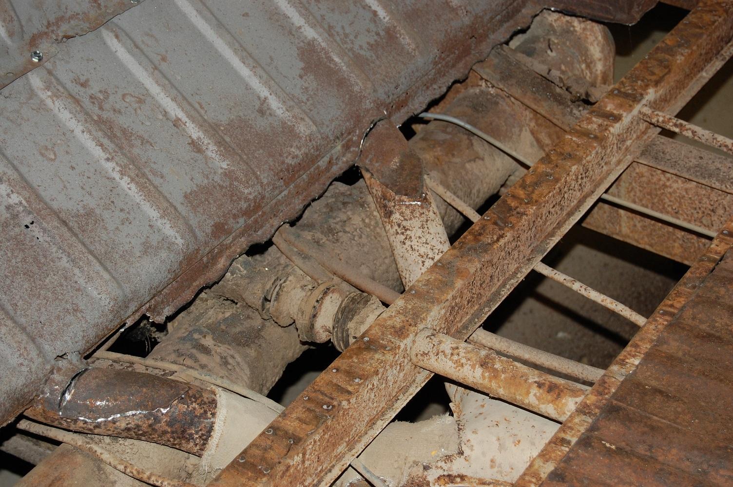

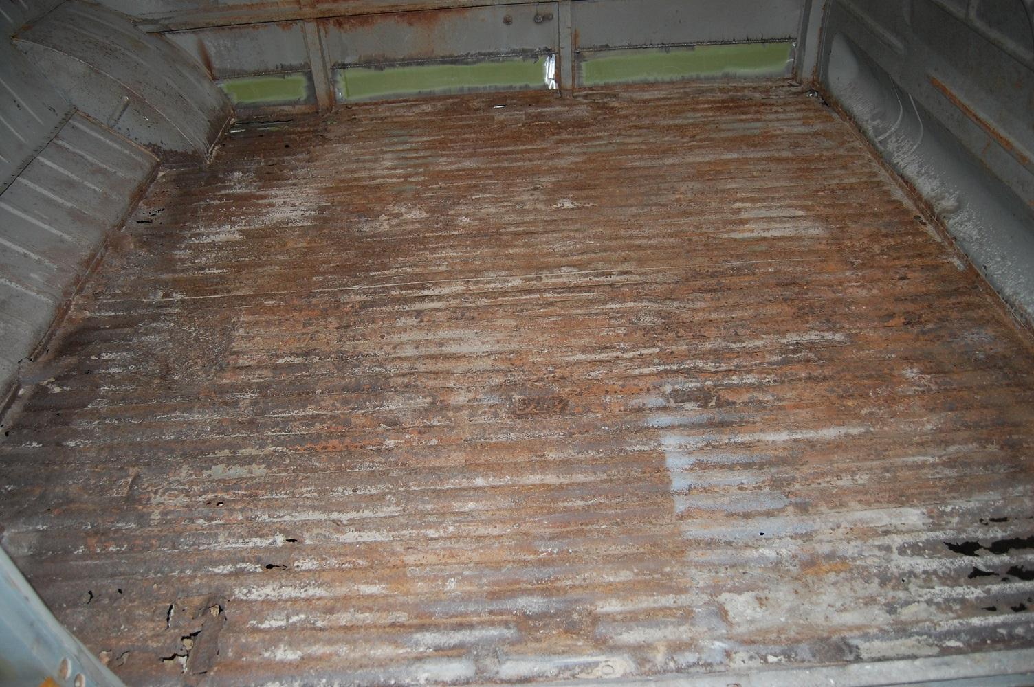

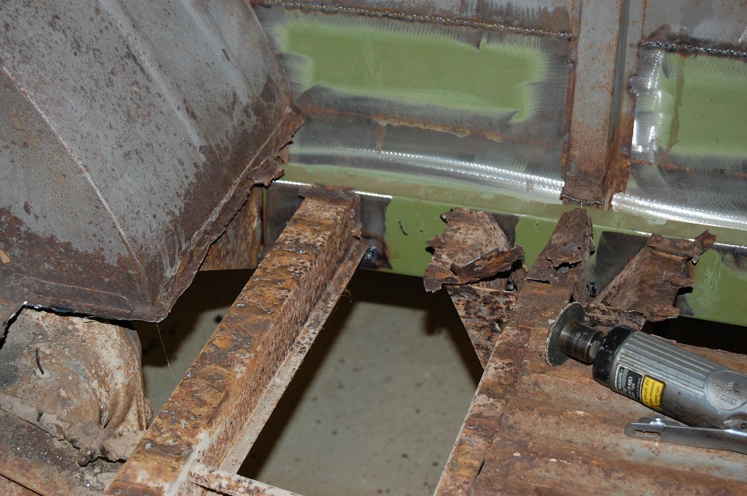

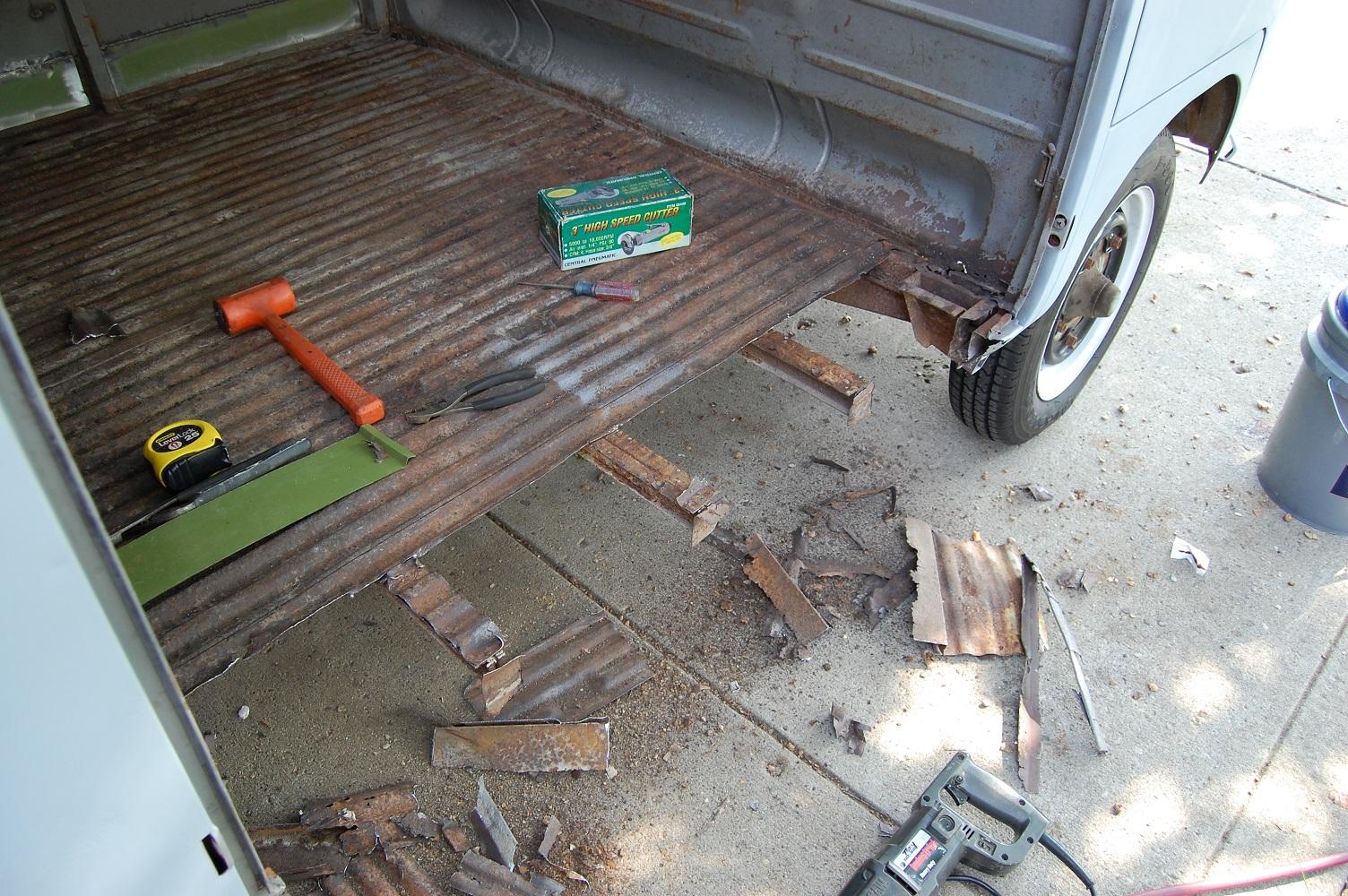

Greetings,
My 1960 panel has been in the garage less than five days and I've already started removing the rust and rot from the cargo floor. The previous owner had already replaced the long driver's side rocker and had not planned on doing much else with the floor. Most of the metal was solid, but the metal was thin in both front corners, all across the rear and (of course) along the cargo sill area. I really didn't see much sense in replacing the entire floor. It seems that it might be difficult to replace the rear section without buying the entire floor sections, but I'm not in a hurry right now. I also have a question about the replacement floor panels. It seems that the floor meets the luggage (sloped wall) area at the bottom and the original panel was welded from below. If I can find good metal to weld to, I had hoped to simply weld the floor to the transition from above. I was unsure if the flange on the new panels were the exact same as the originals. It's taken about 12 hours of spare time to remove the sections I have removed and I'm satisfied with the progress thus far.

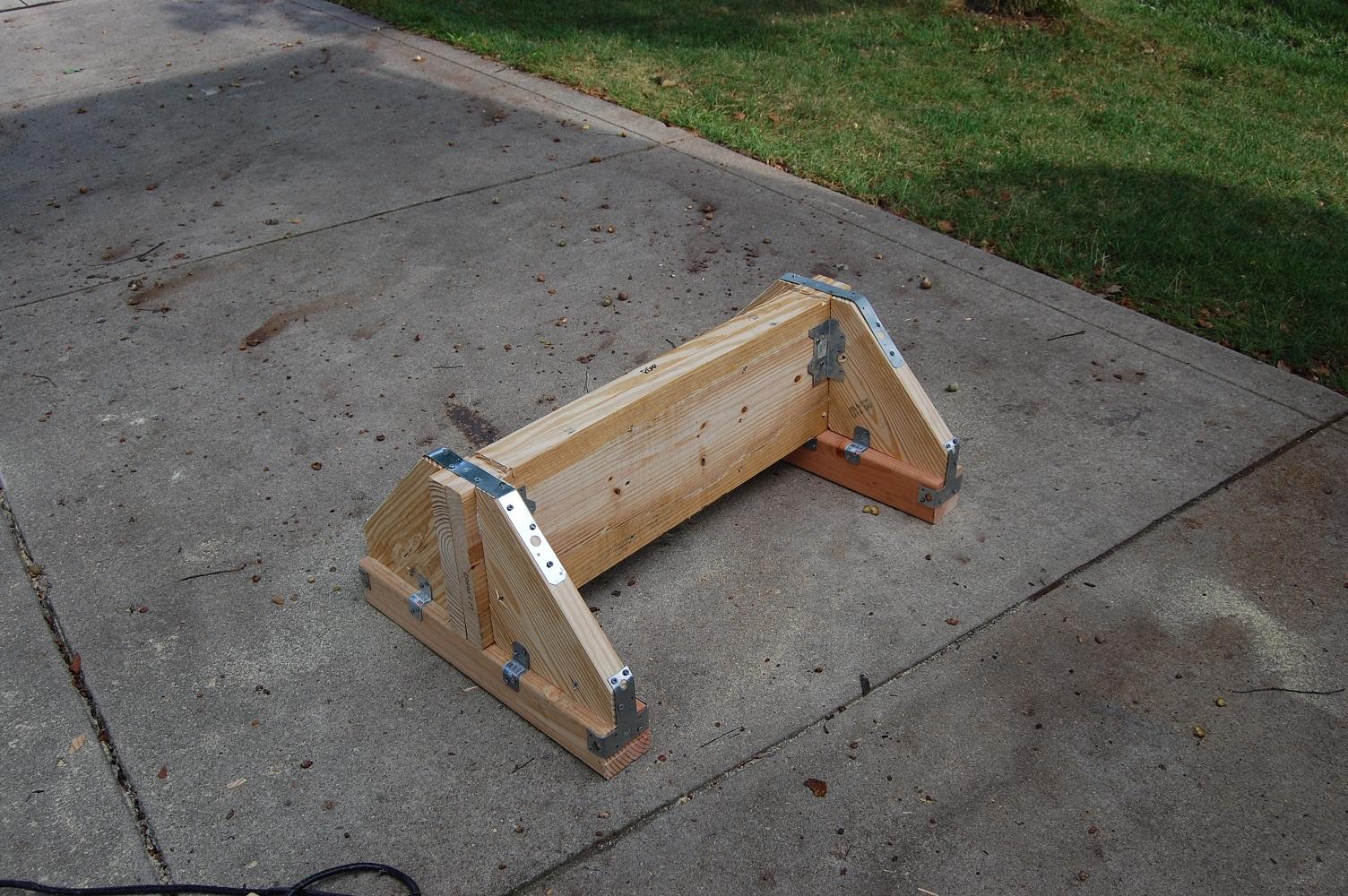

I have plans on lowering my 1960 panel so out goes the entire (stock) front and rear suspension. Now I can access everything I need and will be able to complete the rust repair with easy access from above and below. I don't have enough room for a rotisserie and I built both of these stands in a few hours with a budget of about $100 (including casters). I used a similar set up with my previous bus and it worked well.

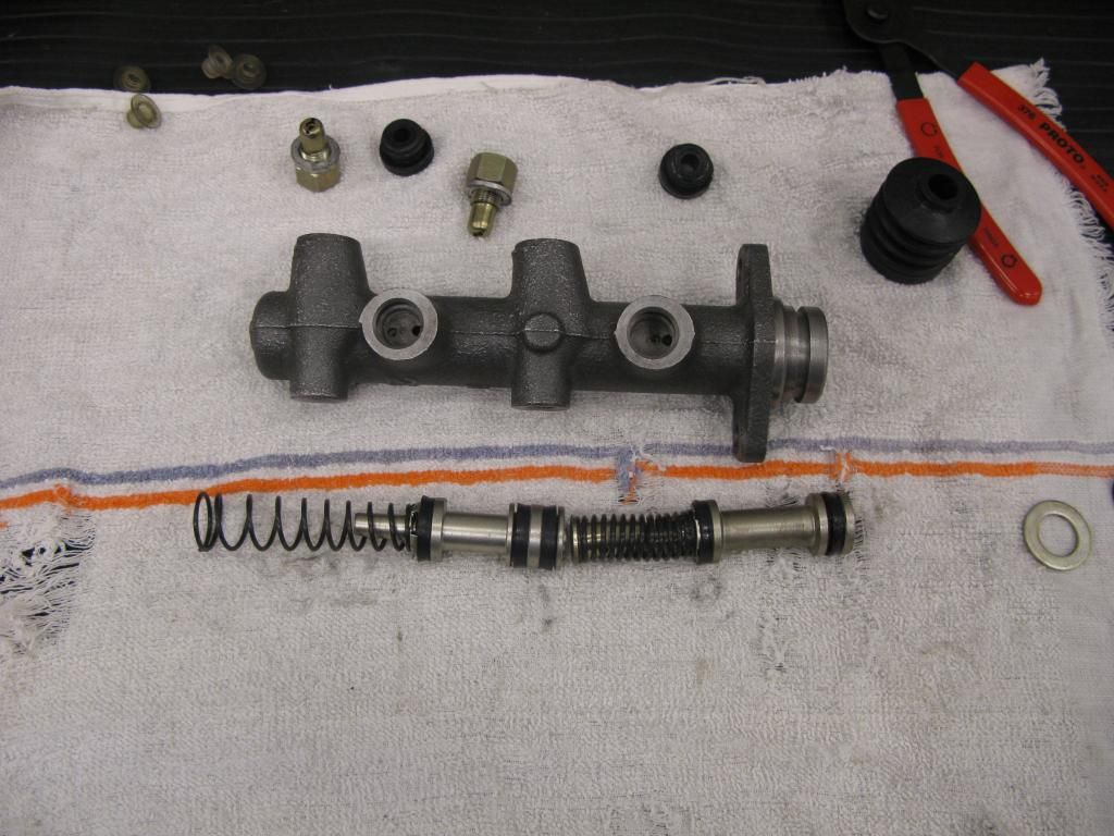

From a few days back.
Pulled apart the EIS 67 only master. It looks pretty good on the insides except for not being as clean as I would have liked. The bore looked excellent on the inspection lab scope.
Cleaned, honed, re cleaned and put back together. All in all not a bad part for $38.00 and some of my time.
Also had some DOT and FMVSS compliant SS braided lines made.
Still need to make a 67 only pushrod for the master and get the bubble flare dies for the tubing crimper to finish the job.
