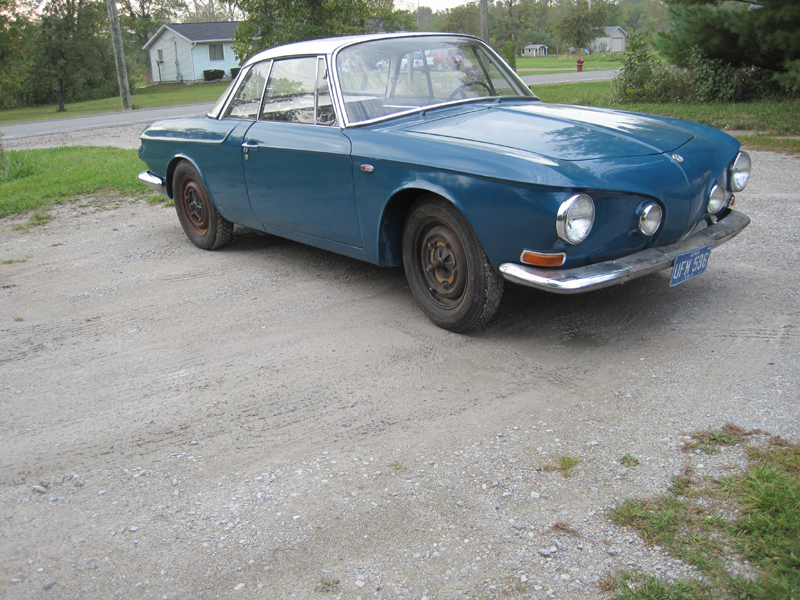

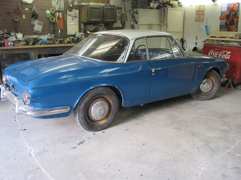

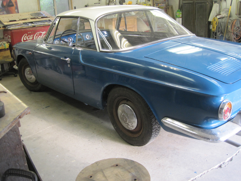

Well, since I basically got Krunchy ready to go for now, I thought I'd bring Wolfie back into the shop, and do some other finish up work, like wiring in the fog lights, seeing what was going on with the wipers (they wanted to run all the time), and general stuff like that. Here's a couple of pics with him back in the shop, and now sporting his "new to him" hub caps.
I got the fogs to work today, and did play around with the wipers too. They're working like they should now. Don't know IF I had something plugged in wrong or what, but they work (actually park correctly). Cool The wiper arms and blades will probably get installed in the spring though. I'll try to get some pics of the lights on in the dark soon. Wink
