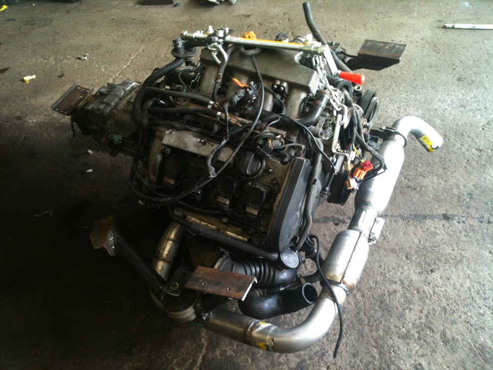

I'm starting to catch up. Look ma, no jack! Laughing

PostPosted: Mon Jan 30, 2017 6:07 am    Post subject: Re: All I want is 200hp, a 5 speed, and some decent heat. Reply with quote
What angle are you guys mounting the engines at? Looks like more than 15, but not as far as 50.

PostPosted: Mon Jan 30, 2017 11:02 am    Post subject: Re: All I want is 200hp, a 5 speed, and some decent heat. Reply with quote
I set mine at "bottom of the oil pan is level relative to the ground", which IIRC is the same angle as the donor Passat. No idea what the actual angle is...

PostPosted: Mon Jan 30, 2017 11:15 am    Post subject: Re: All I want is 200hp, a 5 speed, and some decent heat. Reply with quote
I also have no clue on the angle, never had a reason to measure it. I just made sure the hubs on the transmission were sitting perfectly level with the van before making the motor mount bar. I can set a protractor on it if your really need to know.
On the subject of 50 degree engines, I did in the past set one of these 1.8t engines in a vanagon at 50* using a vanagon diesel belhousing.....
