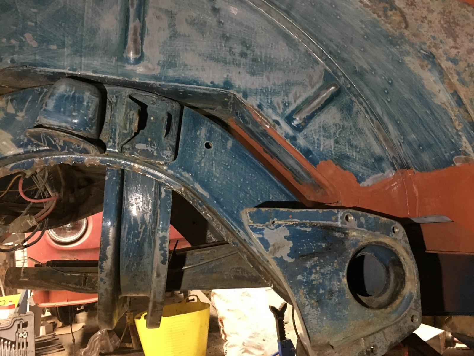

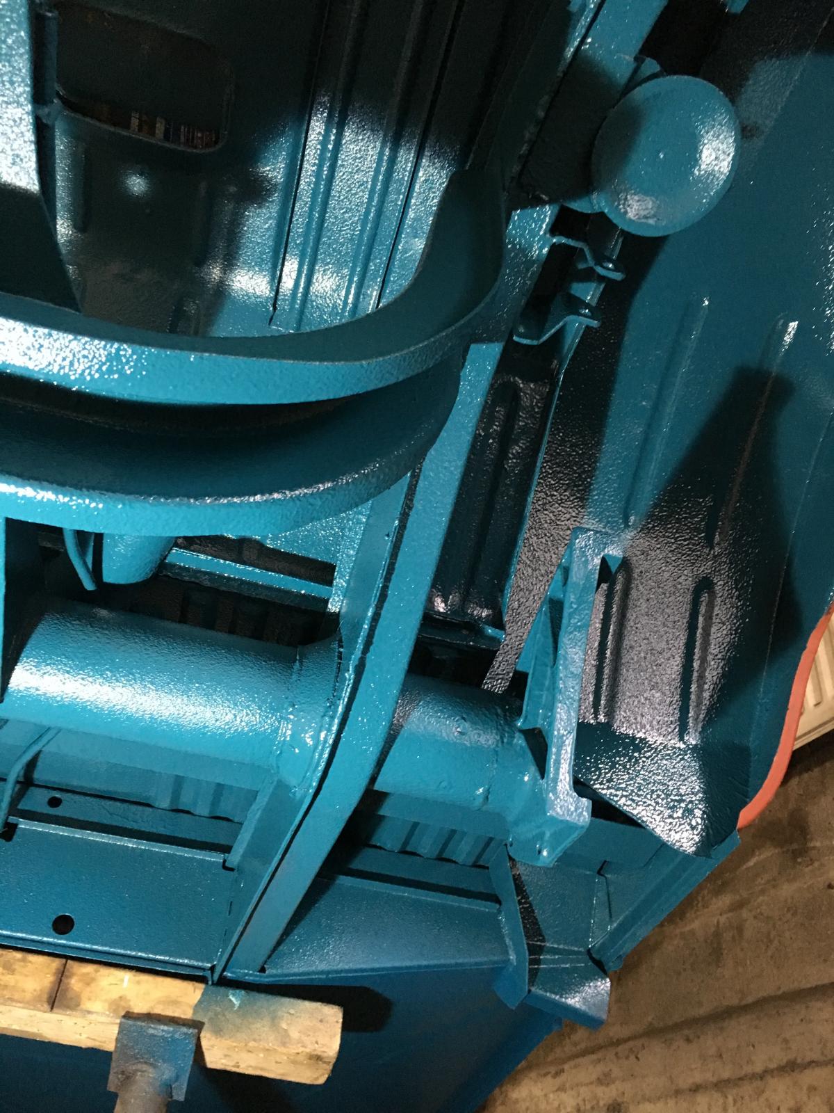

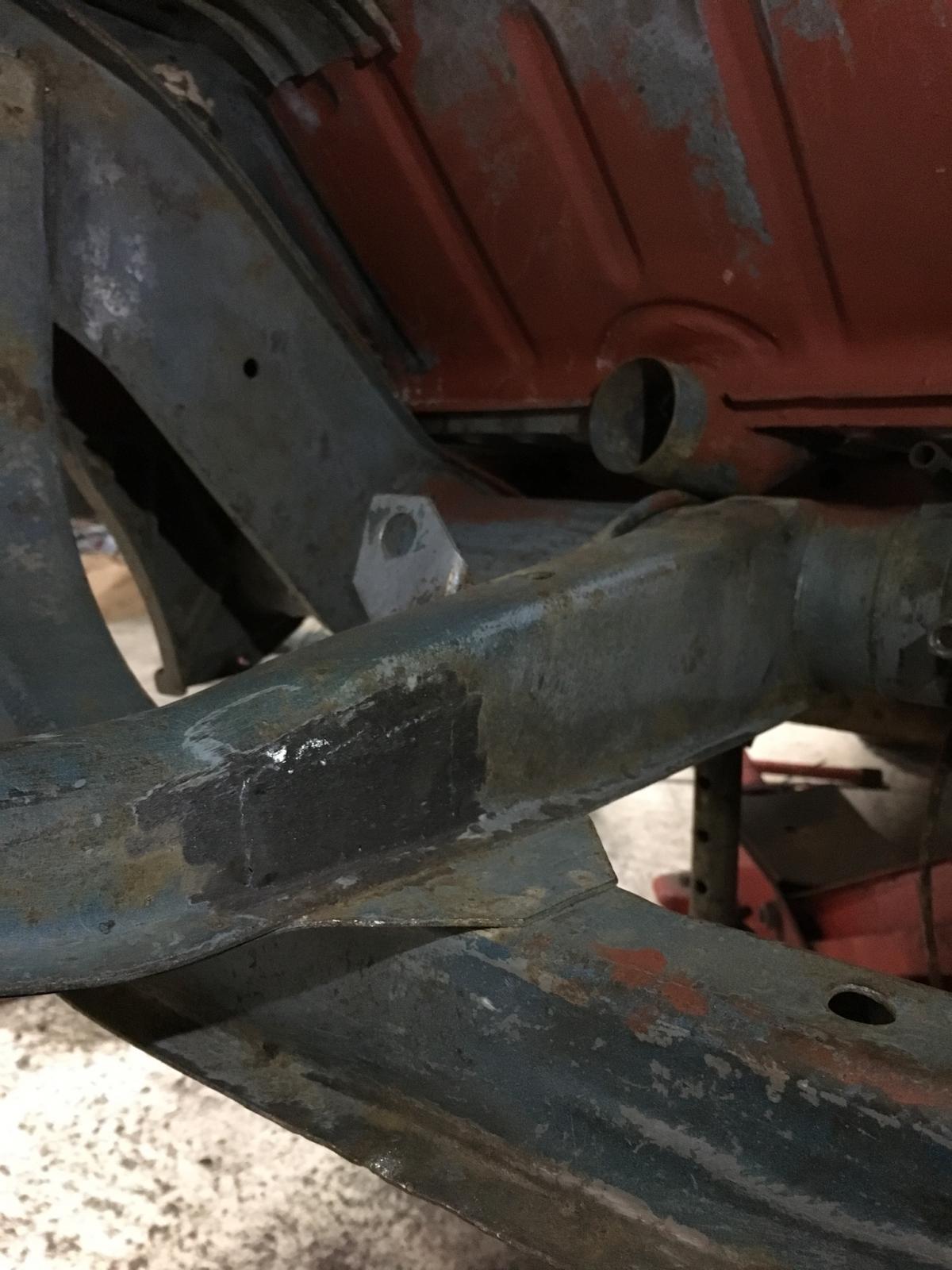

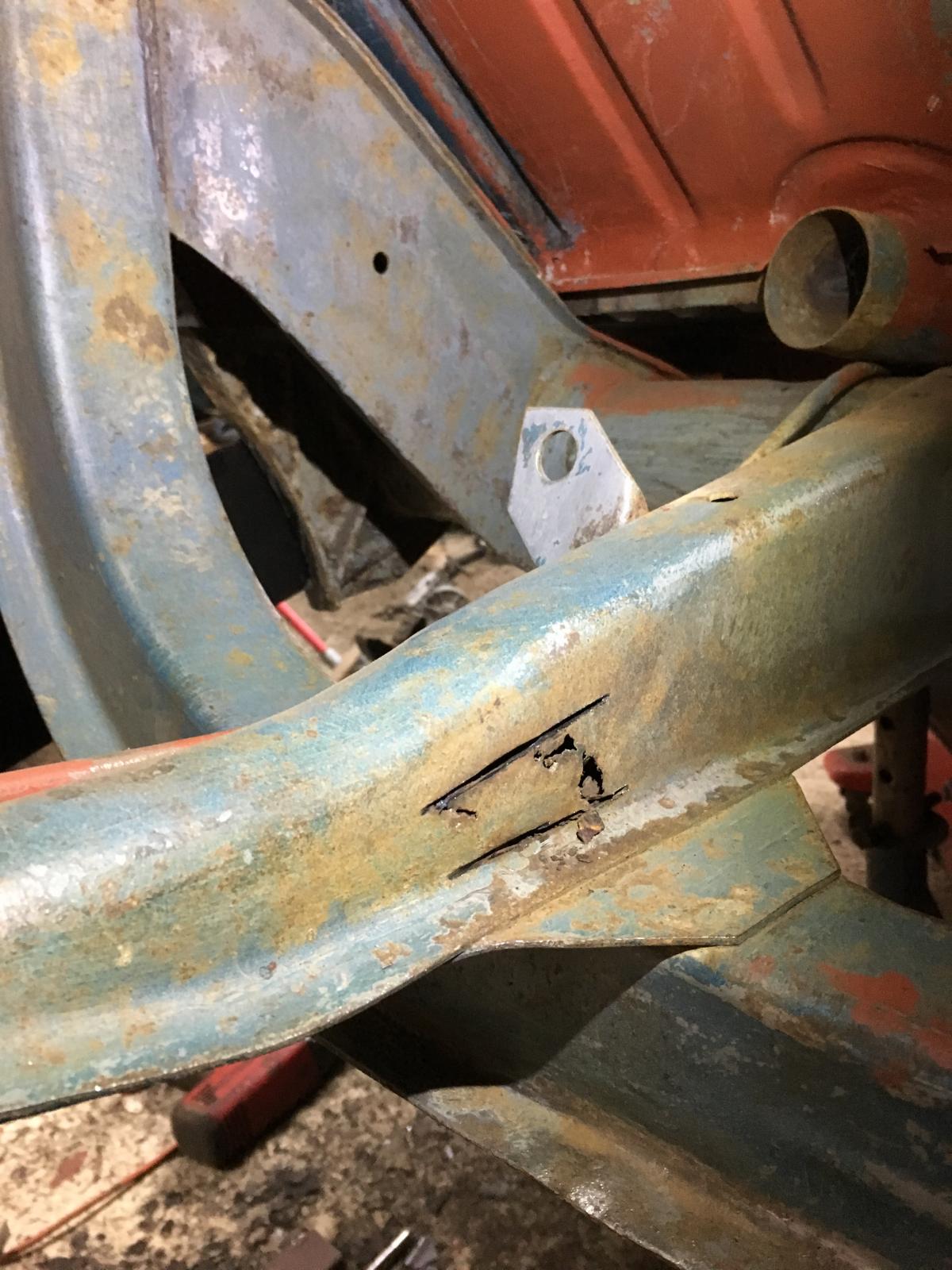

Last few before blue!
Found a bit of rot in the cradle. It’s a stupid design, as it funnels water into gearbox mount turrets if you drive in the rain.
All welded up. I’ve finished the prep and seam sealing, so it should be completely raptored blue by this time tomorrow.

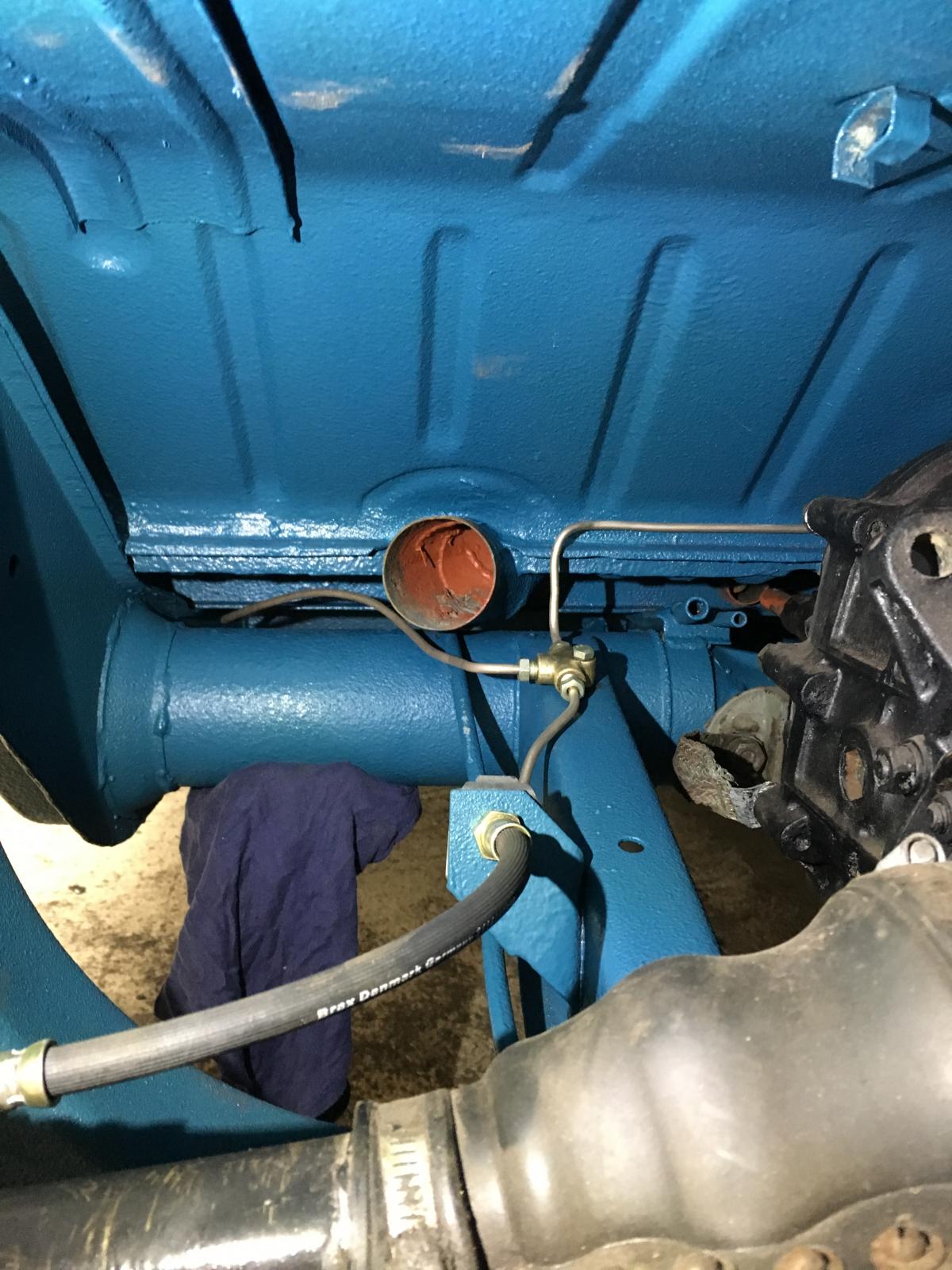

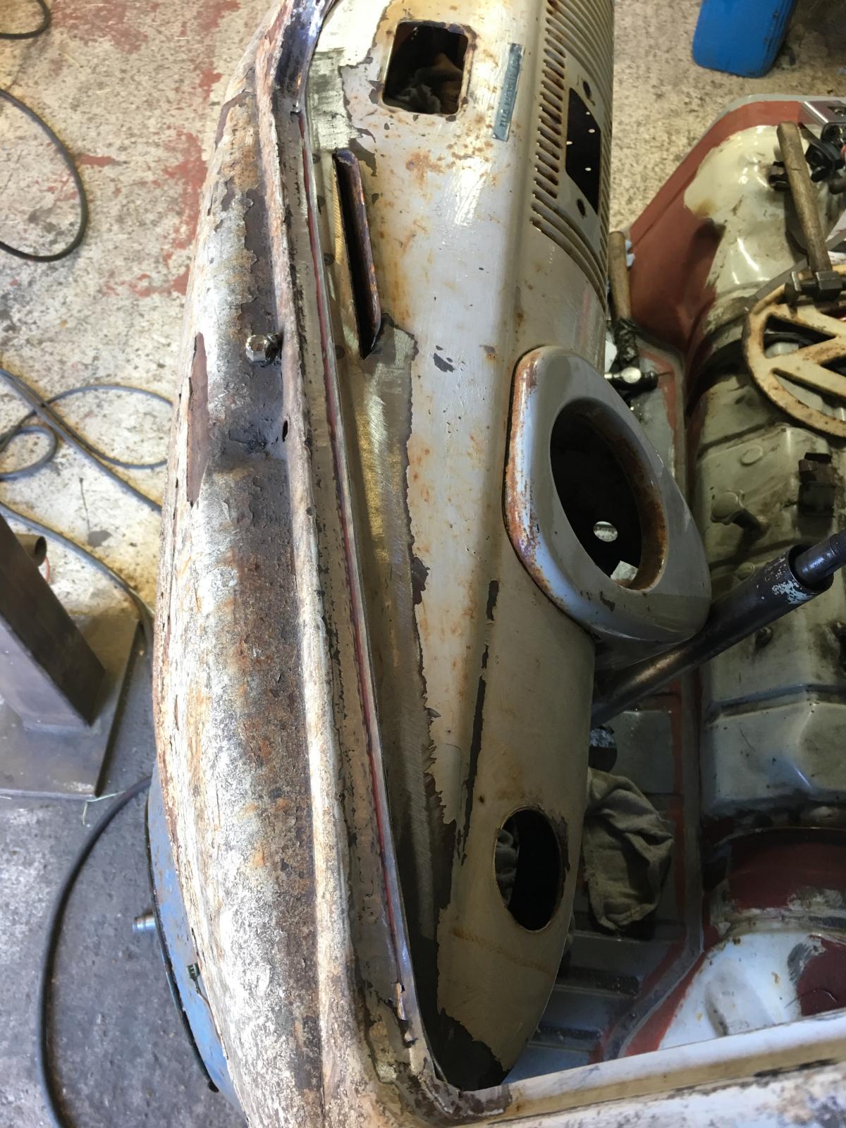

Not a huge amount going on here, I got the ‘box and axles back in and made up the rear brake pipes. I put new handbrakes cables in and had a moment of panic when I couldn’t get the threaded end to slide through the guide tube. Something was blocking it and obviously it’s all hidden under bellypans. With hindsight I should have checked this at an earlier stage. Luckily the obstruction was near the front of the tube and I could file it down a bit. I think I must have got over excited with the welder when I was tacking the tube to the crossmember.
Also made a start on repairing the dash👍

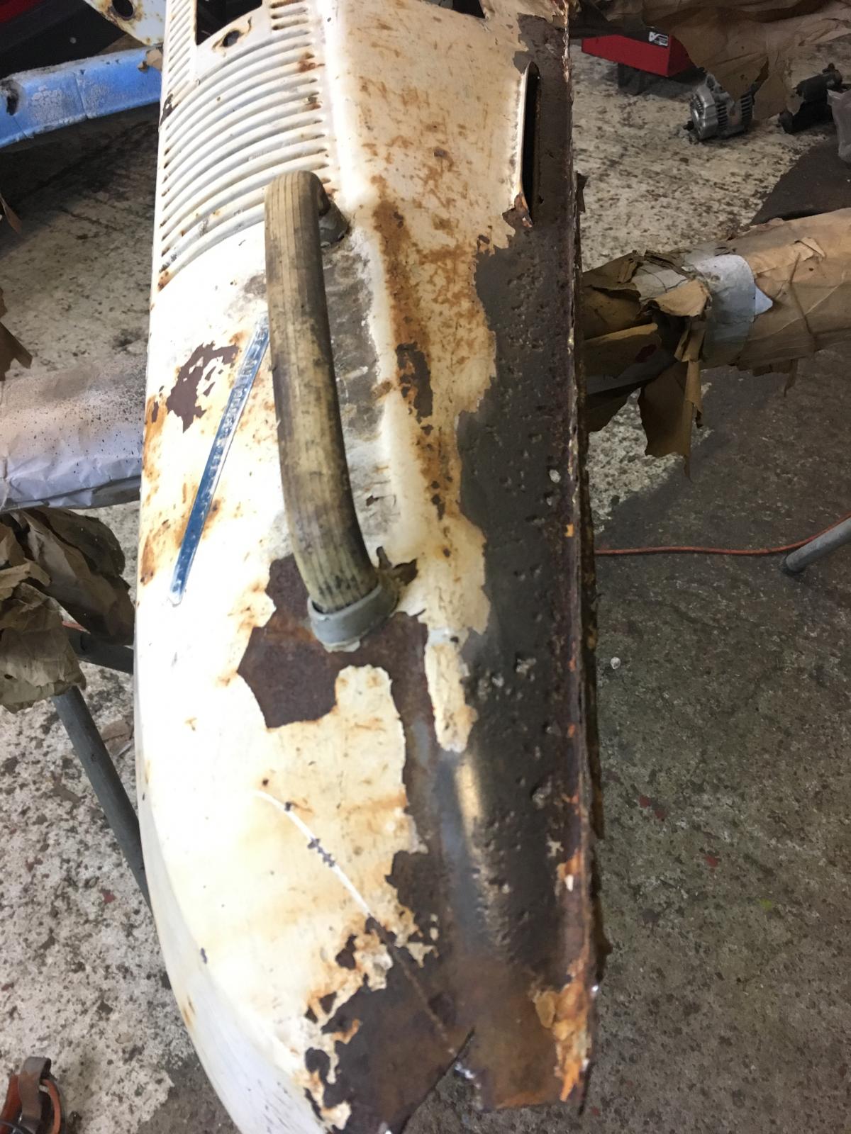

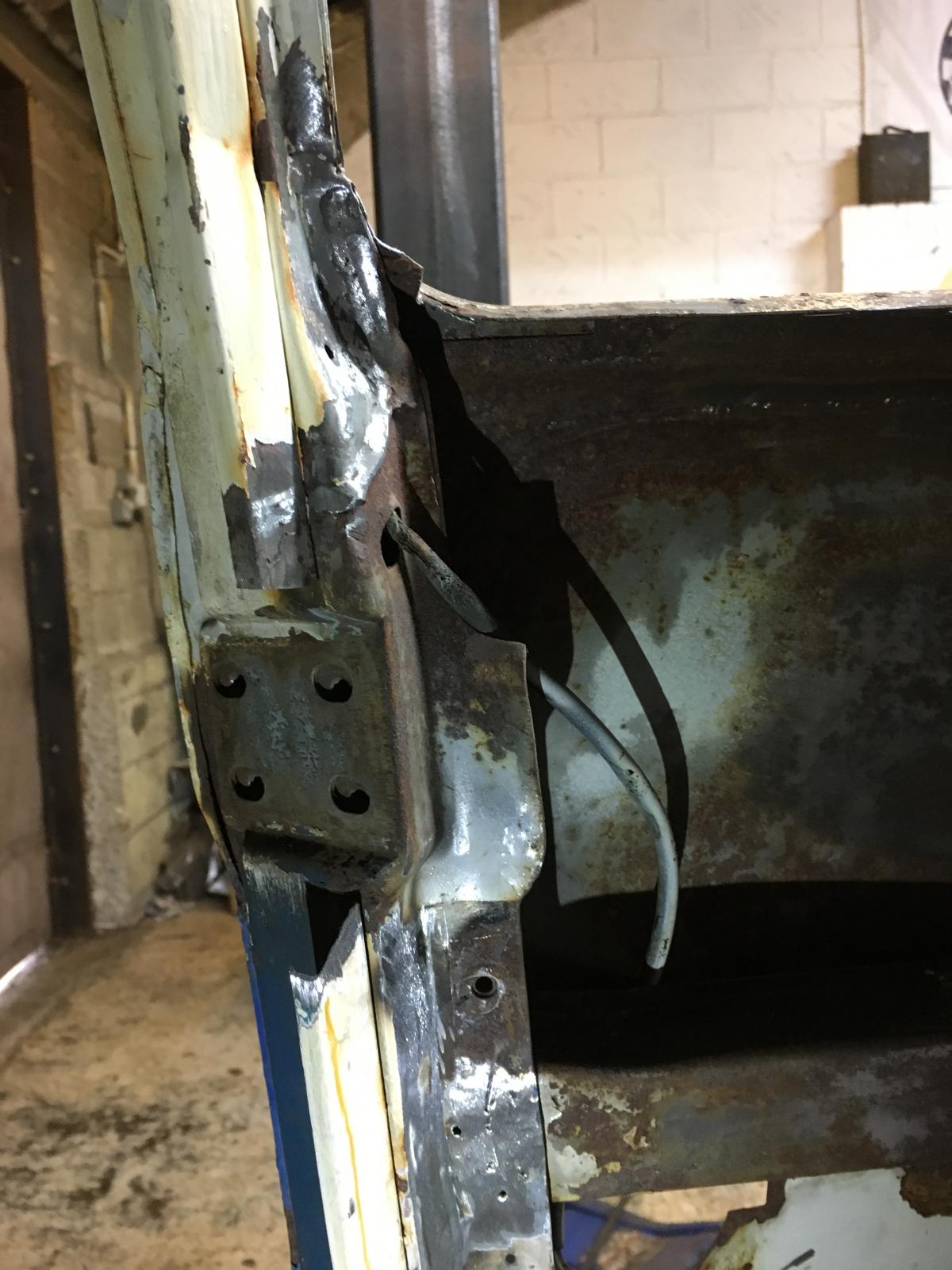

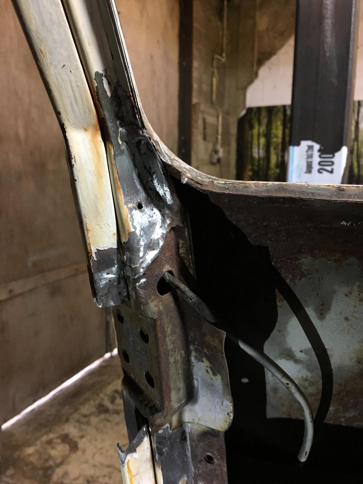

Repairs to the A pillars before the dash goes back in.

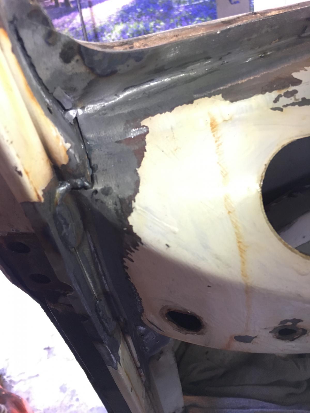

A small update. I’ve finished repairing the dash and welded it back in. Next up was to repair the windscreen frames which were both rusty along the lower sections. I wanted to repair it without disturbing the front panel you can see, so hopefully the repair should be hidden under the seal.

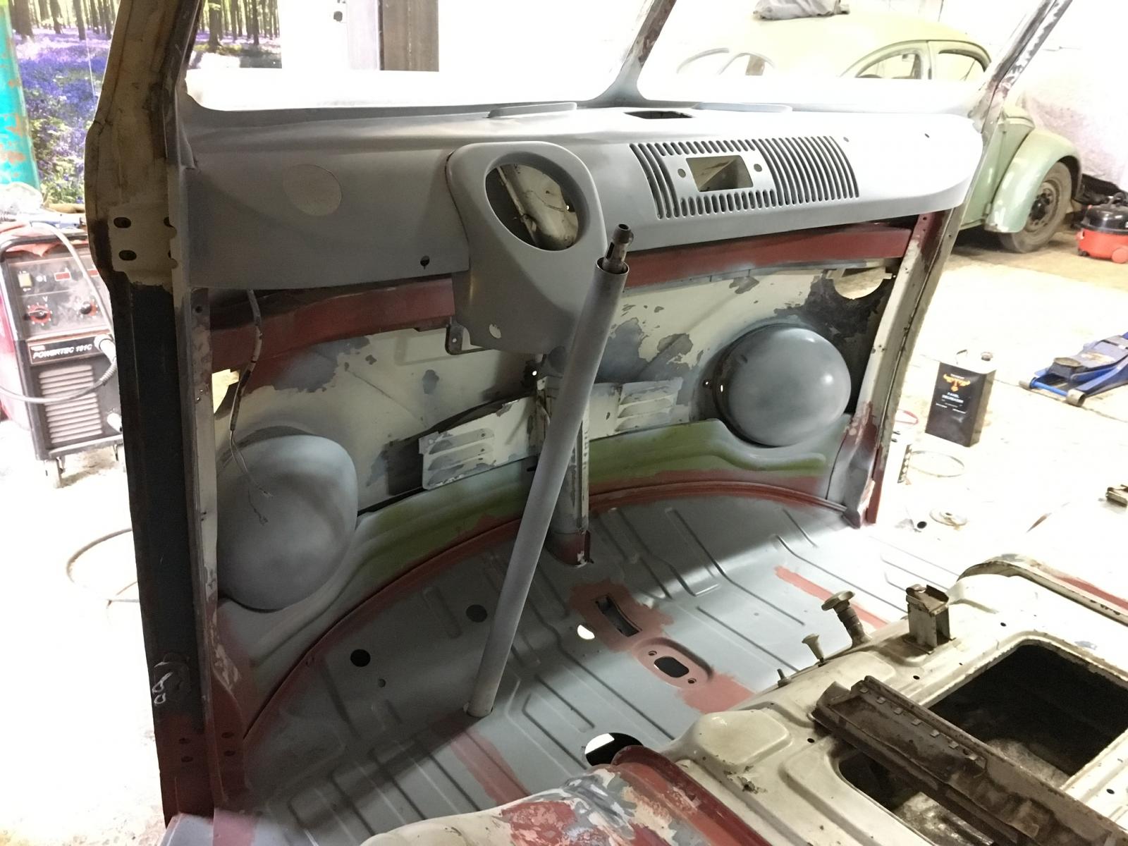

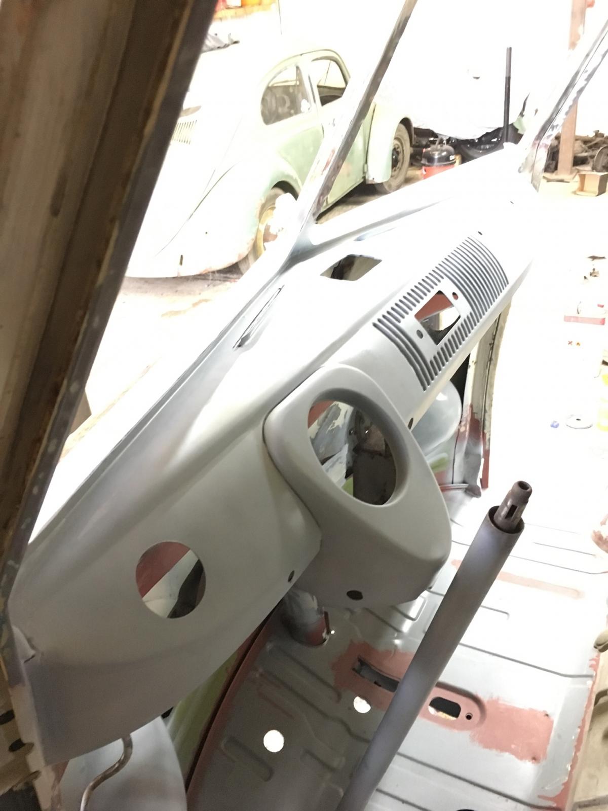

Another quick update. Engine is built up now. I’ll do a separate post on it later, but here’s a pic of it for now.
Next job is the cab area. I spent ages deliberating over keeping the dash looking rough or painting it. In the end I decided to paint it.
I welded up a couple of extra holes that had been added to the left of the speedo pod, then it’s loads of prep. Crazy really as you don’t see much of it once the mats and kick panels are in place. I bare metalled the dash and headlight bowls as they’re the only bits you really see, then gave them a quick coat of etch primer. Hopefully I’ll get the paint on this week. I also welded the totem pole vent back in after i’d prepped behind it.

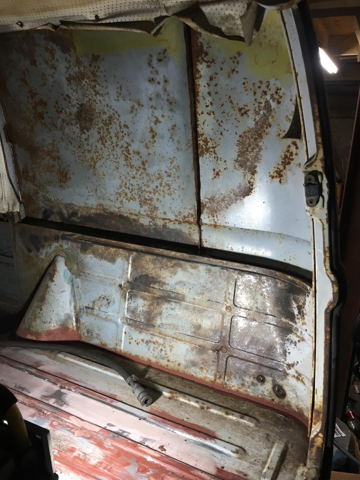

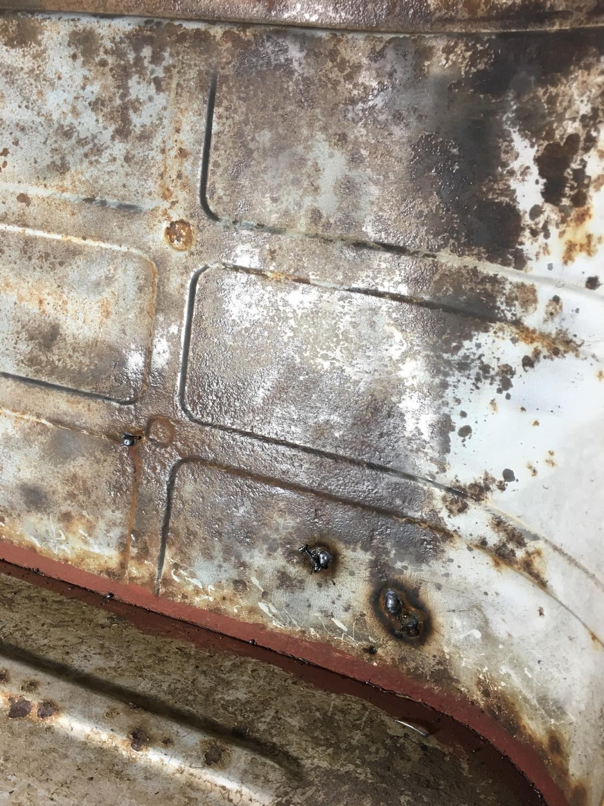

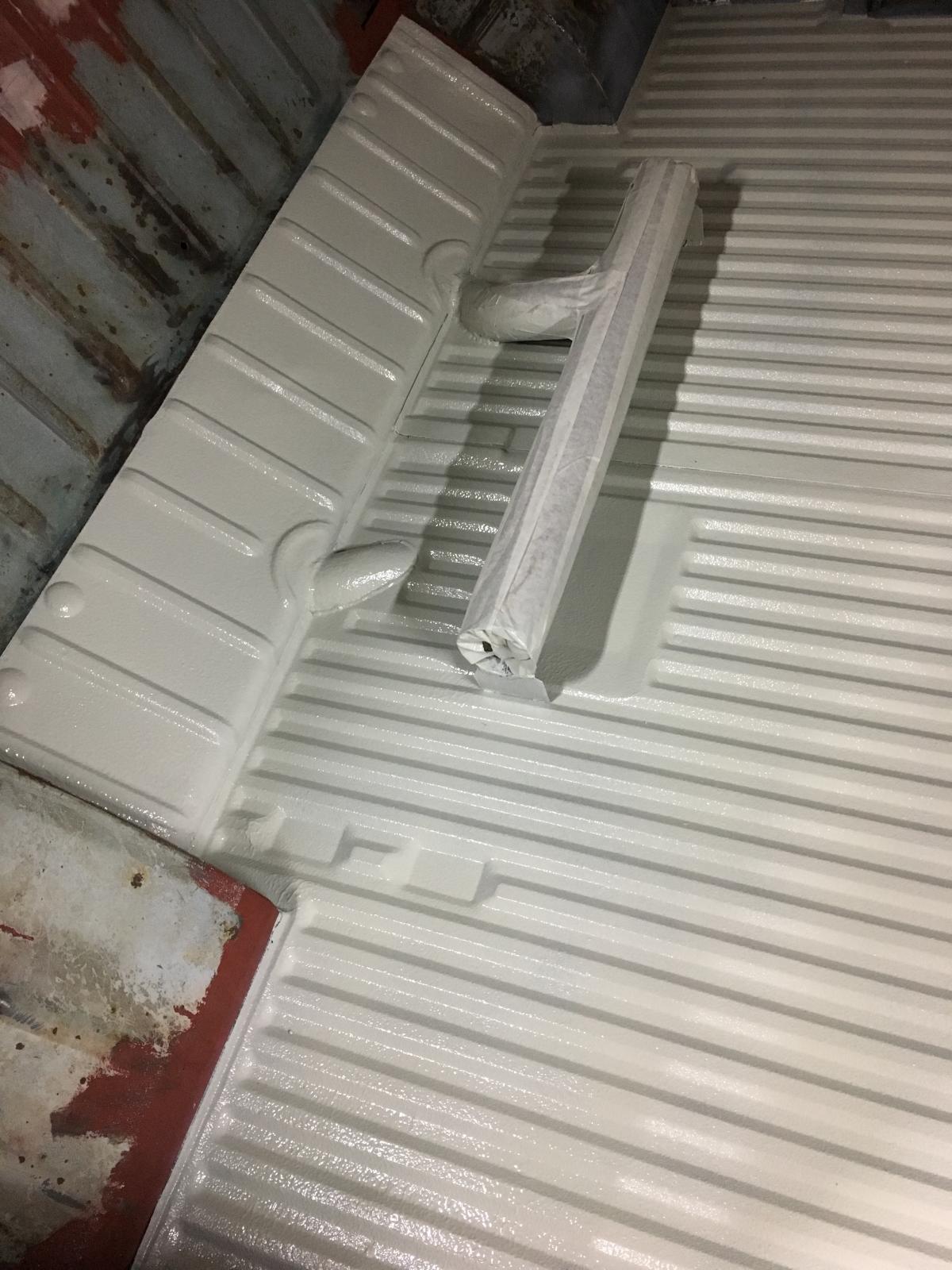

Happy new year everyone. A few little jobs ticked off. I started to prep the inside ready for some paint and obviously found some more holes. Only pin holes though, so welded them up, then treated the whole panel with kurust and bonda.

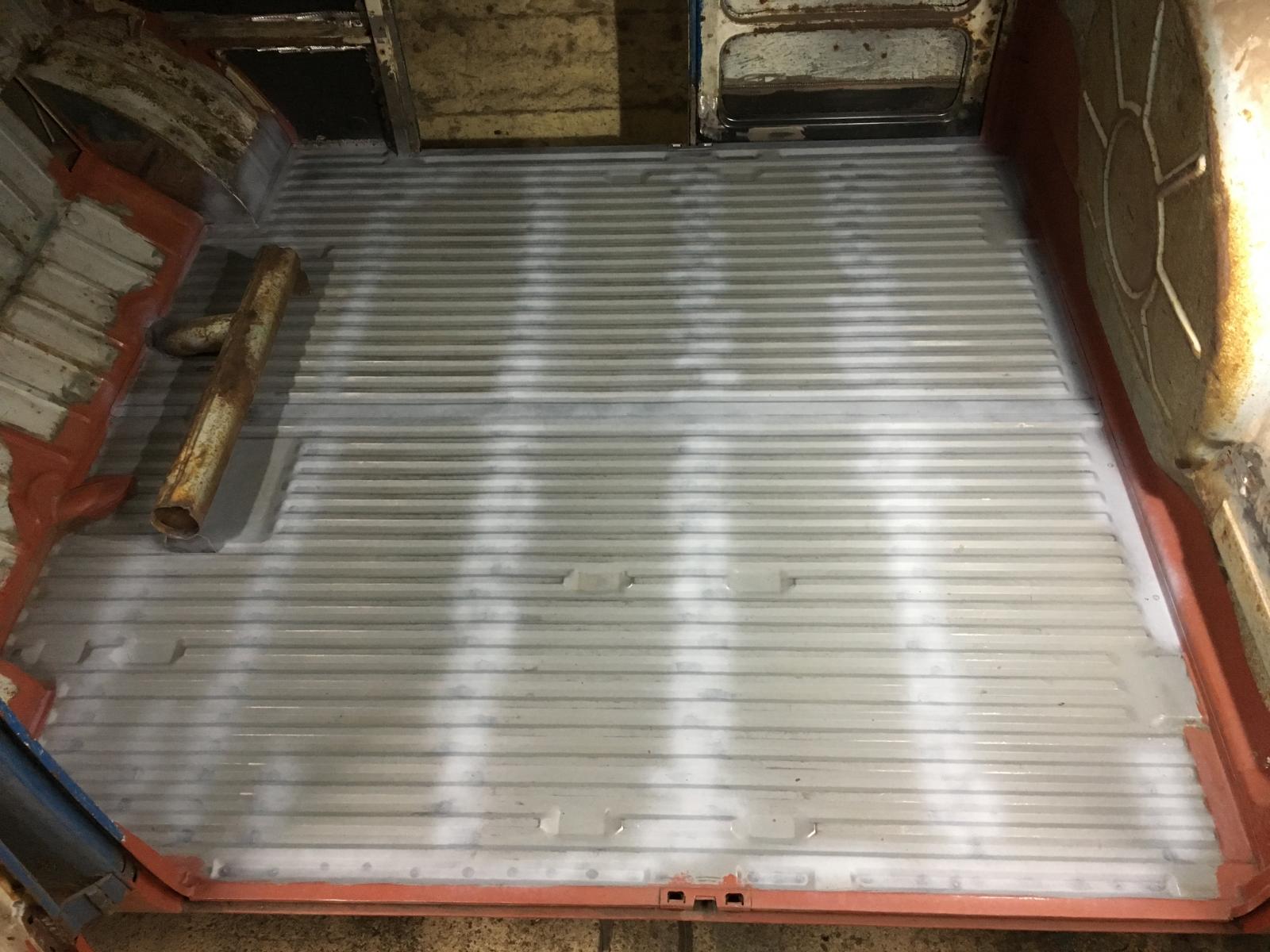

Then I prepped the cargo floor ready for Raptor. I’m not a huge fan of it inside as it doesn’t look quite right, but I figured it’s quick and easy and will be under a ply floor anyway. 10% tint with cloud white👍
