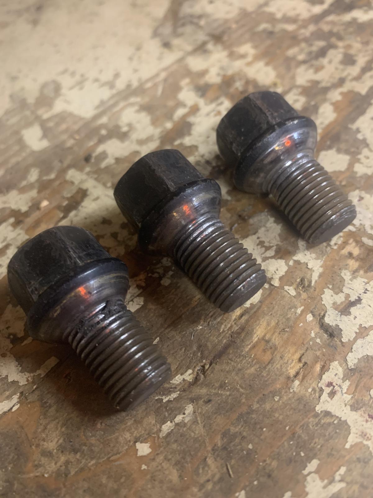

I didn’t check the torque on the wheels often enough and wheel almost fell off the other day. Yadda yadda new drum and new lugs.
However now I’m wondering if I should chase the threads with the die instead of throwing them out. They’re originals. Maybe I’m just being crazy and need to let go. Thoughts?

A chase is different than a die; a chase just tries to re- form the thread profile, and a die cuts new ones. I think a die would mean a thinner, slightly smaller thread, which has less grip. I see lots of bolts with squared threads, and wonder how much holding power they’ve lost; I also hate tossing an OG part, but on the wheels… maybe find some nicer ones.
Only the threads up by shoulder look really bad, so maybe take to local shop for an opinion. Mine has a chase set and has redone a spring plate bolt for me (as opposed to new shiny garbage bolts they didn’t trust). Still holding tight.
Ps - there’s a fantastic book about fasteners by a racing guy, Carrol smith, that discusses threads and holding power. Pretty sure he’d advocate tossing for new, though.
