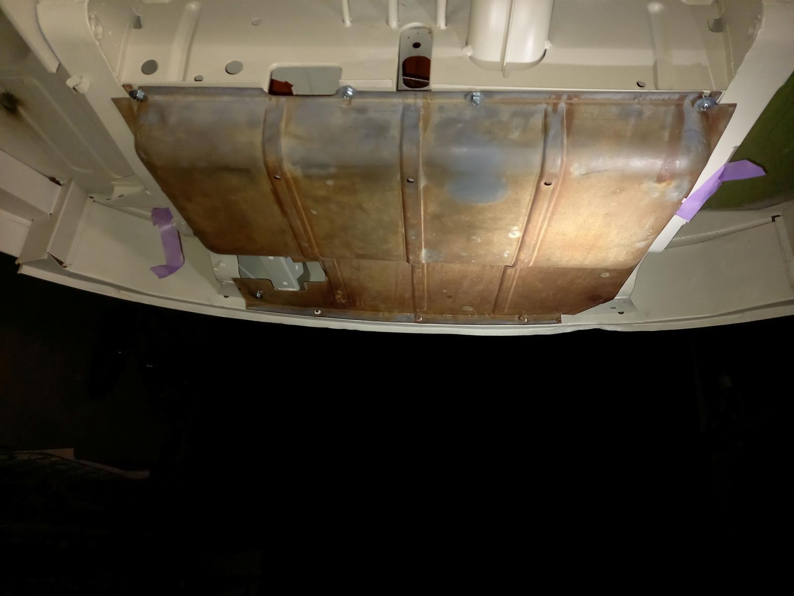

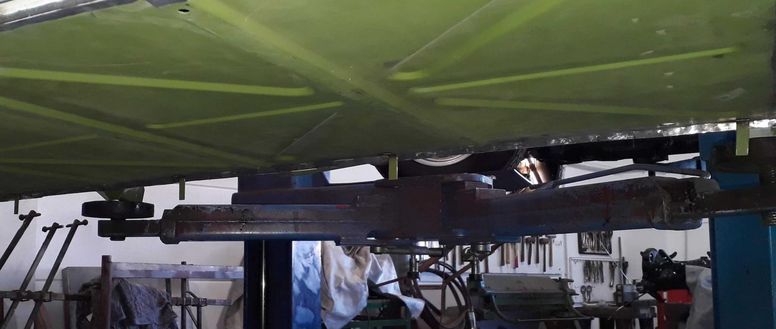

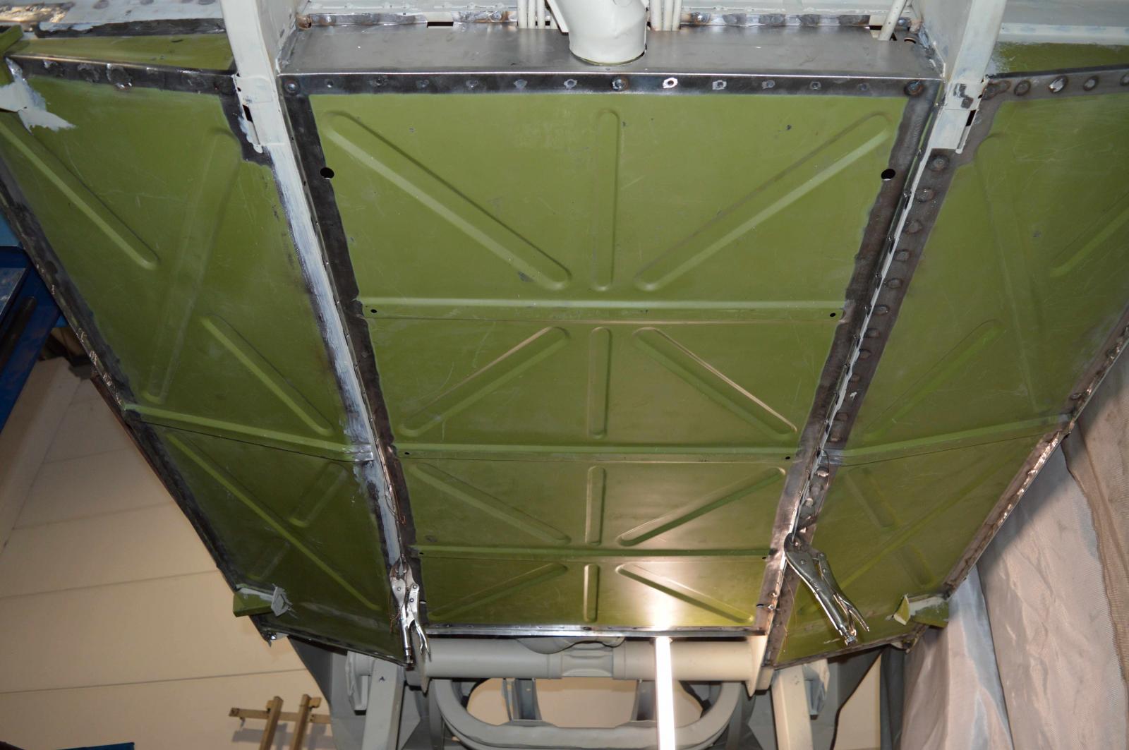

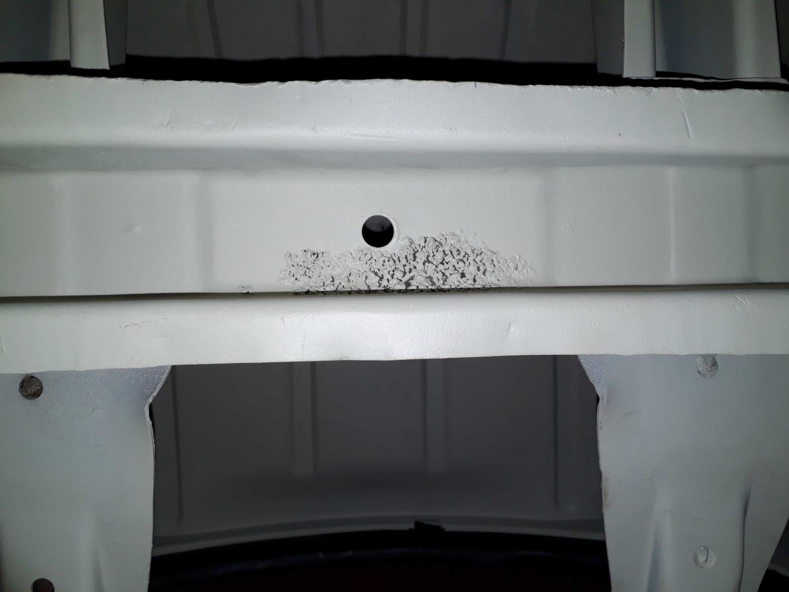

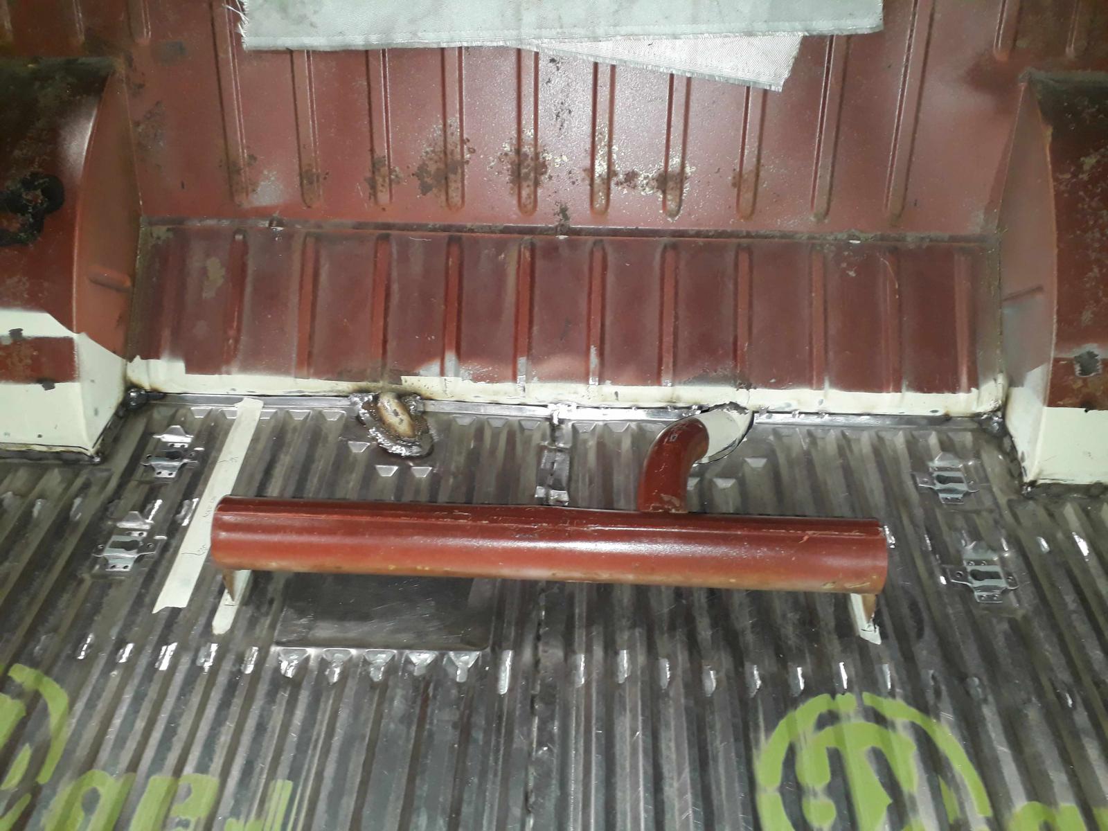

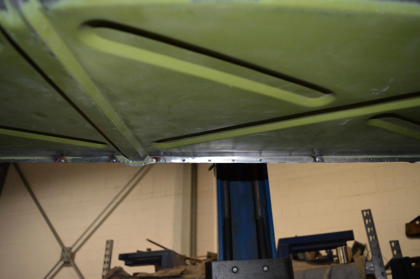

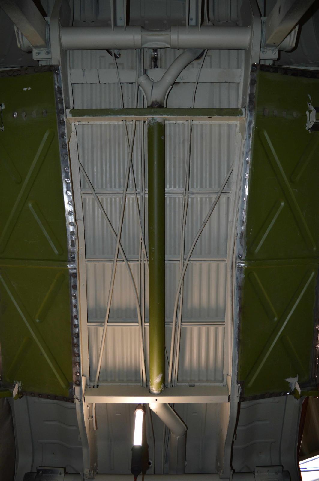

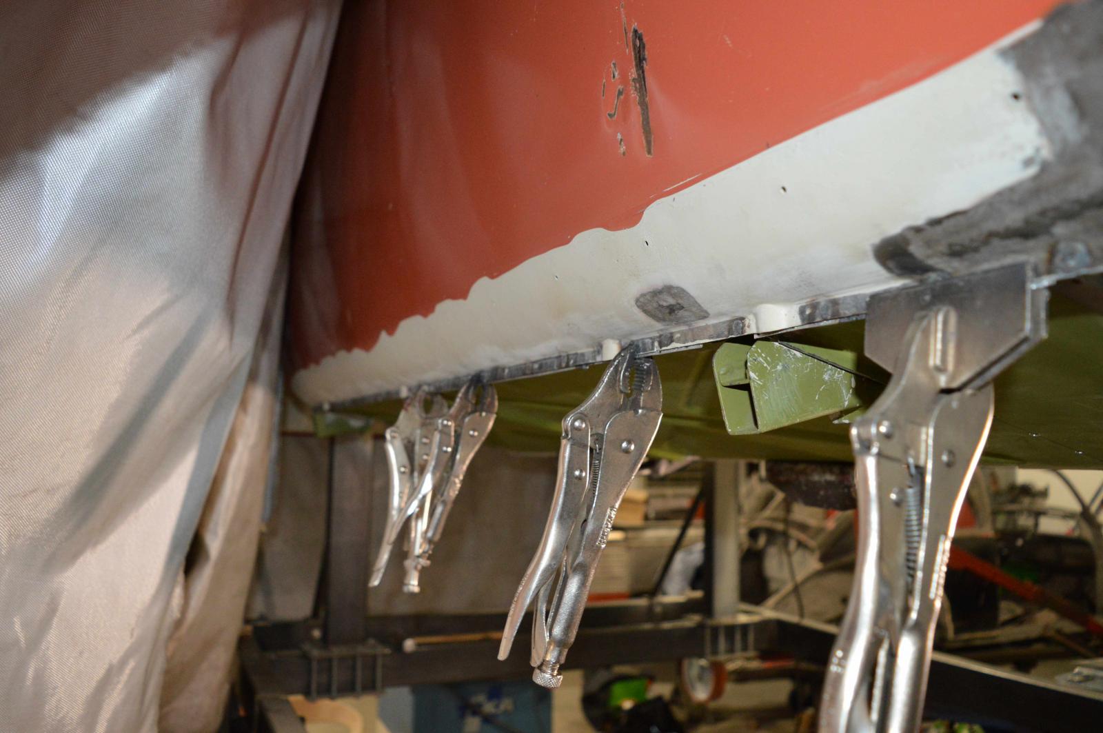

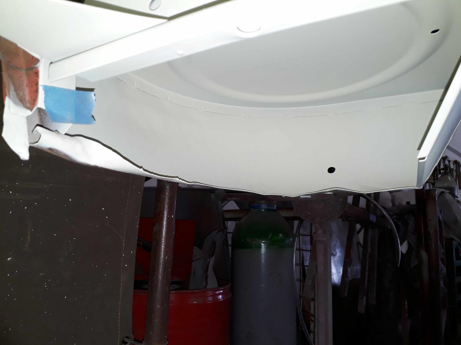

During the next step the 3 belly-pans and the middle heater-tube-section were welded in.
Fortunately the parts fit perfect without any complex adjustments Very Happy
After some consideration, it was decided not to insulate the pipe-section (like it was done in factory):
The thermal insulation is not visible in the floor cavity and
moisture may collect in the thermal insulation and promote corrosion of the pipe from the outside (I don’t know if this is really an issue in future … Confused )
I think it is better this tube-section will be covered by cavity-wax later on.
The little sheet-metal-strips for mounting the brake-line were cut from KF-material.

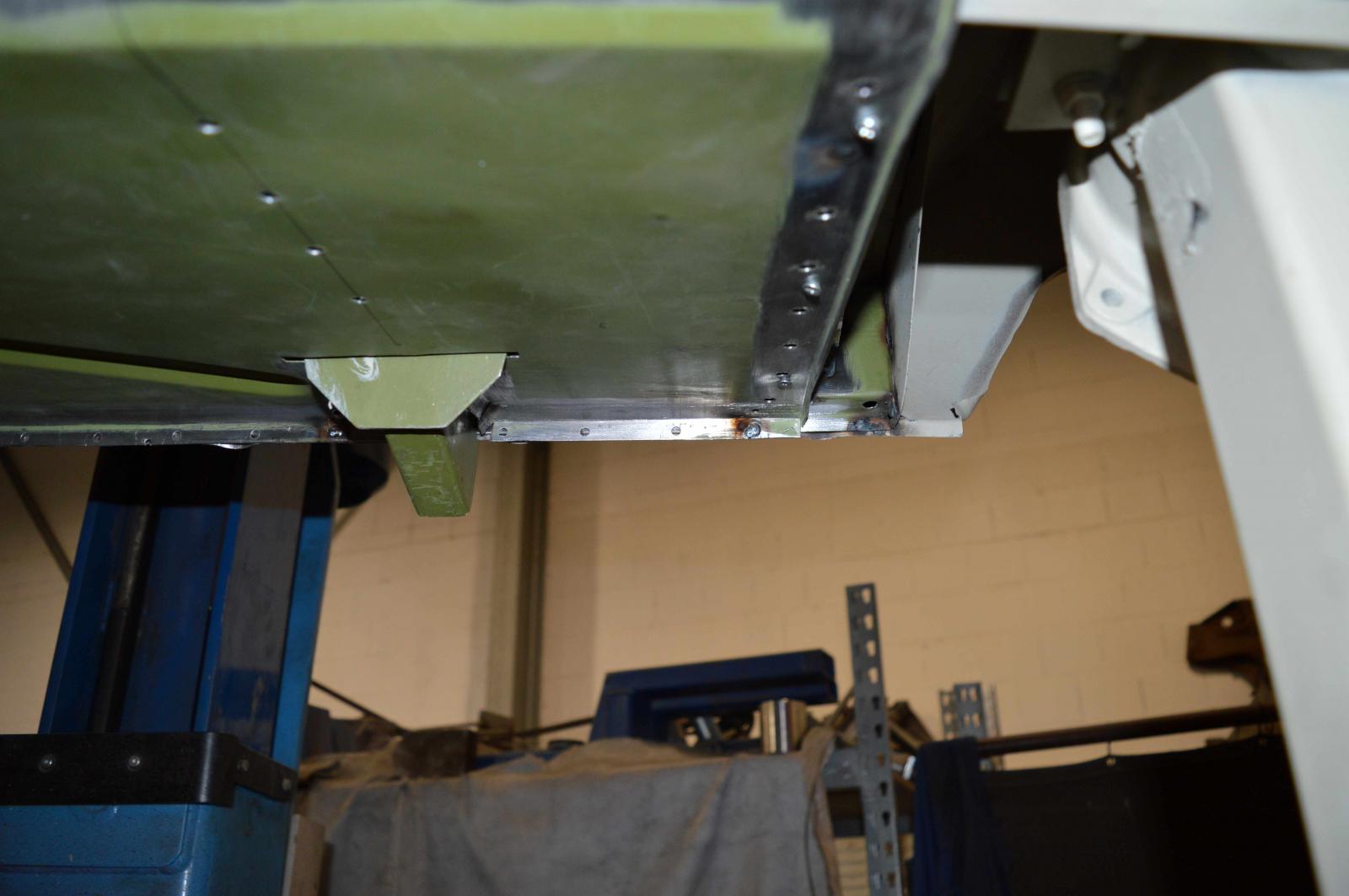

The welding of the belly-pans was one of the last major works in the coachbuilder's workshop and the departure was in sight.
The passenger floor got its seat-bench-mounting-points …
… and the air-outlet. Unfortunately, the coachbuilder removed this item to build in the passenger-floor without any trouble, and missed taking the measurements of its original position Sad
But I was a lucky guy, to have this forum to get the needed information.
Many thanks to the guys who discussed and gathered all the details to this topic in a thread! Very Happy

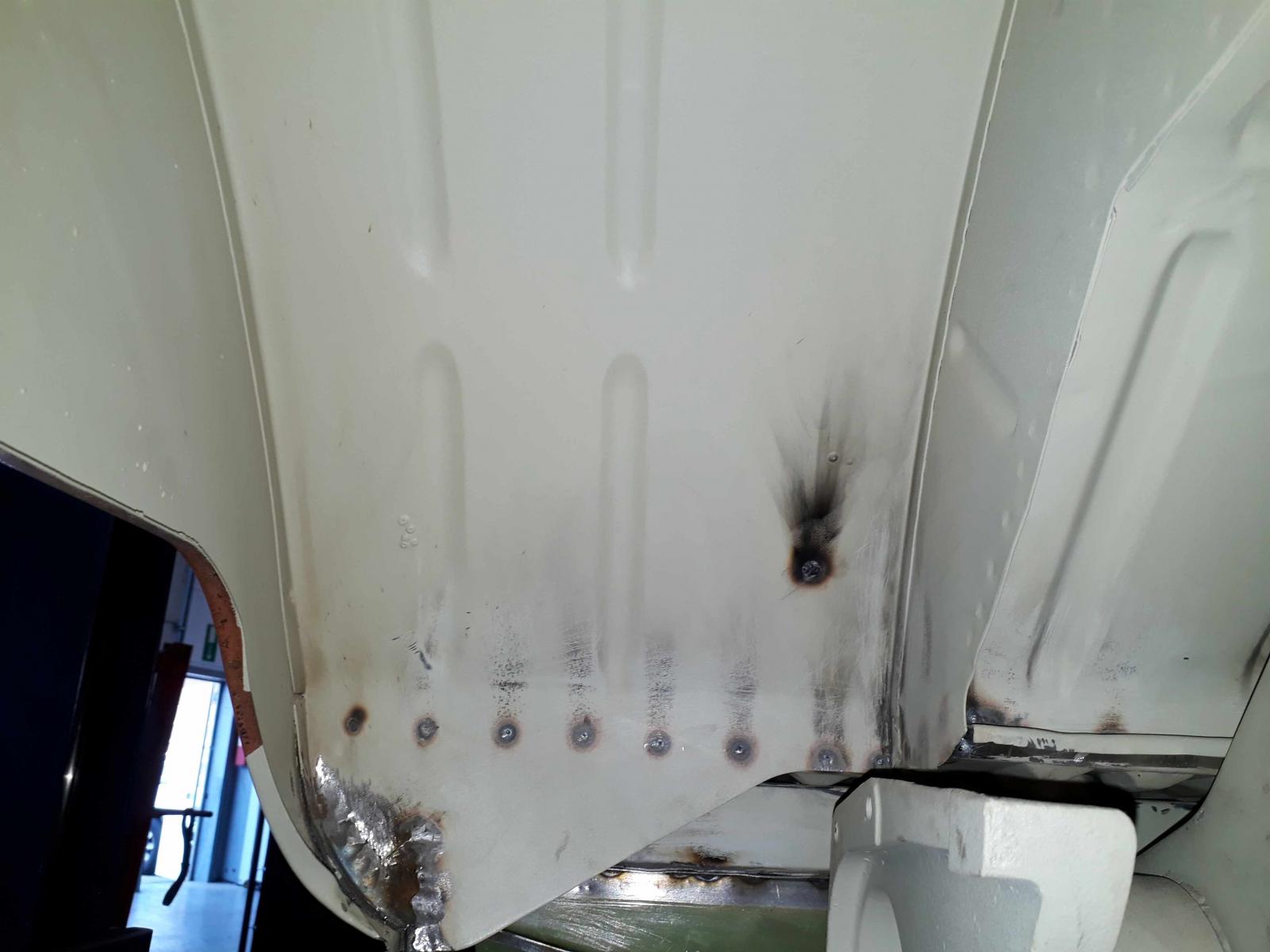

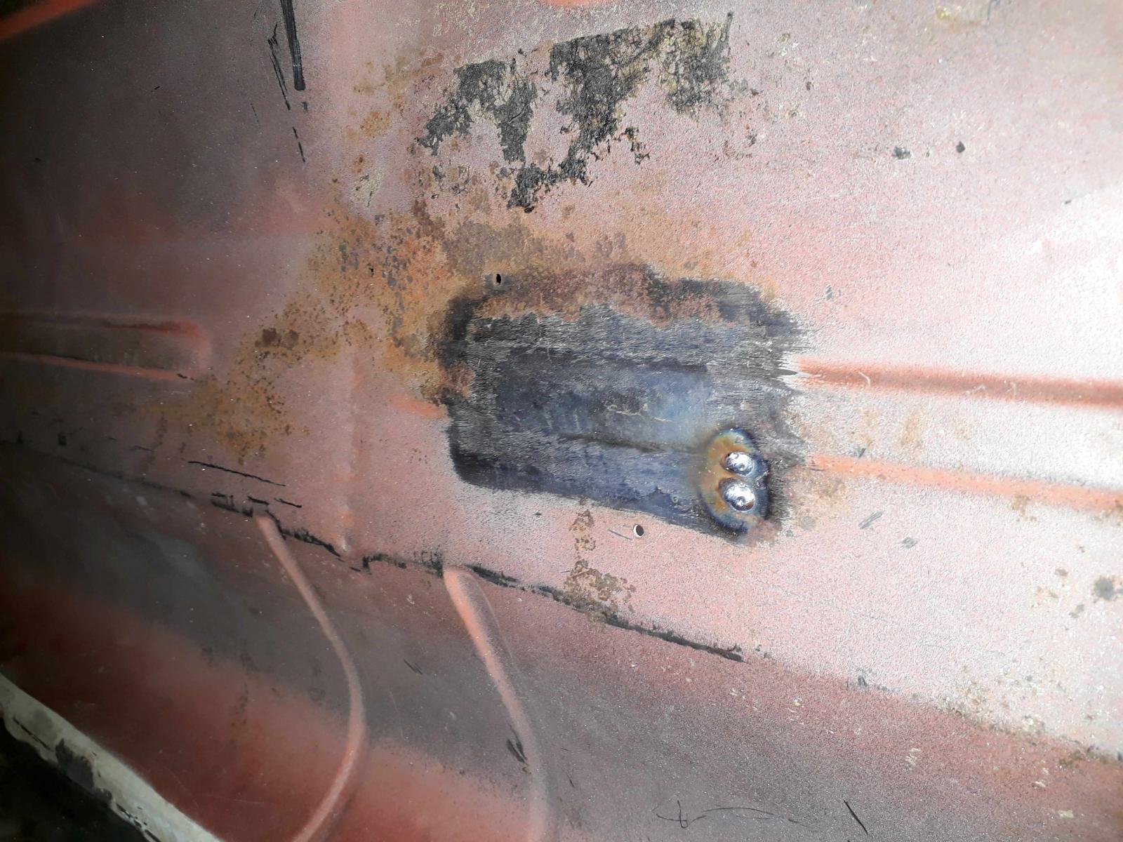

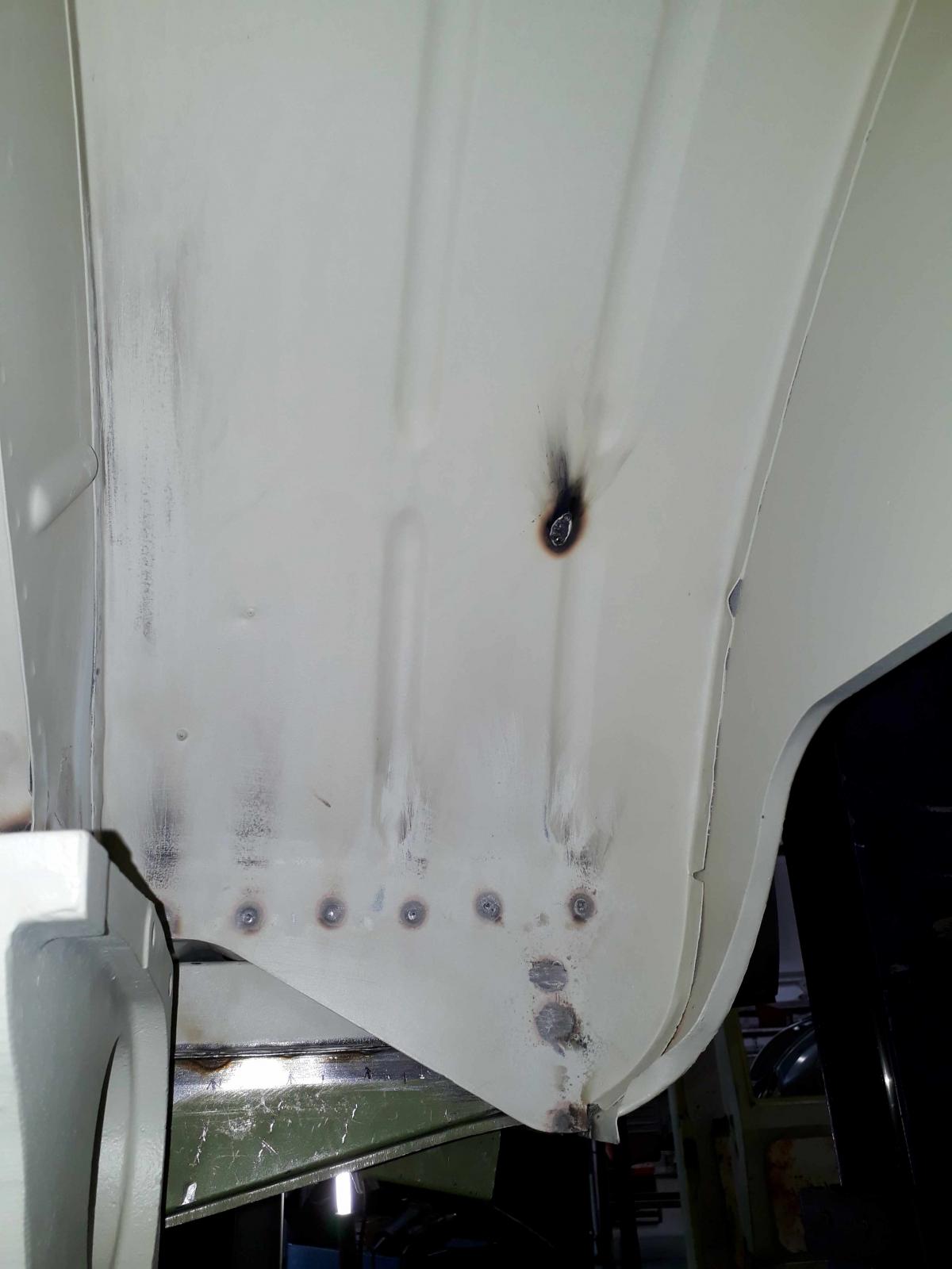

A few little holes were closed by welding …
… and both wrinkled rear corners have been smoothed …

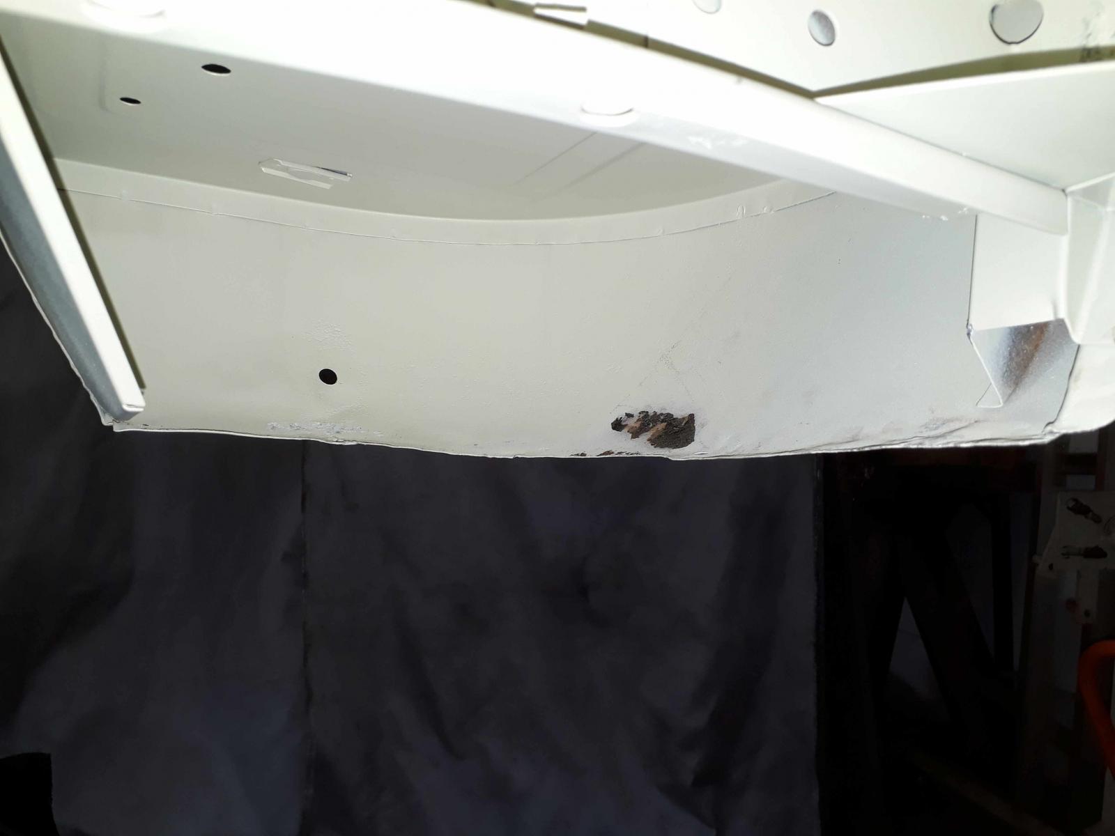

Unbelievable, at this point of time I had already spent weeks and months underneath the bus.
But only now did I notice another spot with old (overpainted) dirt …

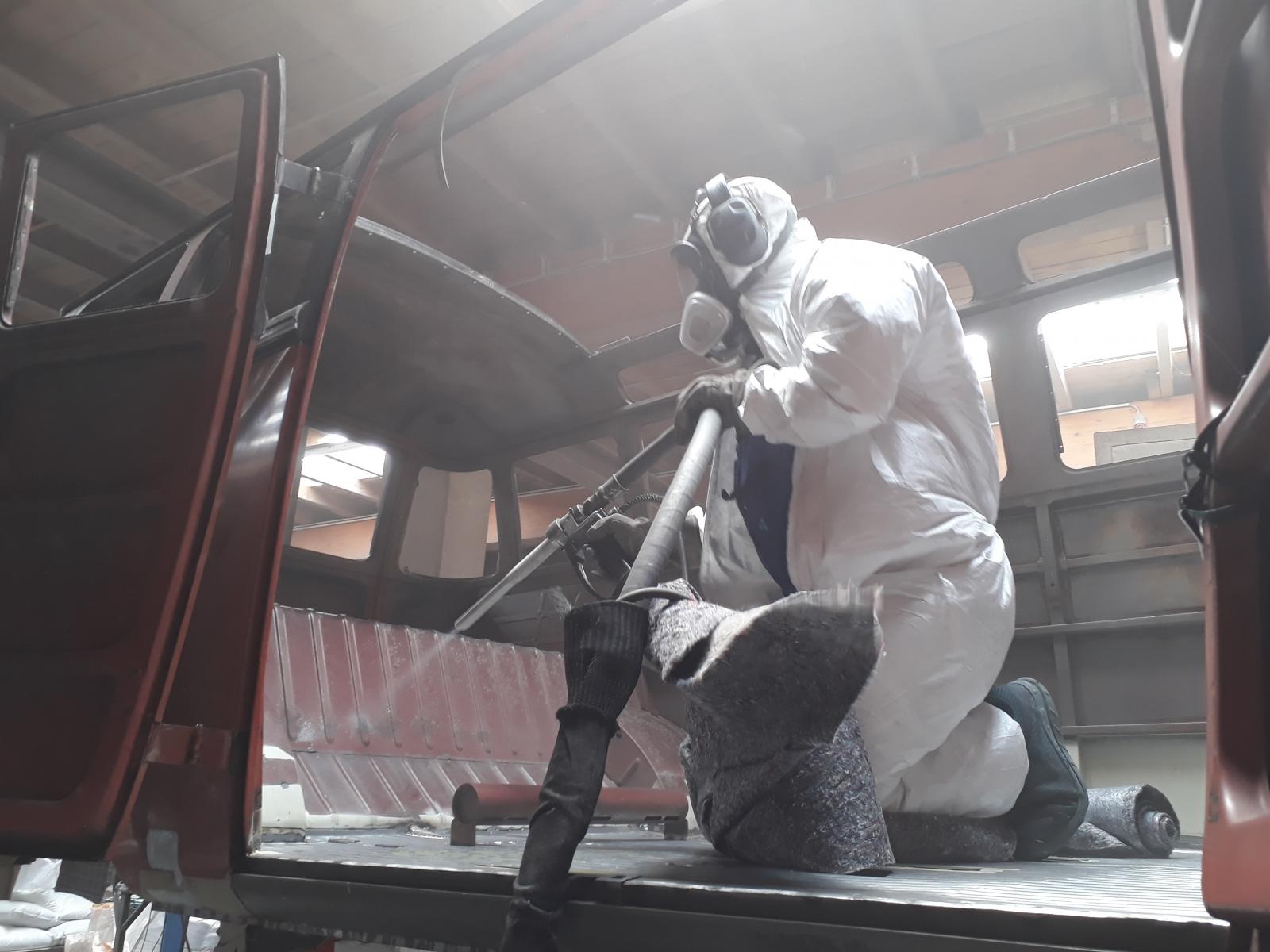

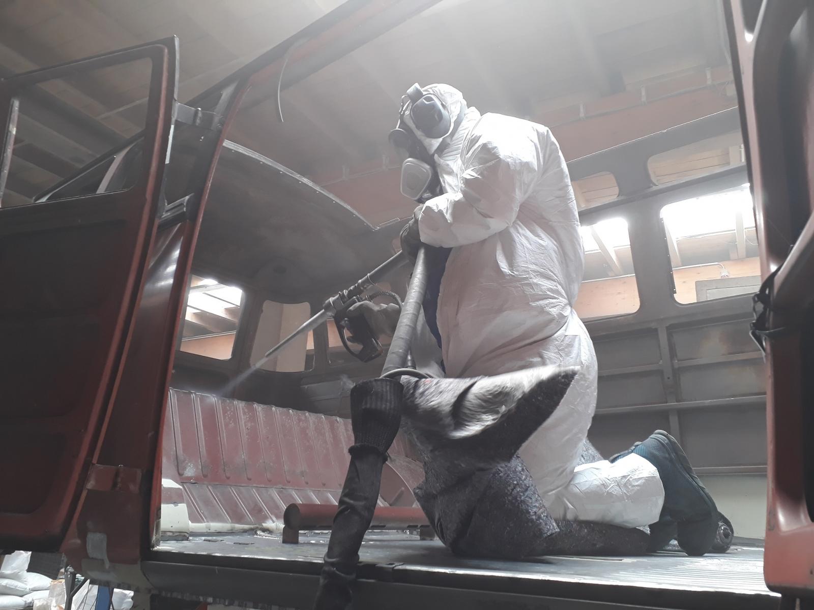

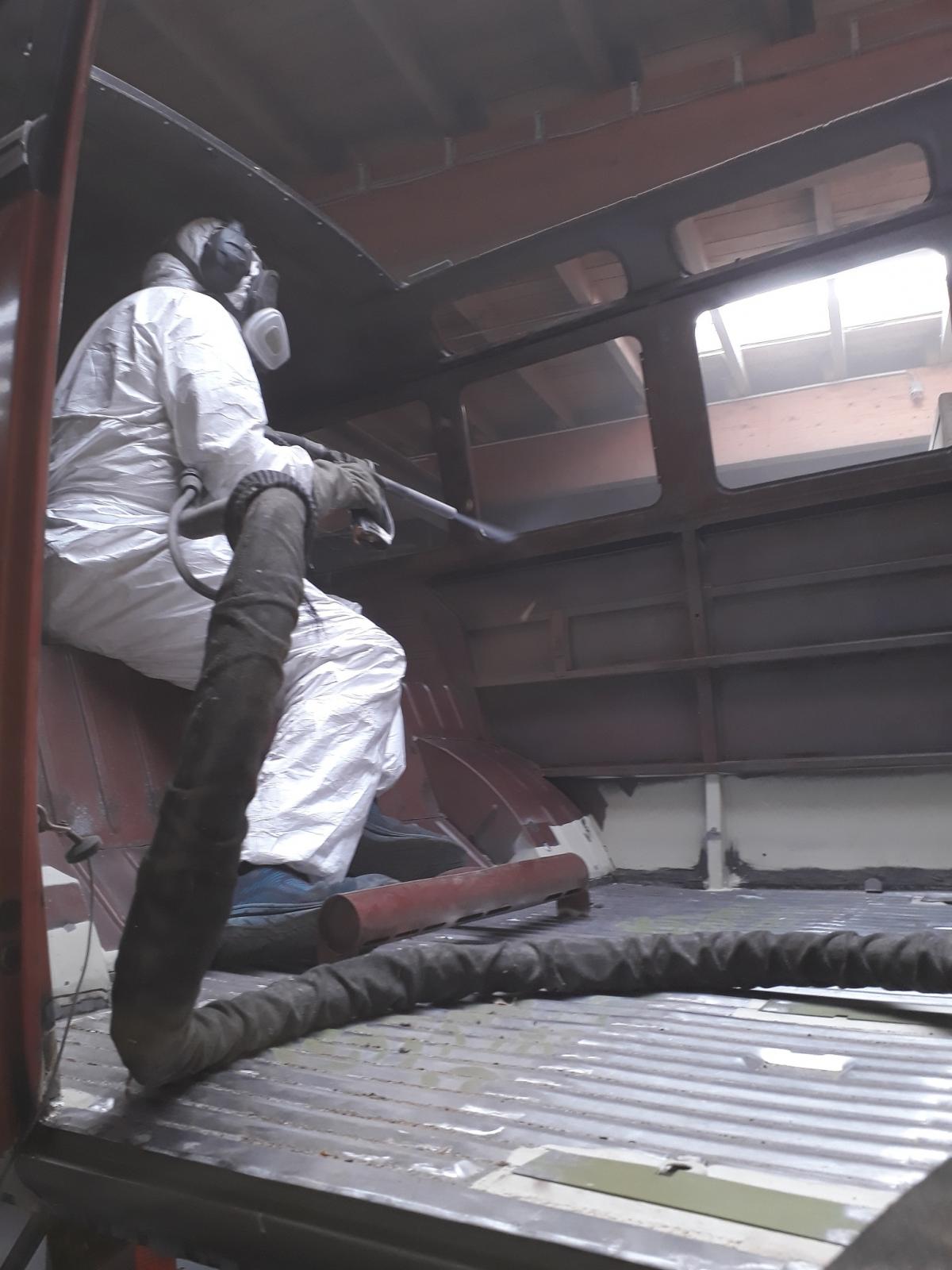

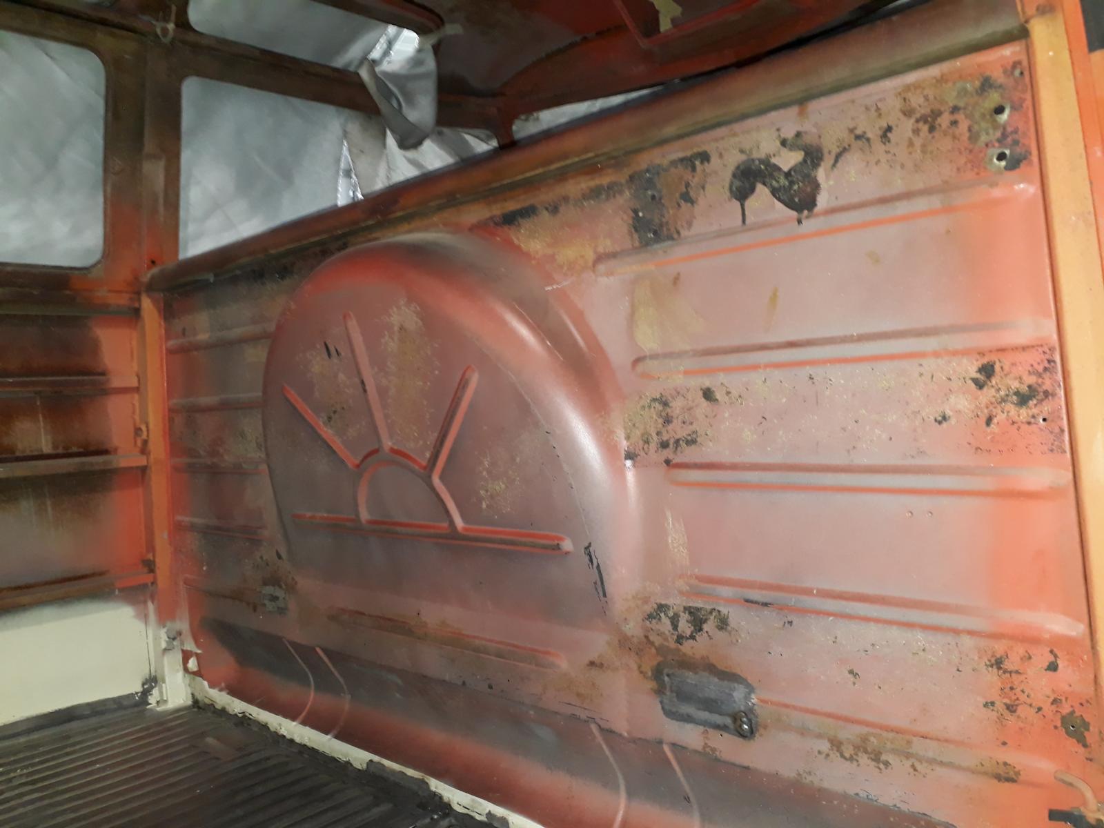

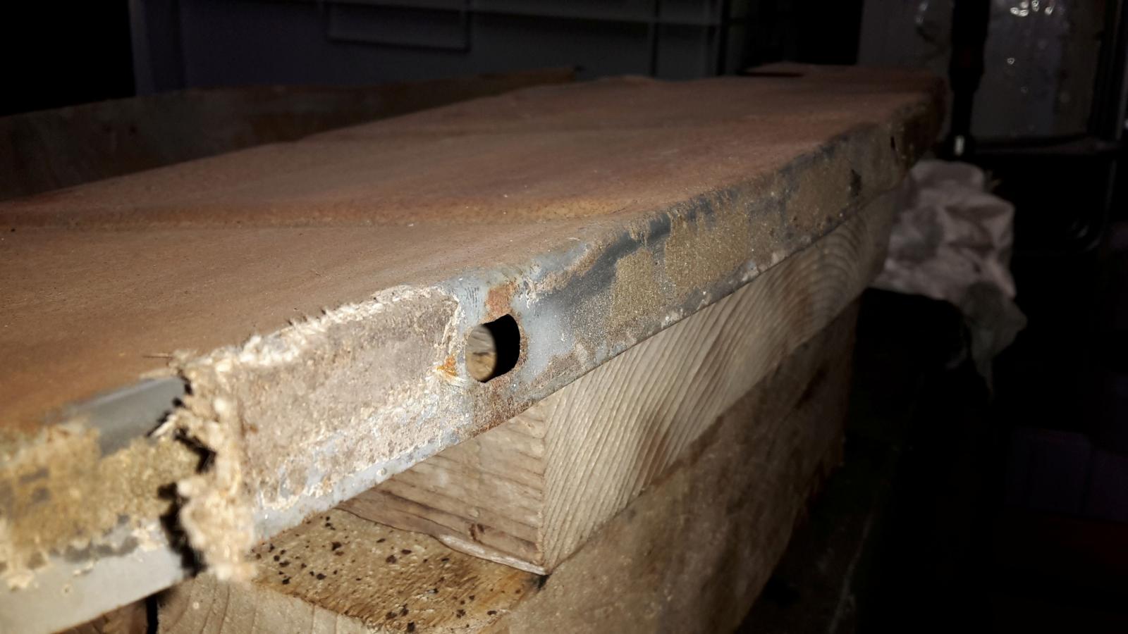

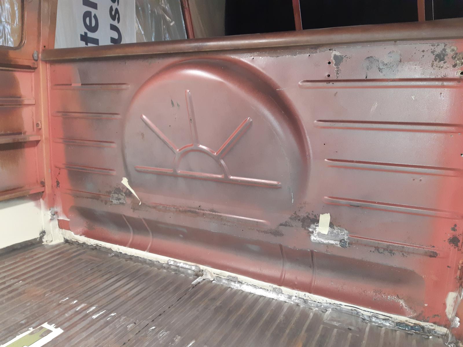

The next point on my to-do-list was removing the remaining adhesive residue inside the bus.
It was still present in the areas of the ceiling, around the windows, the luggage-compartment, the dividing-wall between passenger- and driver-area and the sheet-metal were the sun-visors are mounted.
The upholster deserves a clean and smooth surface Very Happy
No chance for little bumps which may occur later on under the new interior-material.
I already tried to remove the old glue with different tools, chemicals and efforts.
But there was no chance: It was too resistant and time-consuming without resounding success.

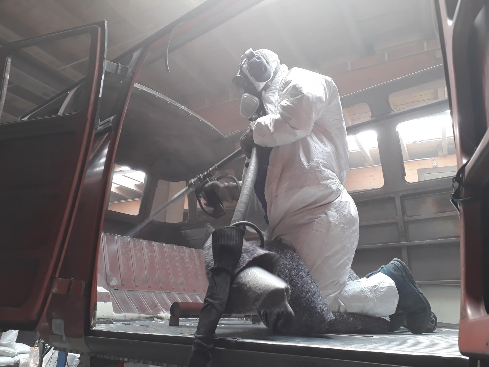

More abrasive methods would have damaged the original paint. The solution: An ice-blaster Cool

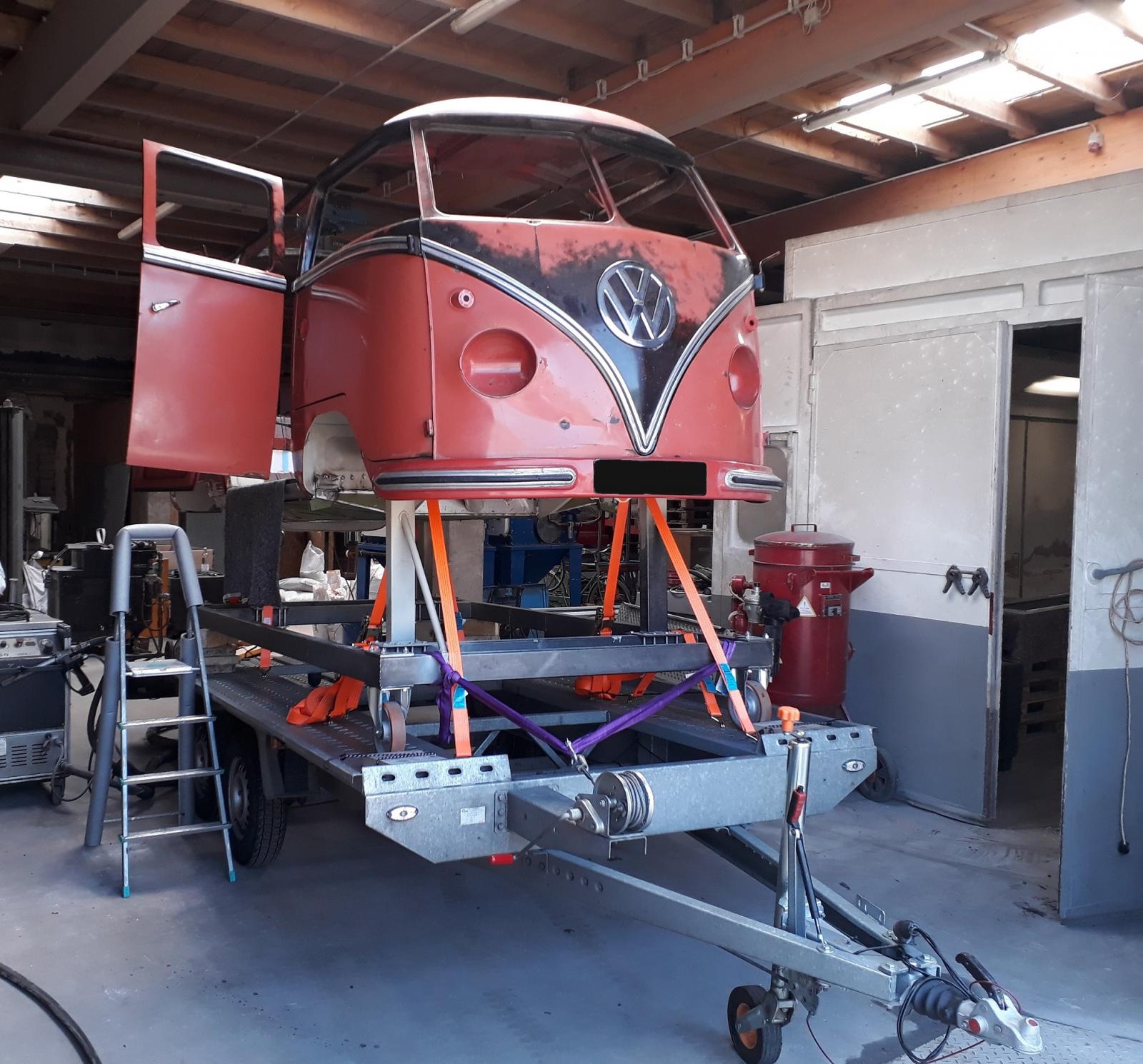

After picking up the bus at the coachbuilder’s workshop, a little detour was made by visiting the ice-blaster …
Until that day, I have read a few reports in vintage-car-magazines about this technique and had no idea how it is to ‘enjoy’ this happening ‘live and in colour’.
It was extremely loud and so windy like a hurricane …
After that treatment the glue was removed. Here is for example the dividing-wall before and after …
One additional good news: During the ice-blasting appeared suddenly pieces of the headliner-material and its piping.
The complete treatment took about 45 minutes.

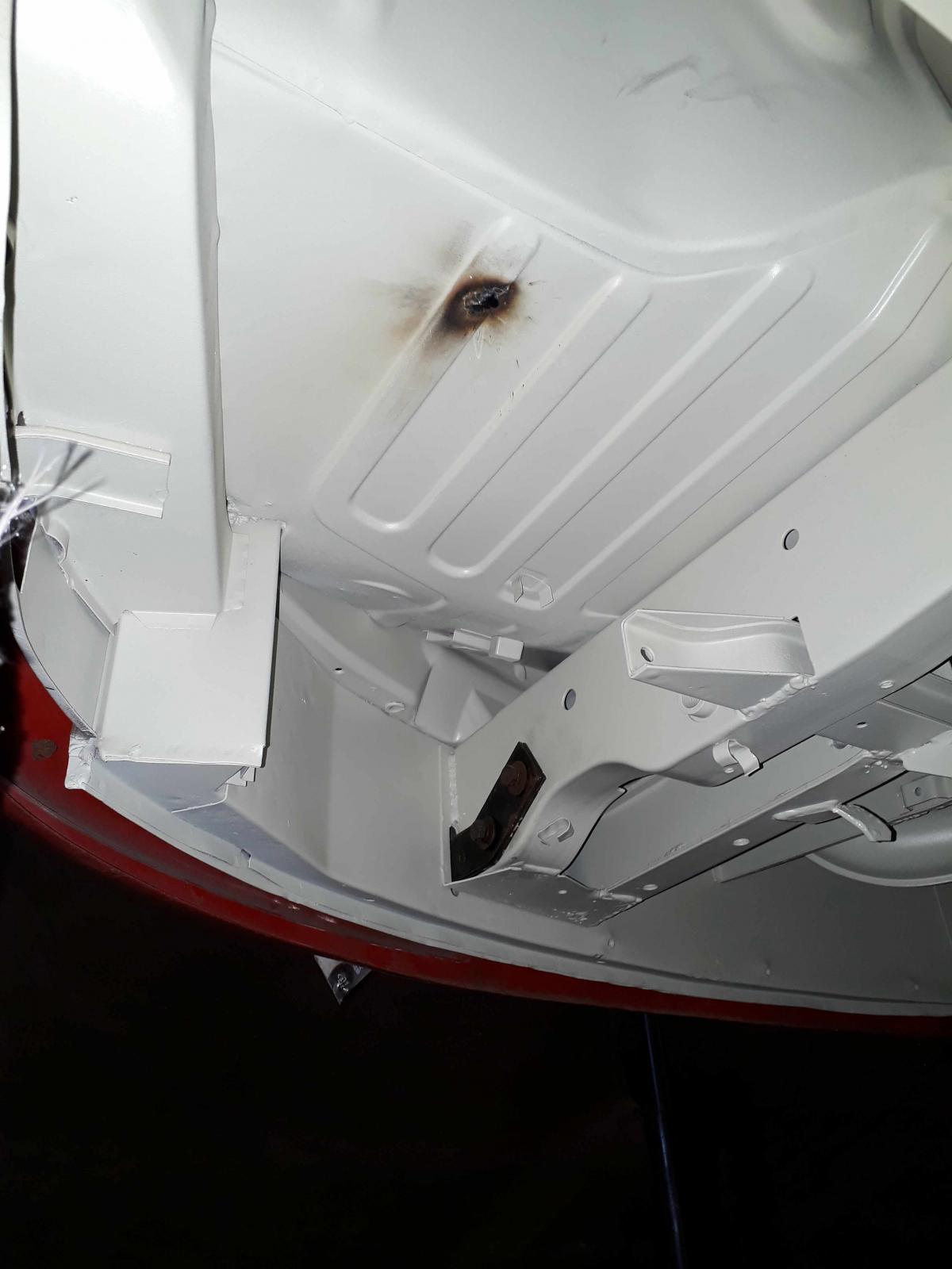

… and during this work I saw the passenger-floor with the unattractive points Rolling Eyes

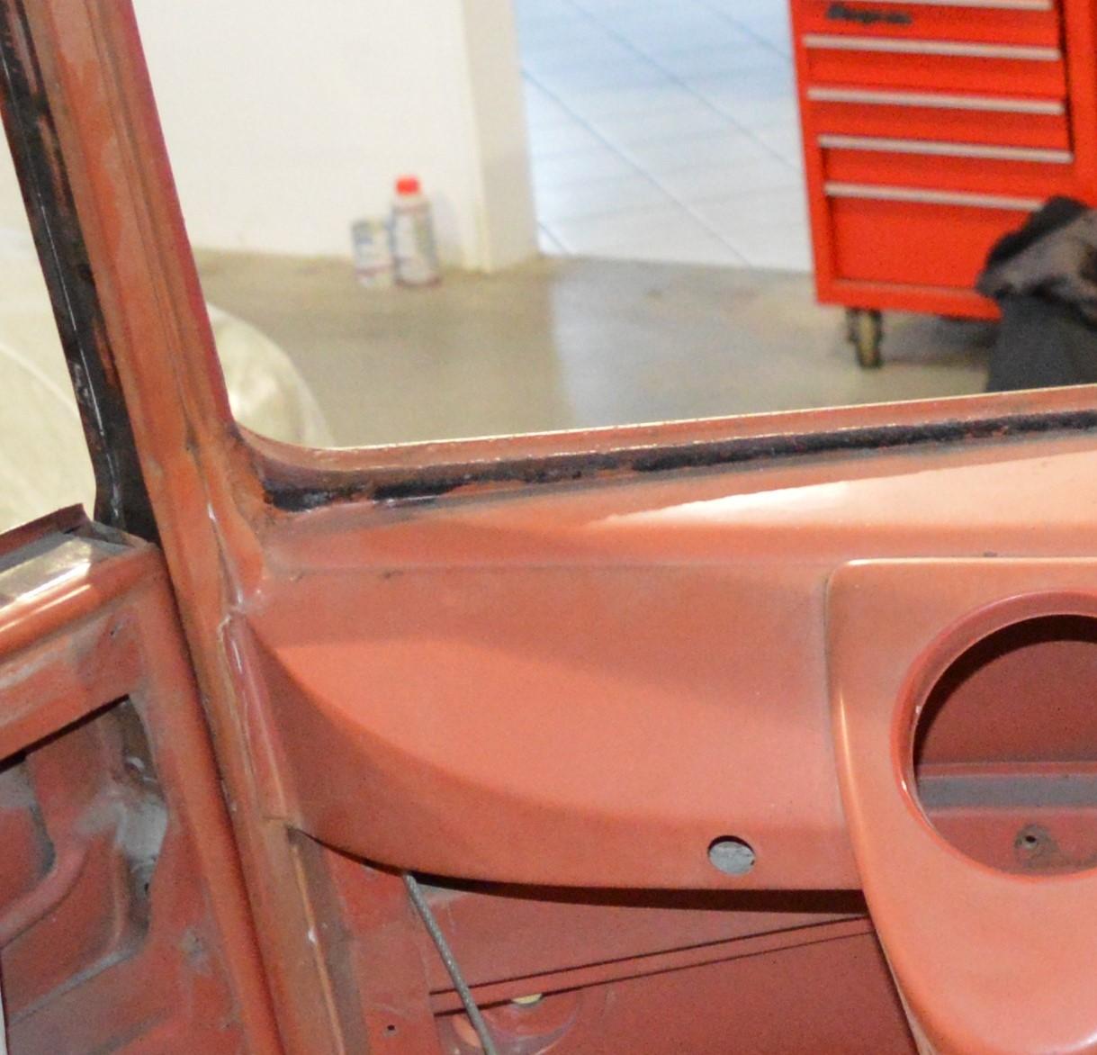

Although the scope of work was discussed in detail with the ice blaster before he started, he made a mistake:
He treated 2 areas at the dashboard although there was no glue there at all, which would have had to be removed.
Because of that there is now in 2 corners a little bit original paint missing.
Left corner before and after …
Right corner before and after …
Let’s call it additional Patina Confused

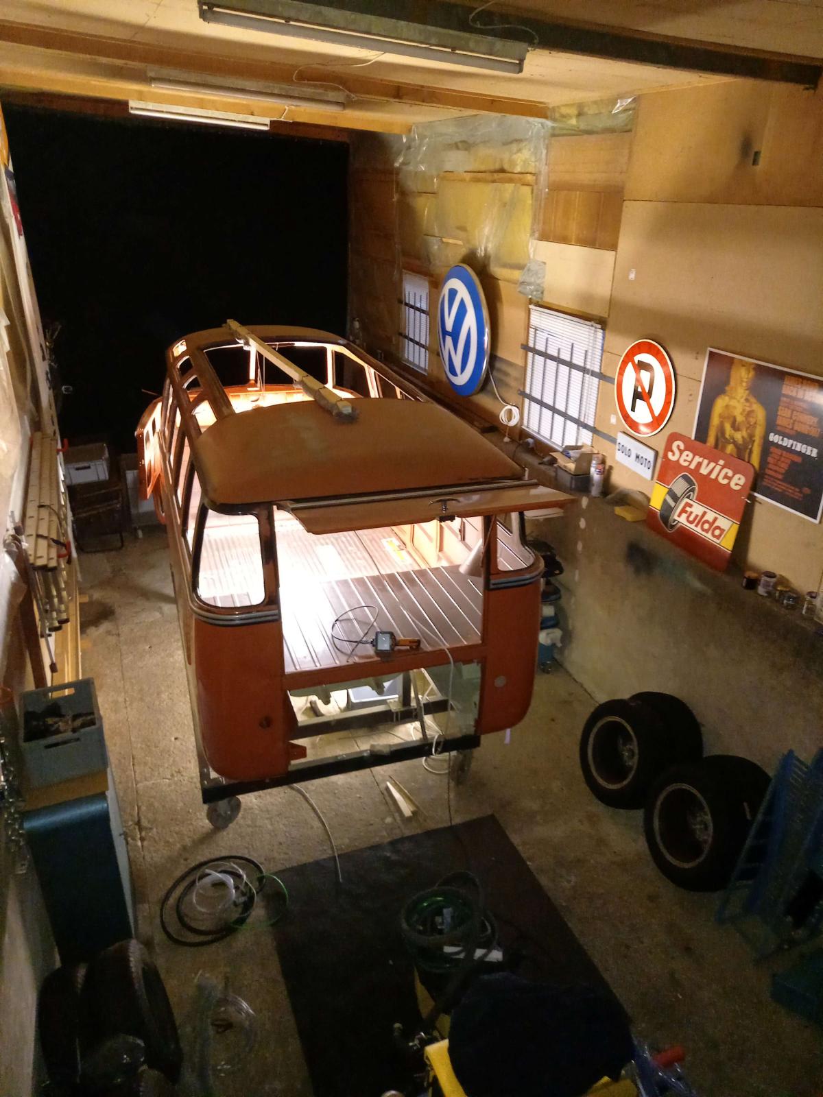

O.k., back in my workshop.
To be honest: Without the hint of the painter and the magazine-report, I would have kept the cavities as they were.
Just protect them before the sandblasting with a lot of masking-tape and foam. This is just an example of the engine-compartment ...
Otherwise no special attention, just control the areas from outside by knocking:
If they sound good and still make a strong impression, no additional efforts needed.
And after finishing the restoration fill the cavities with a lot of wax.
I would never have thought that there would be so much old dirt inside! Shocked
So, thanks to the painter for driving my attention to the ’neglected’ cavities and their inside condition.

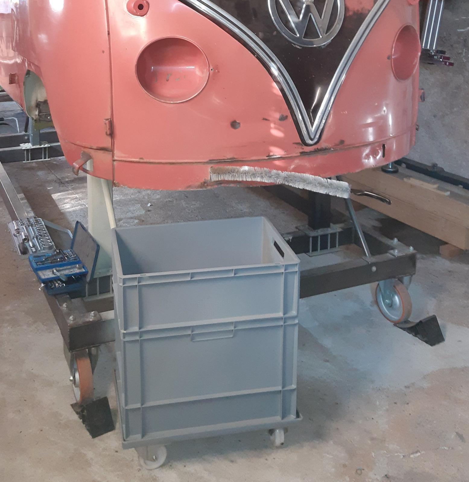

First of all, the cavity in the front-nose-panel behind the bumper was cleaned with brushes and the vacuum-cleaner (… he was my best friend for hours and days …).
… about 650gr. (= 23 oz) old dirt was removed. Now this cavity is completely clean …

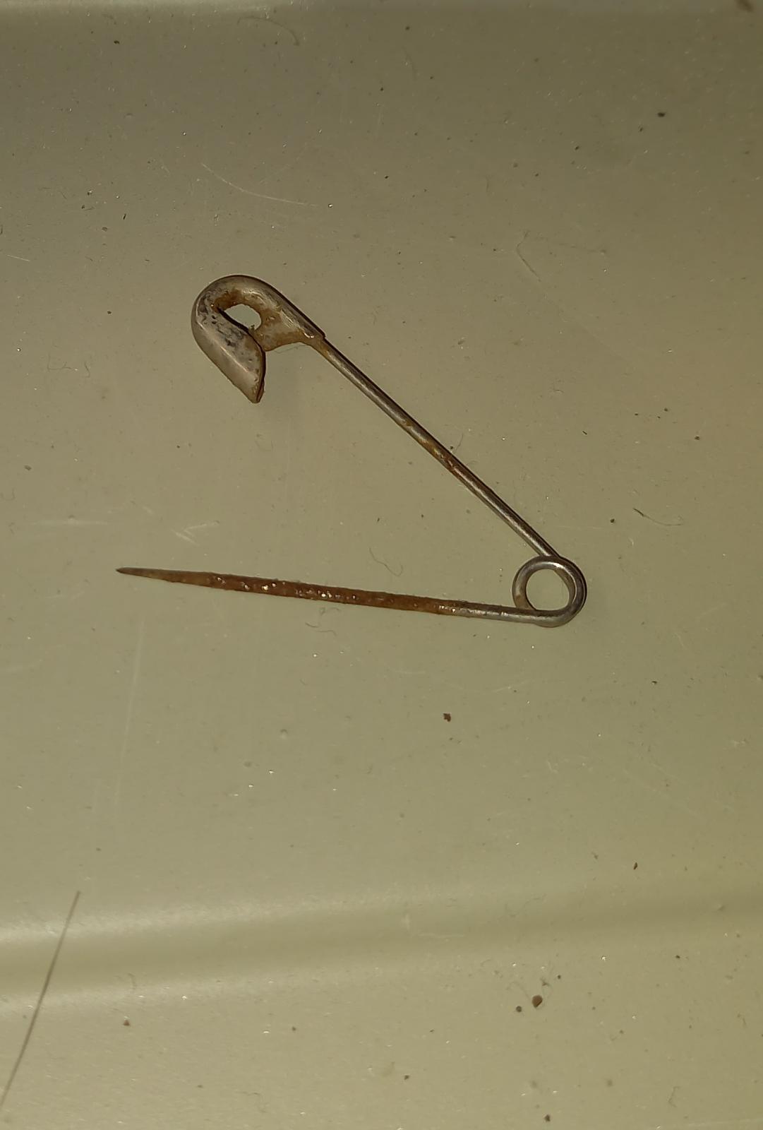

The dog-leg-cavities under the driver- and co-driver-doors had a lot of little stones inside …
The cavity between the front-nose-panel and the floor-pan of the driver- / co-driver-area was cleaned too ....
... a safety-needle and an old piece of printed paper was found ...

… by the way: During this work I saw again the passenger-floor with the unattractive points Rolling Eyes

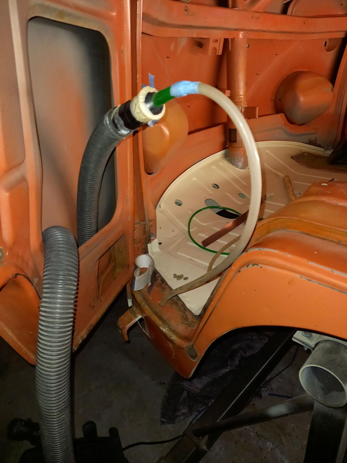

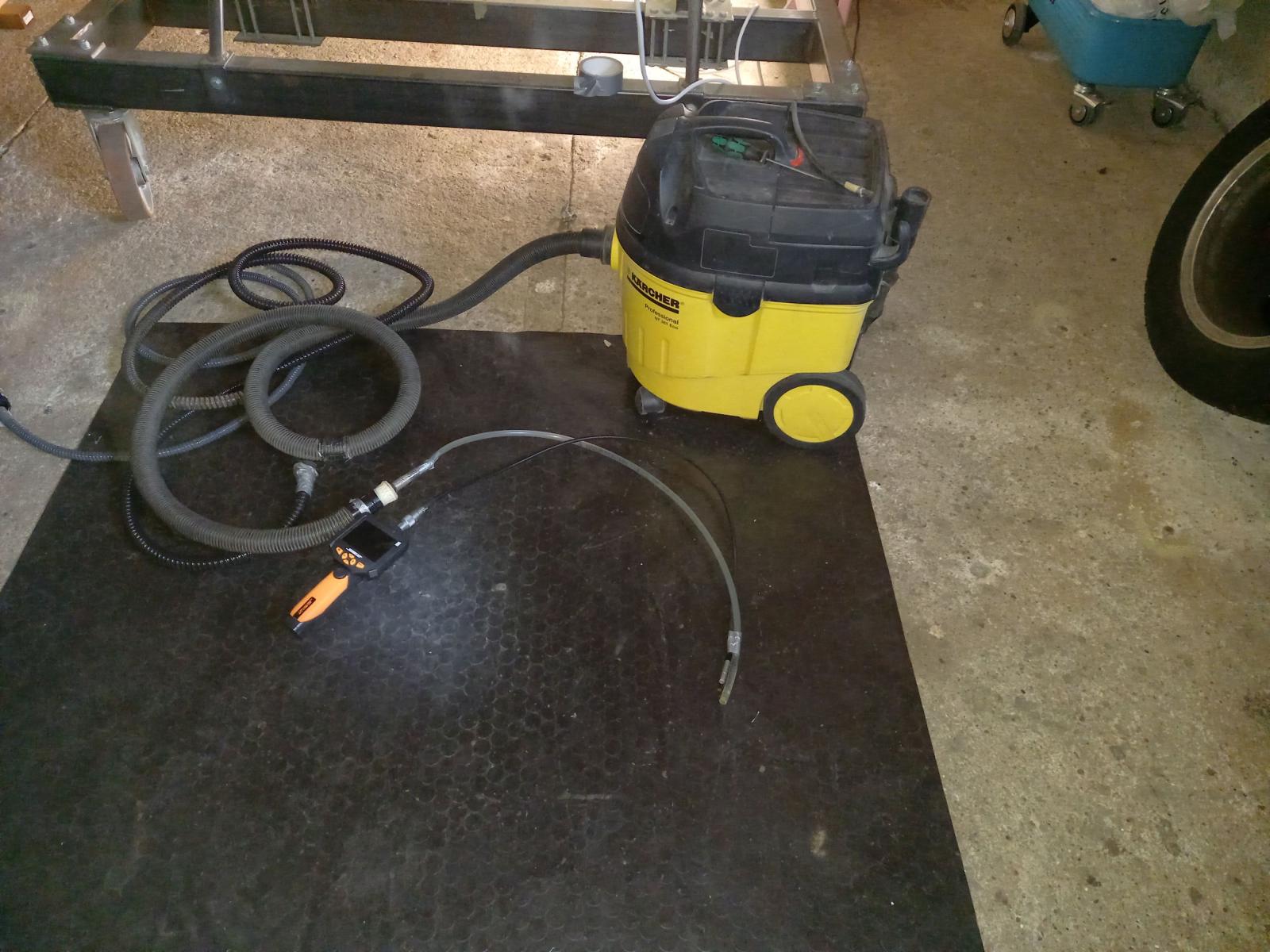

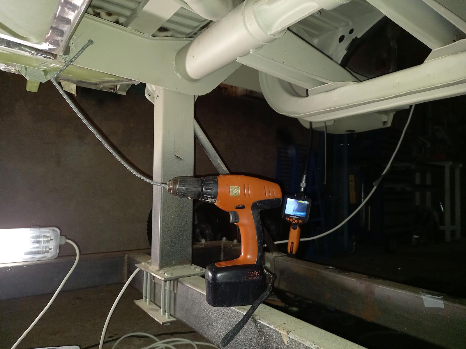

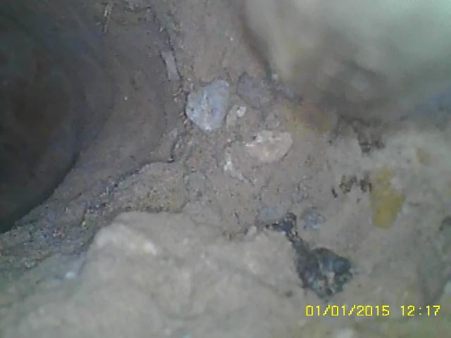

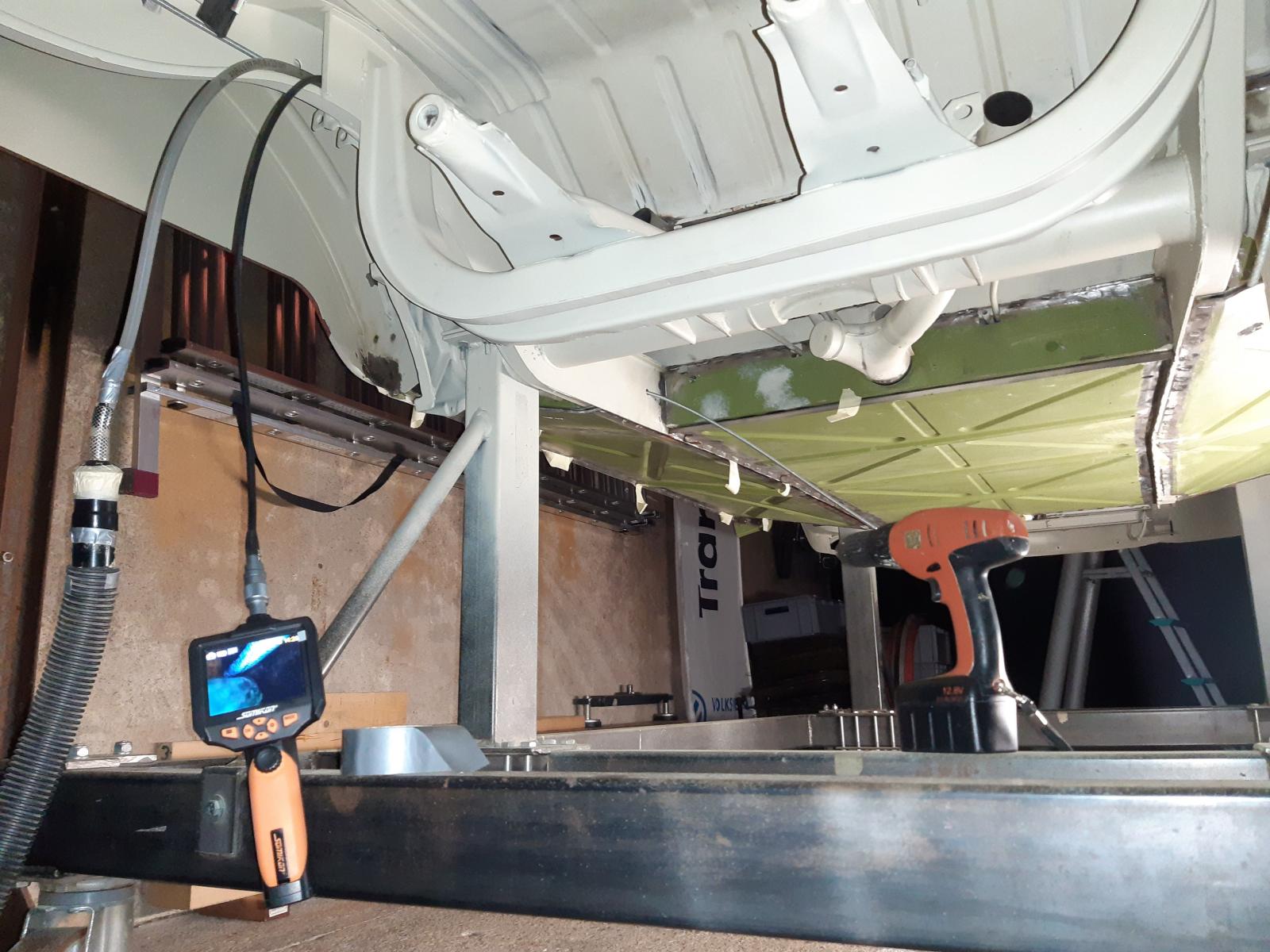

All the large cavities were cleaned. But what about the heater tube?
The heater-tube in the double-floor-section was renewed, but the remaining section to the front was still the original one.
Of course this section should also be inspected like the rest.
It was on my to-do-list before the middle-tube-section was installed, but I forgot Rolling Eyes
So I had to do it more complicated via the air-outlet under the dashboard.

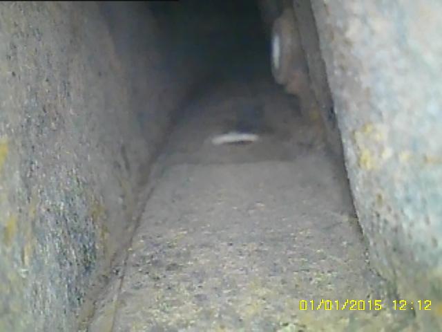

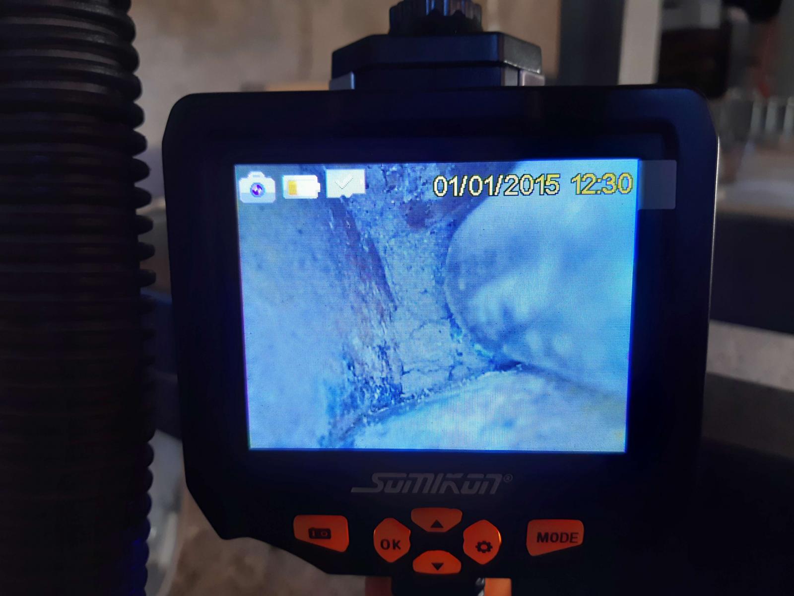

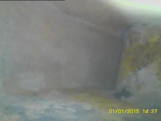

A first look inside the tube with the endoscope-camera offered just a view to a layer of sand and dirt.
So, my best friend – the vacuum-cleaner – started to be busy again …

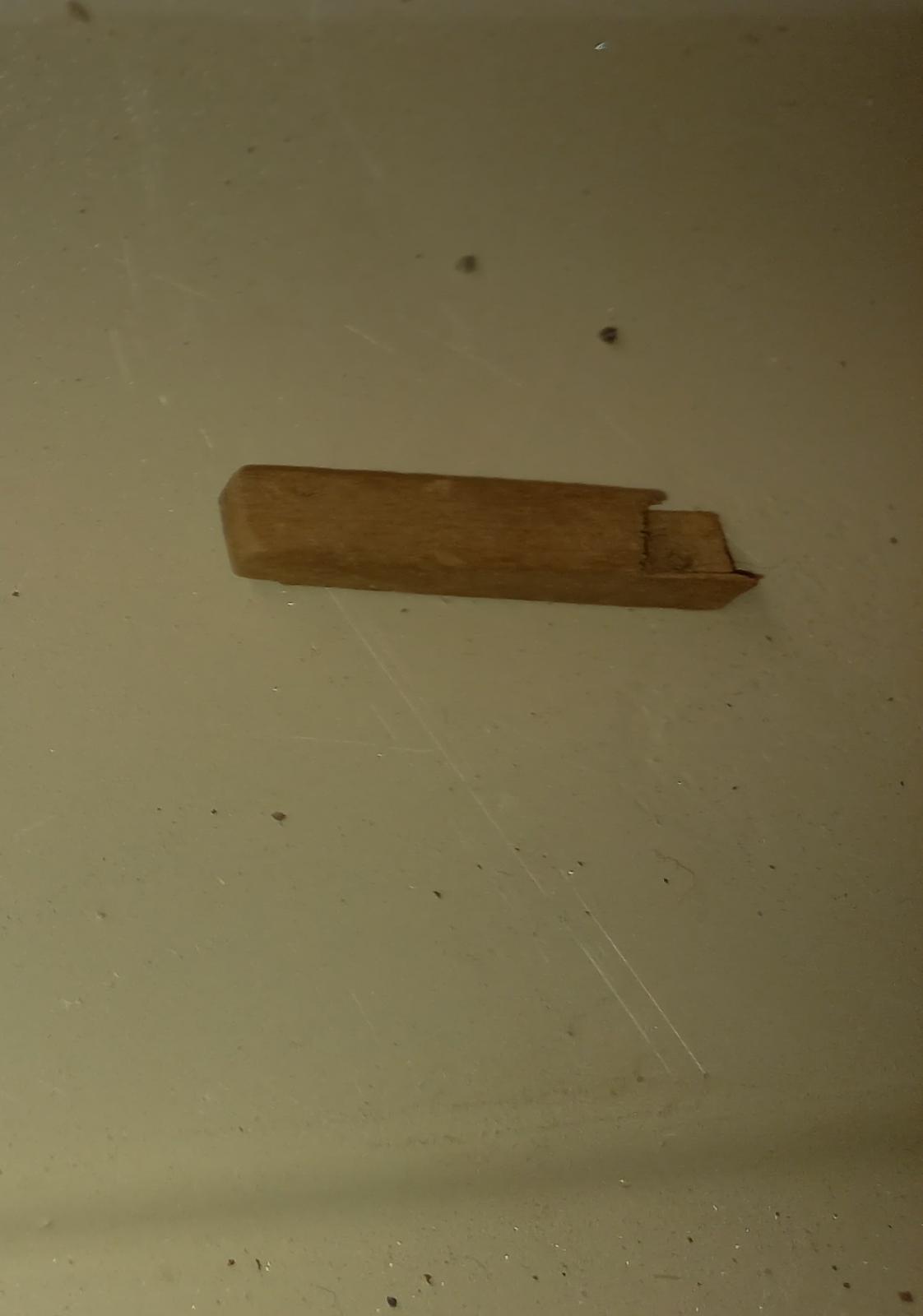

After the first 10 minutes one additional security-needle was in front of the clogged cleaner-tube ...
… later on a small piece of wood with perfect edges and a little hole …
… and I was wondering why such a piece of wood is inside the heater tube and to what it belongs to?
Later on, the cleaner tube was clogged again.
This time by a dirty and small bended piece of wire.
Removing the dirt and inspecting it in details I realized that is was a little Jesus-figure …
I’m sure you can imagine how excited I was about this find Very Happy
Now it was obvious that the small piece of wood is part of his cross.
After this sensation, the tube was controlled again with the endoscope-camera.
Until then, most of the sand and dirt was removed.
But now a blue piece with a golden middle appeared.
Do you have an idea what it is? A rare piece of plastic? A penknife? Golden coins?
To build up a little bit suspense, the riddle will be solved in the next post ... Very Happy

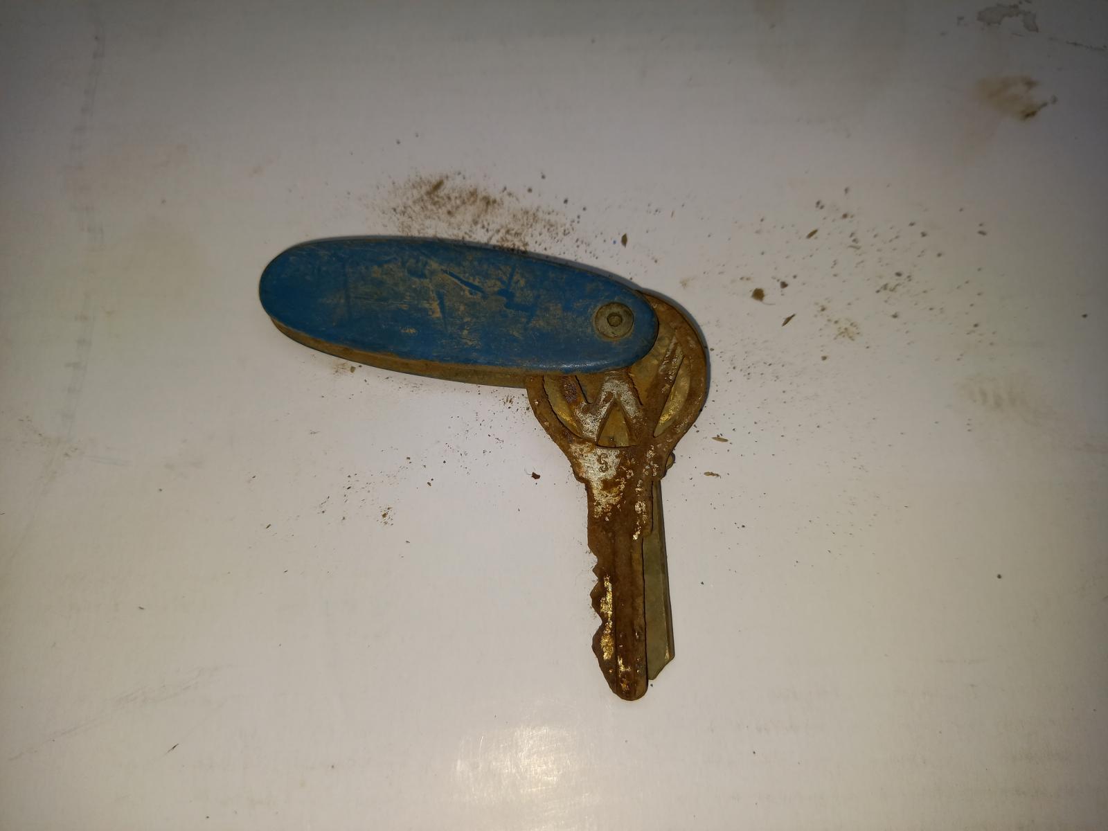

…. here is the solution of the riddle Smile
After fishing about 1 hour in the heater-tube with different tools, tubes, magnet, gripper, etc. the mysterious item was get out.
Finally my patience was honoured with ……
.. the original keys of this bus Very Happy
Without a question, this treasure-hunt belongs to the ‘ups’ of this project.
To get the heater-tube completely clean from the front to the back, a brush with a long extension - that is normally used for cleaning chimneys - was pulled, pushed and rotated numerous times through the heater-tube.
The vacuum-cleaner finally picked up the rest of the dirt.
To make sure, that no treasures got unnoticed into the vacuum-cleaner during the process,
the complete content of the bag was checked afterwards in every detail.
But no additional items were found (… no idea where the missing remains of the wooden Jesus-cross have gone?)

BarryL is offline
PostPosted: Mon May 19, 2025 6:26 pm    Post subject: Re: Nice bus, even nicer sister Reply with quote
Do you think that stuff went down the deflector holes or up top at the defrost vents?

PostPosted: Mon May 19, 2025 8:08 pm    Post subject: Re: Nice bus, even nicer sister Reply with quote
Would first suspect Mark Watney..... Laughing

PostPosted: Tue May 20, 2025 11:48 am    Post subject: Re: Nice bus, even nicer sister Reply with quote
Hello Everett,
only heaven will know ... Very Happy

That's great you found the original keys
Heaven? Eaten by small animals? Disintegrated over time?

PostPosted: Tue May 20, 2025 11:50 am    Post subject: Re: Nice bus, even nicer sister Reply with quote
Hello Matthew,
many thanks for your interest Very Happy
____________
benjamin

PostPosted: Tue May 20, 2025 11:52 am    Post subject: Re: Nice bus, even nicer sister Reply with quote
Hello Barry,
I’m sure that the items disappeared through the defrost vents.
Even if one of the pre-owners was very clumsy, there is no chance to get it unintentionally through the deflector hole (… although: I would probably manage it Razz ).
_____________
benjamin

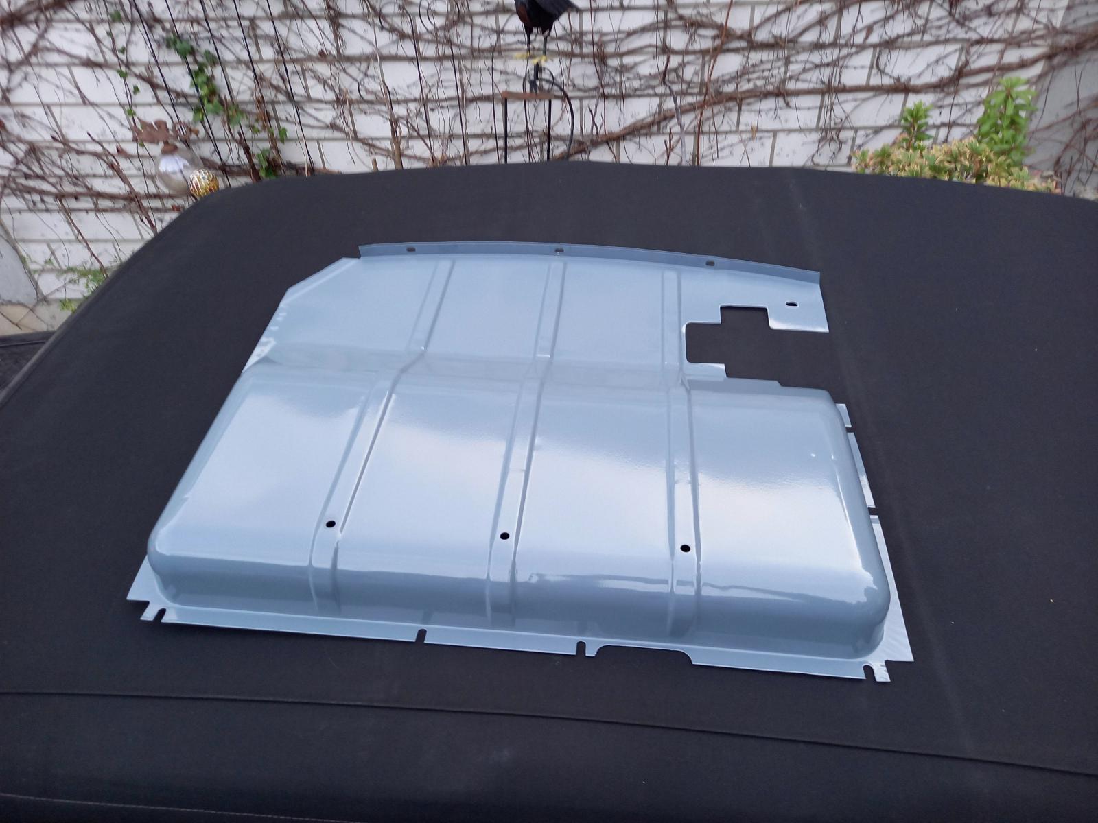

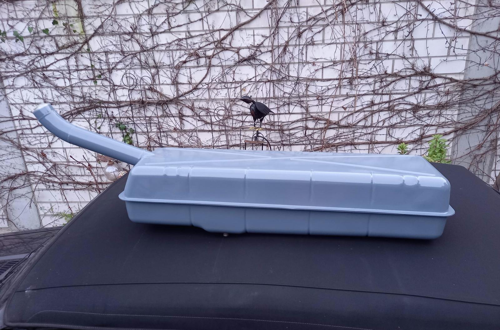

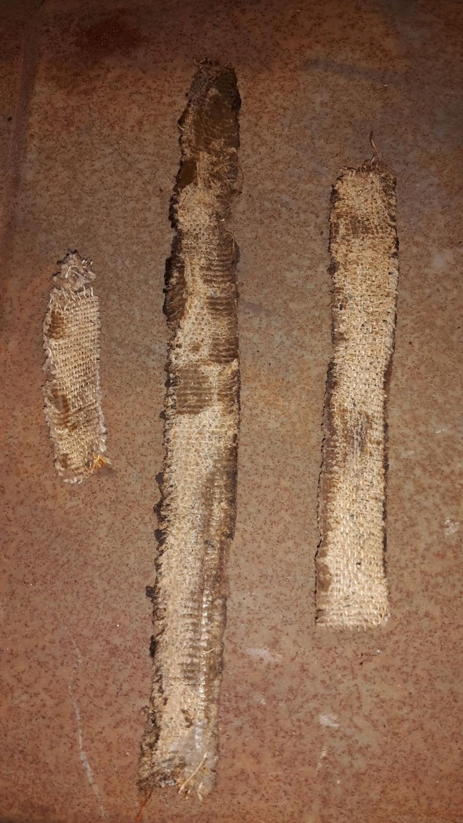

After this exciting treasure-hunt in the cavities, it was time for something less spectacular (and without any vacuum-cleaner-noise Wink )
To prepare the splashpan for the sandblasting, the old insulating-strips were removed and the correct fit was checked ...
The colour-tone seems to be the same like the fuel-tank (near to RAL 7031 ‘Blaugrau’) ...
After sandblasting, the splashpan and the fueltank were finished by the painter and look like new Very Happy
_____________
benjamin

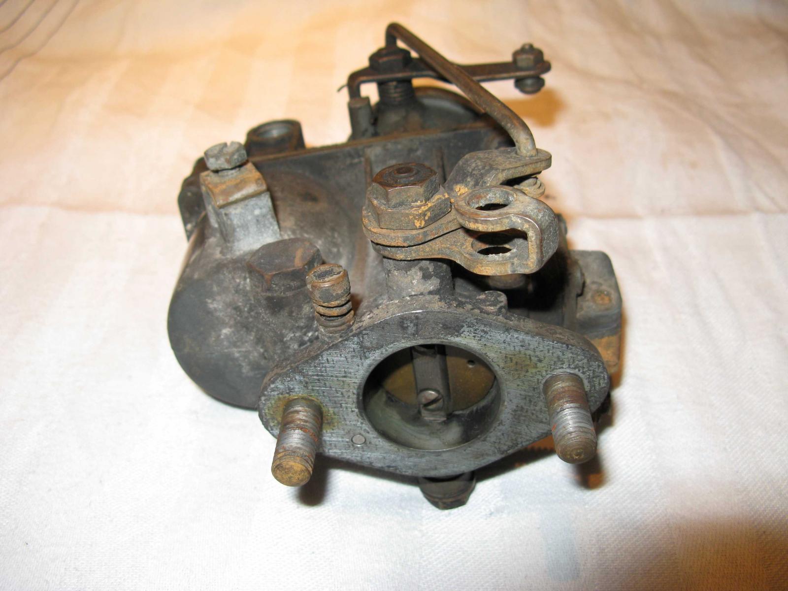

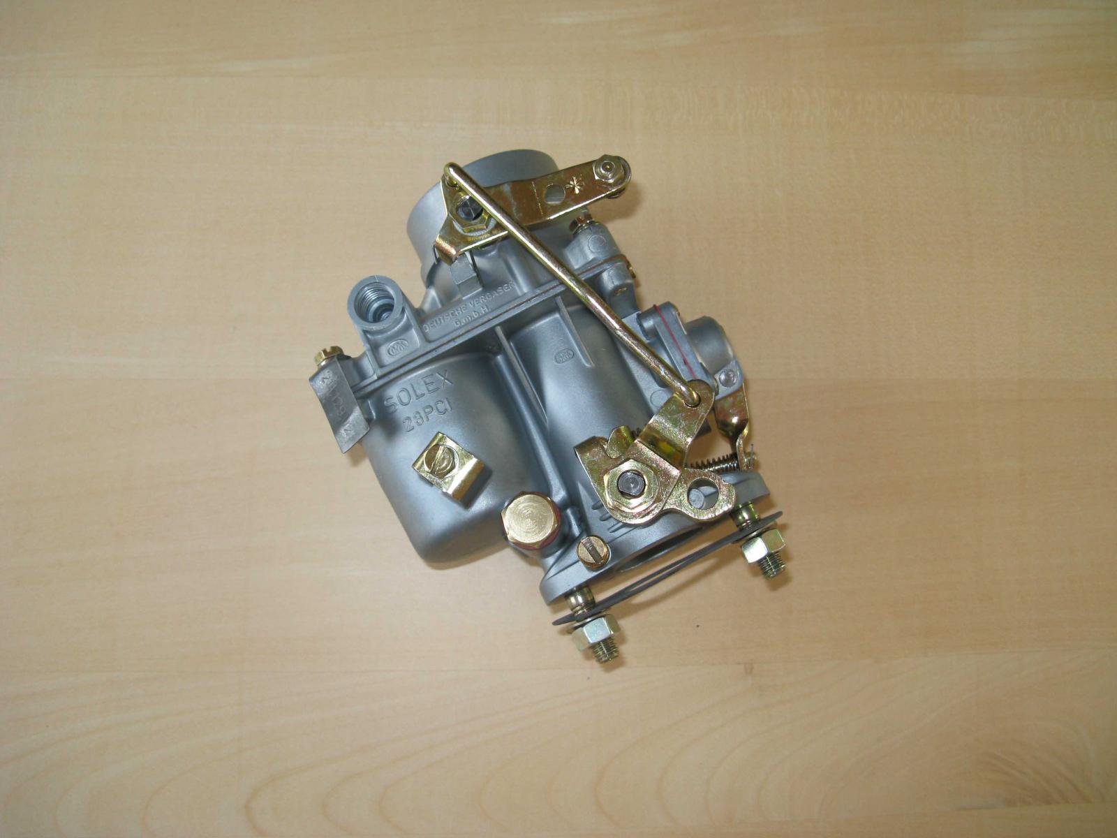

The 34hp-engine which came with the bus was not matching to the builtyear.
Fortunately a 30hp-engine from 1957 was found in the Netherlands, but it was incomplete and in a poor condition, as was the carburator (Solex 28 PCI).
So first of all the carburator was given to a professional workshop and they made a perfect job.
Here are the ‘before and after comparison’-photos …
_____________
