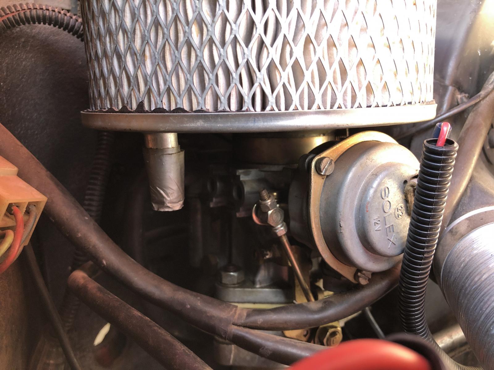

PostPosted: Mon Nov 11, 2019 6:22 pm    Post subject: Re: Official Dual Carburetor How To Thread Reply with quote
Is there any reason my recently acquired ‘73 ghia would have dual solex carbs with only the right having an accelerator pump? Also, any reason not to hook up the the hose from the charcoal canister?
oprn
Joined: November 13, 2016
Posts: 14555
Location: Western Canada
oprn is offline
PostPosted: Sat Dec 21, 2019 7:16 am    Post subject: Re: Official Dual Carburetor How To Thread Reply with quote
I quite honesty have never heard of an automotive carb without an accelerator pump. Yes you need one on each carb or it will stumble and fart bad when you get on it!
