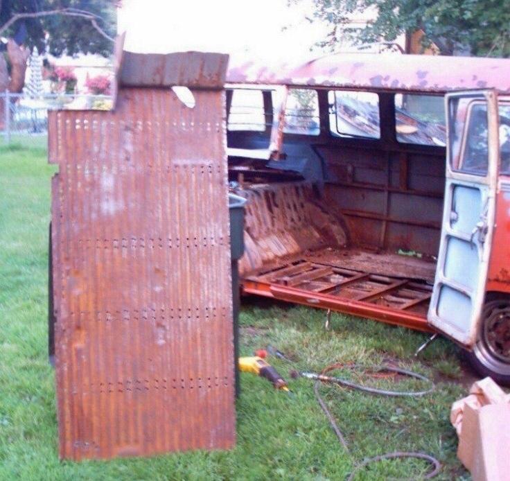

PostPosted: Wed Aug 13, 2008 6:58 am    Post subject: Reply with quote
Glad you tried and had success with the TEK type self tapping screws... Some think I am crazy when I suggest them but they work really well on the VW small spot welds on the thin metal these cars are made of.
*The cheaper brands at the big box store are not as good as ones you get from a "real nut/bolt/hardware or metal building supplier... that 's the thing to watch out for is GET GOOD ONES.
I was replacing the front header/core support on a Mercedes 300E that had been in a front ender
I had to drill out about 50 + BIG FAT spot welds all around the damn thing(s) both on the donor clip and the car. I was using the TEK screws but the spot welds needed to be hogged out to 1/2" Shocked So I had been using the TEK for starter hole and then hitting again with a drill... it was taking WAY TOO LONG out in 100 degree heat. So... I found some "Uni-bit" deal like this at the local flaps for 9 bucks. Suckers work very well...
