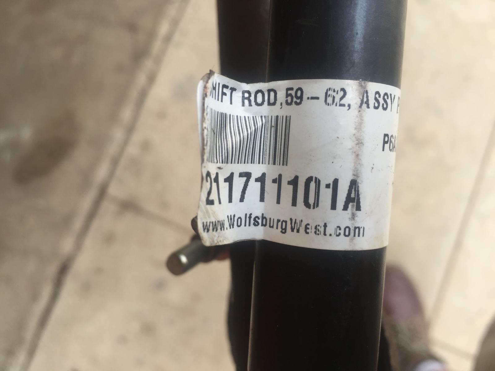

So does Wolfsburg West have this Wrong??? they told me at the counter that this is correct for my 61 but the inside diameter hole is smaller than the shifter ball.. my old one on the right out of my bus

PostPosted: Mon Feb 20, 2017 6:32 pm    Post subject: Re: Shifter differences Reply with quote
Yes they made a mistake, hard to believe

PostPosted: Mon Feb 20, 2017 7:28 pm    Post subject: Re: Shifter differences Reply with quote
Weird part number. Your part should be 214 711 155. The part that is pictured is '66-'67 and should be numbered 211 711 155 C. However Wolfsburg West may have made a universal one that goes from '62-'67. It's still not the '61 correct one for you.

PostPosted: Mon Feb 20, 2017 8:33 pm    Post subject: Re: Shifter differences Reply with quote

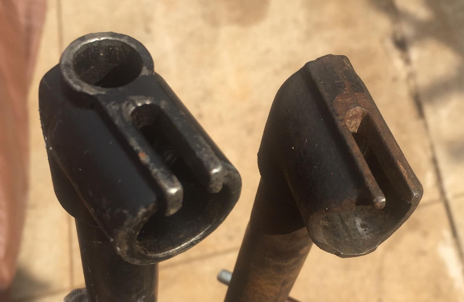

Appreciate the info but if it were a 66-67 shift rod then why does it have the early style end for the 62 and earlier coupler?
Anyhow, after we debated back and forth at the counter he went and got a second opinion from an "expert" and came back. "yup, its correct for a 61" Confused
By the way.. much props to WW. Just trying to clear this up.

PostPosted: Tue Feb 21, 2017 10:11 am    Post subject: Re: Shifter differences Reply with quote
I could easily be wrong but I got the info from the parts book website. I assume your bus vin falls into the '61 year model.
I can't see the other end in the photo but that hole on the front is for the '66-'67 style pivot as those years didn't use a bracket with tensioned plastic guide/anti-rattle.
The acid test to me is that your ball won't fit his hole. Did you take your shaft with you?

PostPosted: Tue Feb 21, 2017 11:49 am    Post subject: Re: Shifter differences Reply with quote
Thanks Baryl. No did not have the old parts in hand the first time assuming they would have the correct parts. Lesson learned..
The descrition itself on the label 59-62 seems to be wrong as well? Crossing over into different years?

PostPosted: Tue Feb 21, 2017 1:15 pm    Post subject: Re: Shifter differences Reply with quote
I've never had to deal with early rods but something is awry. See for yourself. Parts #11 or #12: http://oacdp.org/5867part/359.png

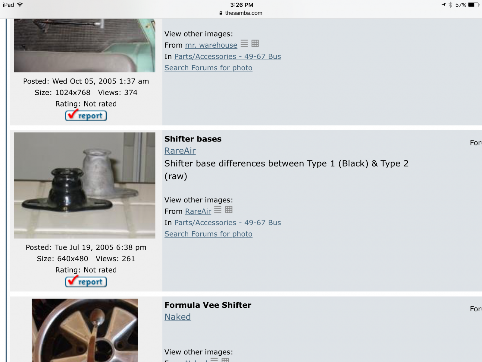

Everett wrote:
Early straight shifter ends:
http://www.thesamba.com/vw/forum/album_page.php?pic_id=533921
Shifter from my '55:
http://www.thesamba.com/vw/forum/album_page.php?pic_id=518622
'61 Kombi shifter with ruler:
http://www.thesamba.com/vw/forum/album_page.php?pic_id=233441
Everett posted this on the page before but I can't tell ball size.

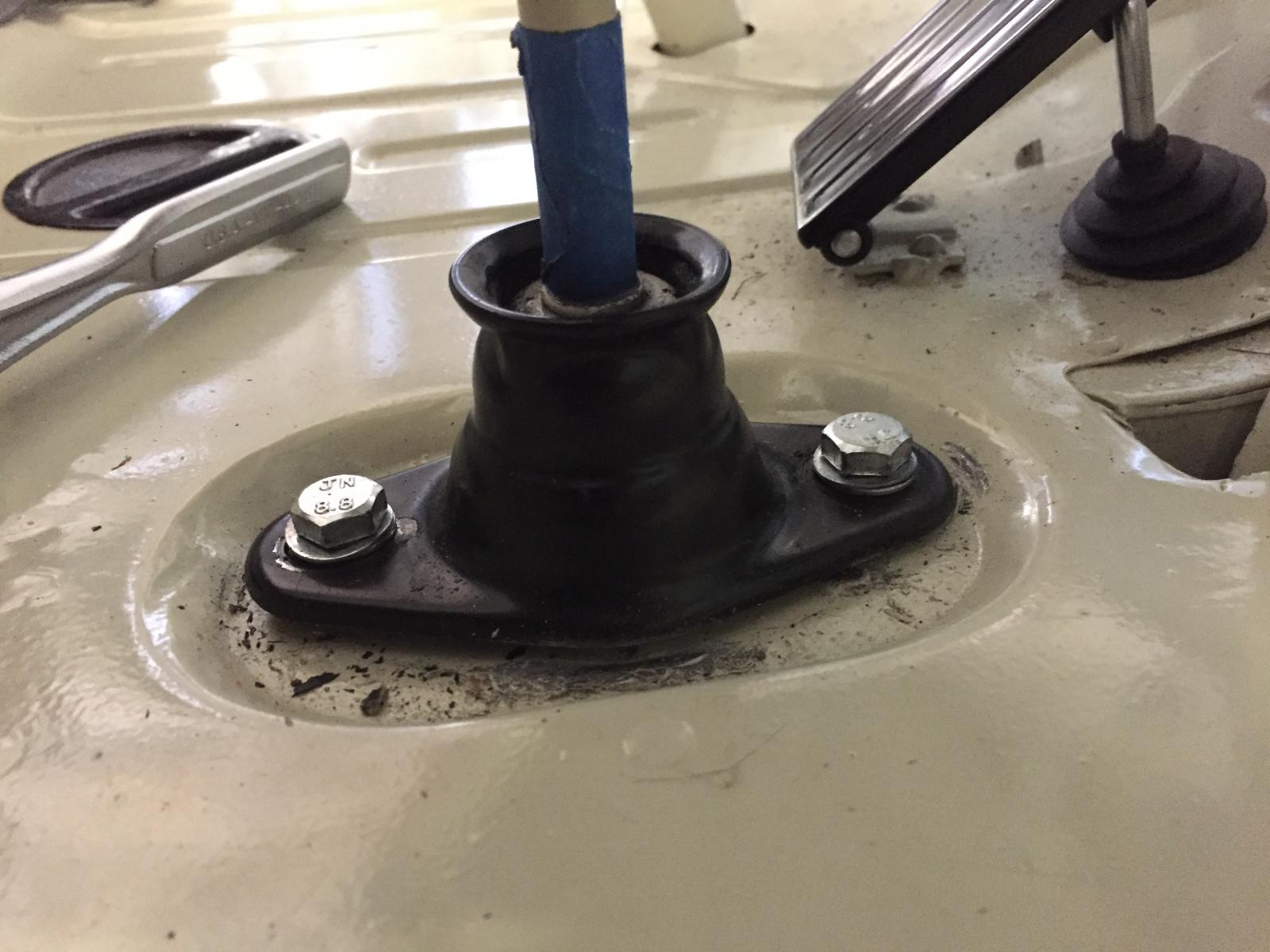

PostPosted: Sun Jul 30, 2017 3:51 pm    Post subject: Re: Shifter differences Reply with quote
Do I have the right shifter base on my early 64 bus? I'm thinking I don't based on a gallery pic from @RareAir. Accordingly to the gallery pic, I have a type 1 base, not a type 2. Can anyone chime in? Thanks,

PostPosted: Mon Jul 31, 2017 8:47 am    Post subject: Re: Shifter differences Reply with quote
My early 64 has the higher base. What you have may work but your reverse lockout will not so finding first will be a pain. Also it may damage your linkage if it is putting too much force down.
If that came with your bus you may also have a modified shifting lever or linkage.
edit: You could space the base up off the floor the difference in height to get by until you find the correct one.

PostPosted: Mon Jul 31, 2017 12:21 pm    Post subject: Re: Shifter differences Reply with quote
sgellis wrote:
OK, thanks. Think I should get the taller one. I've been restoring this bus for almost 3 years, why not have the right base? Thanks for the response!

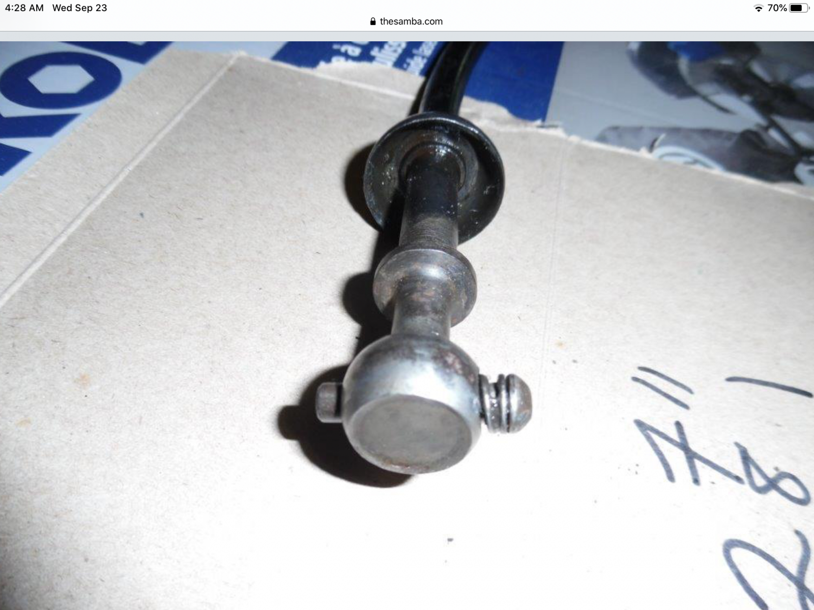

PostPosted: Sat Sep 26, 2020 2:31 pm    Post subject: Re: Shifter differences Reply with quote
On 66 and 67 bus shifter bottom pin shown in this pic, is it suppose to have that spring exposed?
