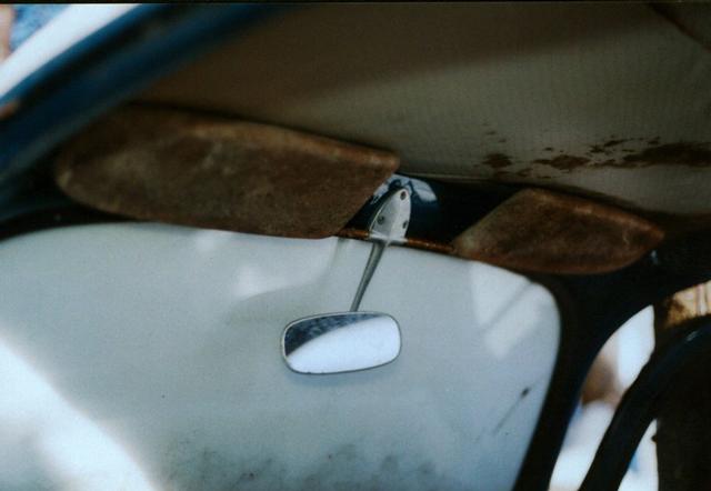

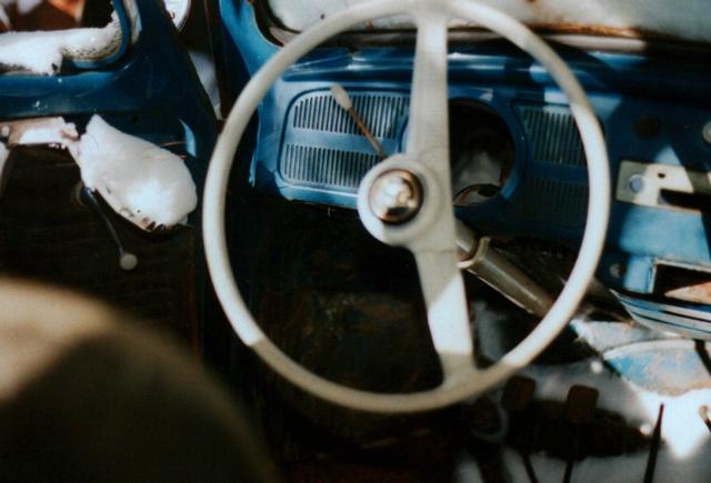

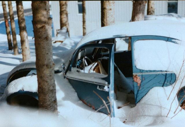

in 62 they still have the 3 spoke steering, I am not sure in 63 but 64 got the oval steering....
Pics of a 64 were taken on different season 10 years ago...I went to see that car last summer and it is non restorable now.
Not the black knobs, oval steering(noe in my garage), peanut flasher, perforated small headliner, No gas gauge and no chrome trims in the inserts of the dash...very rare and I pick the one of the ''non'' gas gauge for a 63 project a friend was working on.
Another friend of mine had a 60 canadian custom with the original carboard in the front truck and it was different than the deluxe.
Also wing nut to fix the front seat...
I have a 73 swing axle pan from a canadian bug in my stock!
Here are the pics of a 64 canadian custom...dead!
