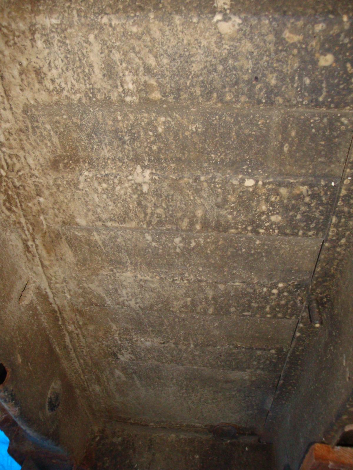

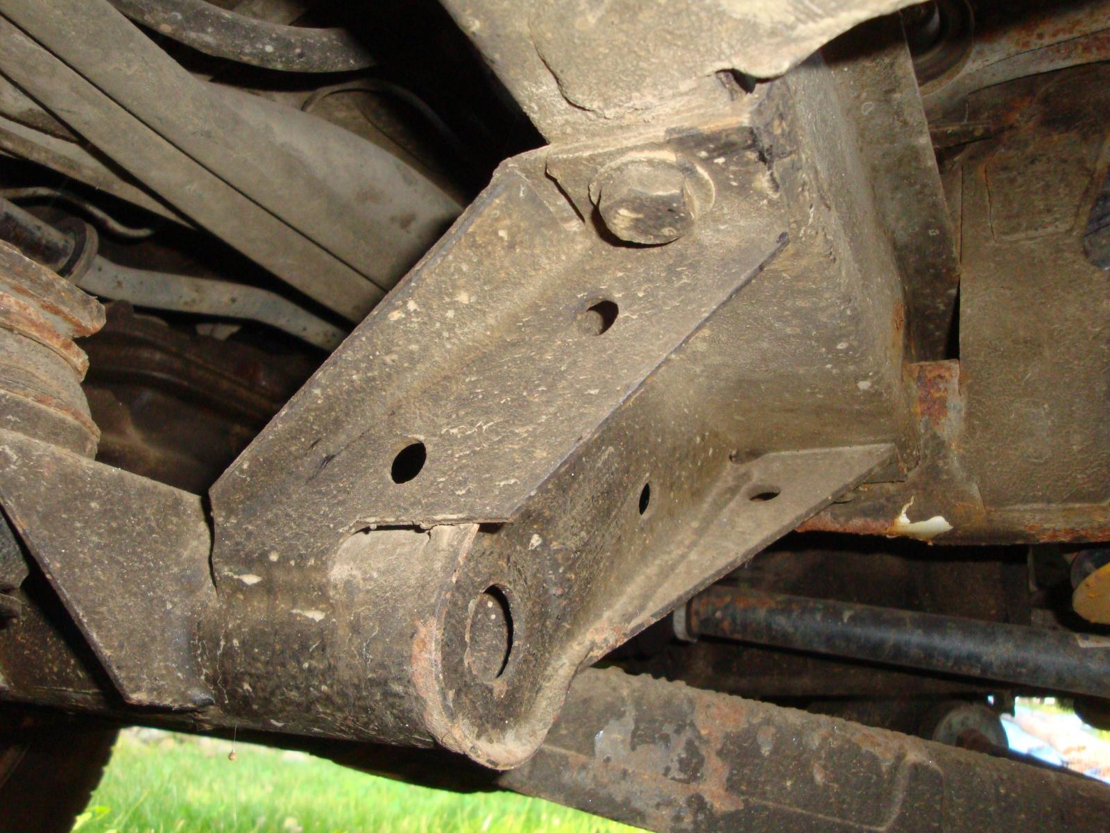

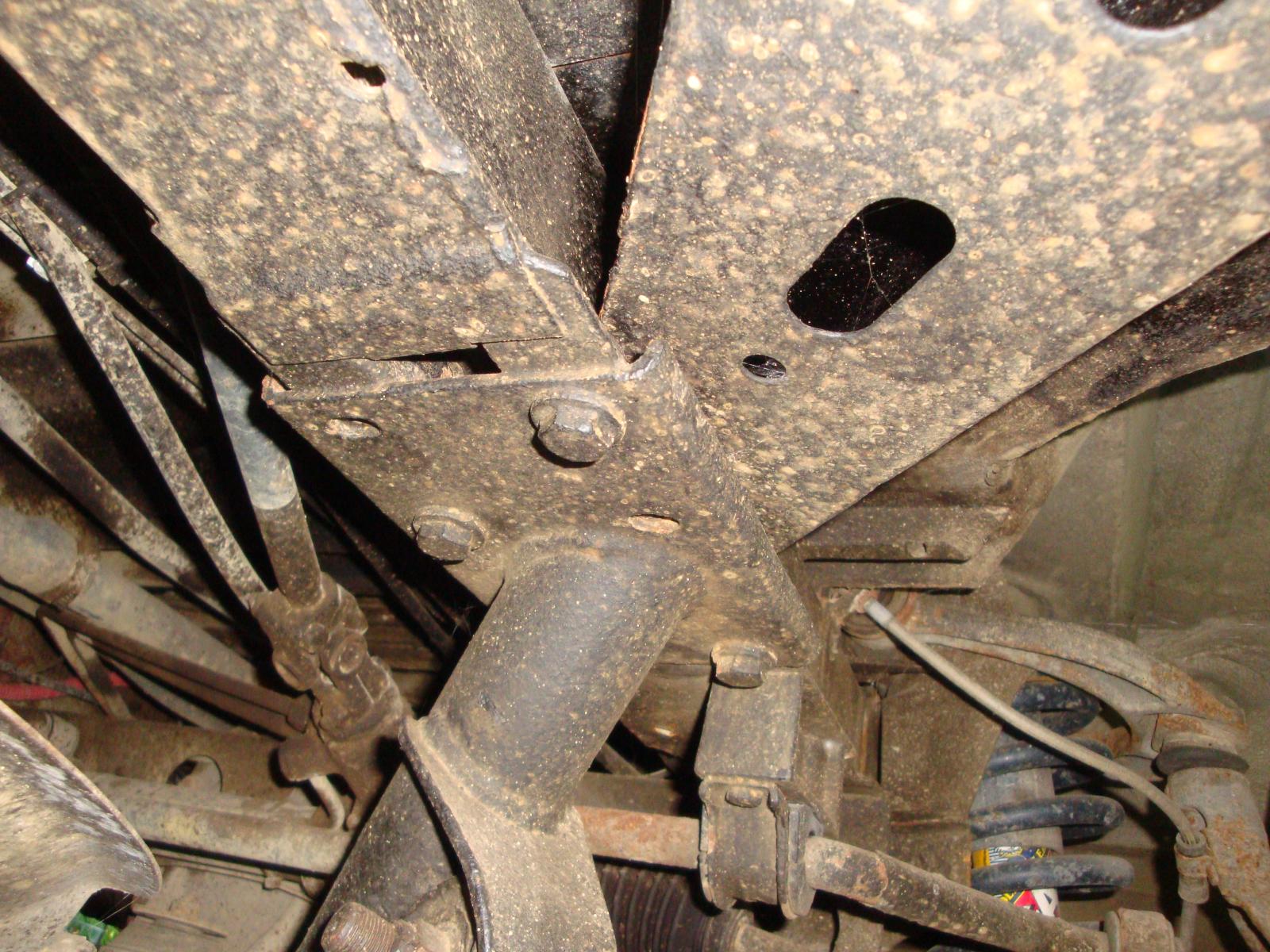

I took a look last night and realized my sense of time is dubious....
I sprayed the Van in 2005.
A little more details are in order.
It's seen about 50K miles since then - no daily driving ever. Only drove it in VT winters for 2 seasons.
I have been really over worked, and never got a chance to re-apply the Waxoyl on a regular basis like I always intended!
Still it has held up rather well, but again, limited winter driving.
Some more pics:
Here you can see what gravel did to the coating....

Dylan, Noxudol staying pliable is a good sign. I know it's a PITA to work on vehicles that have been treated, but it's sure nice when disassembling where rust has been kept at bay.
TJ, it does look like the tests have used a softer Waxoyl product, not the black one.
Taiga, I'd agree this thread is exactly what I hoped it would be..factual with real world pics/experience like nmerril has posted Smile
Special, I noted in my first post that Dinitrol is used here by Bombardier in their new street cars (for Toronto). They have several products and use them differently depending on application. Dinitrol has clearly focused on aviation/rail ... my guess are the margins are rather excellent in that field Smile Airplane superstructure never sees salt washes, although moisture cycles/galvanic corrosion must be targeted. I would love to know what companies like Bombardier actually do for research/testing.
Nm, 9 years with a few winters is a pretty good record for one treatment with the Waxoyl Pro product. Thanks again for posting up these excellent pics. If I had to guess, there is not a lot of self healing going on, but again, 9 years from application! The gravel hits pretty much highlight the need for an annual (ish) inspection. I am under the van a few times a year (this year a fair bit as I dropped the tank, new fuel lines, pump, filter) and of course had the cavity gun going strong. Unless you personally inspect/request, assume any typical rust shop will likely completely ignore/miss above the spare tire (remove it first!) as well as over the fuel tank. In my own shop, I'd be loosening the two tank mount bolts to drop it slightly for re-application to ensure the tank seams/frame rails were properly covered.
