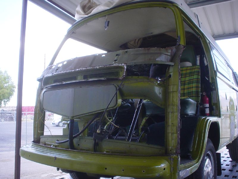

PostPosted: Fri Feb 20, 2015 2:10 pm    Post subject: Fresh Air Drain Hose Reply with quote
Click on pic to enlarge.

PostPosted: Fri Feb 20, 2015 2:40 pm    Post subject: Re: Fresh Air Drain Hose Reply with quote
Just what my bus needs, a nosectomy!.

PostPosted: Fri Feb 20, 2015 3:00 pm    Post subject: Re: Fresh Air Drain Hose Reply with quote
Tcash wrote:
What a perfect photo for that!
That's interesting. It seems that they moved the hole from over the steering box more towards the middle. My experience is based on '73 and later buses. Hoses are not that long, and would not allow for water to collect in the hose like that one.
I guess the answer is to just feel around until you find the damned hole! Smile
You know, somewhere (and this may already exist) we need a comprehensive list of what all changed and when for the Bay Window Bus. All the way down to little details like this.

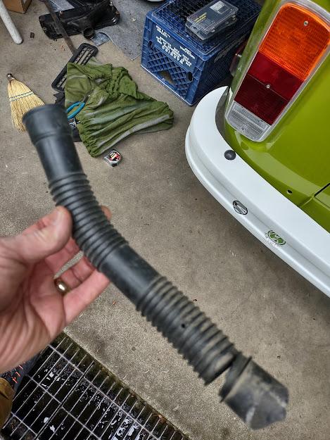

PostPosted: Mon Apr 18, 2022 12:50 pm    Post subject: Re: where does the hose go --- Front vent drain hose Reply with quote
I went to Home Depot and got this hose in WHITE.
BRAND: EVERBILT
6ft BILGE AND PUMP DISCHARGE HOSE
+5*F to +150 *F
1-1/8" ID
upc is 8 11000 01190 9
is on the label
I cut the good ends off of my 50 year old hose and those pieces entered nice and firmly into this hose.
I suppose if you did not have a crappy one with holes in it, you could still make this one work... $8-ish, IIRC

PostPosted: Mon Apr 18, 2022 2:18 pm    Post subject: Re: where does the hose go --- Front vent drain hose Reply with quote
I ran into this issue many moons ago on my '69 singlecab. original plastic was all beat up cracked etc.
There was no repro made - I found a washing machine drain hose works great, just about the same size.

PostPosted: Sun Sep 14, 2025 5:10 pm    Post subject: Re: where does the hose go --- Front vent drain hose Reply with quote
Moments ago listed a hose that was sent to me by one of our favorite used parts vendors. I asked for one to be sent for my 1968 DC and found the "replacement" had two extra segments making it longer than my original. I asked what year bus he removed the hose and he replied 1973. When vendors selling new hoses suggest theirs fit 1968-73, I have significant doubts.
https://www.thesamba.com/vw/classifieds/detail.php?id=2763062

PostPosted: Sun Sep 14, 2025 9:23 pm    Post subject: Re: where does the hose go --- Front vent drain hose Reply with quote
It’s corrugated bilge hose sold at every would-be marine store in the world for a couple of bucks a foot. What on earth would possess anyone to buy a 50 year old piece of plastic that will soon look just like the one removed. Buy some new hose, heat flare the upper end and cut the lower end at an angle. It will look and function EXACTLY like the original. I’m all about keeping my bus original, but some things are just stupid. I have some NOS tires and oil that I’m selling. PM me.
