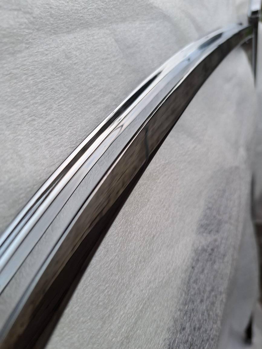

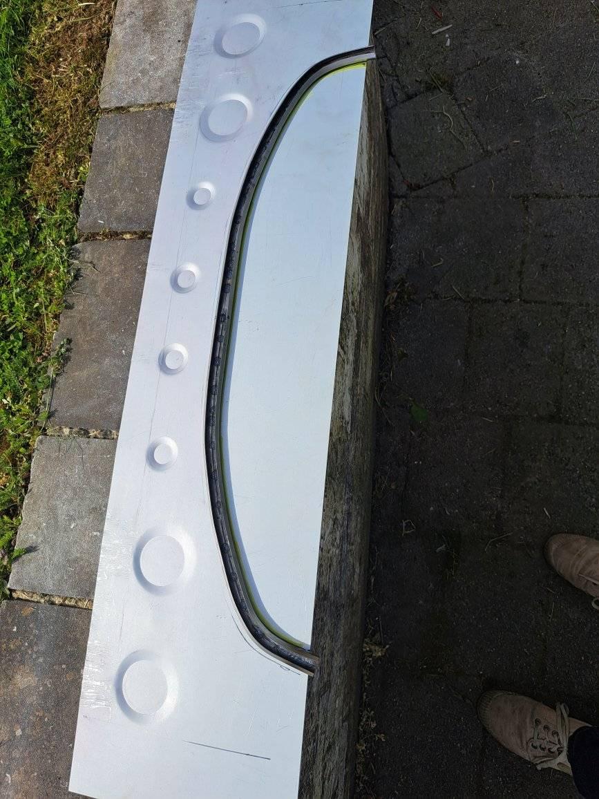

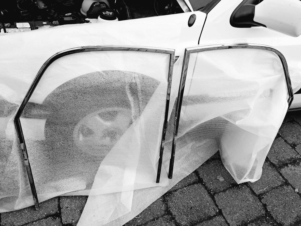

Door window frames are back from chromeshop

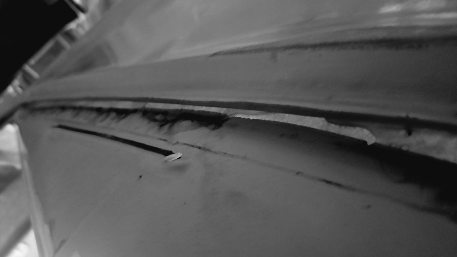

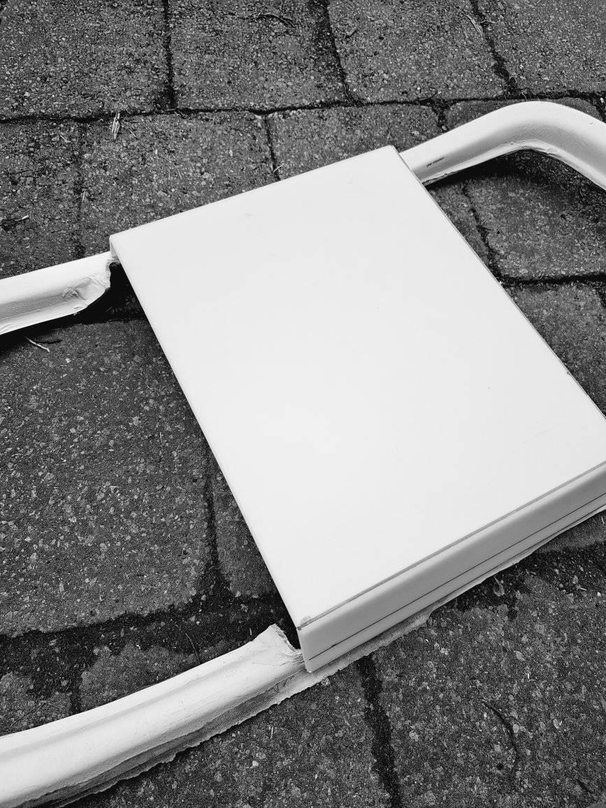

As the rocker panels are wrong , I had to mold two new 50 model rockers..
The 50 model decklid is also specific to that year, the one included in the kit is a later one with round recess in the rain deflector...
The 50 model is flat with 2 ribs...
So I cut the wrong one and made a mold to design the right one.
Just fresh from the mold, it will need some cutting, sanding and adjusting to the hood frame...
Just a mock up to the grill and decklid...

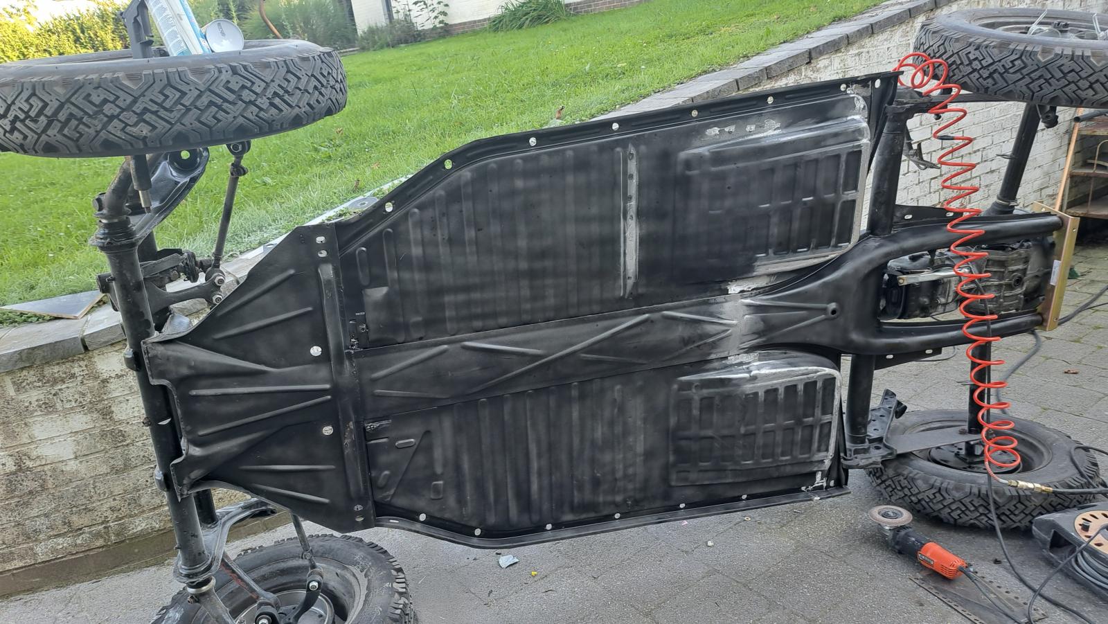

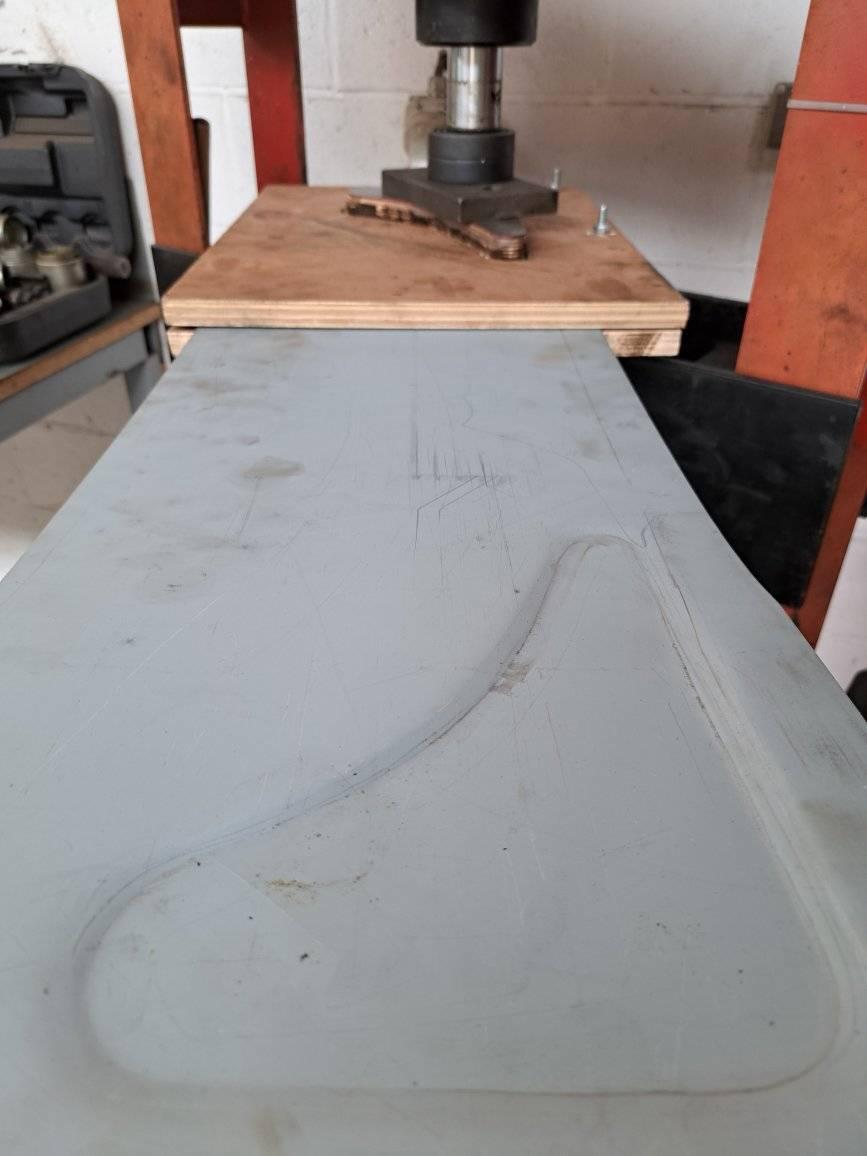

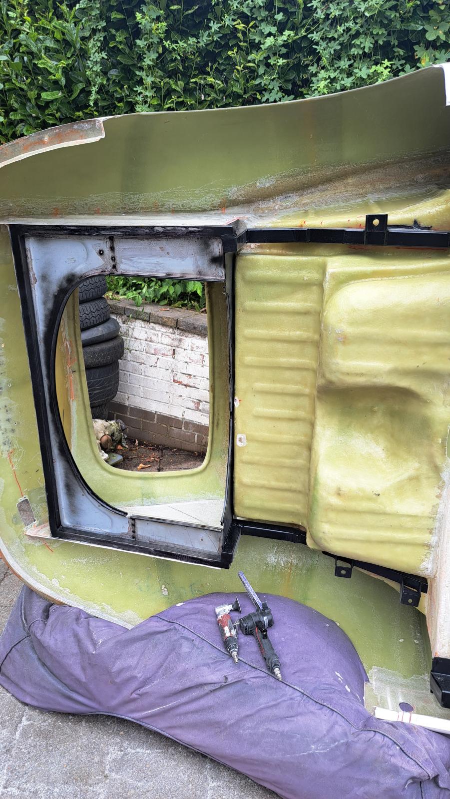

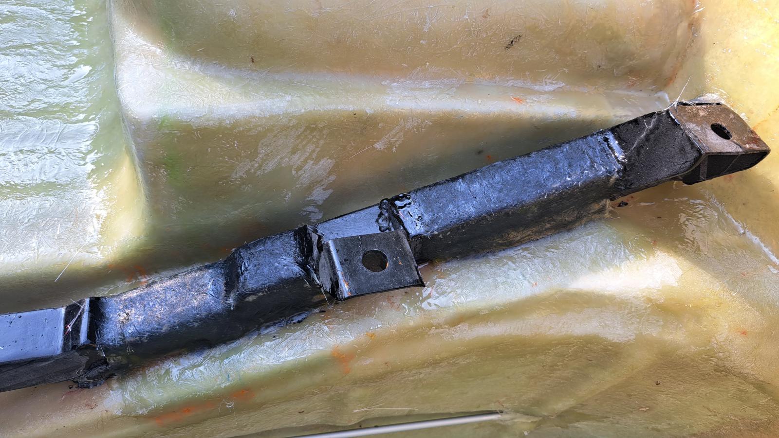

The engine bay is to be build as there was nothing...
I build a frame that is bolted to the rear body and to the chassis, it will be later inserted to the body with fiberglass...
the sides are made of fiberglass and will be bound to the body
to avoid flat metal sheet, I stamped some shapes to the front and rear engine tin.
mock up before welding and fitting engine tin seals .

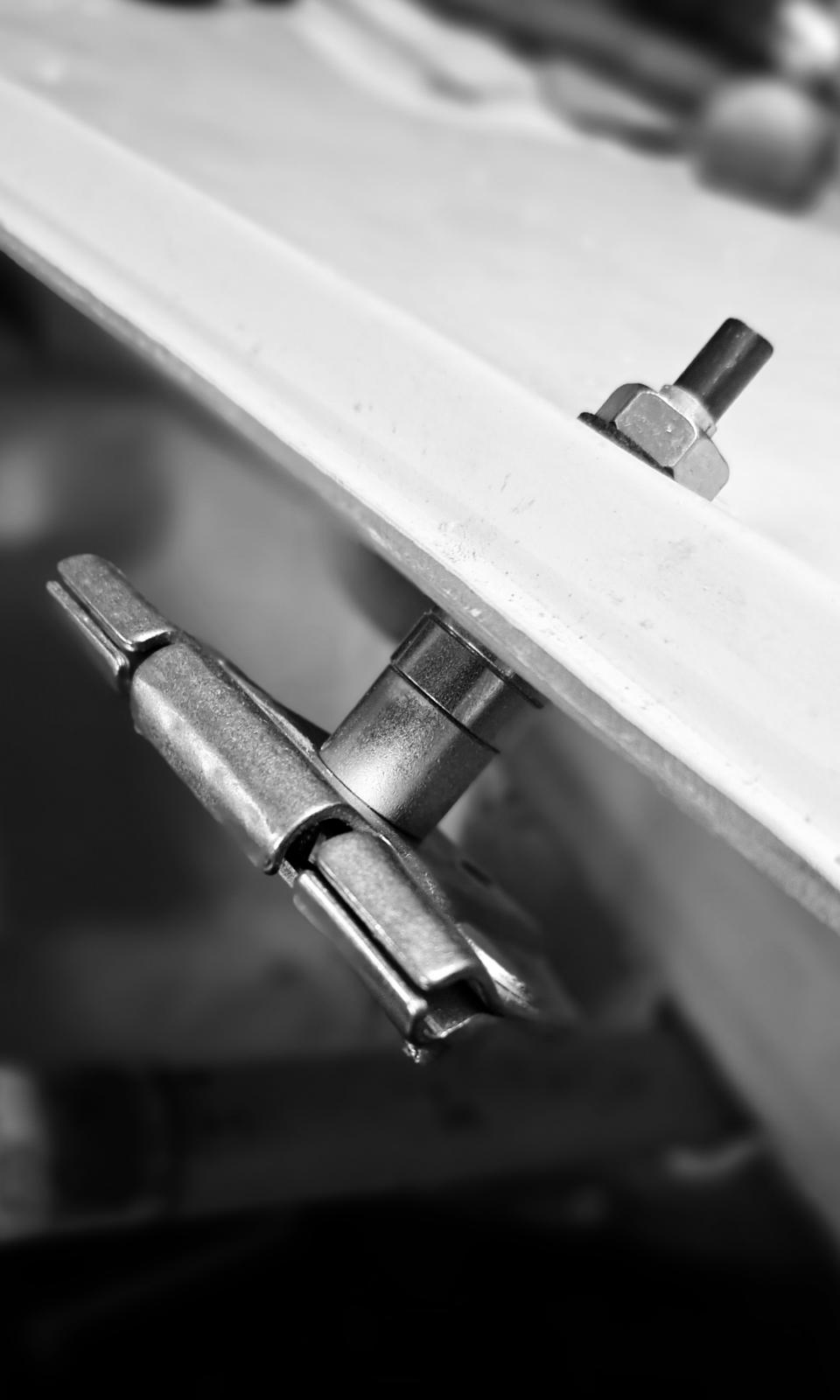

I choose a classic Mini wiper kit, as this stystem will allows to have opposite working blades :
one in this side, the other is fitted upside down

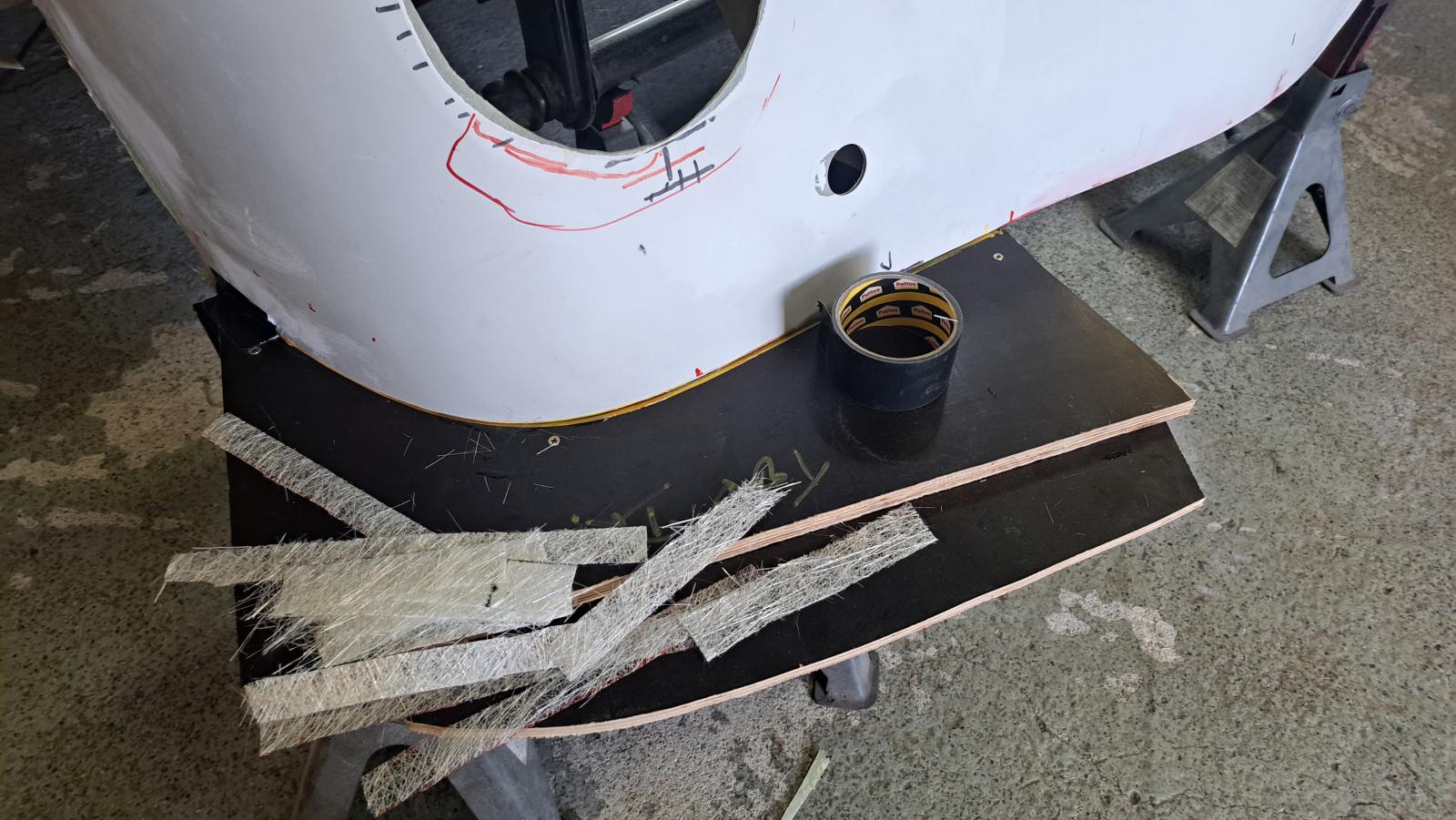

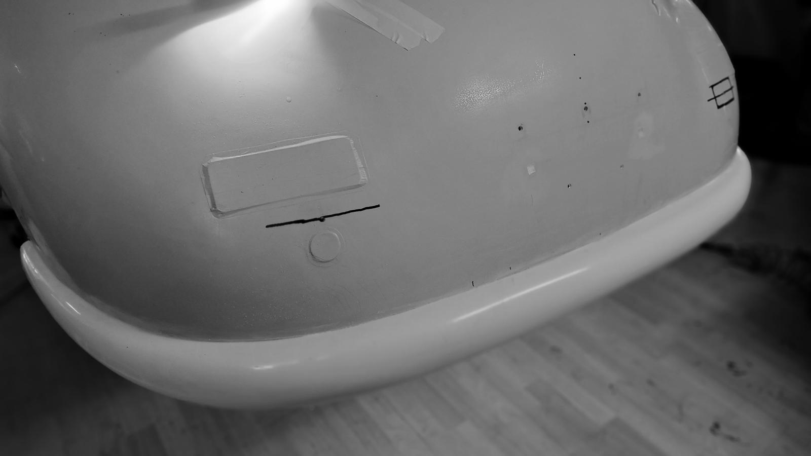

As there was no support to the rear body bumper, I needed to create a lip where the bumper will fit.
The engine compartment is also sealed and the exhaust is fitted , it will need angled exit tubing to avoid the bumper

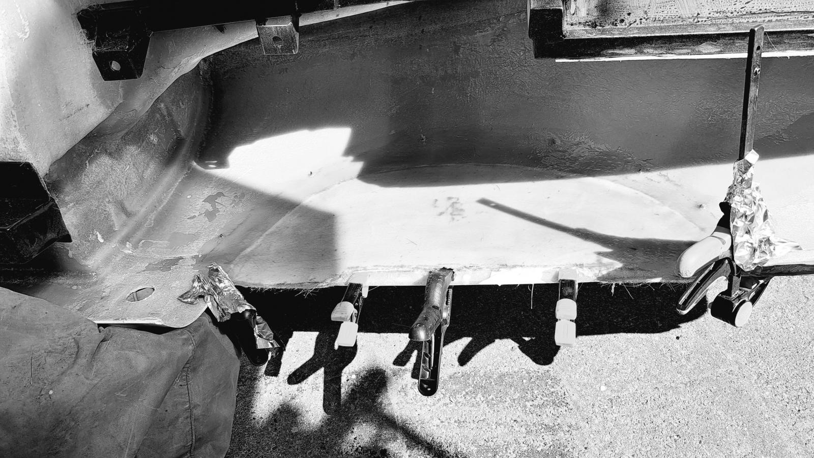

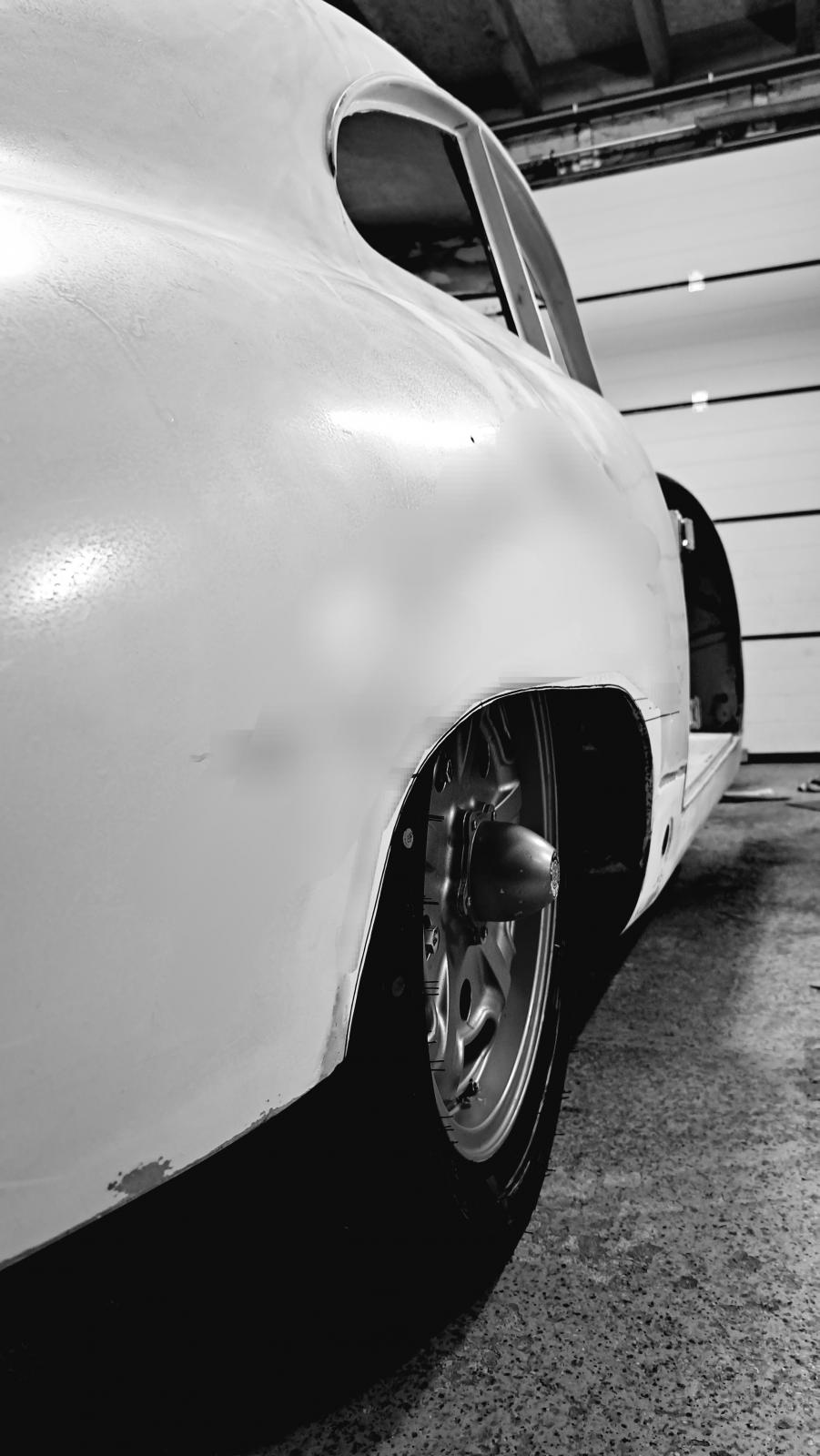

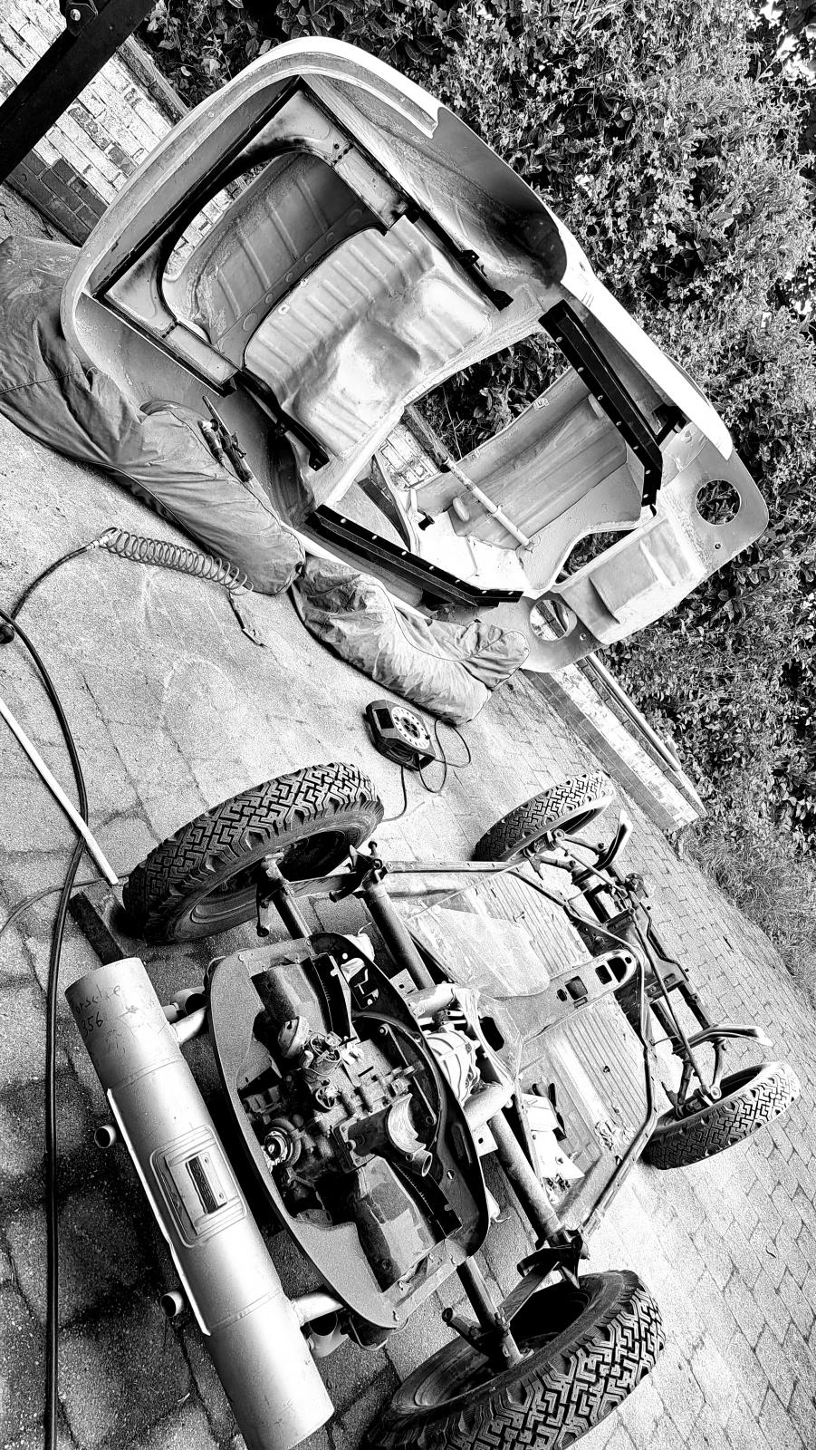

The rockers panels are fitted...
time to work outside to grind all the previous glued and fiberglass work done by the "builder" of the kit...
[b]and finally I closed the rear wheel arches that has been molded too high !
The line is the correct shape of the wheel arch[/b]

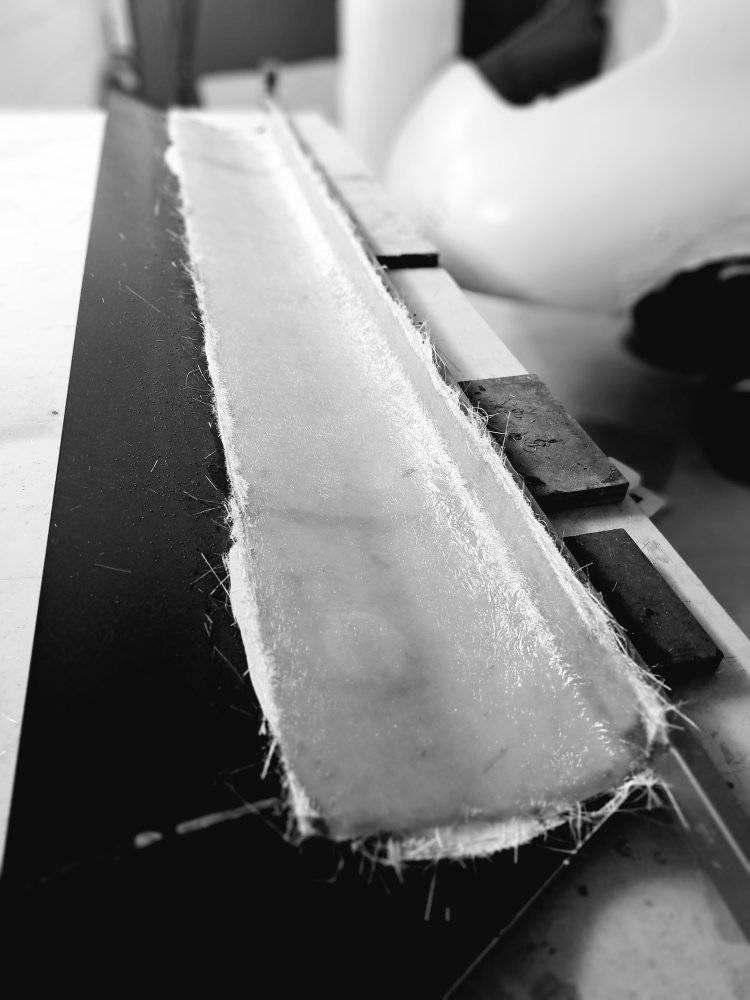

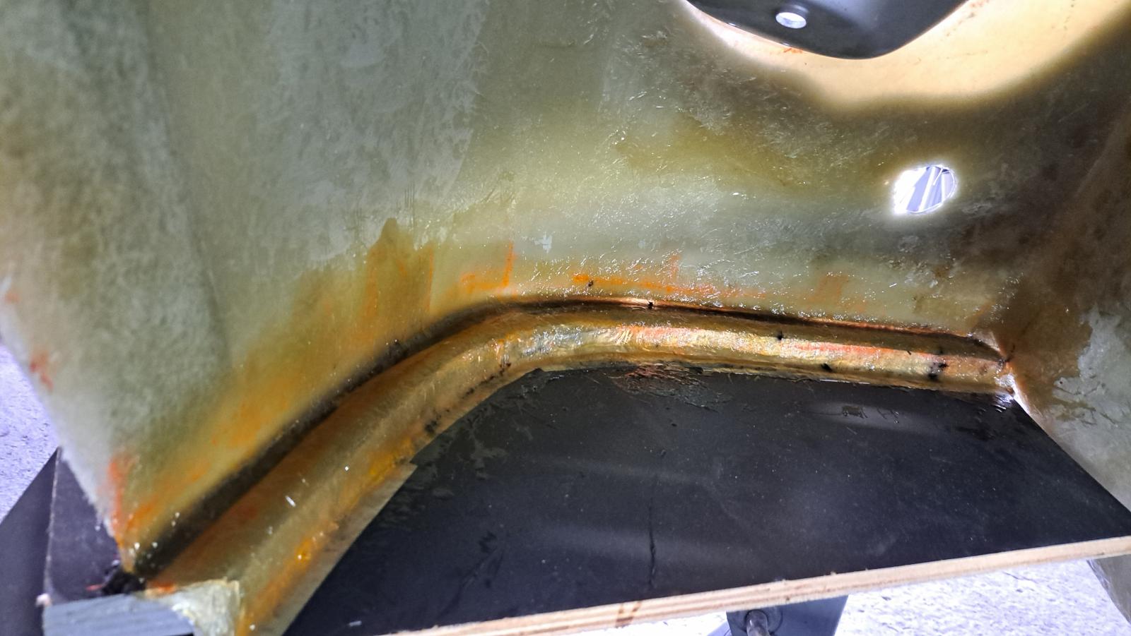

Adding fiberglass and reinforcing some places ...
We have a very shitty weather here in Belgium....2 sunny days then followed by storm and rain...then again sun, storm, rain.... Evil or Very Mad Crying or Very sad
You can see the bad glue that still stick to the finger and didn't avoid some panels to come away...

Smoothing some welding on the chassis
To fit the front bumper, a lip must be created

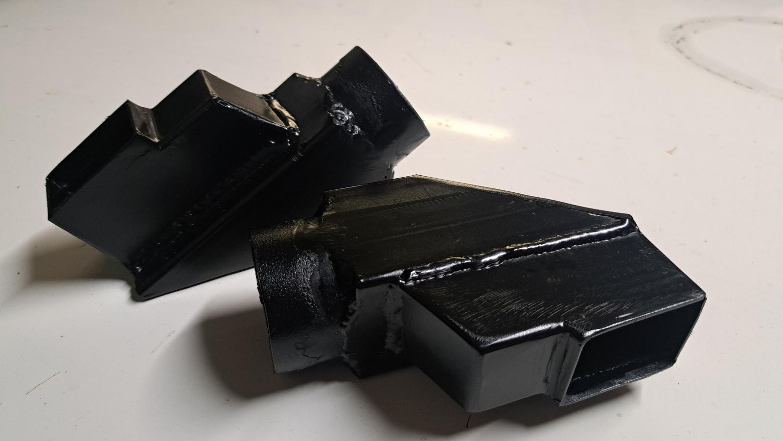

I installed a windshield defrost connected to the heating system with modified bay window vents
once connected
I built heating boxes to send hot air to the feet and to the windshield

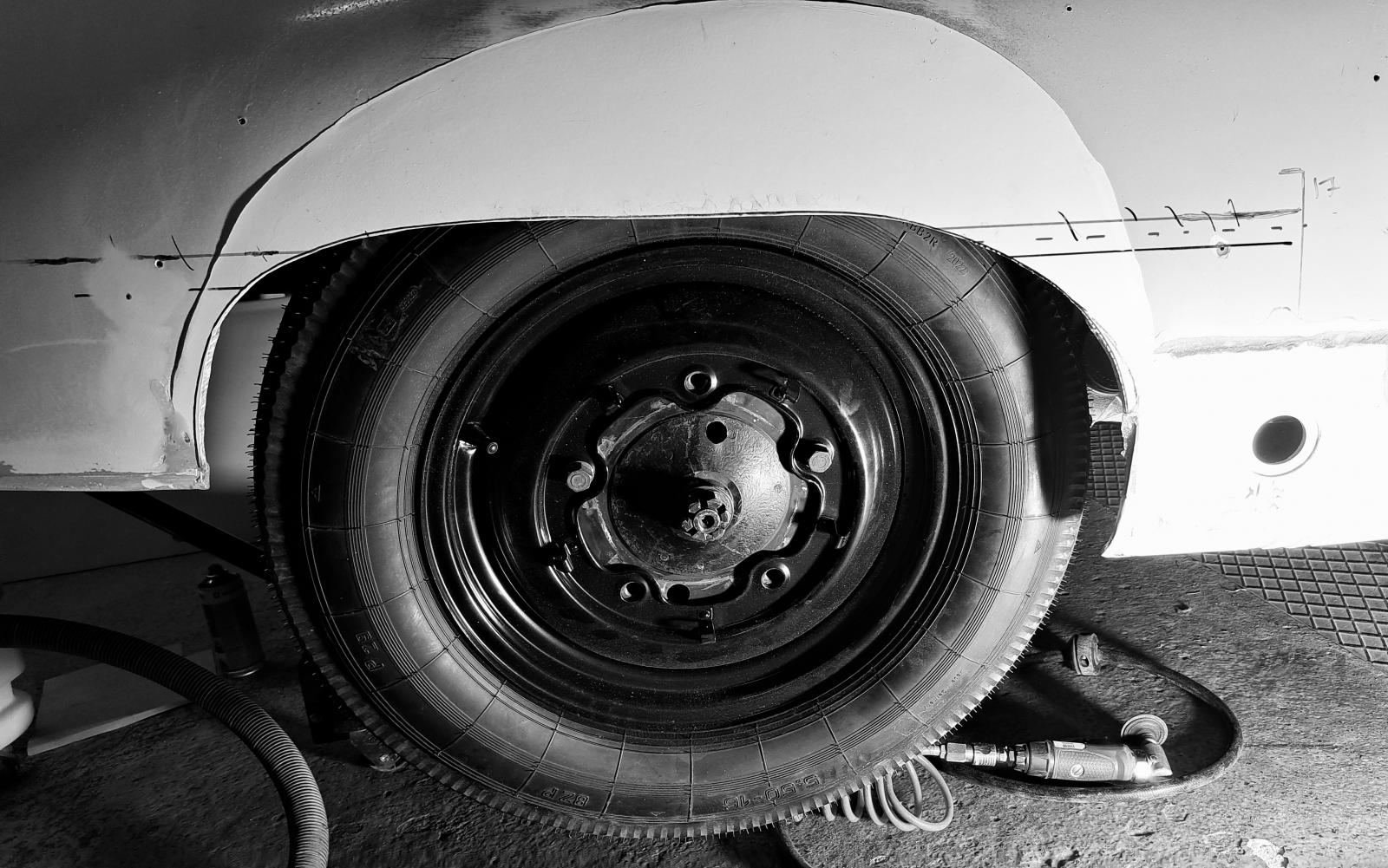

A lip had to be extended as the dashborad was too short to fit the body...
Cutting the rear wheel arches to the right shape, helped by a period plan/schema
I had to notch the spring plate a little bit or the wheel won't pass between the drum and the wheel arche...

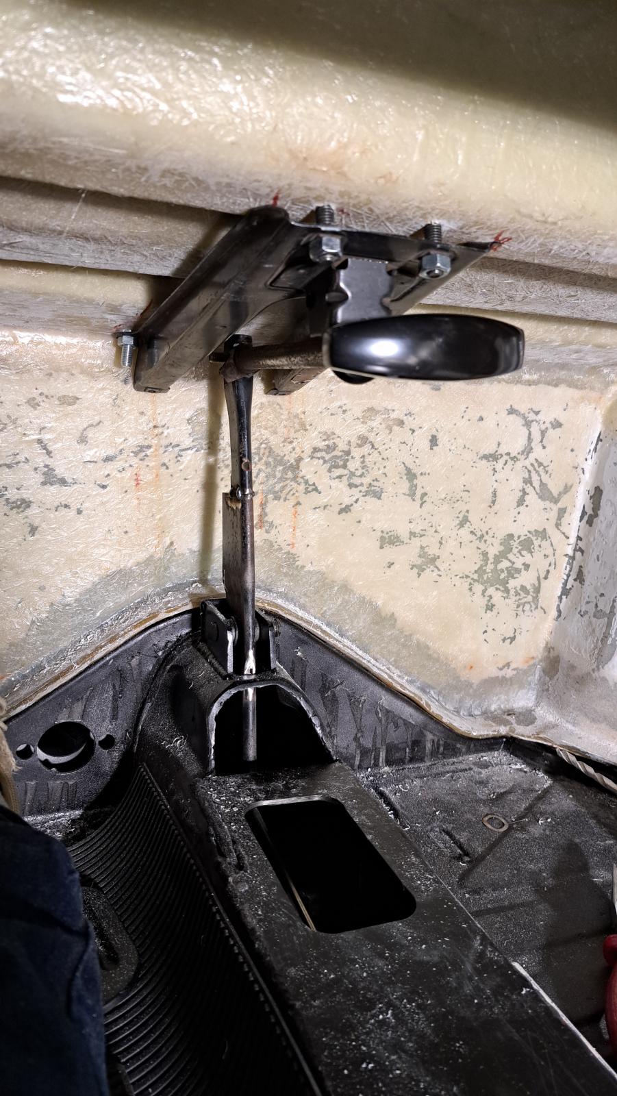

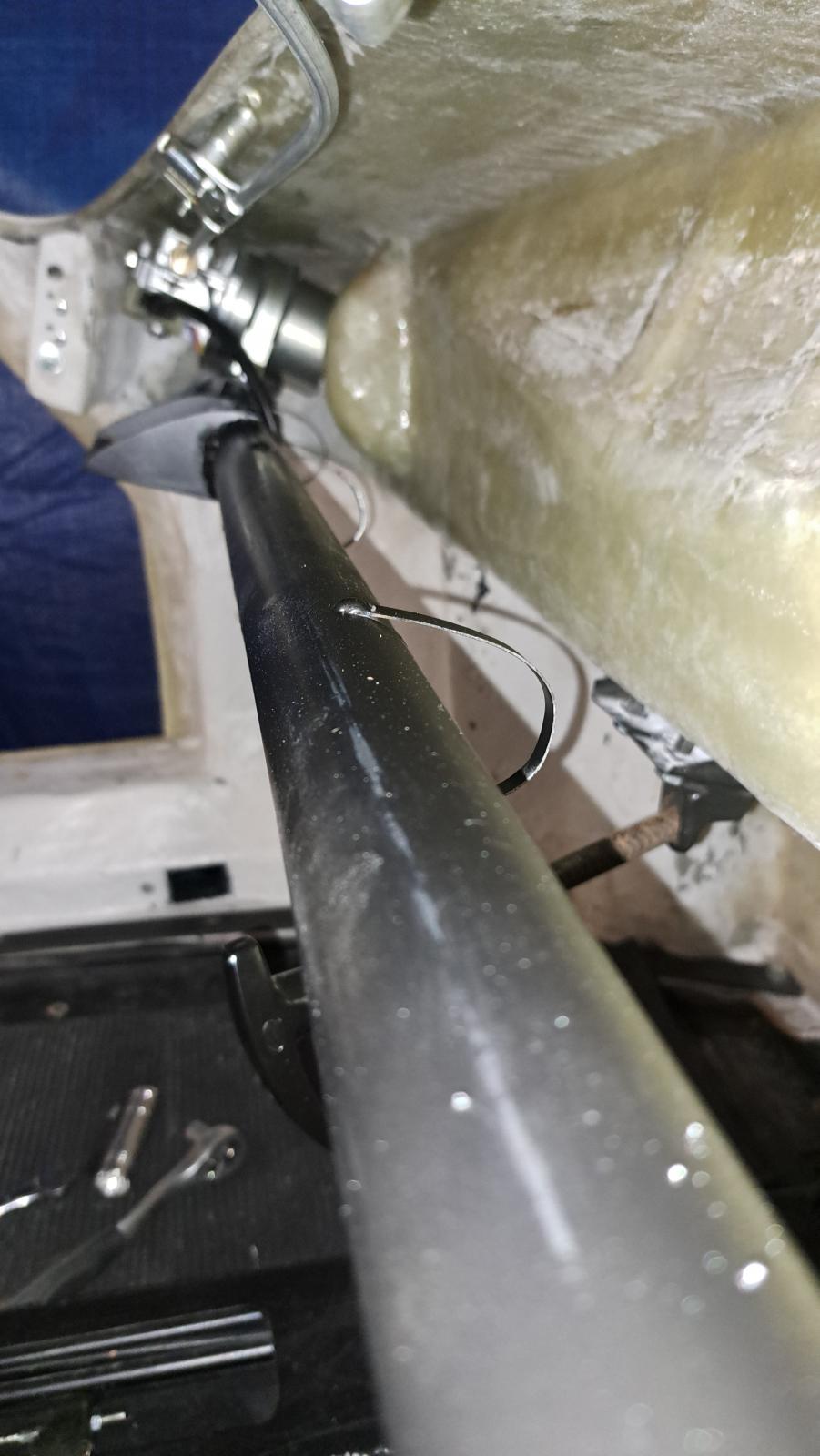

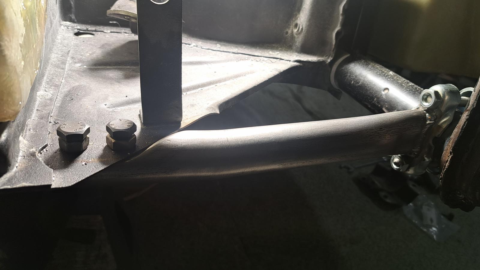

The handbrake will be under the dash, using mostly bay-window parts
It's not the right place for a Porsche but that will work for me Wink
I made some front beam stiffeners
The girls helping to load the suspension to see if the stance is nice and correct on the rear wheel arches
