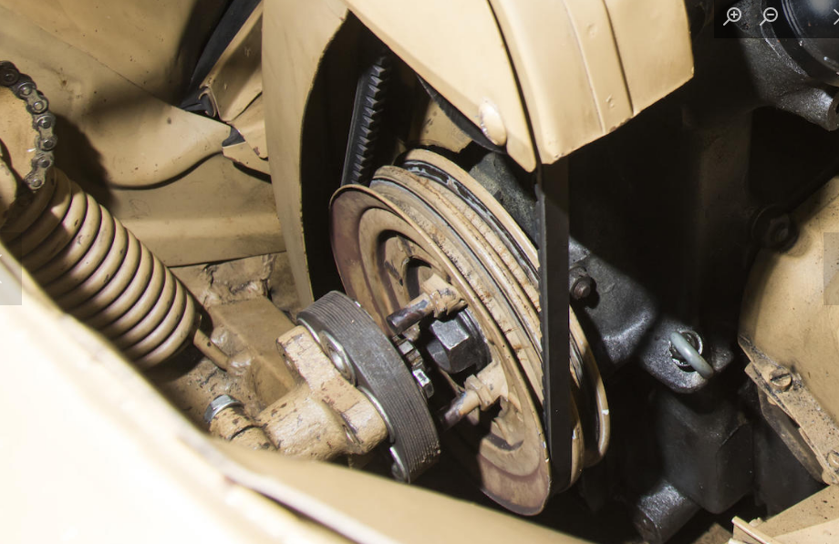

sleepywiesel
Joined: June 22, 2010
Posts: 93
sleepywiesel is offline
PostPosted: Thu Apr 17, 2025 9:03 am    Post subject: Re: Ferry Porsche Turbo VW38 Cabriolet Reply with quote
I quite like the idea with the two pulleys of the Schwimmwagen.
They used the exhaust system from a Kubelwagen obviously.
So maybe the coupling between the crankshaft and the blower is a Schwimmwagen part.
Does anyone have a picture of the Schwimmwagen mechanism from inside the engine bay?

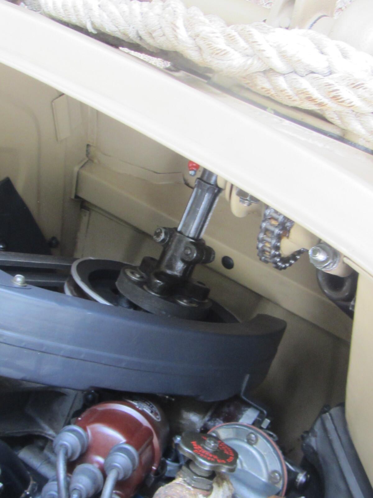

PostPosted: Fri Apr 18, 2025 1:50 am    Post subject: Re: Ferry Porsche Turbo VW38 Cabriolet Reply with quote
the coupling on the schwimmer is a disc that slides on splines to engage with drive pegs on the end of the crankshaft/pulleys. this set-up could easily drive the blower and even enable it to be coupled/uncoupled

PostPosted: Fri Apr 18, 2025 2:11 am    Post subject: Re: Ferry Porsche Turbo VW38 Cabriolet Reply with quote
Thanks finster for your great pics.
I think, the distance between the end of crank pulley and blower is rather short.
The blower must be mechanical fixed with somehow brackets.
Are there pics of a that time common coupling system for roots-blowers of other cars?

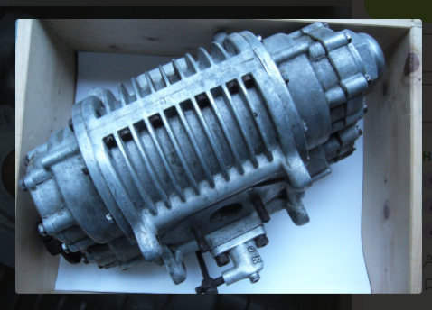

sleepywiesel
Posts: 93
PostPosted: Fri Apr 18, 2025 11:43 am    Post subject: Re: Ferry Porsche Turbo VW38 Cabriolet Reply with quote
Great, thanks for the information finster.
I have found an intersting picture of one of theese blowers.
It almost looks like the one we are looking for. But it doesn't seem to be kdf body.

splitjunkie
Joined: April 04, 2006
Posts: 4202
splitjunkie is offline
PostPosted: Mon Apr 21, 2025 9:33 am    Post subject: Re: Ferry Porsche Turbo VW38 Cabriolet Reply with quote
wagen19 wrote:
There were many interesting types and parts, as well as combinations that time around.
We should also have a look and think about the type 120 industrial engine.
Here I have a original "Bedienungsanweisung und Instandsetzungsanleitung für Stationär-Motor-KdF. Typ 120" from July 1943.
That engine also has a twin belt pulley, nr. 60 102 151, (swimmer pulley with 3 pins for "Gelenkscheibe 70 623 329" is 70 102 151, spare book April 1943)
But I can see, the swimmer pulley, as well as the industrial pulley, both are not hollowed out and made of sheet metal. The pulley on that blower-vert-engine looks clearly hollowed out, but that can may be a older casted version of industrial or swimmer type pulley.
The Magneto of that pictured "Sturmboot-engine" looks the same as for type 120, which was driven by distributer shaft. (housing 60 135 101, complete magneto Bosch Magnetzünder ZEZ 13/1248 FF 4 ALS 388, VW spare nr. 60 920 021)
(The screw for swimmer pulley looks not original. It looks rather like a modified screw since Oct 49, nr. 102 163. Swimmer had a "own" screw 70 102 105, spare book April 43)
That looks like the same type of blower. You can see the blower on the vert from the bottom in this picture.
Like Finster, I had initially thought it was direct drive but based on this picture it just doesn't look like the blower would fit under the bump out on the apron, but that could be just the angle of the shot.
What I find interesting about this new picture is that it appears that it might be in the vert with the apron removed. You can see what looks to be the side of the left lower quarter panel, just to the left of the blower. The angle looks correct and you can see at least one fender weld nut and in the upper left corner you can see what looks like the edge of the fender. The shade appears the same as the vert too.

in the picture showing the supercharger from above I have a few comments.
It looks like that the fender beading is laid over the fender.
And you can see what I think is the black bumper bracket. Is that a broom handle used to spread the apron? It does not look like the exhaust as shown in the picture from below.
finster
Joined: May 26, 2012
Posts: 10071
finster is offline
PostPosted: Tue Apr 22, 2025 4:52 am    Post subject: Re: Ferry Porsche Turbo VW38 Cabriolet Reply with quote
I don't think the photo of the VD blower is showing a kdf wagen application. the bumper bracket is in the wrong place. the Derbuel blowers were used in all sorts of vehicles from dkw bikes to fiat topolinos.
this one has a dog drive coupling on the end
