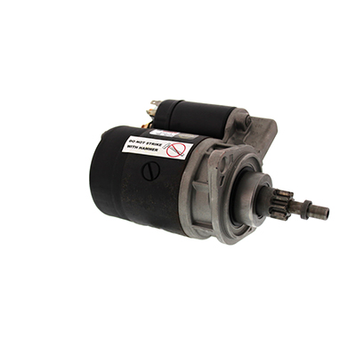

PostPosted: Sun Aug 31, 2025 9:38 pm    Post subject: Re: MEXICO VW BUS Engine - Starter Reply with quote
the shaft on those starters are not support,there will be some play in it,that the reason for the bushing,its supports the shaft.
1968 Dune Buggy sold dec 2024
1974 parts bus
mikedjames
Joined: July 02, 2012
Posts: 3388
mikedjames is offline
PostPosted: Sun Aug 31, 2025 11:42 pm    Post subject: Re: MEXICO VW BUS Engine - Starter Reply with quote
The 1600 starters that were used in Europe up to 1979 dont have a bearing at the pinion end so they wobble normally.
I would go for measuring the shaft of your starter- length and offset to the pinion- it is probably the same as a pre 1972 bus in the USA.
Before condemning the starter I would make sure your wiring is perfect- you are describing what could be classical hot start issues. Which are mostly electrical, though points wearing, closing up and over advancing the ignition can also cause it to crank slower .

Ya'all are making this way more difficult than it needs to be.
Using ETKA online for free it shows a few actual part numbers.
BAA911023B is the 1st one.
I hate Rock Auto parts but you can search just Mexico vehicles.
The first start it shows for a 1977 Mexican Combi that crosses to that ETKA number above looks exactly like the once in the OPs 1st picture.
"OEM / Interchange Numbers: 102102, 111911023, 111911023A, 111911023B, 111911023BT, 111911023C, 111911023D, 113911023E, 16450, 211911023, 211911023B, 3059110233, 311911023B, 311911023C, 311911023D, 311911023DX, 331911023C, 432543, 66925157, BAA911023B, D8E158"

The one he has looks more like it would cross to this one. He really needs to set them side by side to see how far the gear protrudes from the starter mounting surface.

SR87X is a 091 trans (76-79 and AC Vanagon) starter.
Could be. I dont know what trans Mexi-Upright Late Bays use.

Well, just an update. After a visit to an old school rebuild shop, the took the original starter apart and found the brushes were pretty much done for. They said they were still good enough to get it to crank the first time but as soon as it got a little hot that was probably the problem.
They rebuilt it for $165, which is cheaper than I could get a new one, and it’s original, known to bolt in and fit.
Took them about two days to rebuild it, half hour to put it in and it fires right up. After running it around town for a good half hour, we shut it off and then it fired right back up again. So it definitely looks like the starter was the culprit!
Thanks all for the input and ideas.
