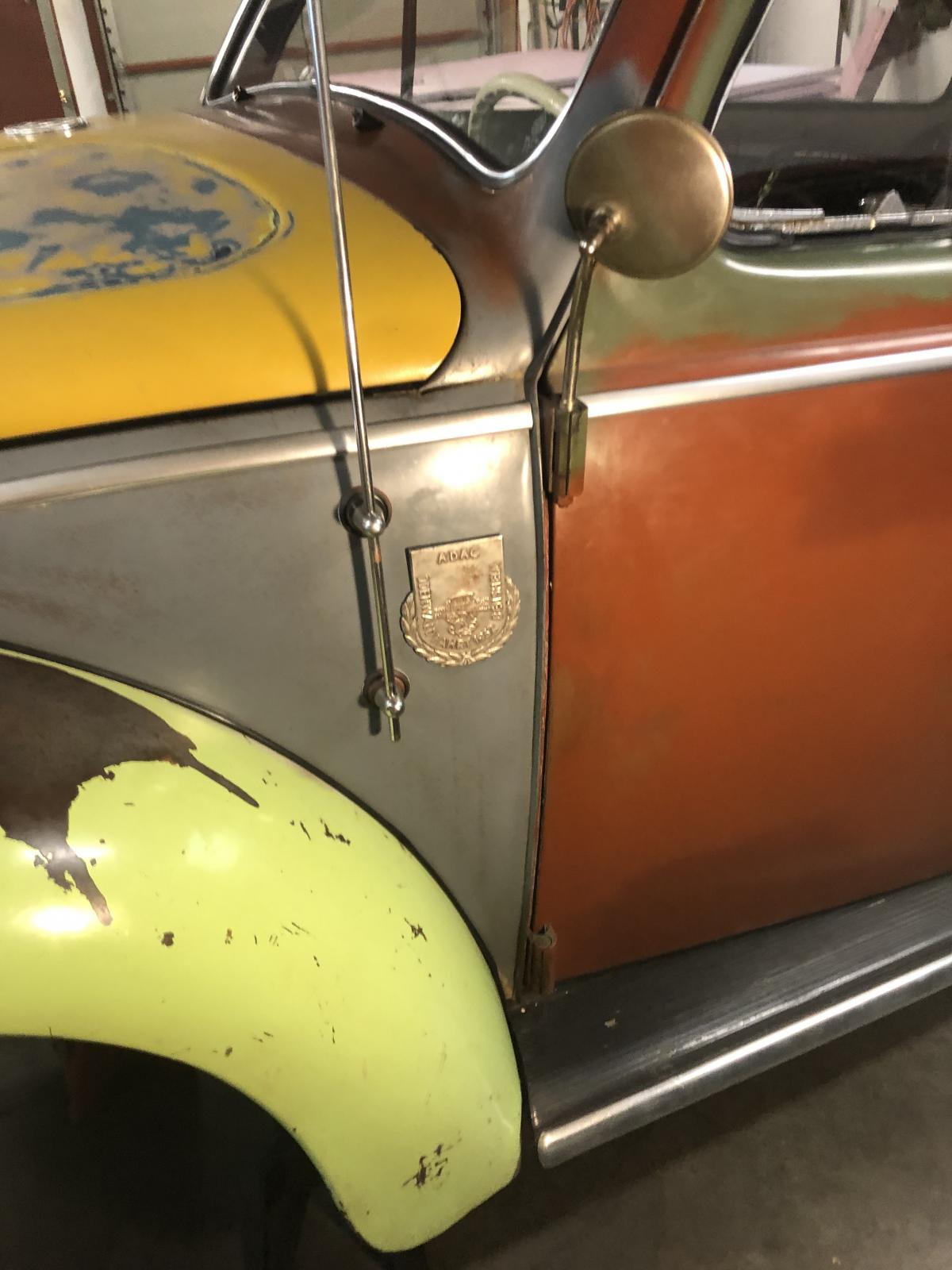

i picked up a fun ADAC badge:

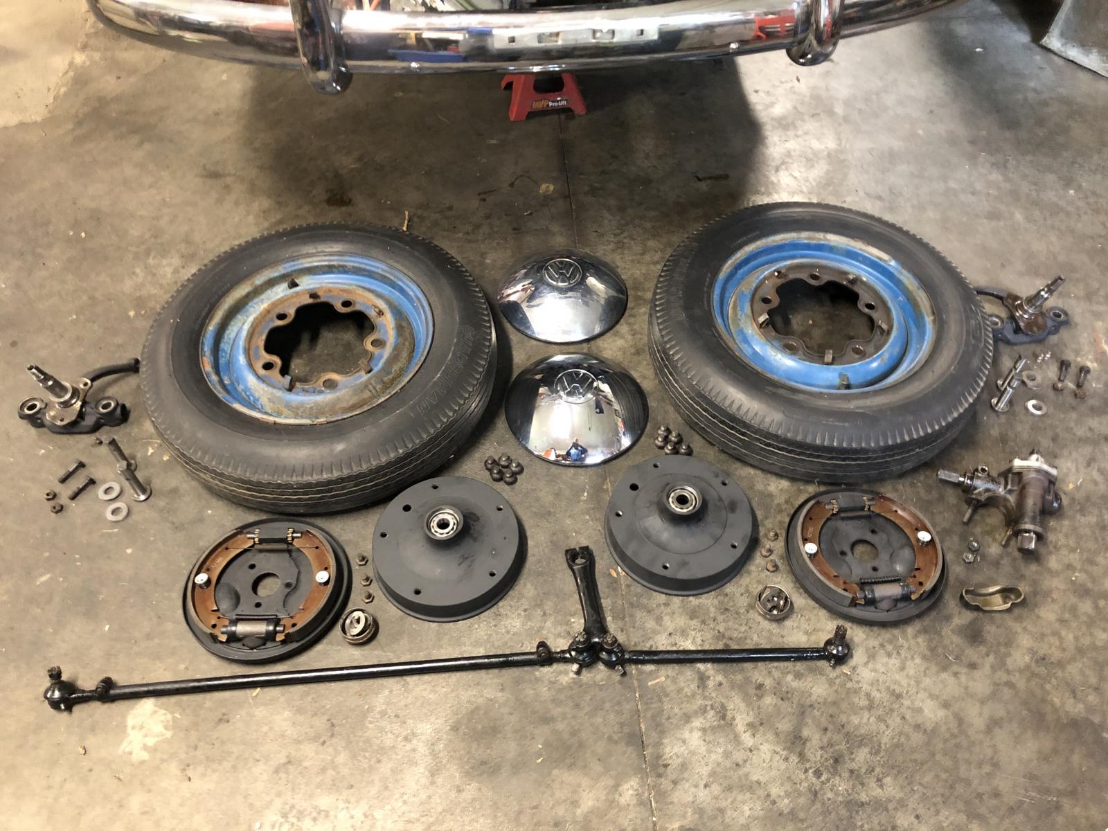

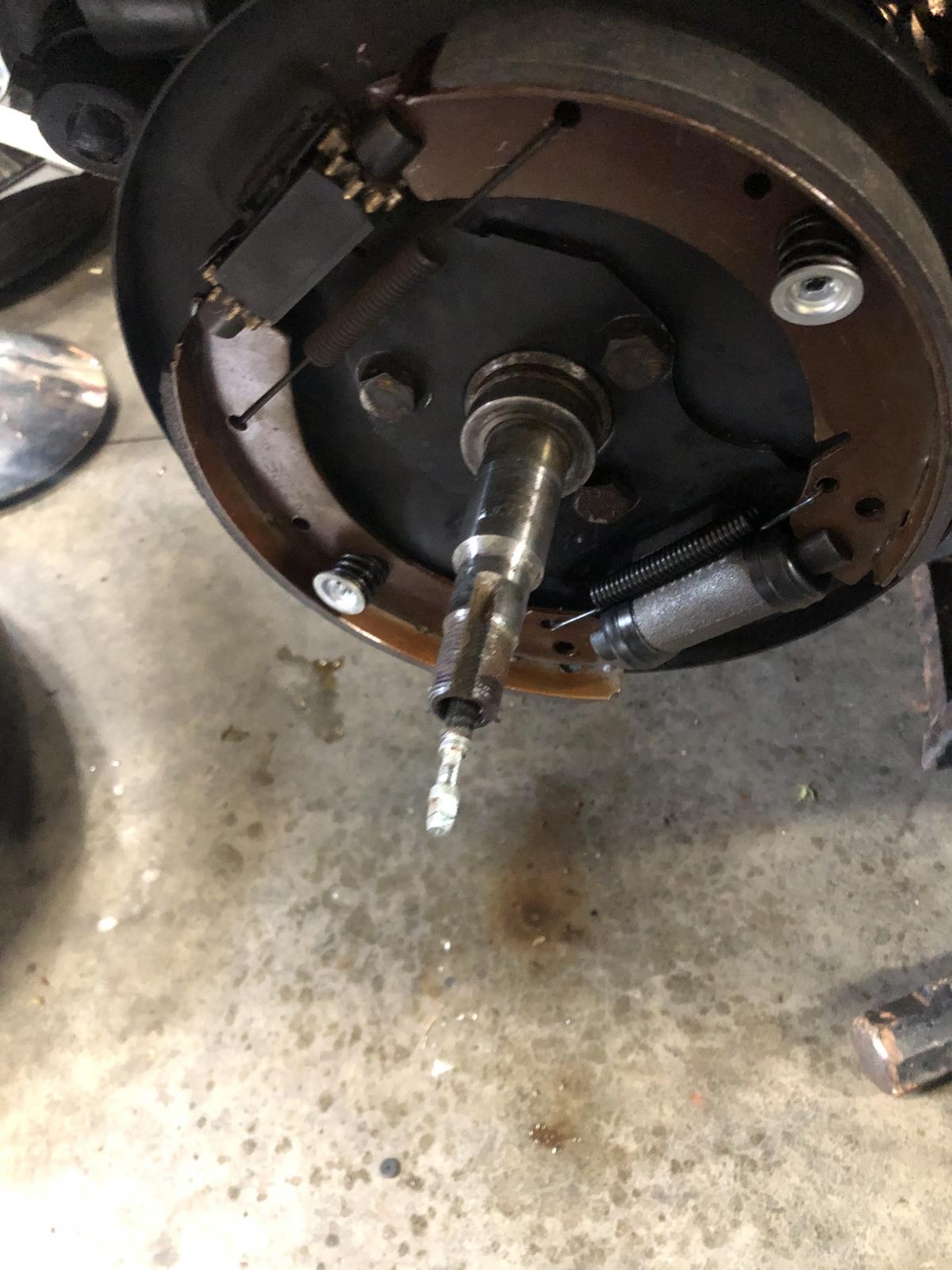

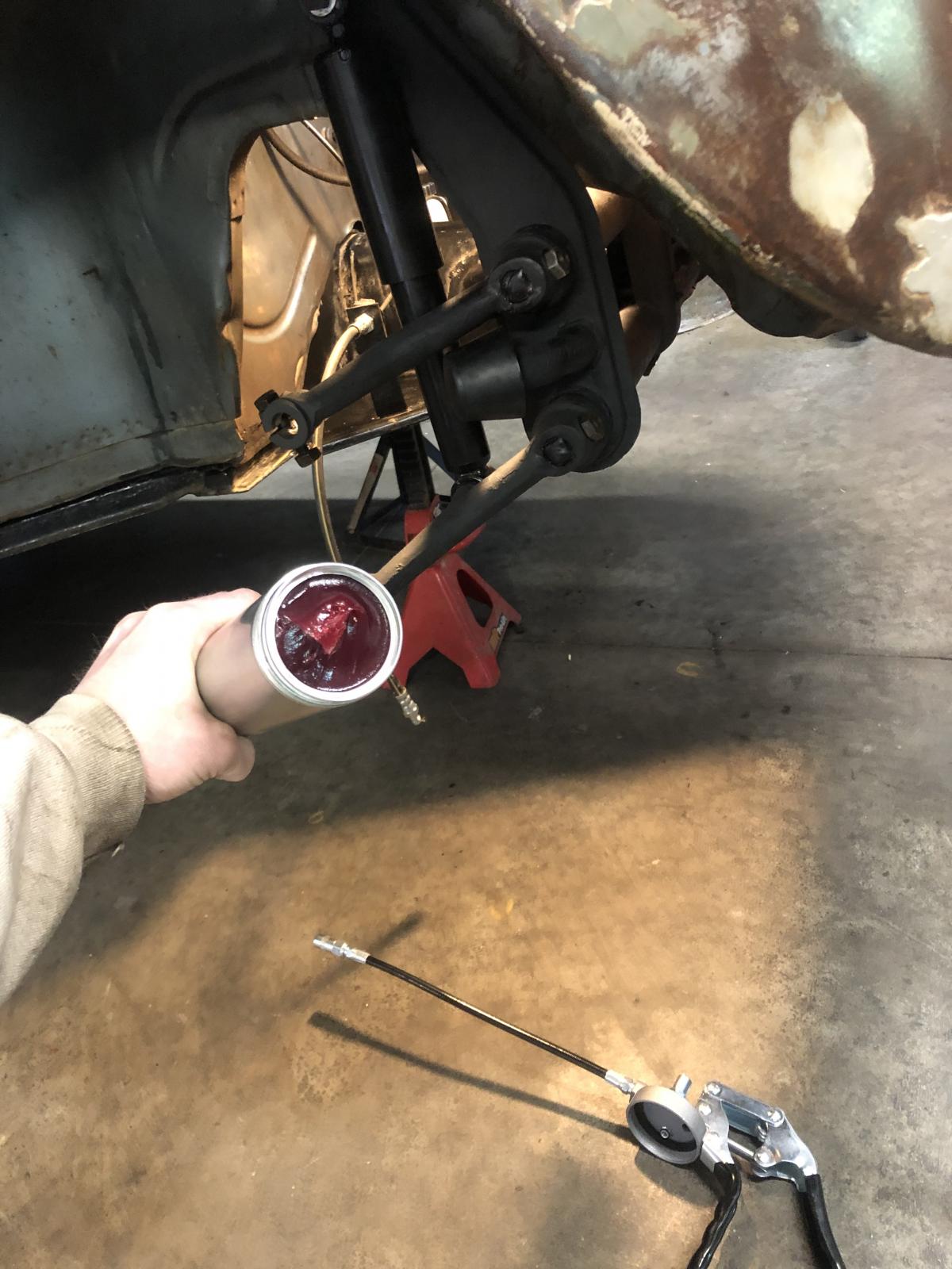

i got the king and link pins resolved. i ended up finding a local shop to work on the king pins. Gary, the shop owner, was awesome. he has a 1953 ragtop. took me for a spin around town.
here are all my washers for shimming the link pin offset. spec is 7mm. i was at 7mm on the passenger side and 6.7 on the driver. thats pretty good.
so then i got to put the front back together.
that locking wire ended up snugger than this picture

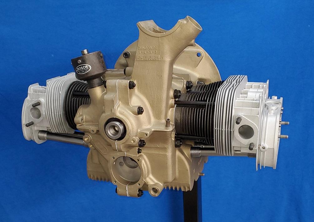

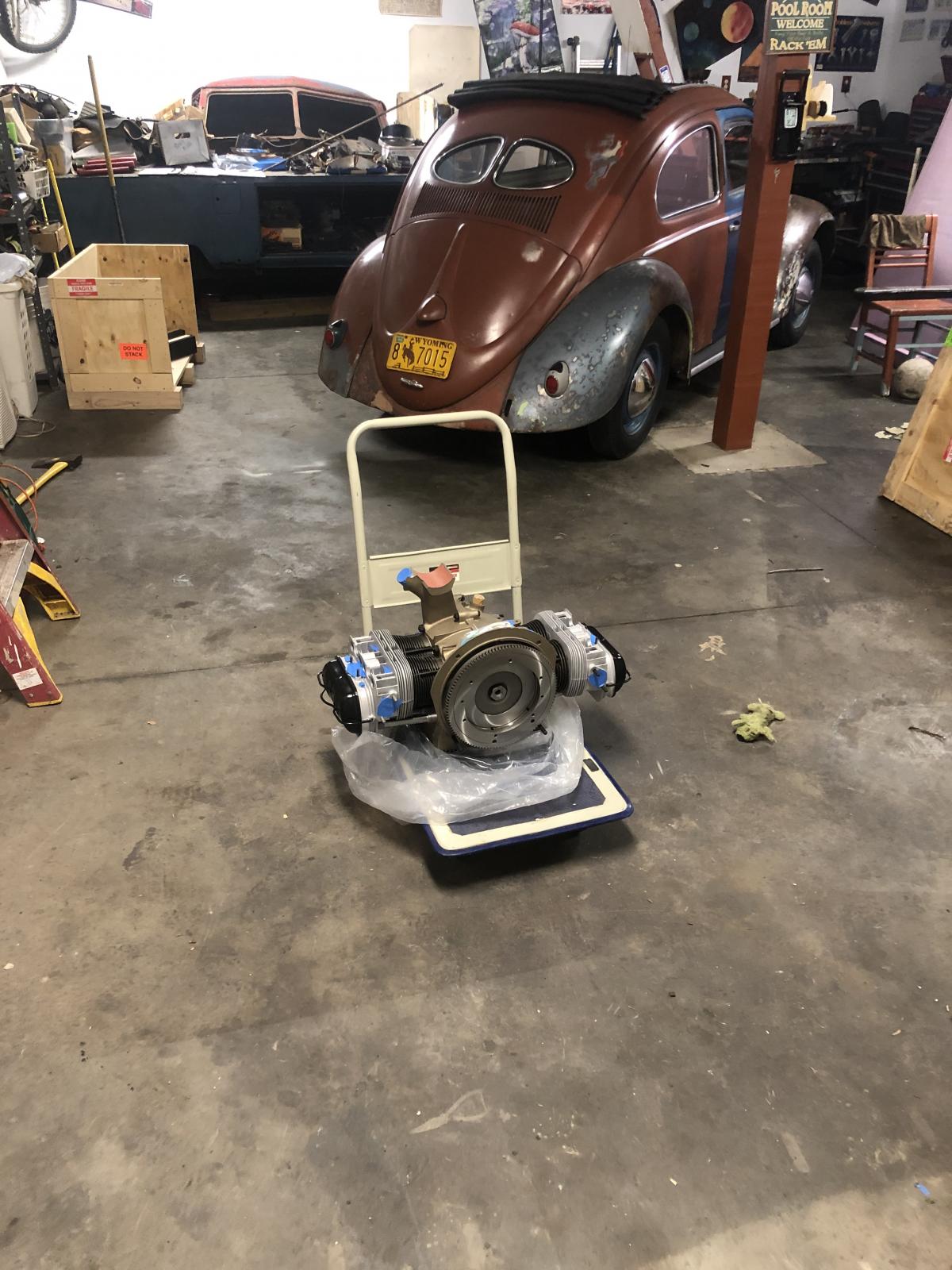

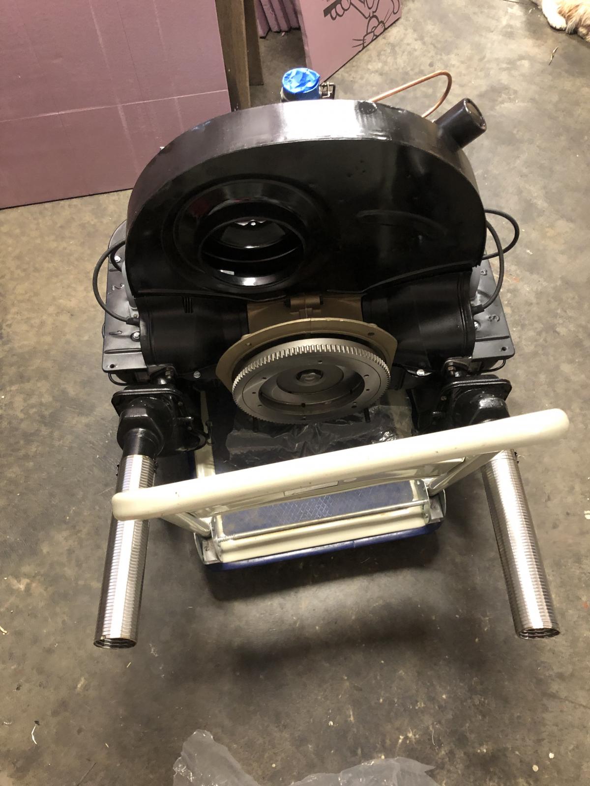

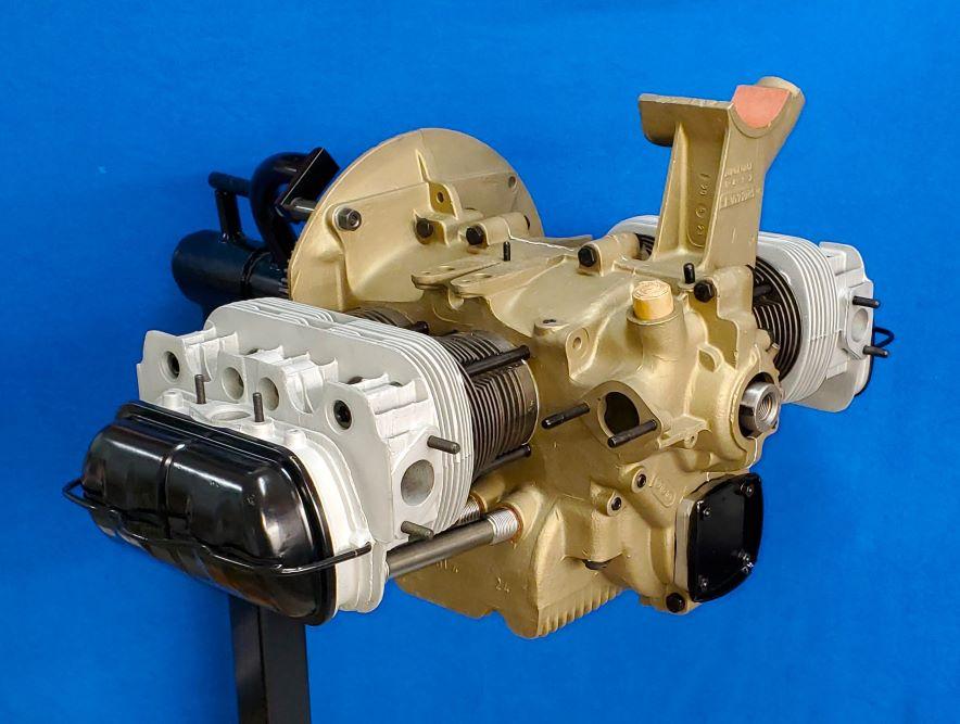

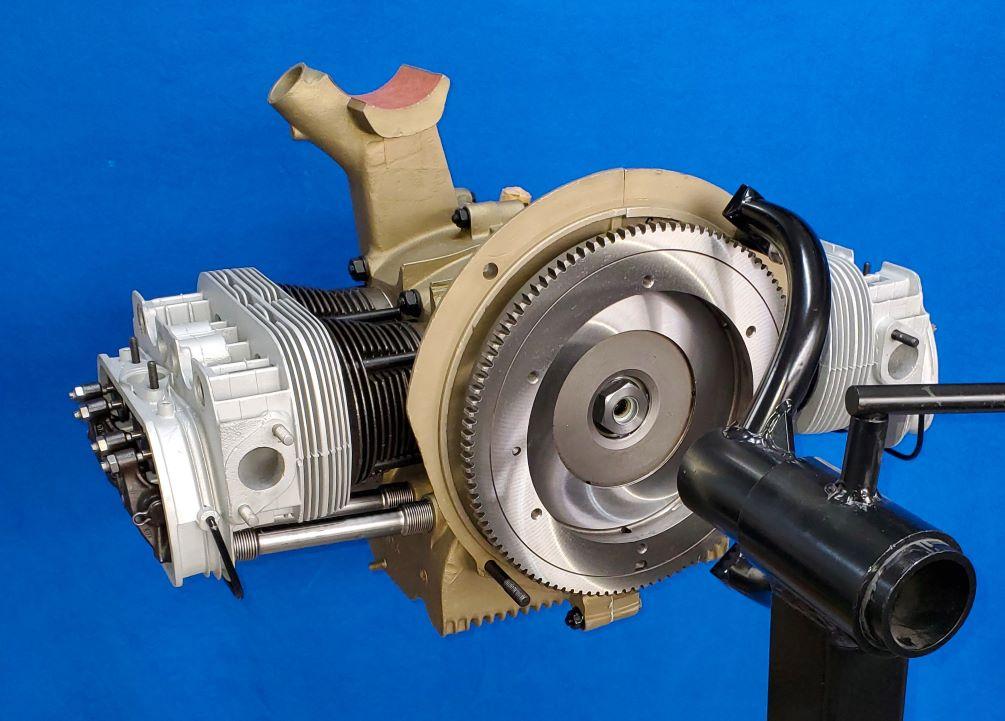

so... i had some motor parts.
and i sold them to Joe Ruiz (Mr. Okrasa)
i also bought a longblock motor from him.
he takes really nice photos. here are some of them.
it came in a big wooden crate
and looks really good in person.
november 1952 ragtop

Wow, that engine looks crazy good, probably even better than factory fresh!
Has the main case been wetblasted and is this the colour of the bare metal? Or has there been some kind of protective layer aplied on to the surface?
cleaned up magnesium will be kinda dull gray/silver. it turns to powdery white really fast.
the gold stuff is a chemical surface treatment. im not a chemist or anything like that so im not entirely clear on what it is or how it functions chemically. the basic jist is that the magnesium from the engine block can oxidize quickly. it will rust into white powdery dust. the surface treatment keeps that from happening.
my understanding is that a similar treatment was originally applied to the block from the factory.
Chromating is the process. DOW7 I believe is the Golden hued one.
Chris Childs of Childs Motorsports Chromates cases. 510-734-5977. Tell him Jimbo sent you!
Thanx, nice to know.

in addition to the protective quality and the factory correctness i also like that the motorcar has a heart of gold improbability drive like the spaceship in hitchhikers guide to the galaxy.

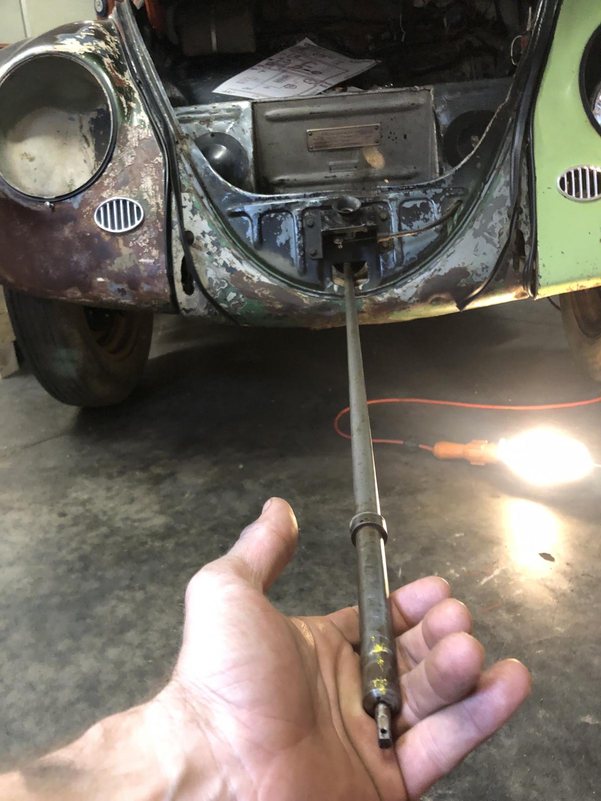

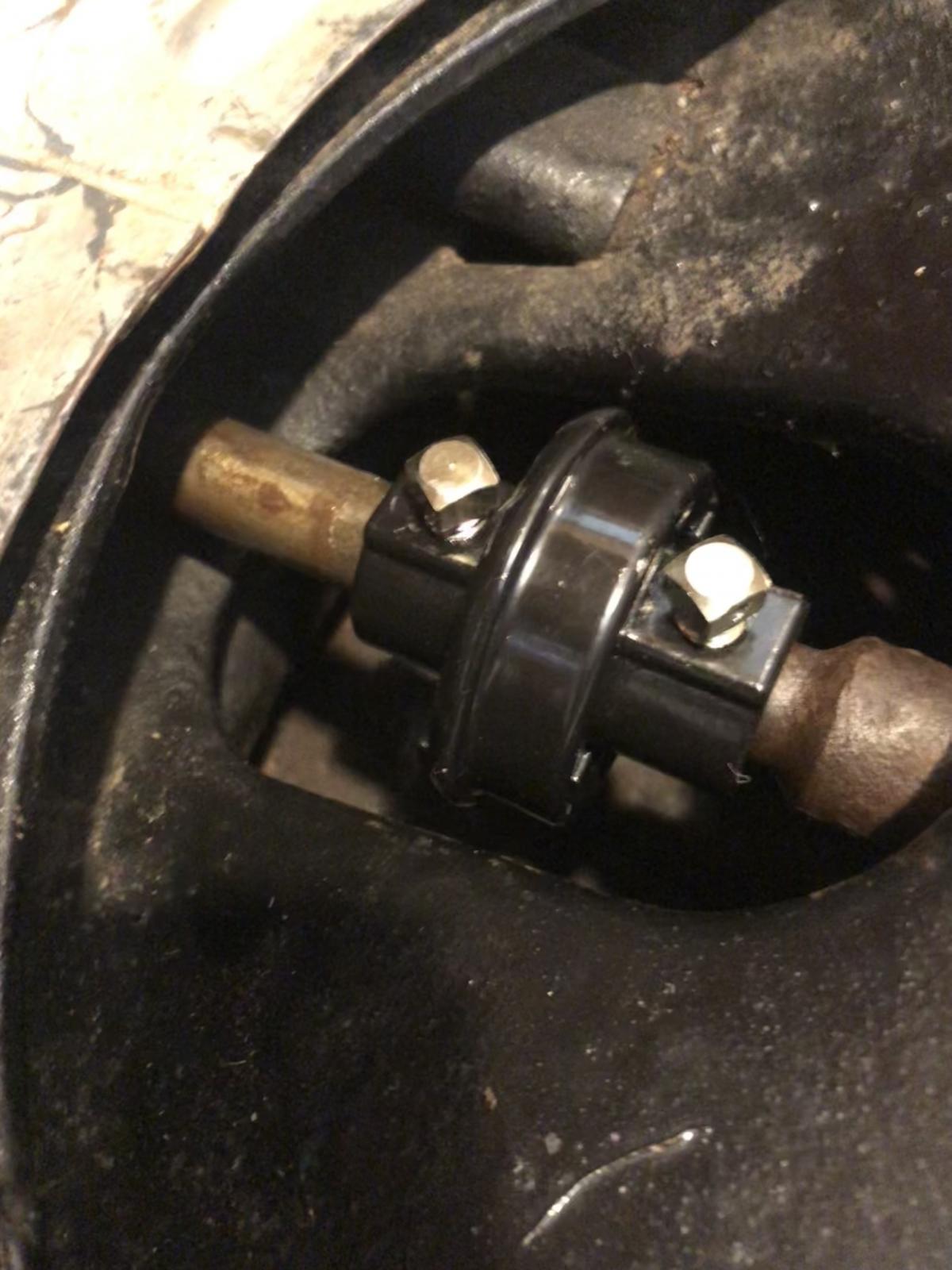

i got the shift coupler attached. this was exciting because i could try shifting it into gears. the transmission moves through all the gears!
i took some puctures down the central coumn duting that part.
running the parking brake lever. i landed the groove on the ball first try. its better to be lucky than good.

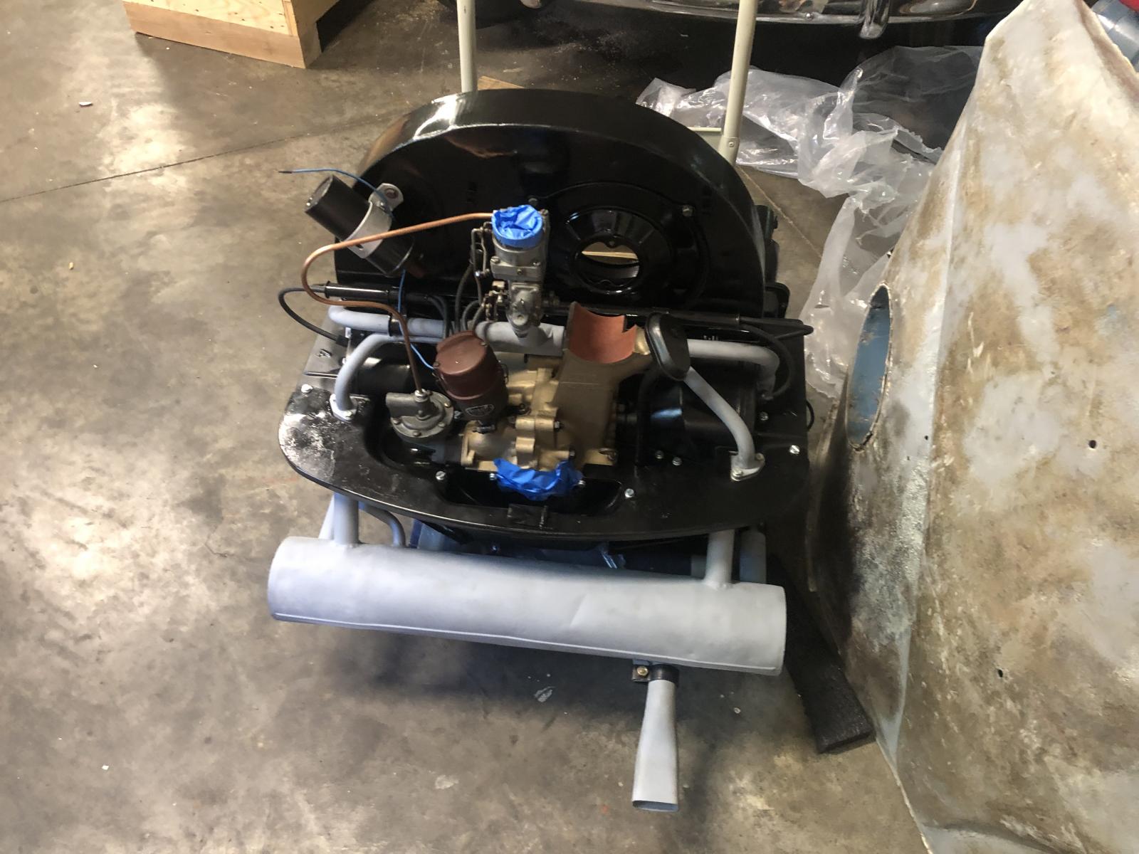

and have been making some progress on the motor

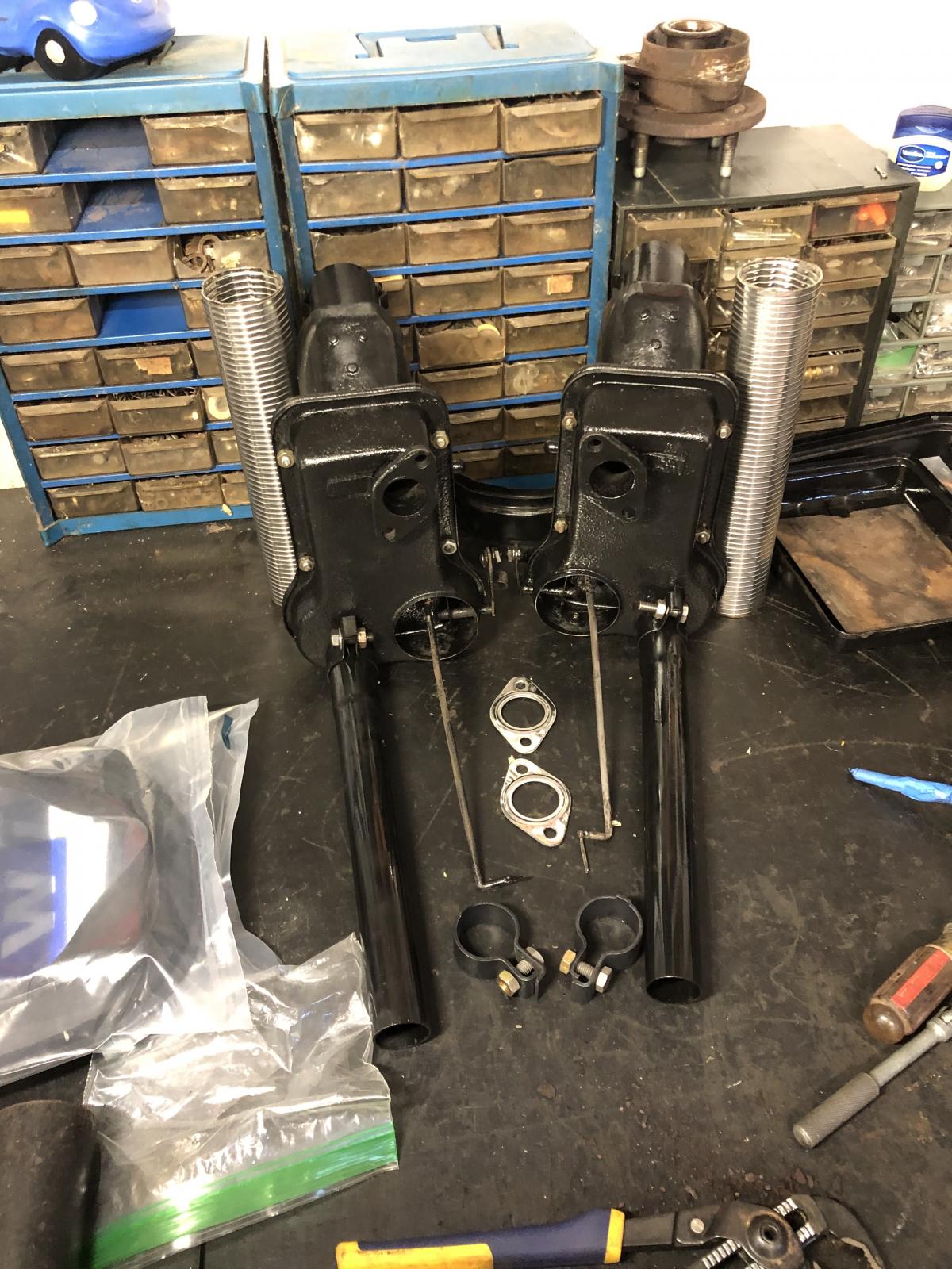

finally got the heat exchangers opened up and cleaned out. those things spent like 3 months soaking in an array of WD, PB, acetone and soapy water. i negelected to take internal photos but i would have happily eaten off of them.
motor is getting closer

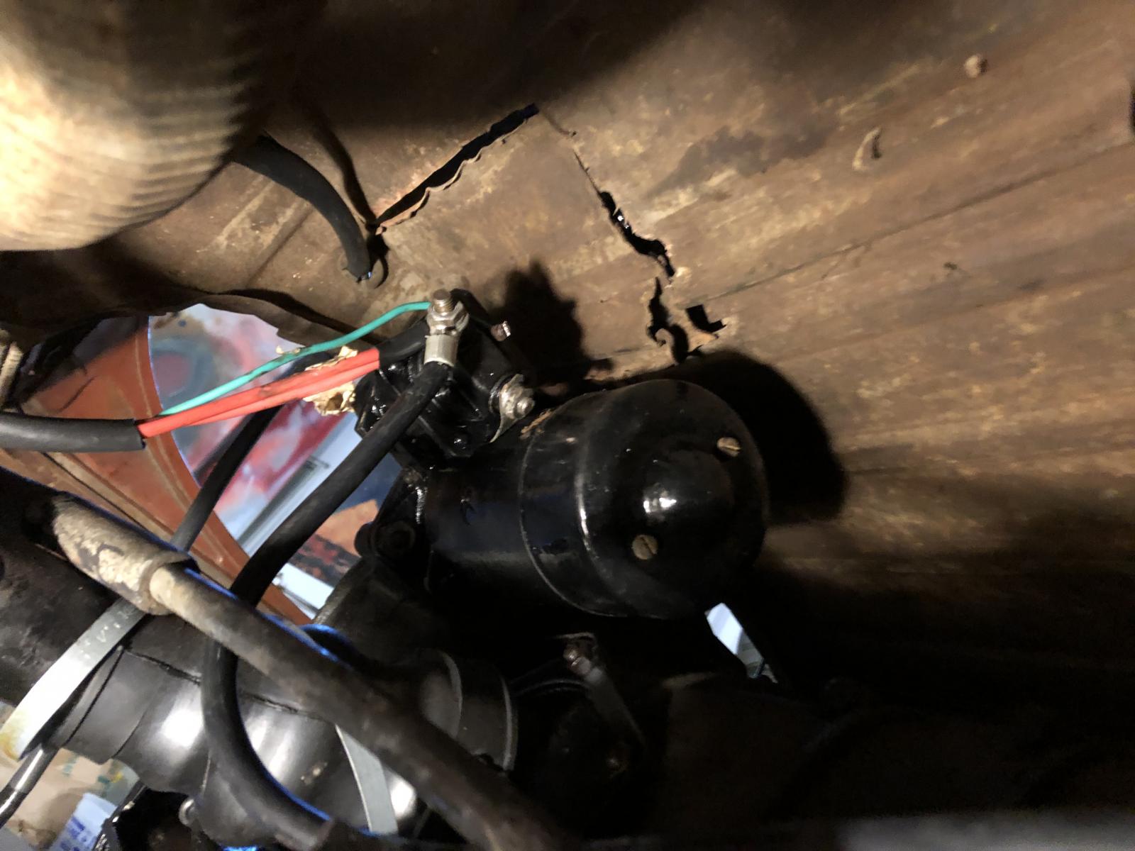

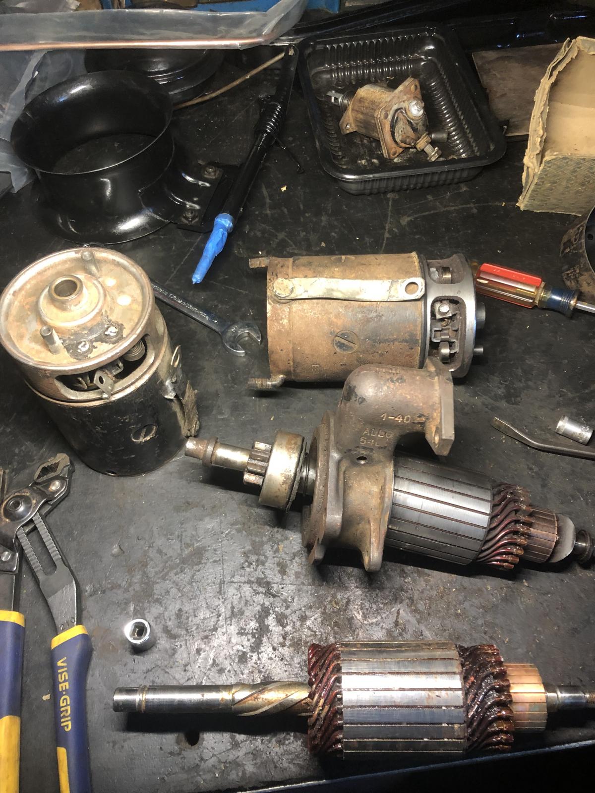

rebuilt a starter motor. this one is a 4R so april 1960. the internals looked pretty good. small detail i noticed - it had 4 brushes... the 1953 that i have with the truck has only 2 brushes.
here you can see the easy starter motor access panel a previous owner cut into the luggage tray. im not a wleder and im not learning today. there are a couple hidden shame type spots like that. ill look back to them eventually. at the beginning of this project i elected not to address purely aesthetic metalwork problems untill after i had driven the car for some time
