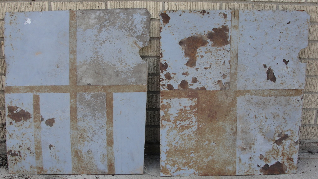

| Lee. wrote: |
| Lee. wrote: |
Here is the orientation of the panels.
I'll make sure to label each picture from now on. |
I found the panels and tossed them in the trash last weekend. Here's the final pic....In the end, after 5 years, nothing worked.
from the looks of the results it looks like the rust bullet did the best. _________________ Missouri Micros |

Posted: Thu May 31, 2012 10:27 am Post subject: HOLD YOUR VOTE UNTIL SEE THIS!!! |
Guys, just wanted to correct a discrepancy in the picture orientation:
My 2 c. -Y.
| Lee. wrote: |

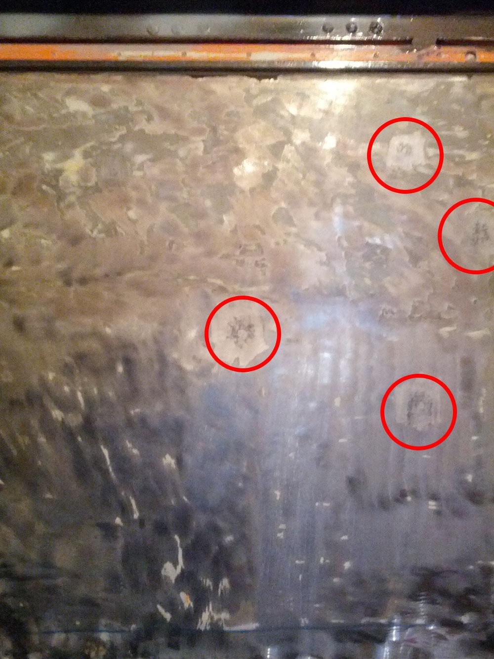

The toughest part of rust treatment is never knowing the long term results of your efforts, so when I was stripping down the side of my bus on the weekend I was actually quite excited to discover a bunch of small areas that look to have been previously treated with a phosphoric acid product (highlighted with red in the photo below).
Given how I'm pretty sure the paint job is at least 10 years old, I was VERY impressed to see that the rust hadn't returned at all. There were a few very small brown spots, but I believe that was because I ripped the "converted" rust off while stripping the paint.
I should also mention that it was only sealed with what looks like rolled on house paint and no primer, and I believe spent the last decade mostly sitting outside. After seeing these results, I'm going to use Rust Mort + sealing primer for all my remaining repairs.
Hope this helps other people! |
