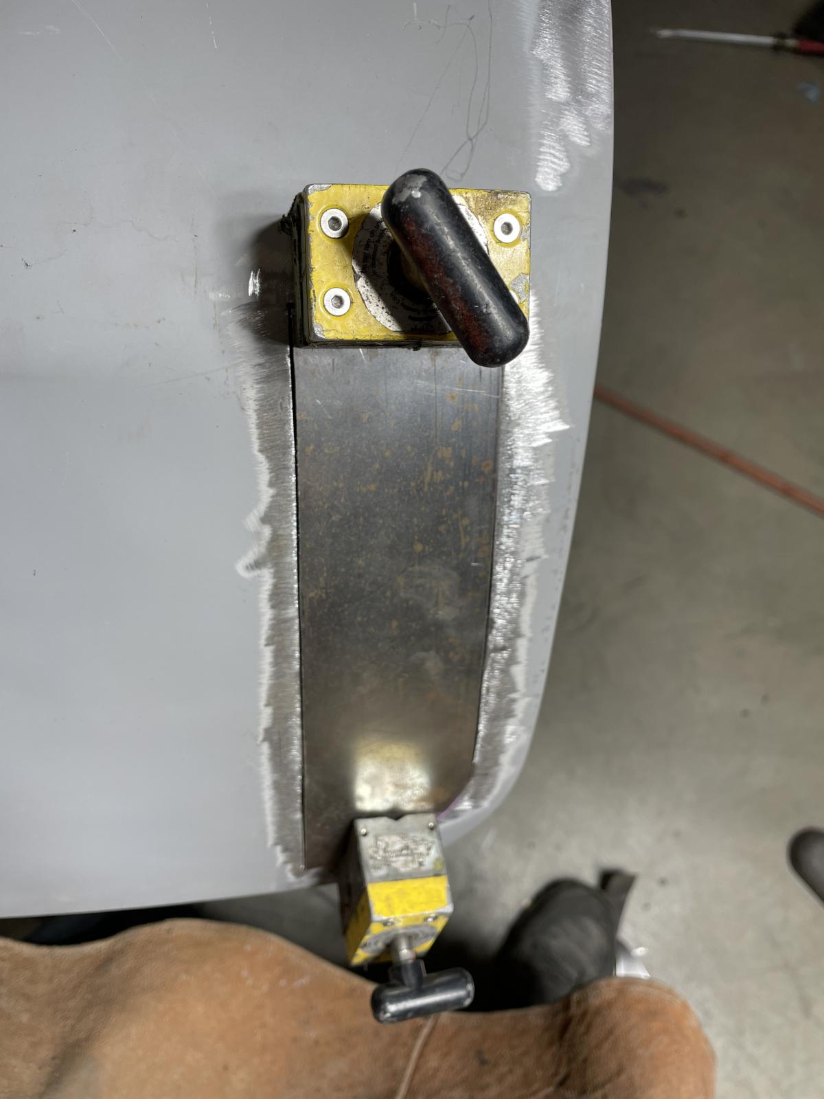

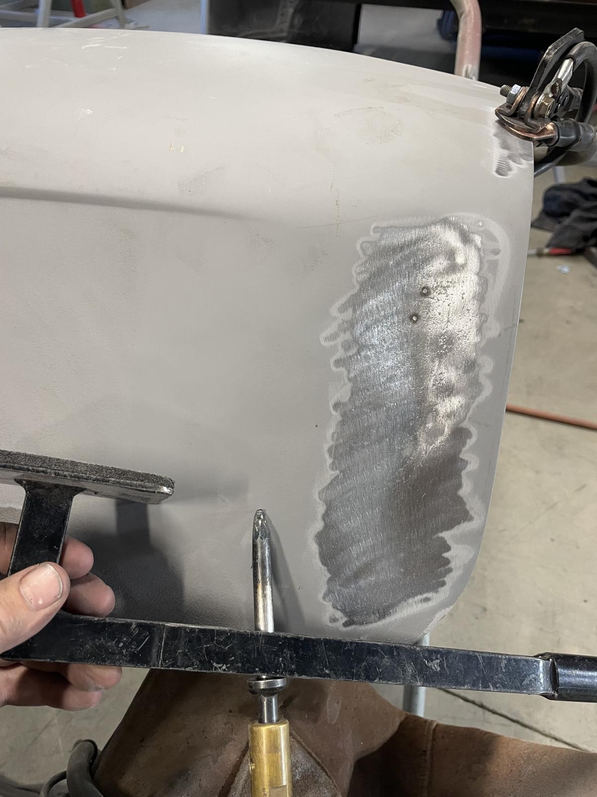

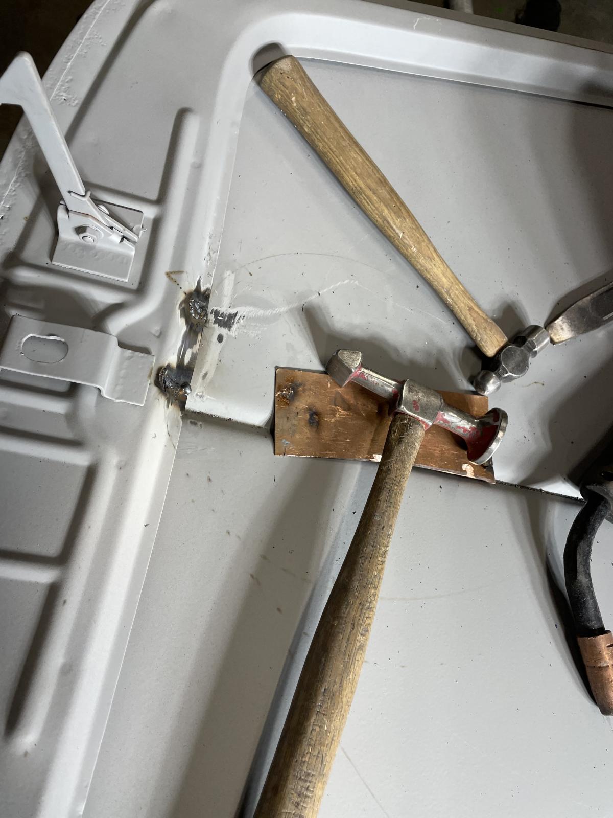

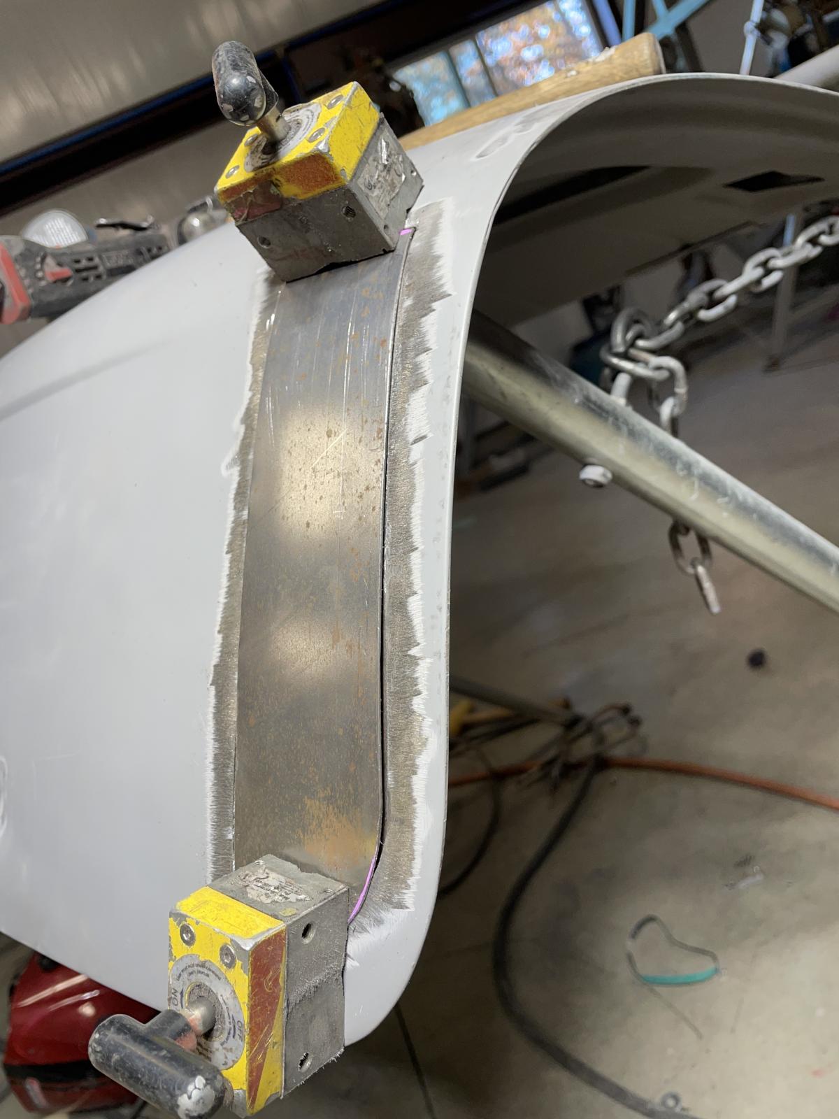

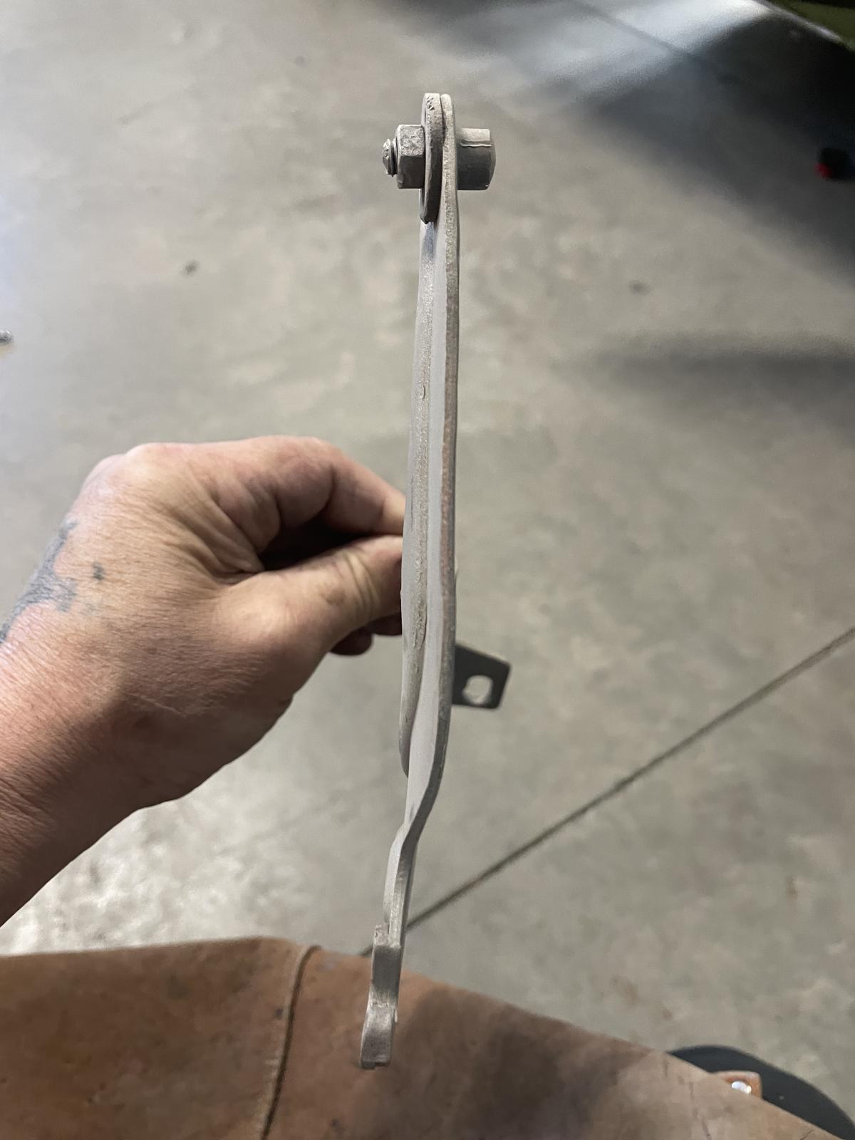

Once I pulled all the stretched material up it is now too high and will need to be shrunk back down into position. I will use this shrinking electrode with compressed air to make that happen. This is somewhat of a time consuming process but definitely rewarding to see the repair come full circle.

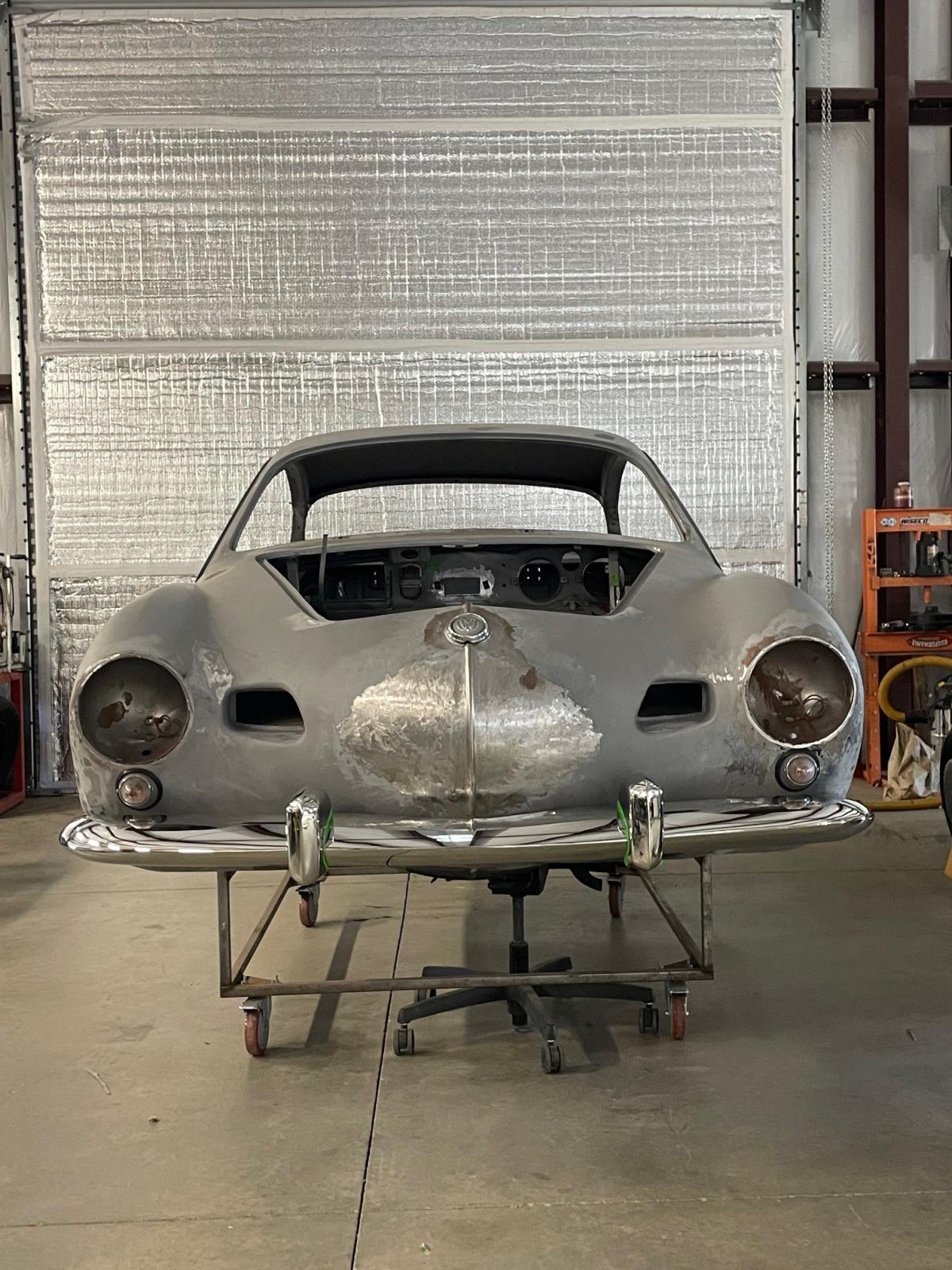

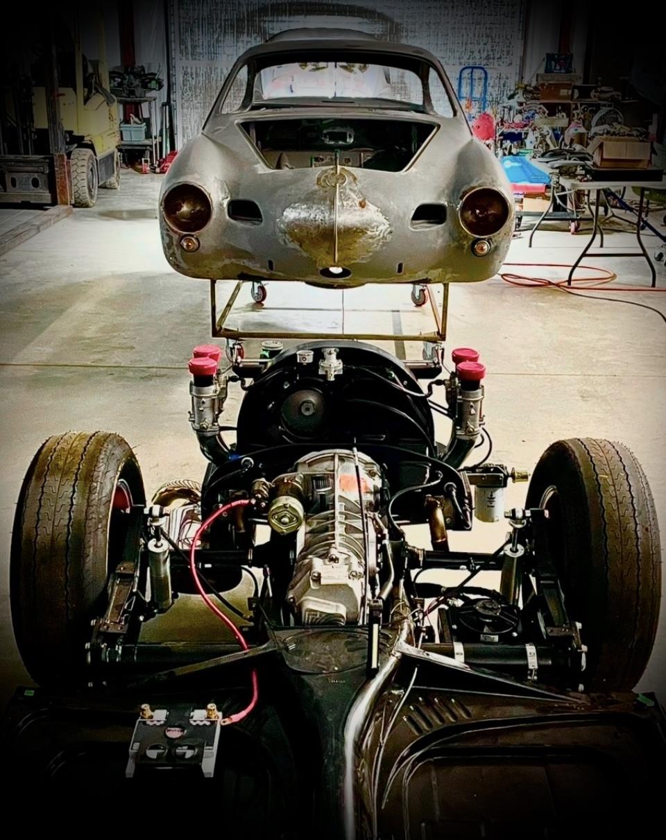

PostPosted: Mon Jan 06, 2025 1:07 pm    Post subject: Re: 58 Ghia Restoration Begins Reply with quote

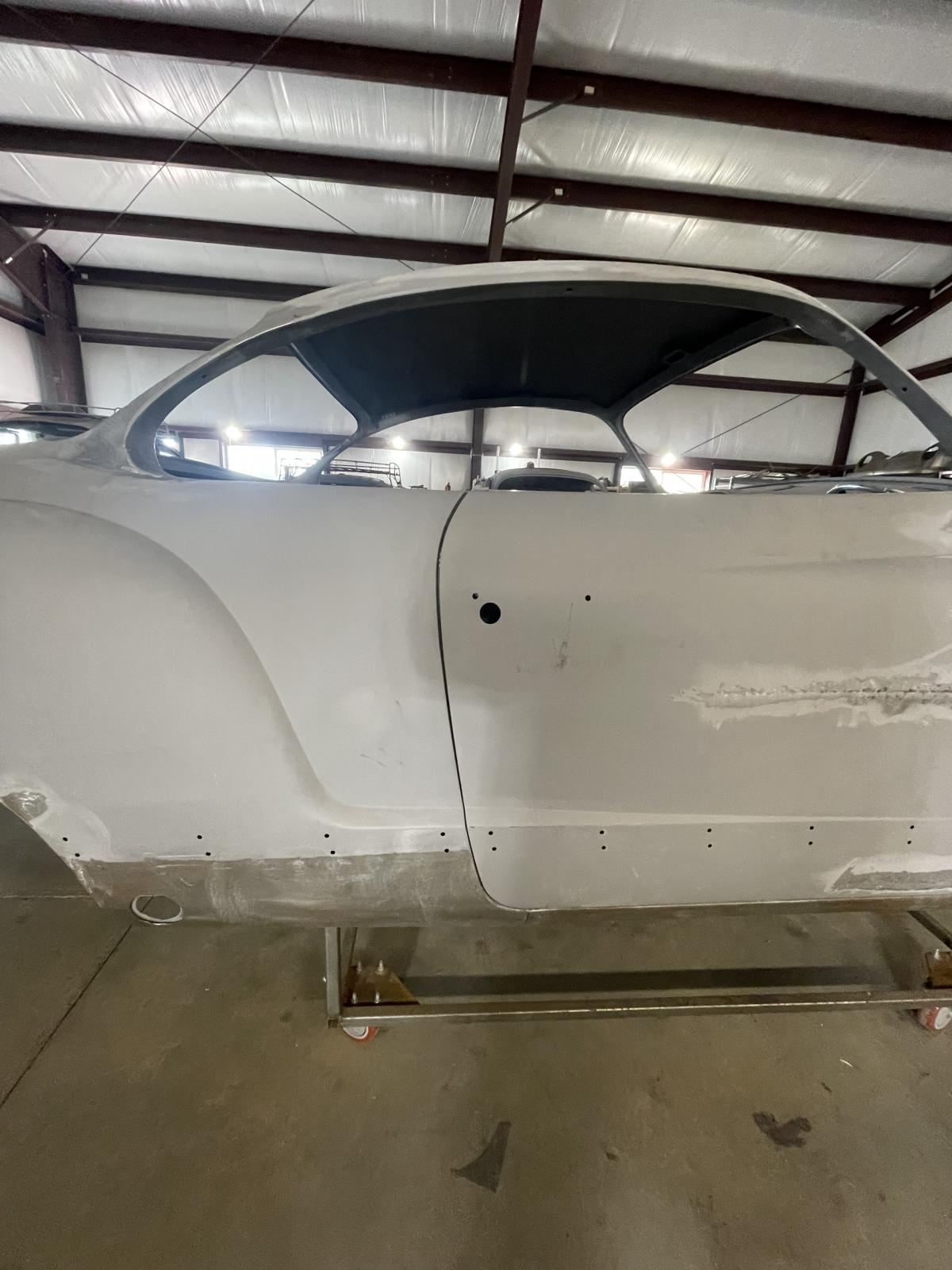

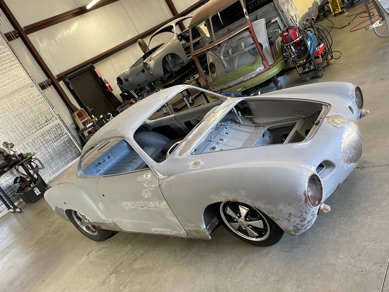

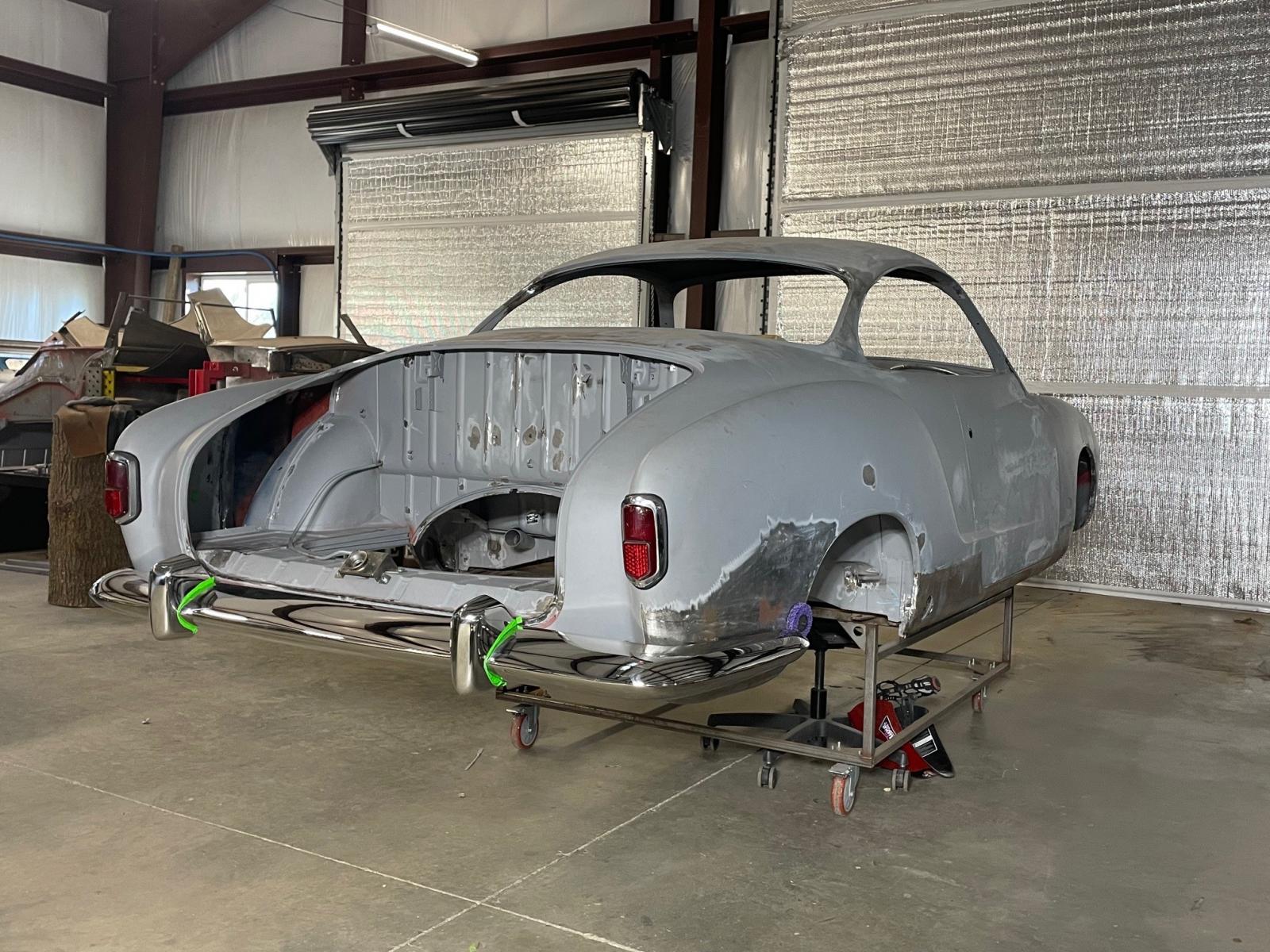

Sneak peak! The body is almost / kinda back on the pan.
'58 Ghia 2387cc with a Berg / Folts 5 Speed
Ghia Build Thread https://www.thesamba.com/vw/forum/viewtopic.php?t=768748

That looks great. What a transformation! It's amazing how quickly Jason tackles all these repairs and brings these cars back to their original glory.

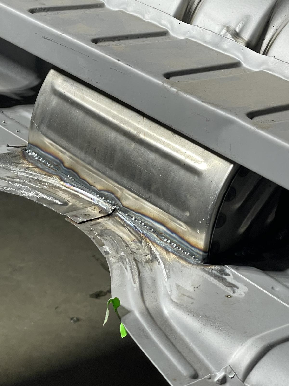

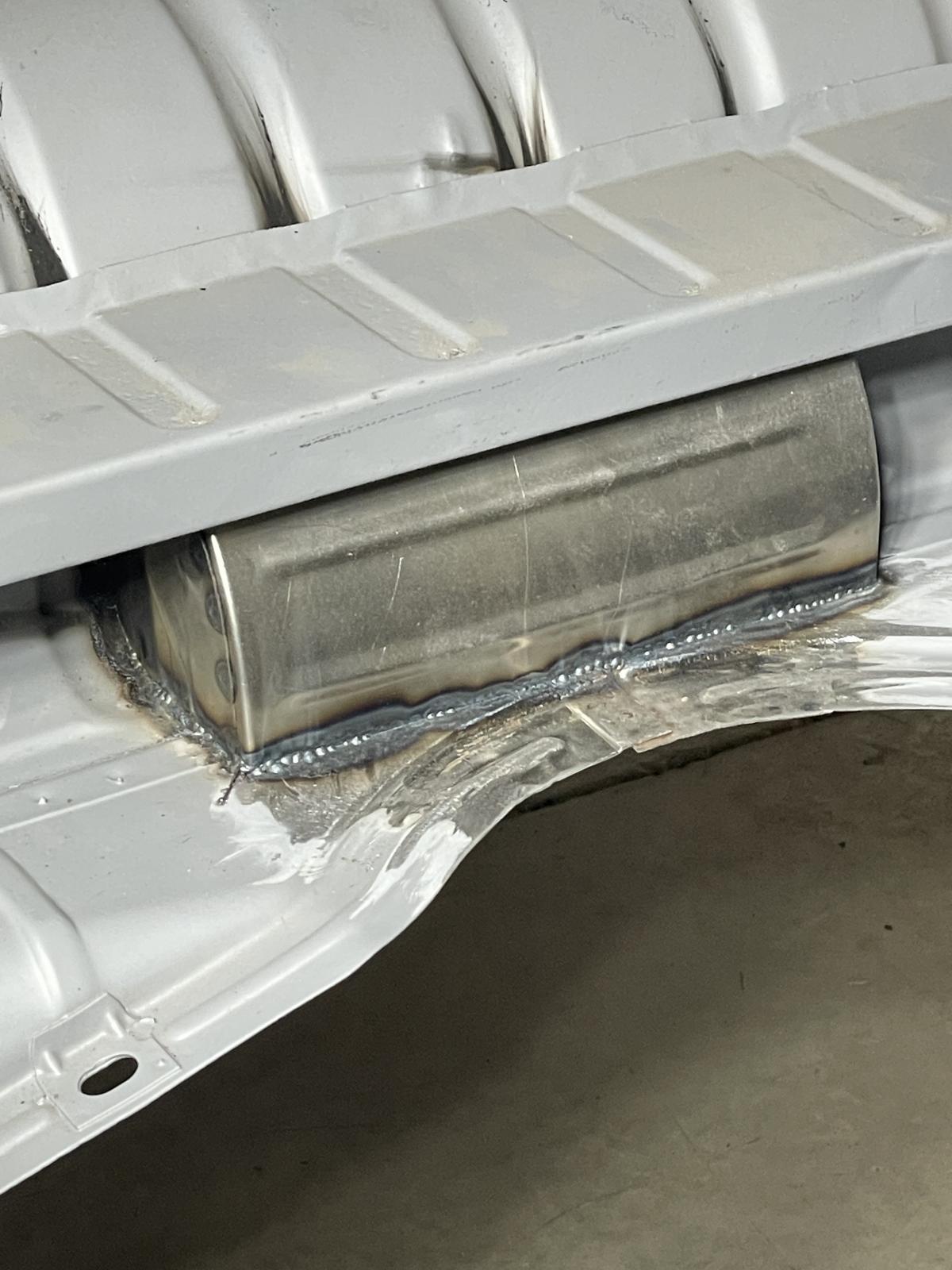

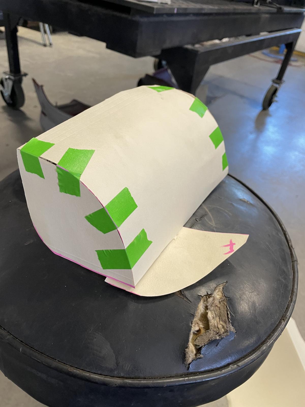

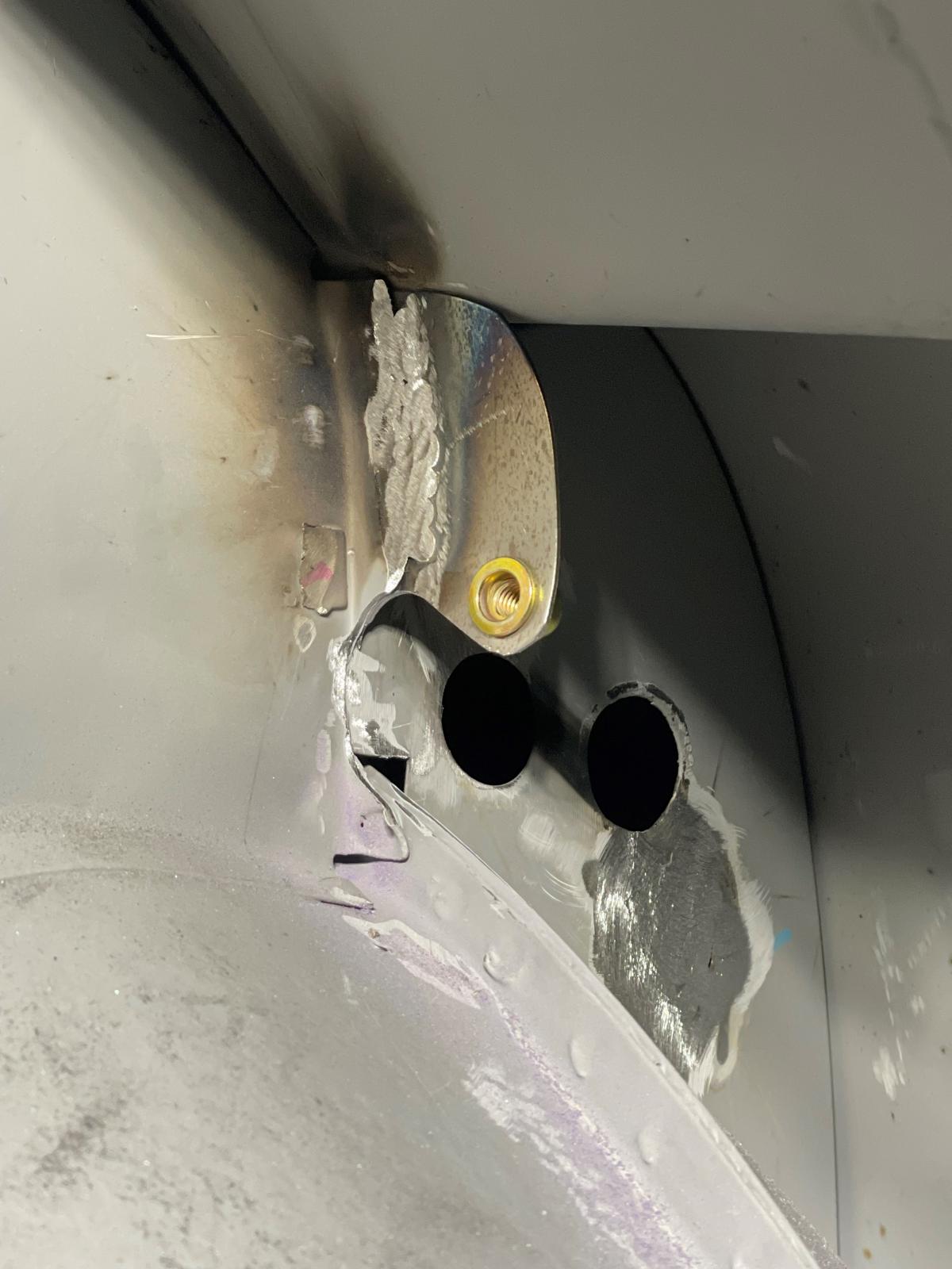

I will sneak this in from the back once I lift the body back off.

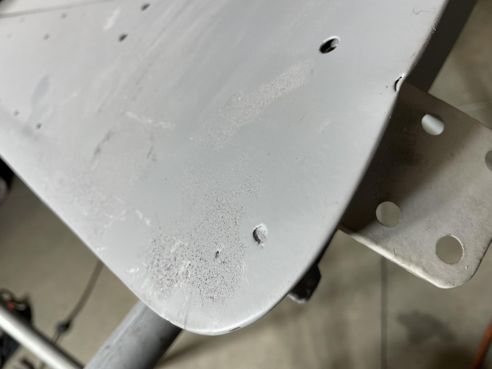

PostPosted: Tue Jan 07, 2025 10:18 pm    Post subject: Re: 58 Ghia Restoration Begins Reply with quote

TRS63
Joined: December 17, 2017
Posts: 1127
Location: Stuttgart - Germany
TRS63 is offline
PostPosted: Wed Jan 08, 2025 8:10 am    Post subject: Re: 58 Ghia Restoration Begins Reply with quote
Clean way of solving this space issue Cool

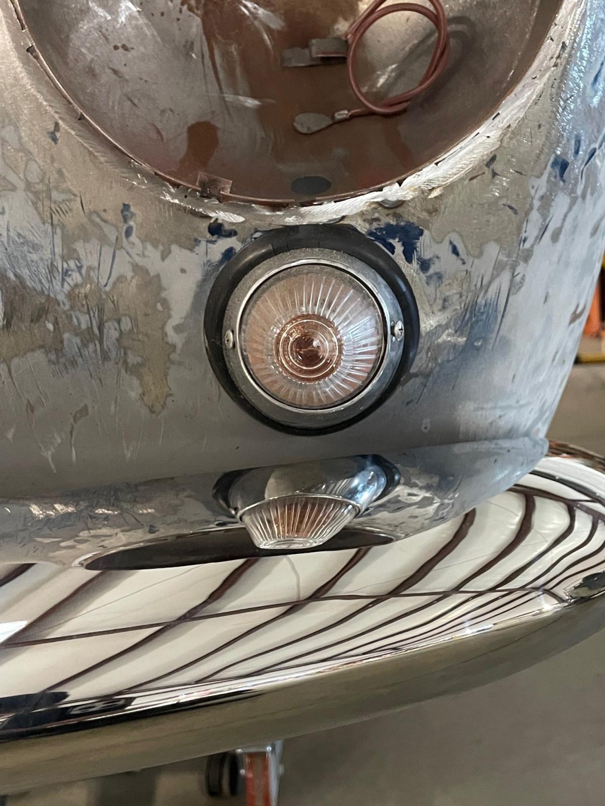

VeloMikey
Joined: March 19, 2012
Posts: 765
Location: So Cal
VeloMikey is offline
PostPosted: Wed Jan 08, 2025 9:31 pm    Post subject: Re: 58 Ghia Restoration Begins Reply with quote

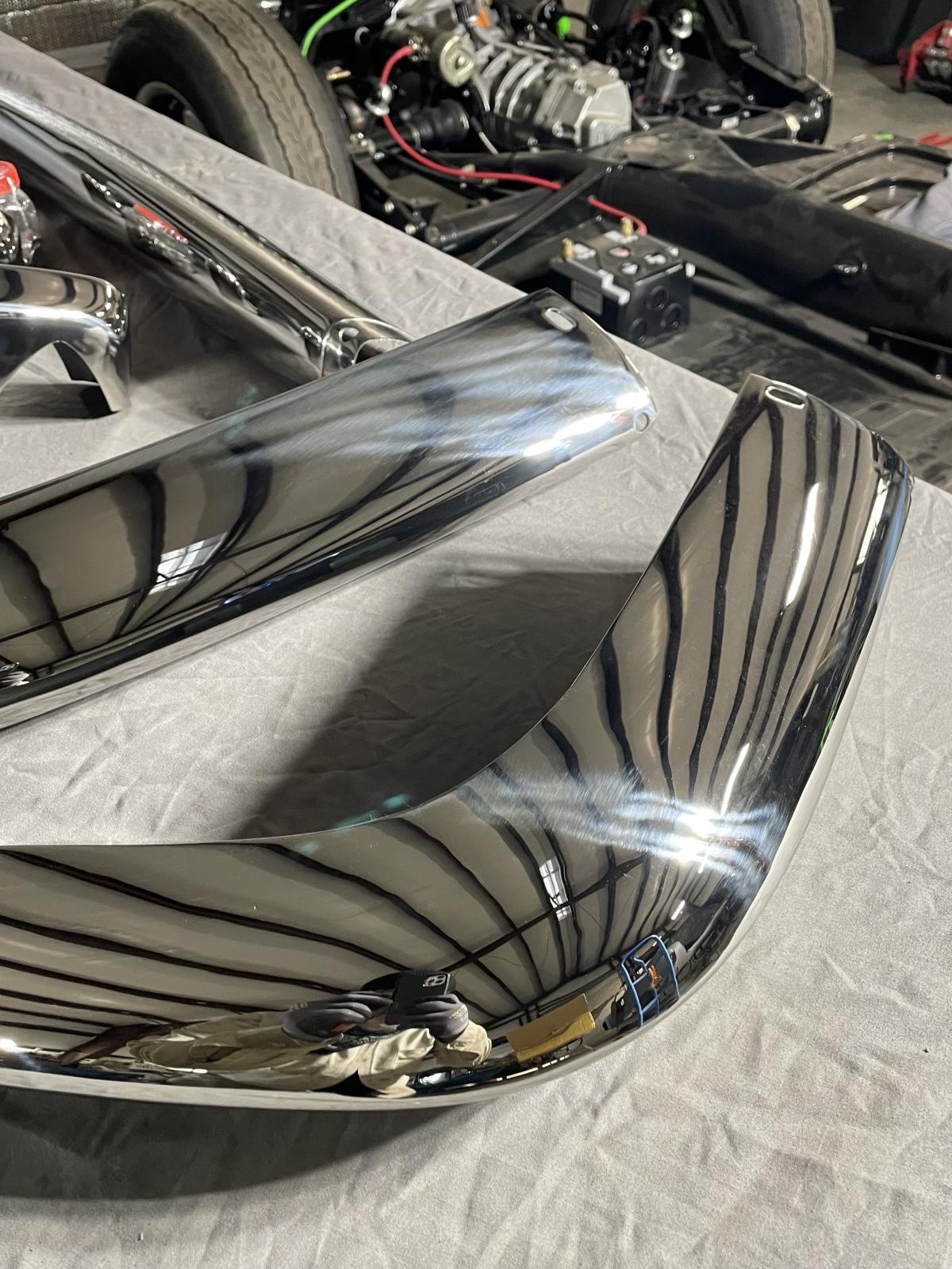

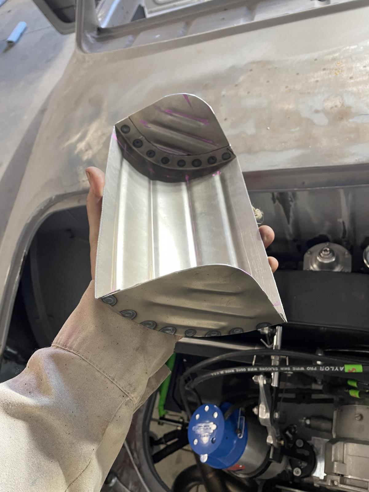

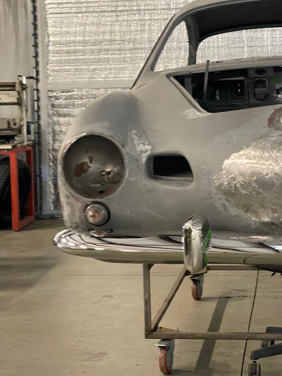

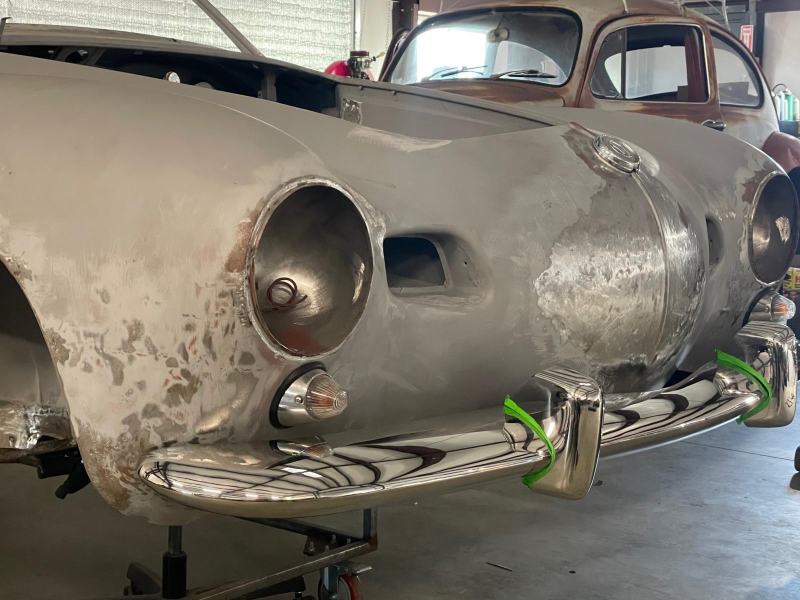

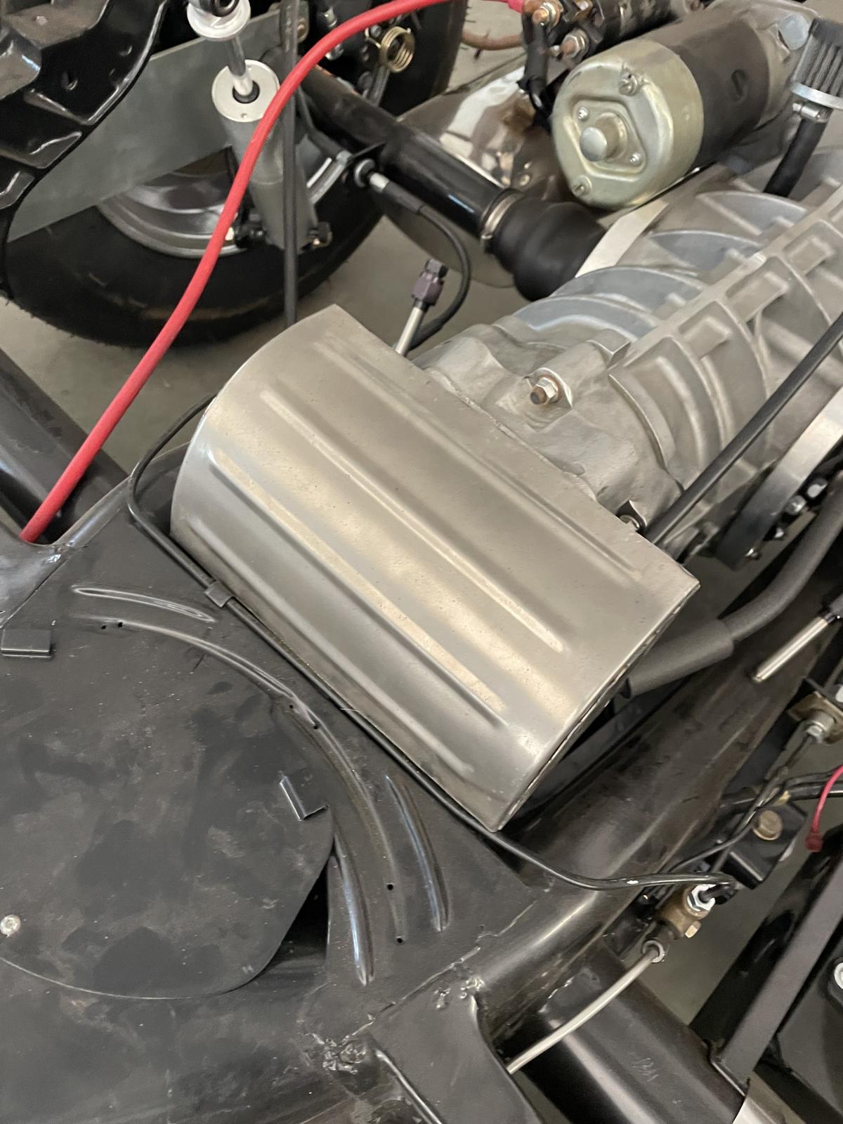

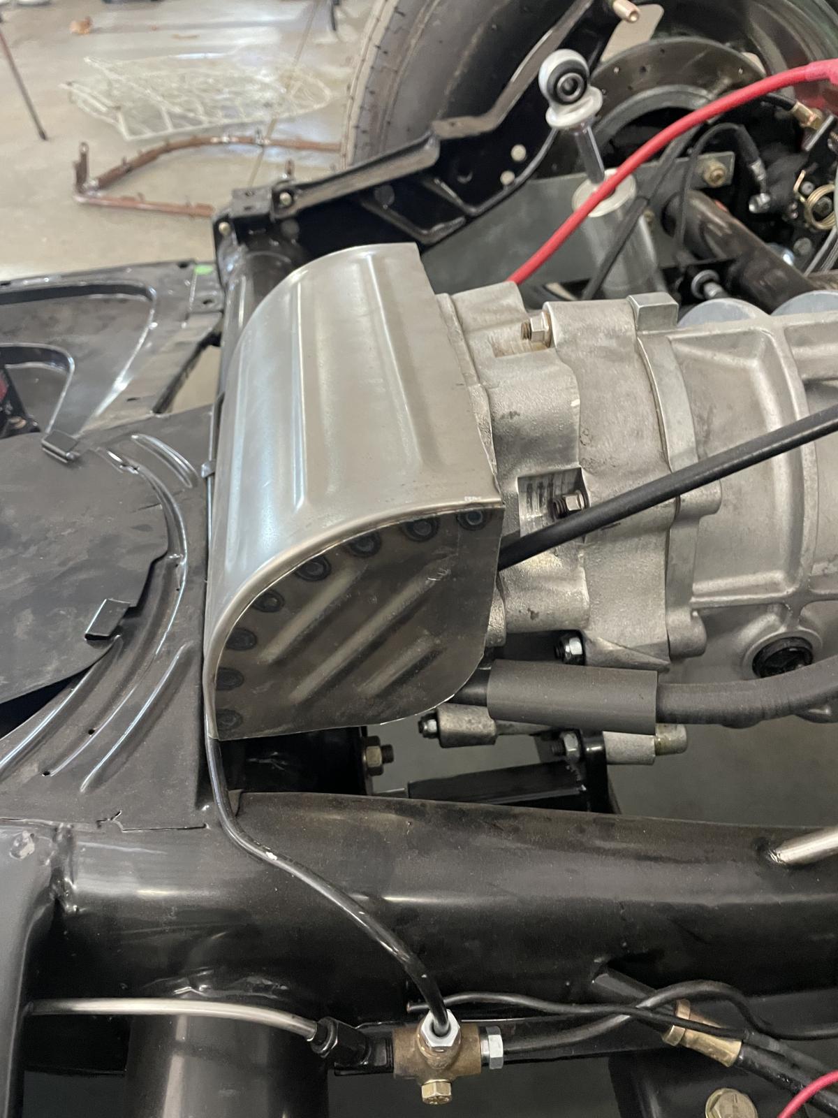

Here are a couple more photos of the Berg / Folts 5 Speed bump cover.
Jason did a little more clean up on the back of the nose. With a little "body work" you won't even know it was replaced.

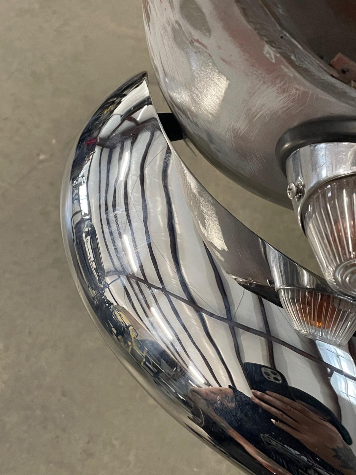

I decided to go with Stainless Euro bumpers since my car does not have the rear bumper supports under the apron. I bought them from Helen in the bumper thread for $450 plus $170 shipping.
She stuck a surprise $29 PayPal fee on there too. I couldn't justify having Jason weld up the overrider holes on the original bumpers and then have them chromed for $3000.
Plus I like the way they look on the car. Maybe someday I will rechome them and put them back on. At least I have the option now. I had them shipped directly to Jason.
They showed up a day early. The chrome / polish job on them looks good from 400 miles away. He is going to assemble and fit them this rotation so we can get his feed back.

Looking forward to seeing the bumpers put together and on the car.

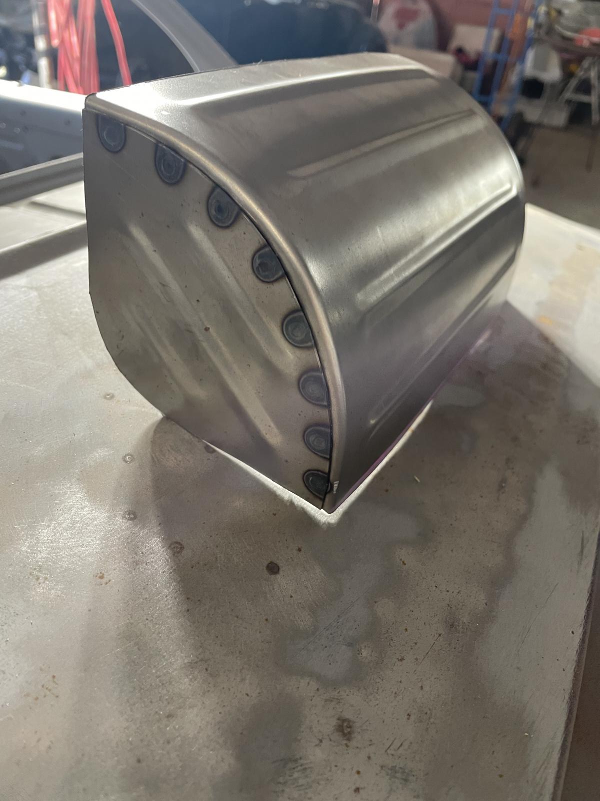

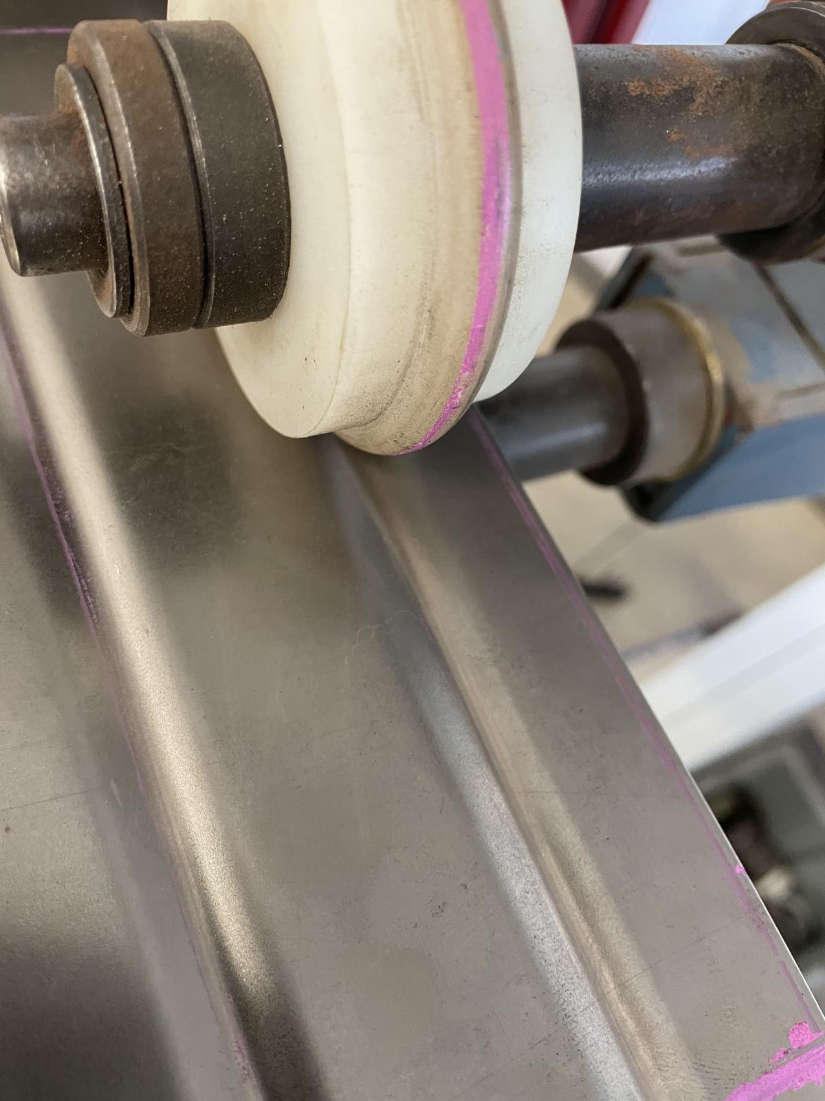

I did the inside grinding on the trans cover this morning it looks rite at home now…. I will post a pic of it tomorrow

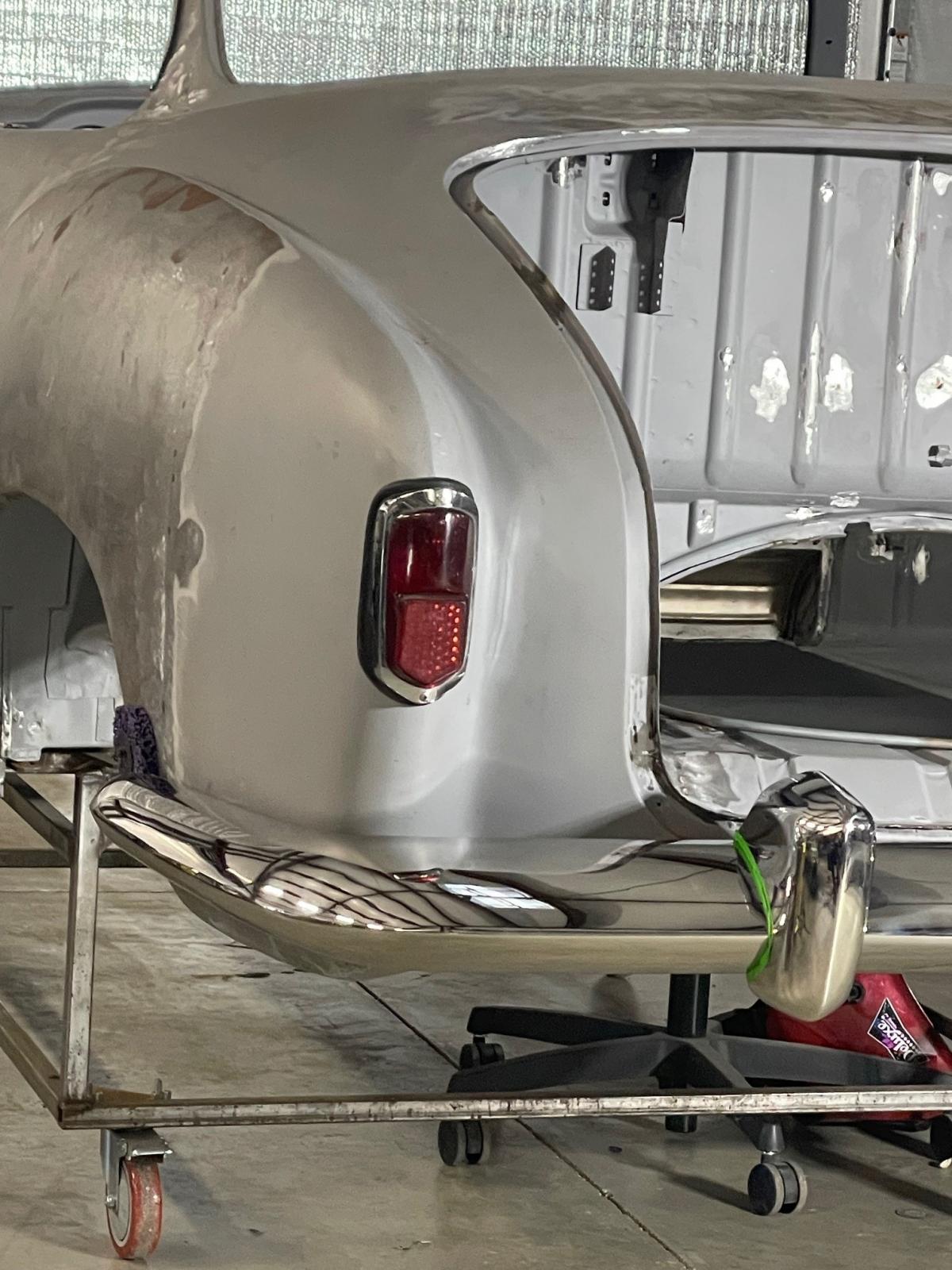

PostPosted: Fri Jan 10, 2025 11:47 am    Post subject: Re: 58 Ghia Restoration Begins Reply with quote

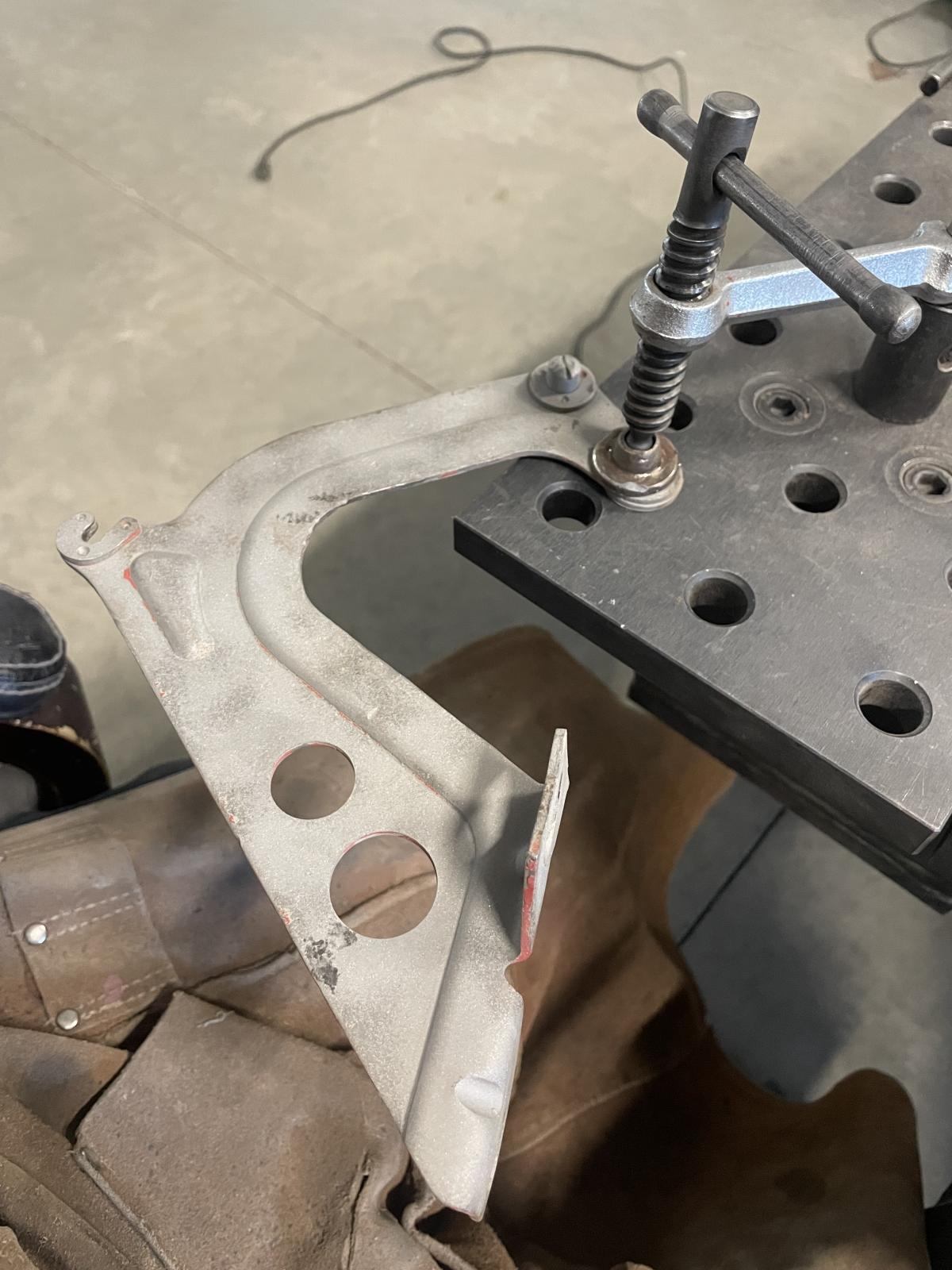

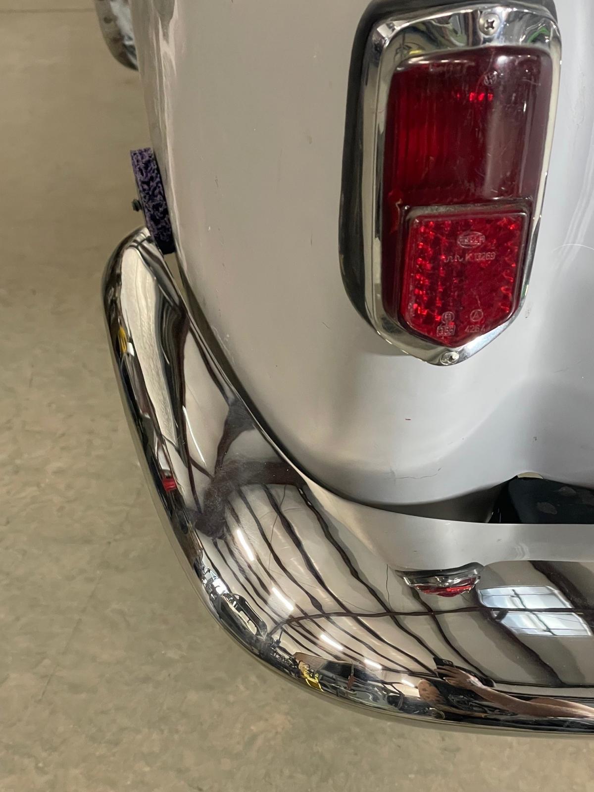

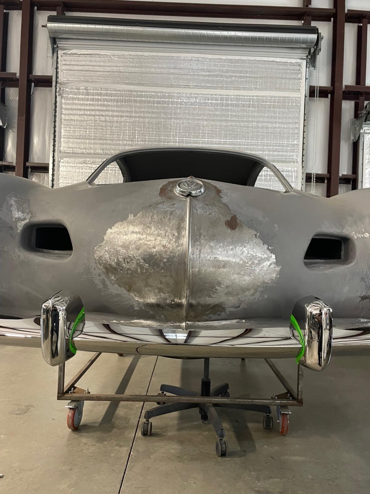

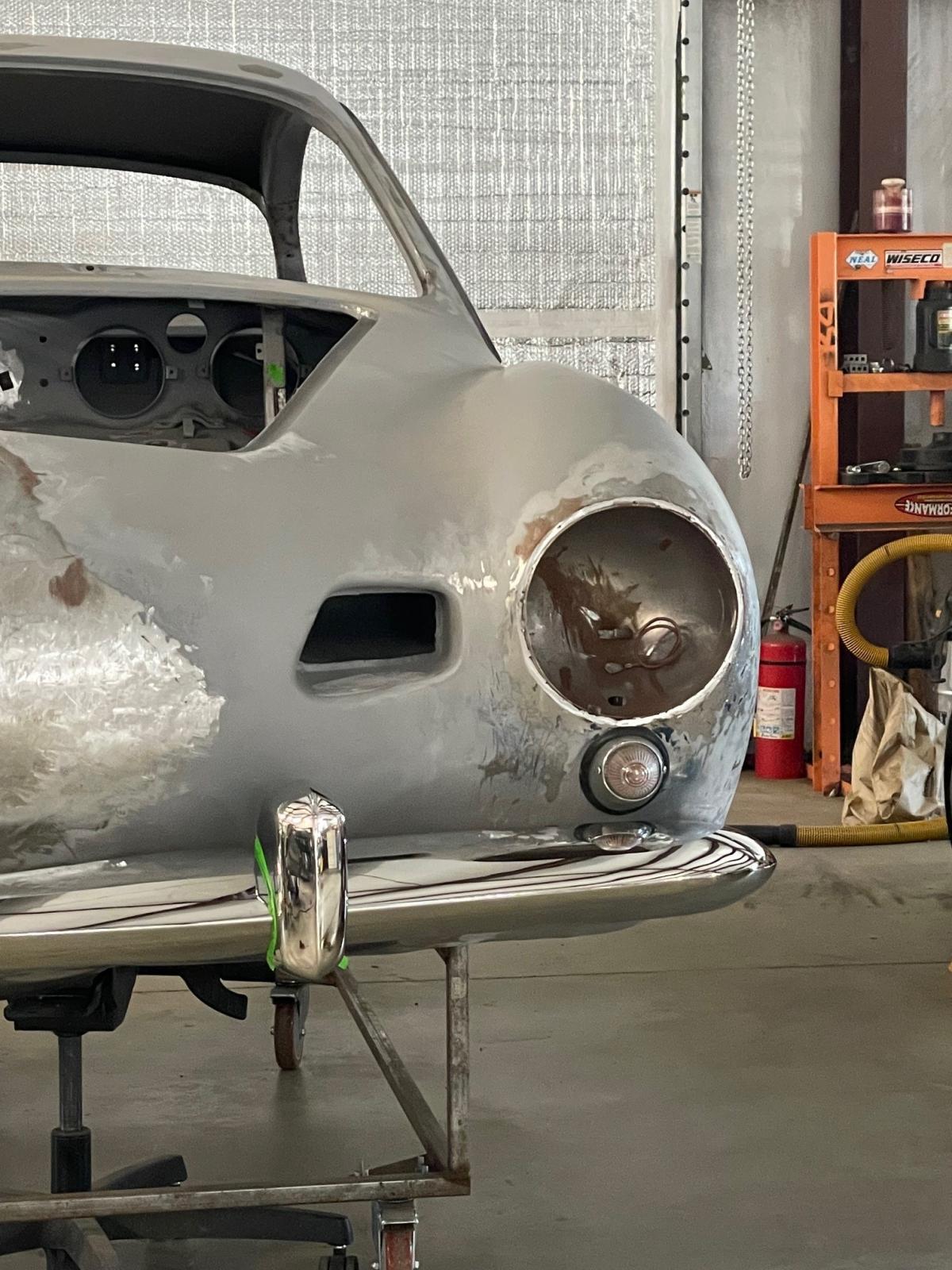

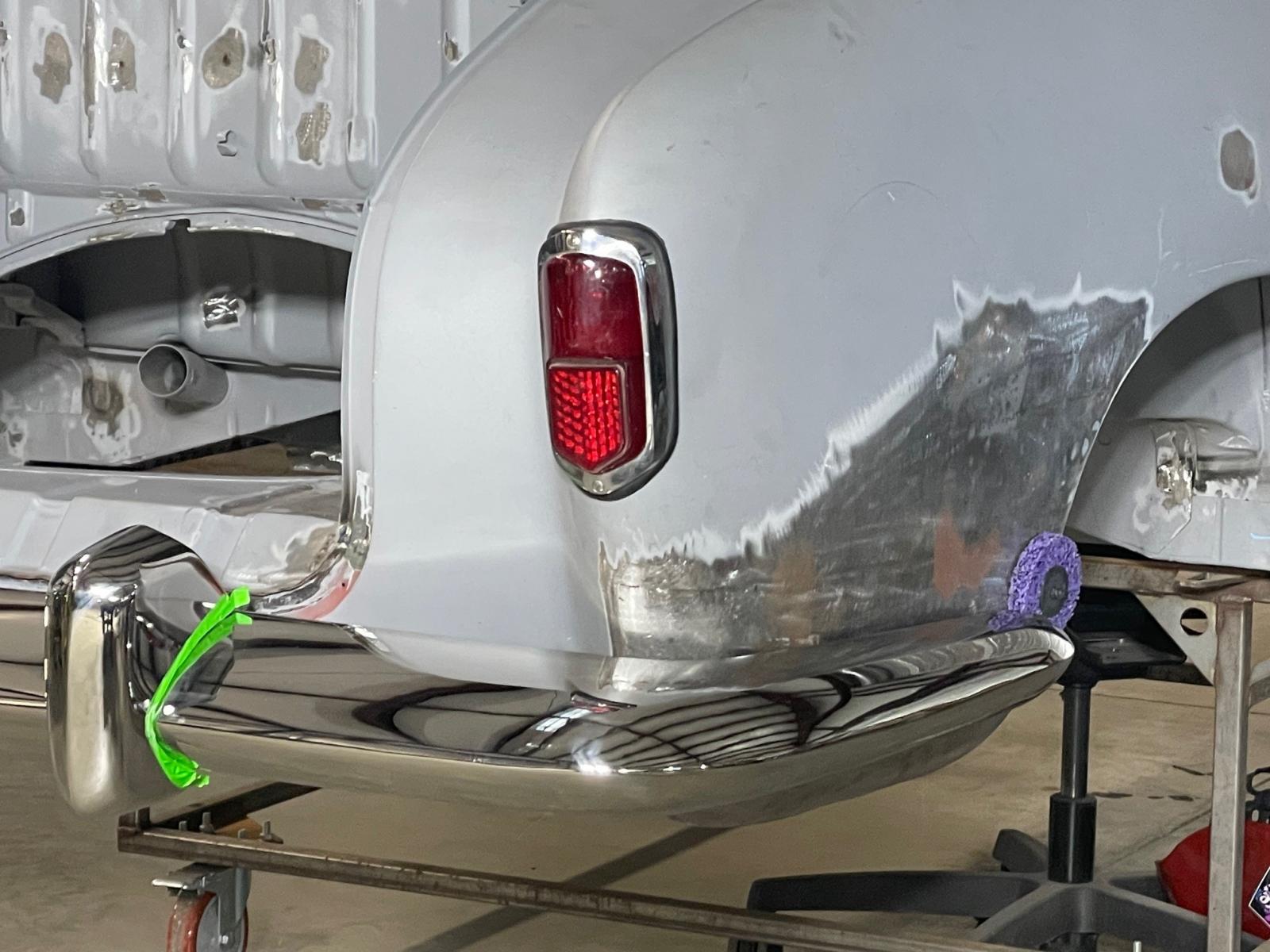

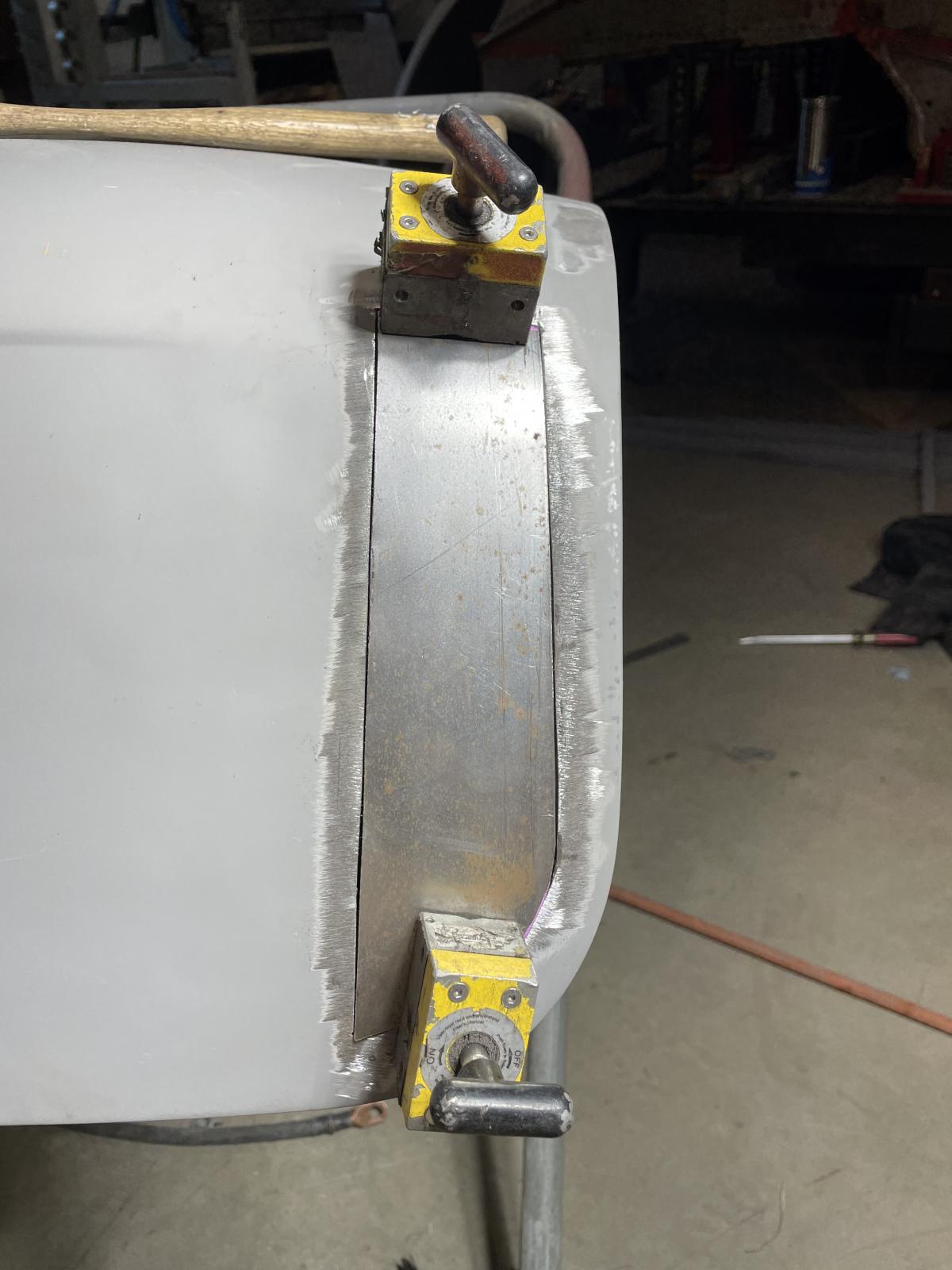

Jason got the Stainless bumpers mounted up yesterday. The back bumper went on without incident and gaps are really good.
The front bumper is a different story. The driver's side corner bolt tab had to be cut and rewelded in a different postiton. The finish and gaps are great here too after the modification. Next up is welding up the over rider holes in the bracket covers and geting them fitted.
