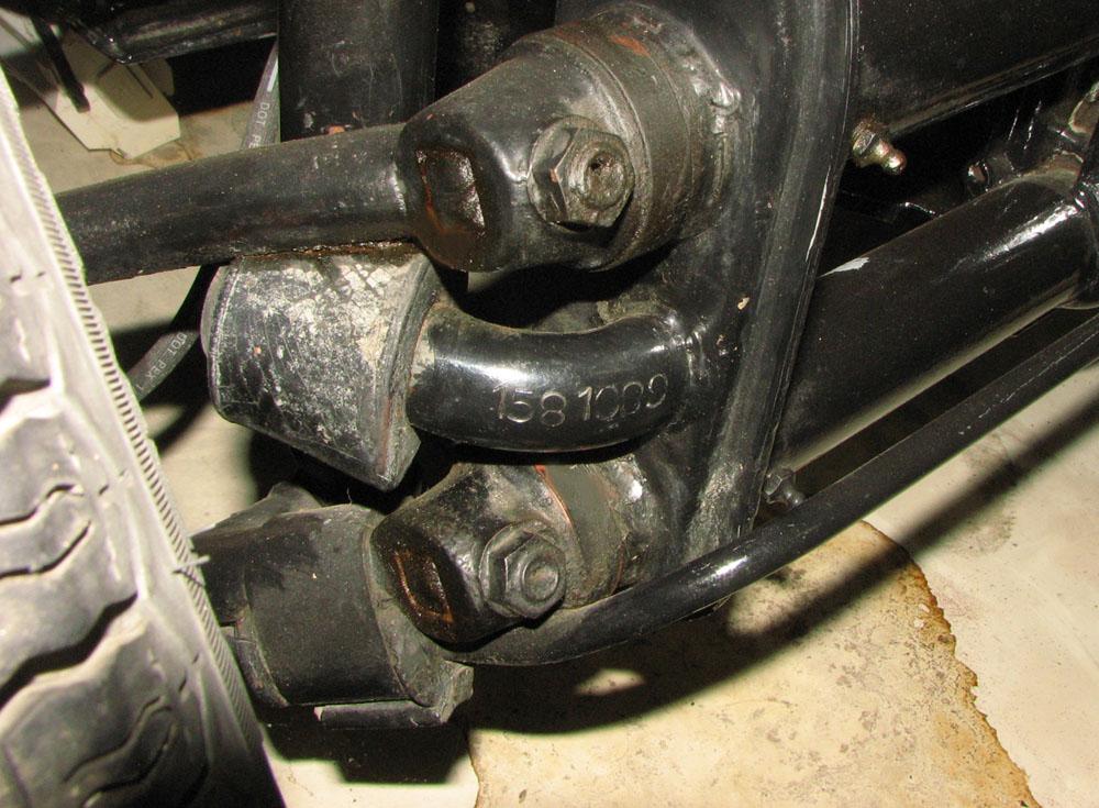

Where are the locations for the serial numbers for the front and rear axles on a 63 beetle?
mukluk
Joined: October 18, 2012
Posts: 7452
Location: Clyde, TX
mukluk is offline
PostPosted: Fri Mar 07, 2025 6:22 pm    Post subject: Re: The Stupid Question Thread Reply with quote
Look on the right front bump stop horn and the lower right side of the trans.

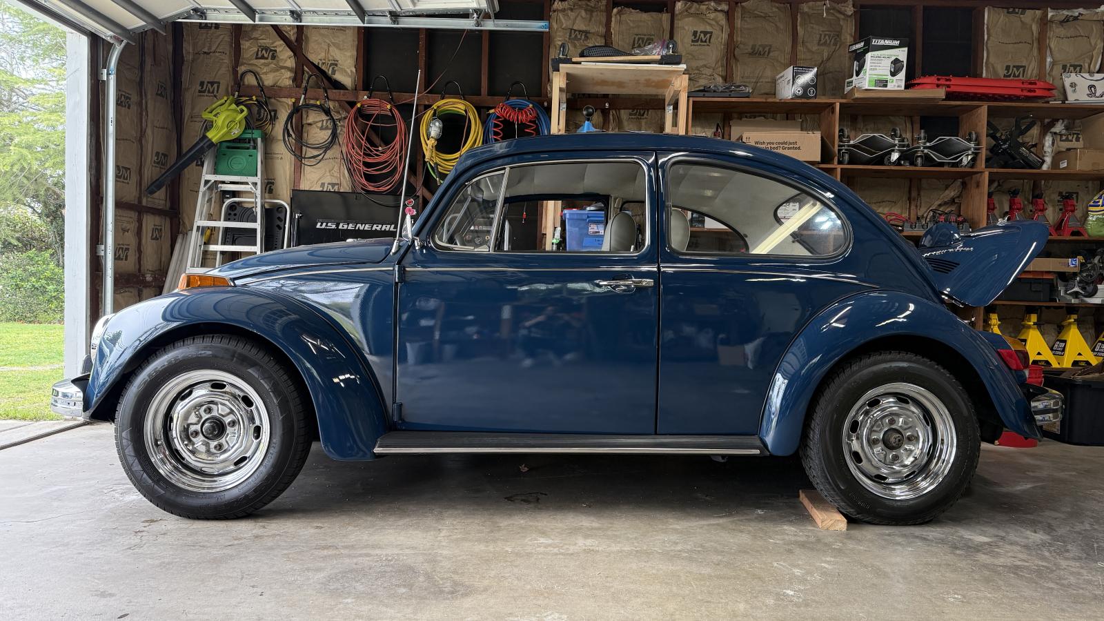

Do torsion bars wear out over time?
My bug is lower on one side than the other. I think maybe the person before me didn't get the torsion bars calibrated correctly to be even on both sides. So while I'm doing the work to adjust that, I wonder if I should just replace both torsion bars while I'm at it.
It's only by a little bit, the second picture shows the gap is bigger over the front and rear tires than the first pic
Lower
Higher
mukluk
Posts: 7452
Location: Clyde, TX
mukluk is offline
PostPosted: Mon Mar 31, 2025 6:32 pm    Post subject: Re: The Stupid Question Thread Reply with quote
Torsion bars can lose some of their springiness over time. The front ones can also have individual leaves fracture, and if that happens on one side of center it can cause a lean to one side. A common cause for leaning or sagging is actually from the torsion bar bushings wearing out. Then there's also the possibility that something in the chassis or suspension is bent or twisted. Keep in mind a lean to one side can be caused by a problem with the front just as well as by the rear.
Personally, I don't see a good reason to pre-emptively plan to replace the torsion bars. I'd pull and inspect them first to see if they have a defect warranting replacement, otherwise reuse them and adjust as needed (be sure to install new bushings).
