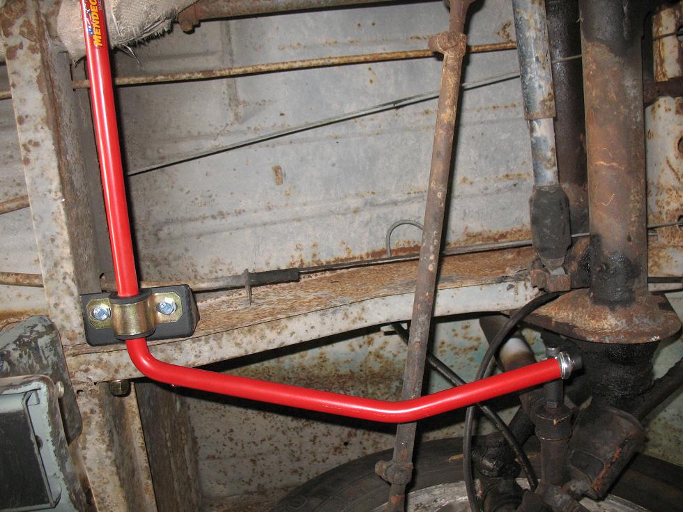

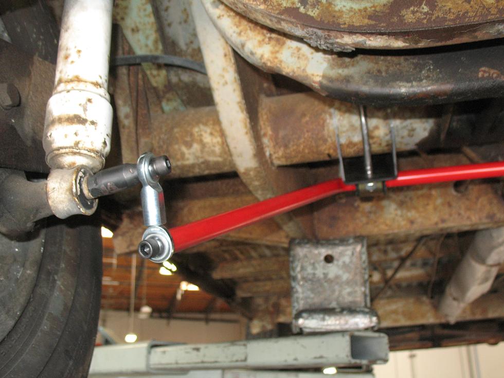

Here are some pictures of the sway bar kits mounted up on an early type two.
Yes are are still hard at work on the bus A-Arm front end. Cool

Antonio; Why not just buy a Subaru? It would be cheaper, handle better, be safer and you wouldn't have hacked up/ruined a bus for no reason!
Coolyrydes; A huge rear sway bar is probably the worst thing you can do for a bus. It will induce more over steer. Exactly what you don't want. An A arm kit for a bus? Why? Rolling Eyes

PostPosted: Wed Jul 27, 2011 10:09 pm    Post subject: Reply with quote
Hey brother, I've driven my fair shair of busses and now with our sway bar kits. This thing is just big enough to prevent body roll and it certainly makes you feel a lot better going around corners. Besides I would rether have a little oversteer any day better then a roll over. You know that is another name for sway bars "Anti Roll Bars".... Try a set I'm sure you change your mind.... Cool

PostPosted: Thu Jul 28, 2011 12:10 am    Post subject: Reply with quote
coolrydes wrote:
I have over 200+ autocross days and a few other random track days mixed in, but none on a bus so I will defer to other people's knowledge/experience.
But my question is, what part of the rear sway bar will help with a swing axle suspension set up? The oversteer caused by the sway bar is going to make the entire situation worse. The slight body roll it might reduce doesn't seem the added risk to an already risky set up. Buses (cab forward, swing axle, torsion setup etc) were NOT meant to handle corners. Throwing thousands of dollars into them seems pretty pointless.
More money than brains and all that...

PostPosted: Thu Jul 28, 2011 9:00 am    Post subject: Reply with quote
dref wrote:
coolrydes wrote:
It's funny to me that you point out you have more then 200 Autocross days, as I have been racing with the Porsche club for over 15 years and a Performance driving instructor for over 13 years.
It seems to me that you have a stock bus that you don't drive very fast, and that you would never dream of trying to drive it fast. So I have a question for you first. Why are you even wasting your time in a thread that is about building or adding performance to a type 2?
Now on to your questions. Why a sway bar or ANTI-ROLL bar, first tell me why not. This is not a thousand dollar upgrade.
In a turn there are many forces happening at the same time, and all effect the suspension in some way while it is trying to control what is going on. As a bus or vehicle with a high center of gravity goes thru a turn, the top of the vehicle starts to lean due to centrifugal force and the lack of any type of support pushing against it. Your out side torsion bar/ spring is trying to push back. An Anti-Roll Bar now takes some of that force that is pushing the outside spring up and transfer that force to the inside spring, thus increasing the outside spring rate. This keeps the vehicle more vertical. Yes, if you make the Anti Roll bar to stiff then you'll get a very quick over steer condition, however if you add enough Anti-Roll bar / sway bar tension without going to stiff then you'll control the roll and make the vehicle safer. I'm sure with your track history you've heard or read about "lossening" or "tighting a car up". These slang terms are in reference to adjusting a sway bar.
Please take a little time and research sway/Anti-roll bars before you go to much further.
Also enjoy this very watched video... Yes those are VANS!!!

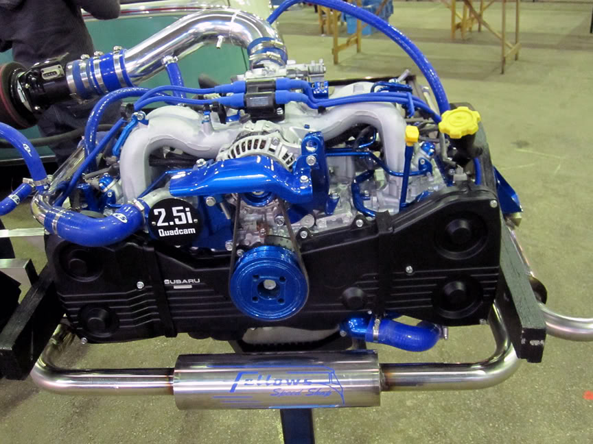

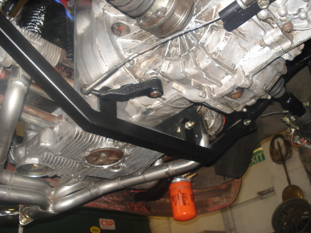

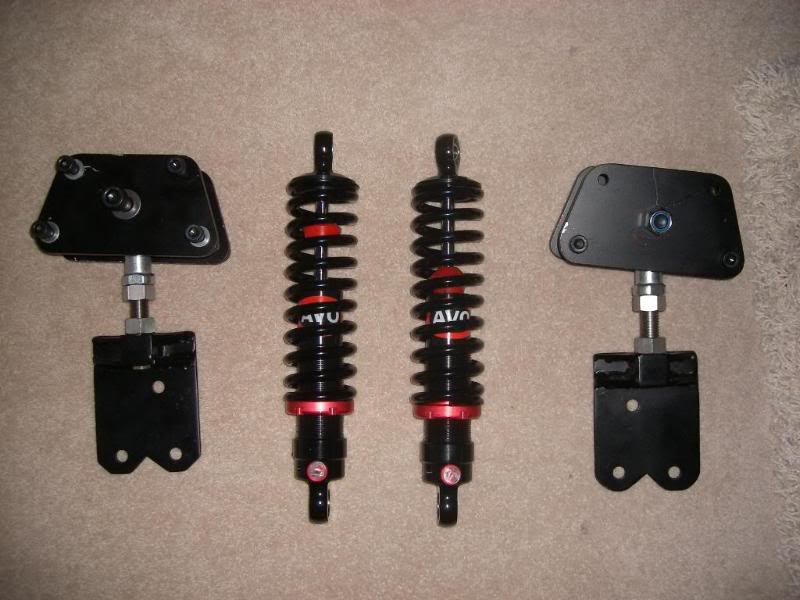

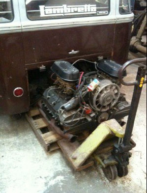

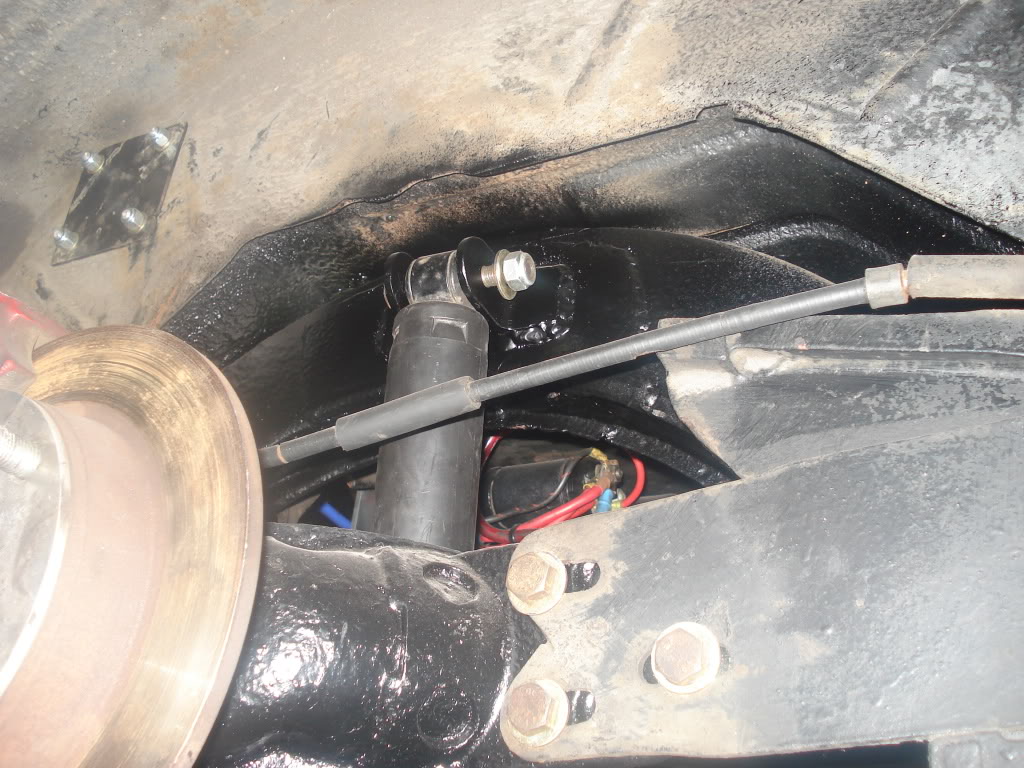

Closer detail of RJ's Porsche 915 (5 speed) gearbox & 2600cc Type 4 Engine (as corrected by Orb) installed into his 54 23 Barndoor.
*Photos & descriptions below are by Rikki James (5 following pics).

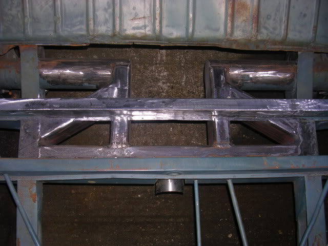

"Here's a few pix of the installed Porsche 915 gearbox into my '54 samba, with as much as possible, minimum modifications. Obviously the frame horns had to go due to the size of the bell housing on the box, never the less it wouldn't be a to difficult job to re-install them if need be."
^ "Gear box mounted under torsion bar (solid mounted), with custom noes cone, mounting bracket."
^ "Motor plate between engine and gearbox, with lower support bar connected to chassis rails."
^ "Shock absorbers mounted to chassis rails, square bolted plate to the left is the upper motor plate support brace mount."
^ "In this picture you can see rear engine mount that is covered by the rear valance, along with top motor plate brace. Before this recent'ish upgraded was installed, the engine and gearbox were all over the place (mainly caused by abuse)."
^ "Motor plate, bracing bar, solid mounted, left side of engine bay."

PostPosted: Thu Jul 28, 2011 9:08 pm    Post subject: Reply with quote
Have you done any testing on your bus on the track to prove that it's not actually making a dangerous situation worse? I would be interested in seeing this information/testing.
How do we as consumers know you're not selling a 'too stiff' bar. At least you acknowledge that a dangerous oversteer (made worse by swing axle suspensions) exists with incorrect sway bar adjustment.

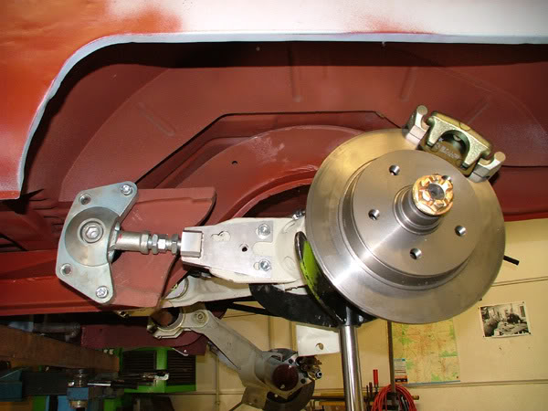

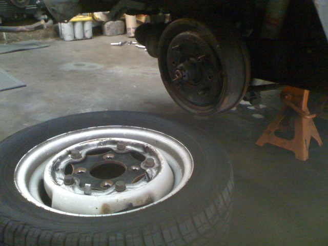

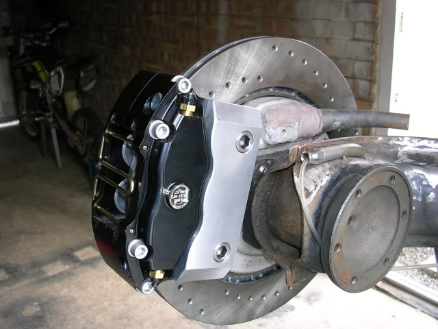

986 / 996 Porsche Brembo Brakes to all four corners of Type 2 Bus (stock beam)
^Old wolgang/bay brakes required adapters...not ideal
^VDubEngineering Brembo brackets come coated and ready for mounting.
I noticed you did not like caliper adapters but are still using caliper adapters for the Porsche brakes.
^ Um...no.
Those are Caliper Mounting Brackets made specifically for Brembo calipers your trying to call me out on....not adapters.

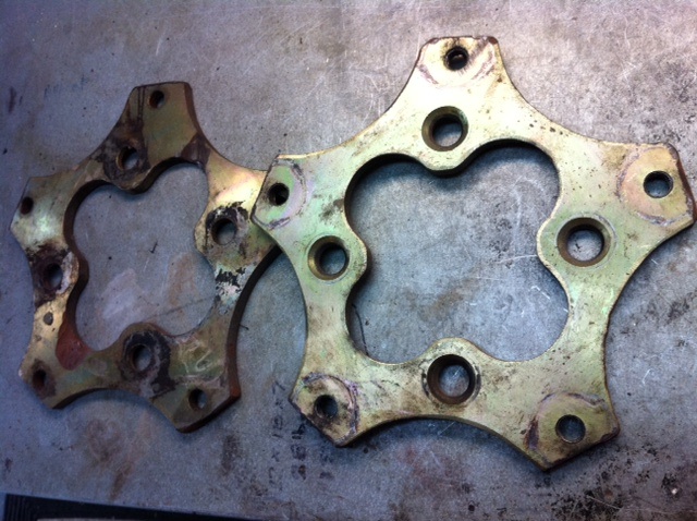

I already posted a photo of the adapter....here it is again for Brett...
Some more dangerous adapters...
^ DO NOT use these if you value your life. I speak from experience....not from 3rd & 4th party grapevine chatter.
First off, I will state I would go with Porsche Brembos over bay bakes any day.
Bay brakes driven on the streets will throw you thru the windshield.
But, when you make statements on worldwide forums and call one setup with adapters junk and you then install another set up with adapters (when you adapt it is an adapter). I was a little confused.
The Brembo caliper brackets in the pic looks like angle iron and flat steel being adapted to the stock non-disk spindles.
I misunderstood the adapter part because you don't have to have adapters for bay brakes? There are plenty of wheel selections for 5X112 bolt patterns.
As for the wheel adapters; They have been used as spacers in hard racing for decades.
I am not trying to give you a hard time. When you are on the world wide web with unlimited readers' well you get my point.

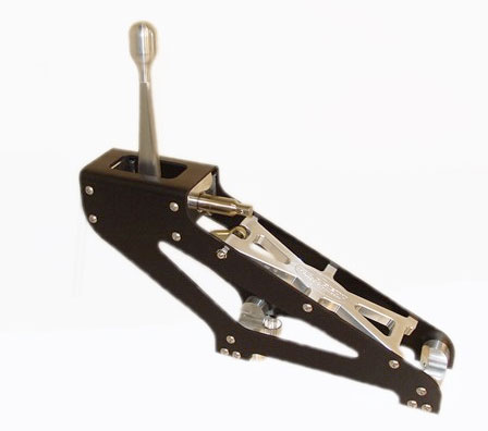

^ G50, 901, 915, 930
^ "HPP's shifters are known to be the "Best of the Best". They are designed and manufactured to impeccable standards and built with state of the art CNC machines. They define the shifting experience."
^ http://hargettprecision.com/index.php/porsche-products/porsche-shifters.html
_____________________________________________________________________
^ "This shifter is a radical new approach according to any other shifter on the market. Shifting travel is wonderful short, the look is straightforward and functional. Very big improvement compared to the original VW shifter.Reverse lock done by counterpressure. Quick and easy mounting. 100% made in Germany."
^ http://raceshifter.de/index.php?XTCsid=41199448e5c635ba330a4a08172adc35
__________________________________________________________________________________
^ PBS Cable Shifter ... "Finally, a mid/rear-engine cable shifter that eliminates stress and vulnerability encountered when using the VW Nose Cone, while providing the same positive feel of the OEM hardware. Unique shifter is made of 356 T6 cast aluminum and features a spring loaded reverse lockout built into the cover. Complete with everything except the cables, which you can custom order to fit your application. The complete set up can be installed with ordinary hand tools without dismantling your transmission! Slight modification to the shift rail is necessary. An optional VW mounting adapter is available and bolts onto the rear plate of the shifter cover. Two holes on the bottom pick up the stock VW nose cone mounting tab on the frame. Adapter plate is 3/8" steel and the two holes are tapped for mounting. Mounting hardware for the plate is included with the adapter. Rancho offers this rugged and durable linkage for use with Type 1 Swing or IRS and Mendeola MD4E and 2D transaxles."
^ http://www.ranchotransaxles.com/store/shifters-c-33.html?osCsid=21k7i7npg6i9e09cenkvn545i6

FellowsSpeedShop.com
(Perry Fellows specializes in Subaru Powered Split Buses)
^ Video at FellowsSpeedShop.com
__________________________________________________________________________________________
^ EJ20 into Type 3.... posting to show VW/Subaru power setup
^ Owner / Builder - daimotoo1956
_______________________________________________________________________________________________
