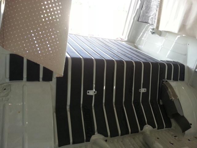

Hey everyone, just wanted to post here for others who might be considering options that I ended up deciding on using 1/4" Dynaliner (can buy from amazon). The below pictures used two of the 32"x54" boxes and there was enough left over to do some of the nose area also - the total material cost was right around $100.
Obviously the logo is not ideal but overall I think it looks clean. My bus had to have a full resto as it had been a bit hacked so my thought was putting in some salvaged tar paper wouldn't look right and this seemed like a good alternative from a looks and functionality perspective:

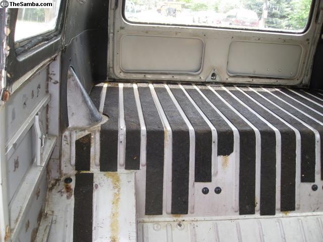

just some tar strips pics for reference.

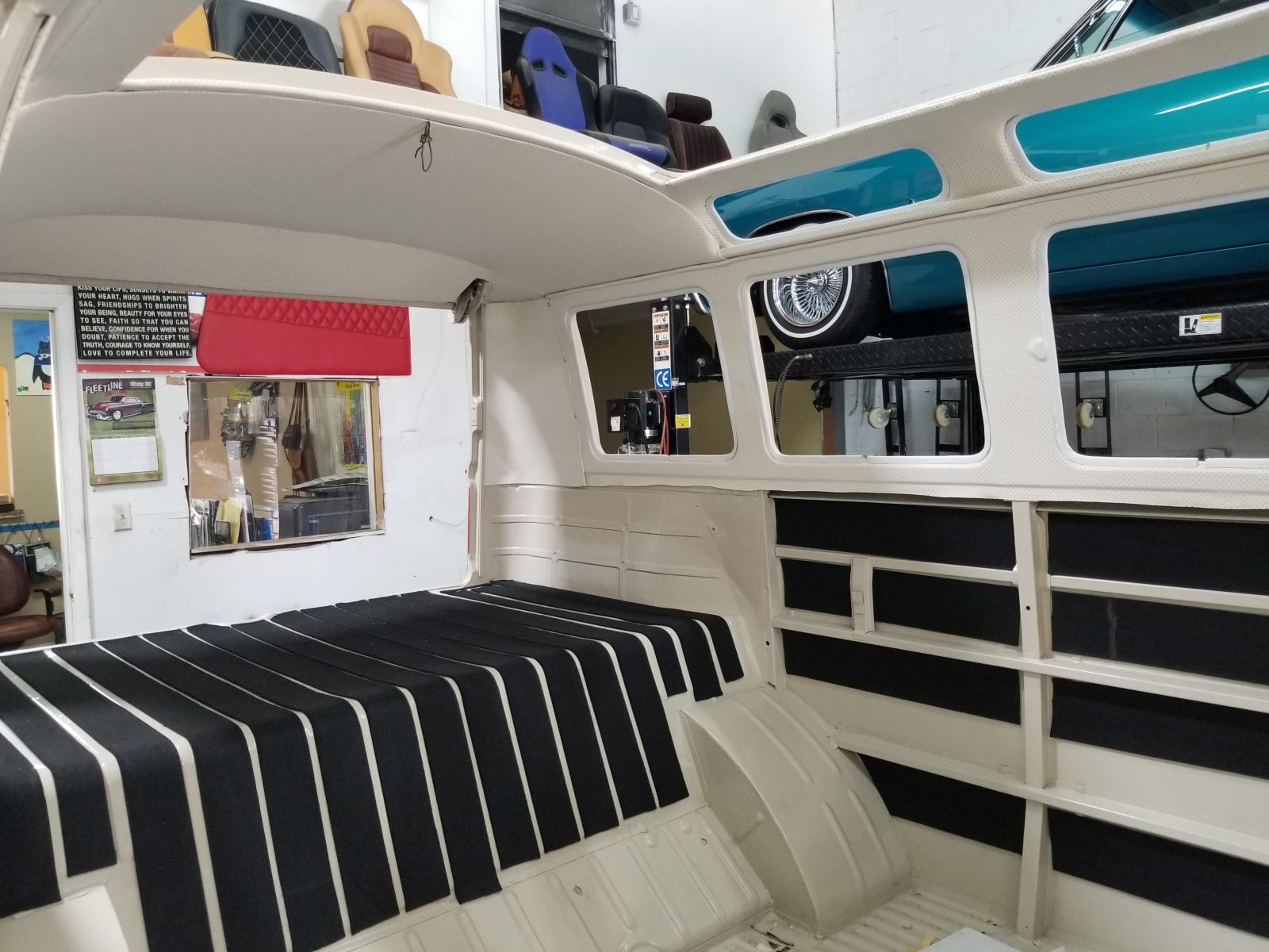

So the roofing materials were way too stiff... and realizing the OG material was probably a lot more flexible when it was installed way back when, decided to look into automotive insulation suppliers. I got this stuff from Sutherland Felt, correct thickness (4mm) cut to size and adhesive backed. Thought about spraying a light coat of rubberized undercoating on it to get as close to the feel of the original, but decided against it. A breeze to install, ordered in different widths as needed, just cut to length.
Total cost was about $160 (I over ordered)... not bad and results look and feel right, at least to me. Very Happy

Here's an OG piece and the new felt for comparison... I used a thicker material for the bulkhead.
