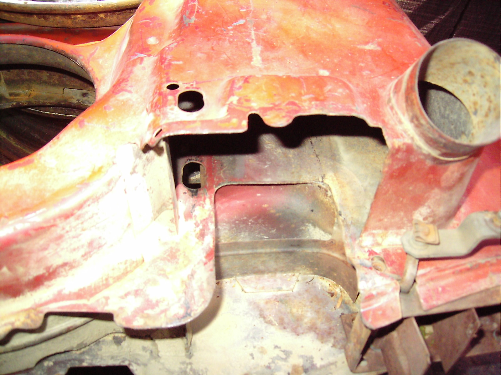

Has anyone seen this before? It's from a 69 bus where everything else was stock, factory original to the T.
I'm guessing it had something to do with the air cleaner.

That wire runs to the heat flapper in the air cleaner. As the engine warms up and the air deflectors open up it also closes up the hot air intake on the air cleaner air snorkle allowing cool air intake..
I think this preheat method ran for 2 production yrs.

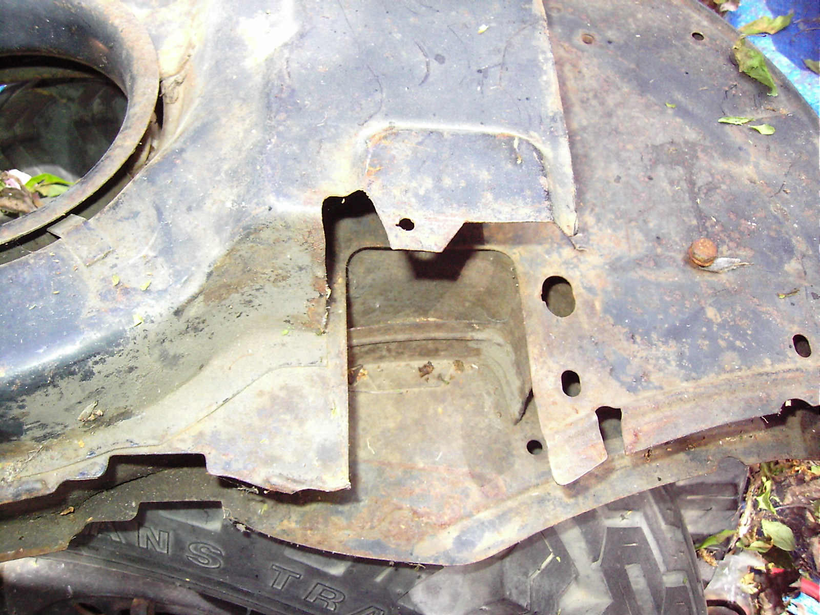

I have an engine with FI, but the doghouse was in rough shape, so I replaced it with a 71-74 one. Is there a difference aside from the location of the throttle cable? I'm willing to drill a new hole for that if needed.
I have the old doghouse, so I can easily locate the holes in the same place. If there are greater differences then I'll clean up and repaint the FI doghouse, but I'd rather just use the one I've already painted if it's an option.

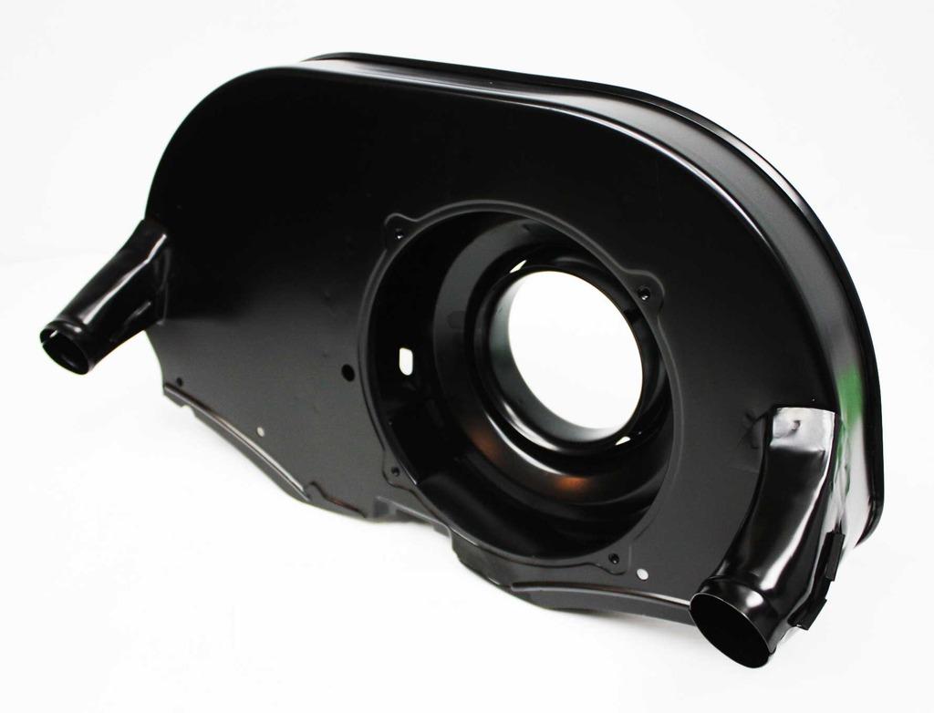

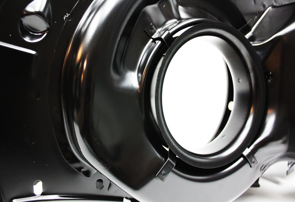

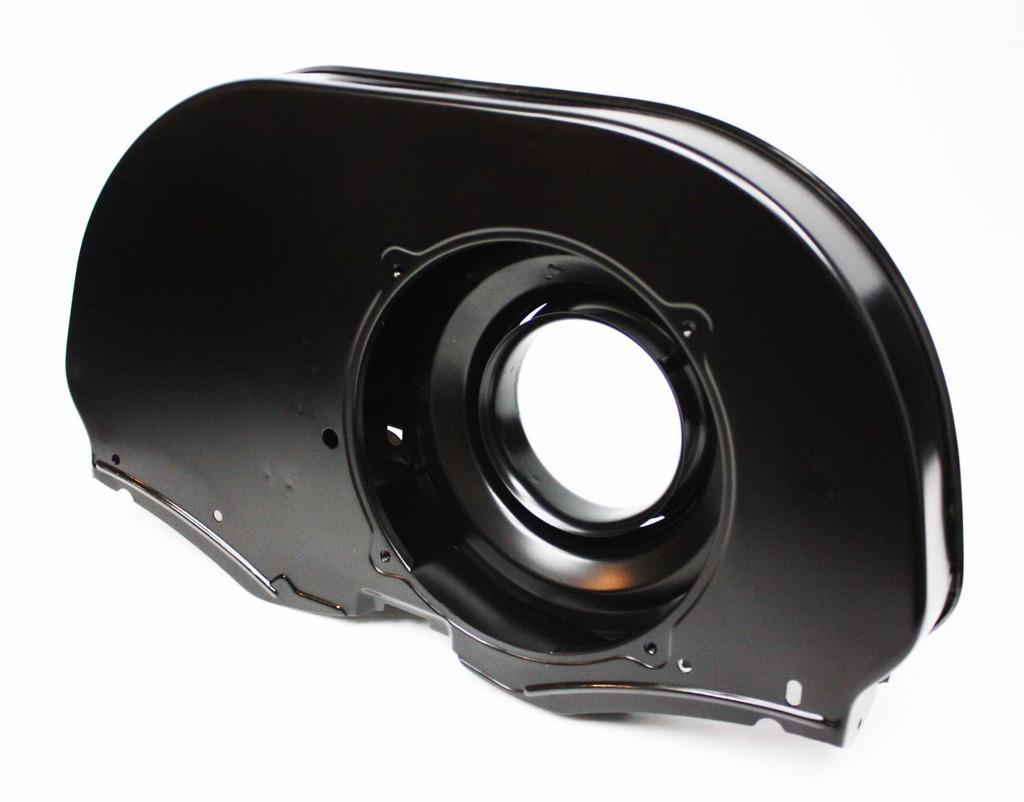

FINALLY an aftermarket part thats done right!
Available with or without heat, uses FI style oil cooler port (peanut slot), venturi ring and larger type 4 cooler. Provisions for factory thermostat flaps too!
http://www.thesamba.com/vw/classifieds/detail.php?id=1872355
They also offer the parts to convert your shroud to type 4 cooler and venturi ring.
http://www.thesamba.com/vw/classifieds/detail.php?id=1872371
This part utilizes the latest advancements in shroud design by VW for use in their aircooled type 1 all the way to the end of production. The ability to run the type 4 cooler is a real bonus!
Hats off to Concept1 for offering a great product!

Just adding some comparison pics of an early shroud that will accept a hoover bit and late shroud that does not.
Fresh air Brazilia shroud.
77-79 VW FI Shroud
Only has a tab for the flap return spring, will NOT accept a hoover bit.

That Fanhousing is fantastic love it. For a T-1 car with the T-4 oil cooler housing it is a great part.
T-1 vs T-4, well there sure are alot more T-1s. My point if I guy wanted to convert a T-4 into an Upright conversion like in my Cali Style, the way to go would be use a 36 hp Fanhousing with T-1 doghouse and no heater hose outlets.
The reason a 36 hp fanhousing has to be used is because the carbs won't fit using later model fanhousing, they are too wide. The 36 hp with doghouse works for the T-4 conversion with the T-1 oil cooler because the T-4 runs extremely cool and in a climate like here in NY it is fine. I show how to extend the dog house to take a T-4 cooler ( I have one in my bug ).
It would be perfect if they made a 36hp with T-4 cooler housing. Well maybe they will sell just the extended T-4 oil cooler housing.

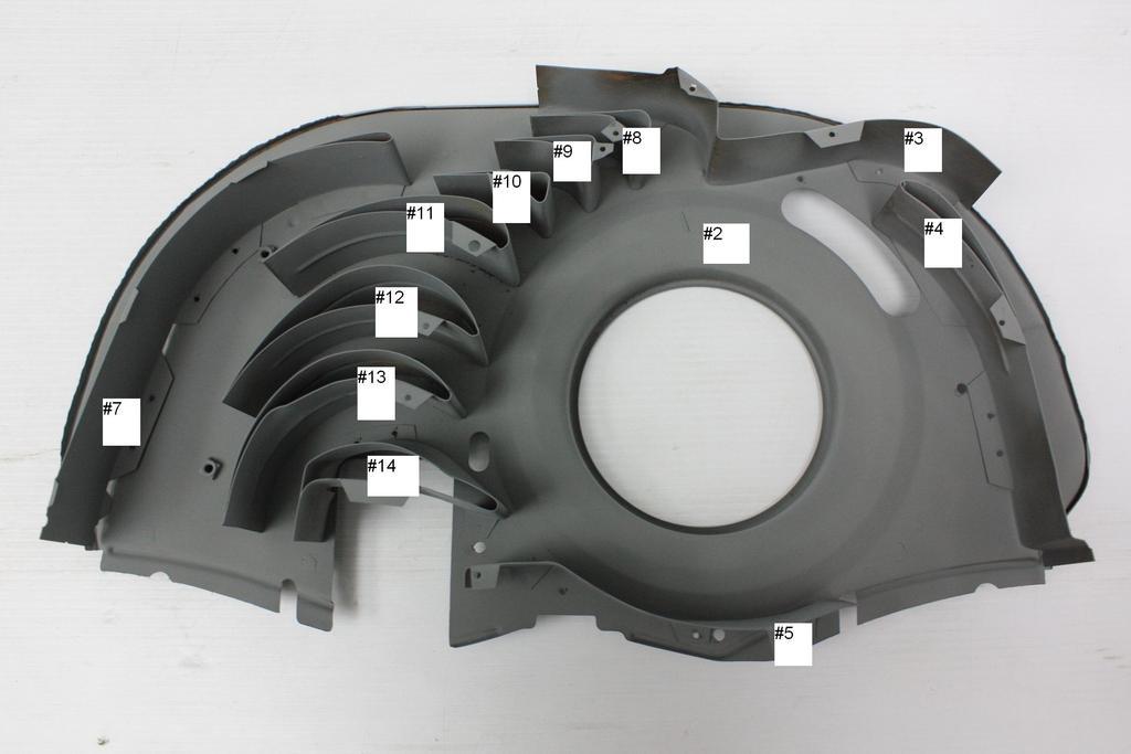

AlteWagen wrote:
WORK IN PROGRESS!!! PICS ADDED AS FOUND. If you have better pics please post.
63-70 fresh air shroud
Uses upright oil cooler
April 1964 Cooling flaps replace throttle ring
August 1964 Cooling flaps replace throttle ring (Type II)
Great thread!
IIRC, the earlier fresh air fan shrouds that take the ring have different cut outs/ mounting holes than the later one that take the flaps.
Ditto for the cylinder tin.
The pic above shows one that takes the flaps.
There may be an intermediate kind that can go either way as well. There is for the cylinder tin

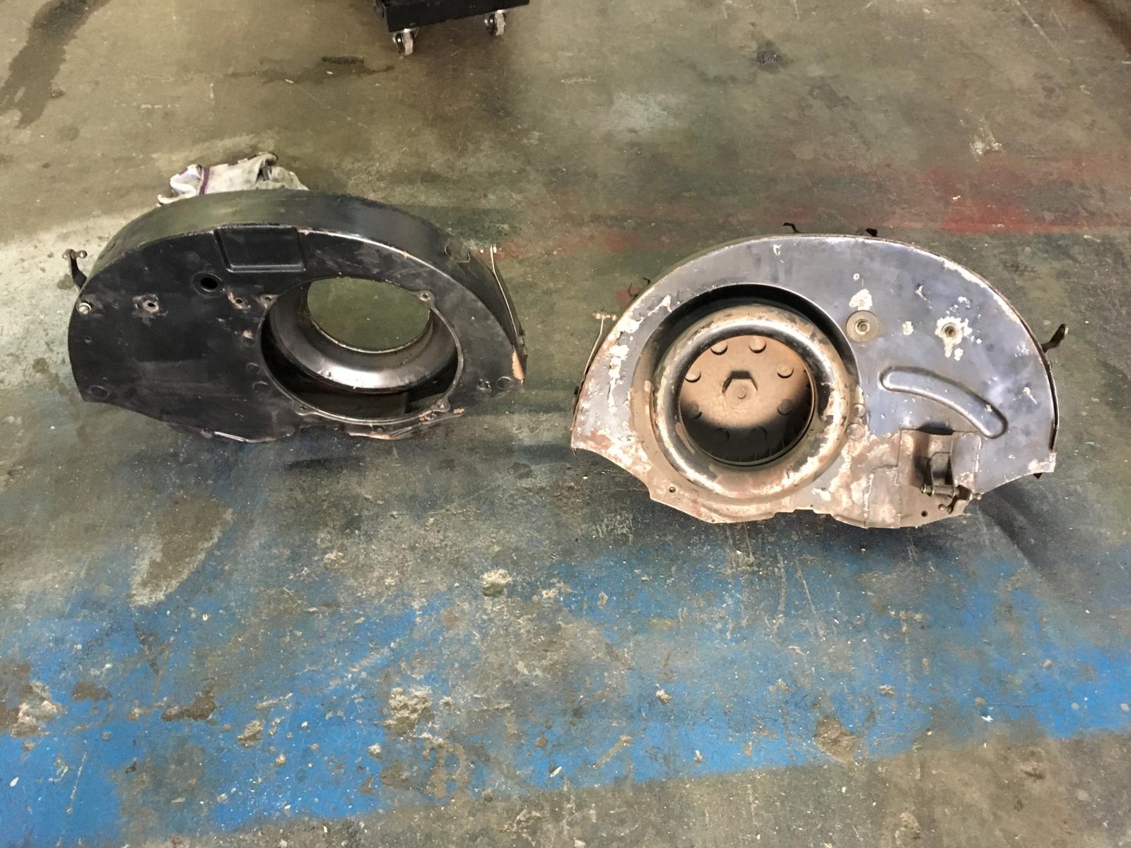

I don't see a painted number on any of the pics above. Can anyone shed some light on this:
vilihardrada
Joined: September 12, 2012
Posts: 34
Location: ariel,wa
vilihardrada is offline
PostPosted: Tue Oct 09, 2018 6:40 pm    Post subject: Re: Official Upright fan shroud thread Reply with quote
I believe the numbers indicate factory rebuild.
