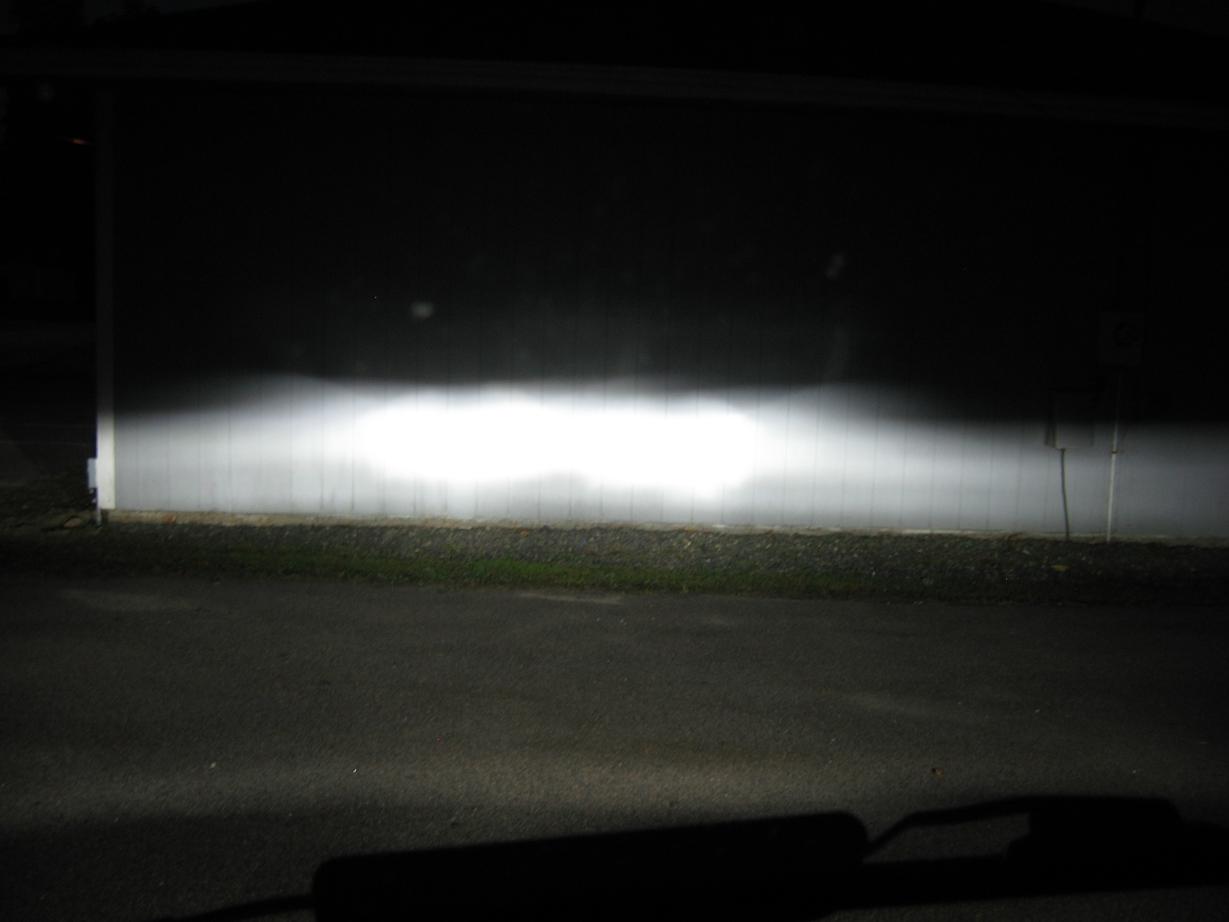

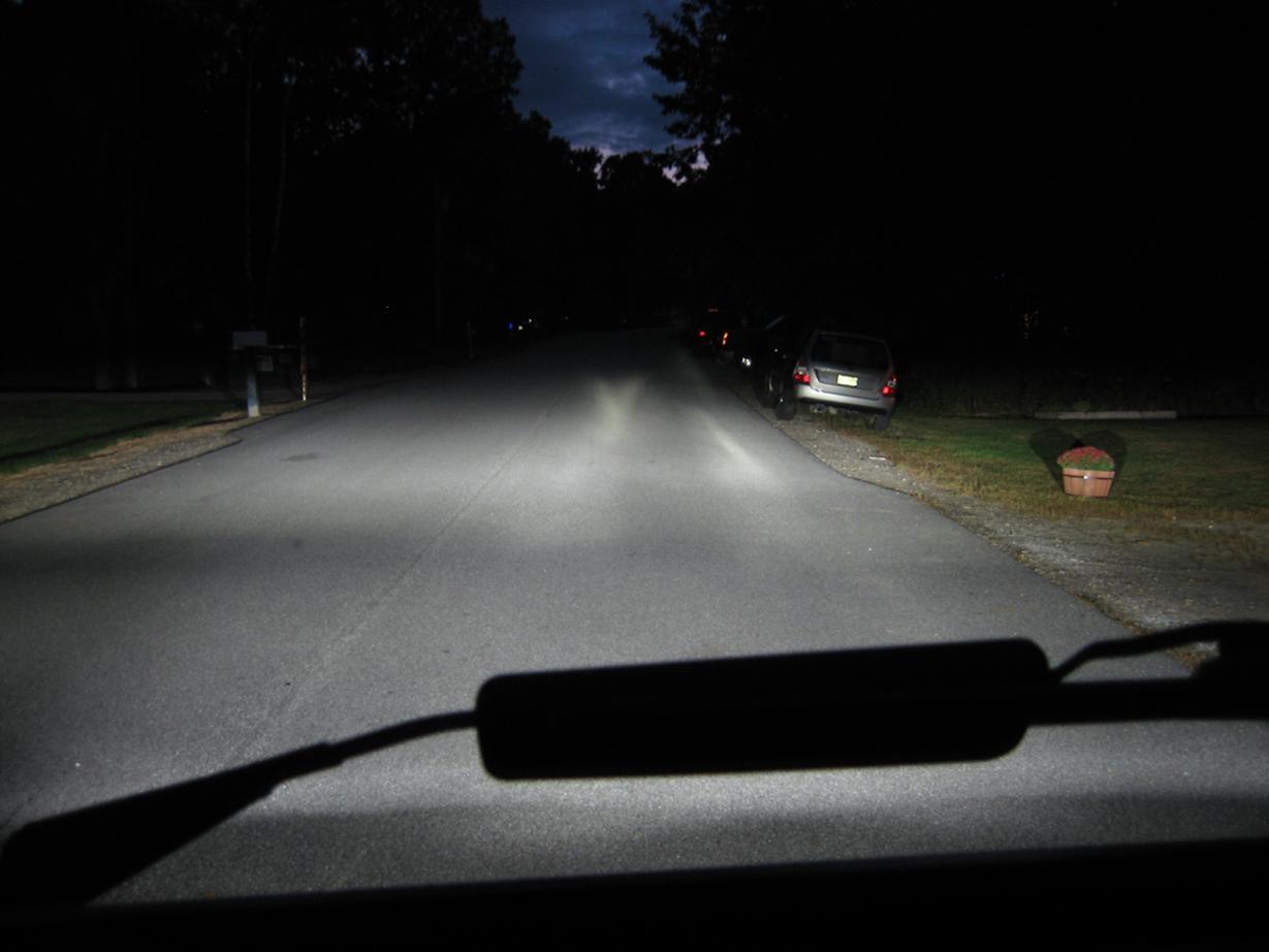

PostPosted: Fri Sep 19, 2014 1:43 am    Post subject: Reply with quote
Finally got a chance to install the GE NightHawk 7" LED headlights and take them out for a short drive tonight. These are pretty decent headlights and would be a good match for any Vanagon running 7" round lenses. I did however find the X-shaped artifact that is common to many automotive LED headlamps to be distracting (see photo) especially when cornering.
The color temperature of the lights is a very bright white, but not blue. On low beam, there was very little noticeable upward glare, so dazzling oncoming traffic shouldn't be an issue if your lights are adjusted properly. The cutoff is nearly flat on low beam and well controlled on high beam. Lumen output and amp draw were both approximately as listed when measured by my inexpensive equipment.
Here are a few shots of the lights in action. All photos were taken with the same settings on my trusty old Cannon A500.
Street view showing the X-shaped lighting artifact:
Low Beam Cutoff:
High Beam Cutoff:
Overall, I would give these 7" LED's a favorable review. I am still not 100% sure that they are worth the $320.00 price tag however. For now, a combination of Cibie e-Code lenses and Osram Hyper H4 bulbs remains my preffered setup for Vanagon lighting.

PostPosted: Fri Sep 19, 2014 4:17 am    Post subject: Reply with quote
Thanks a lot for the review, it is appreciated.

PostPosted: Fri Sep 19, 2014 7:41 am    Post subject: Reply with quote
Thatvwbusguy,
what is the distance in the first pic?

PostPosted: Sat Sep 20, 2014 2:52 am    Post subject: Reply with quote
Distance to the back of the silver Forester in the first photo was roughly 30' away. The shot was taken just after installation and before aiming the lights up to the proper height. I highly doubt that these LEDs will reach out further than a halogen bulb installed in a decent lens as claimed in their literature http://www.gelighting.com/LightingWeb/na/consumer/...index.jsp, but they should certainly be more than adequate for most people's daily driving needs.
After taking a late night trip around town and visiting some spots with very little ambient light pollution, I had to admit that I really had no interest in "getting used" to the X-shaped hot spot artifact and decided to pull them out. This was made much easier by the fact that one of the guys I work had already told me that he wanted them for his '68 Camaro and had the cash in hand. A couple hours later, I ordered a new set of Cibie eCode's to replace the Bosch lenses I have been running for the past couple years.
