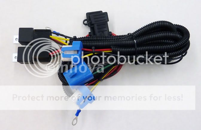

The original headlight circuits aren’t relayed so that has to be fixed before anything. Just putting them on relays appears to improve the light output. I split headlights from inner squares and set them on separate switched circuits, 30amp relays and 15amp fuses.

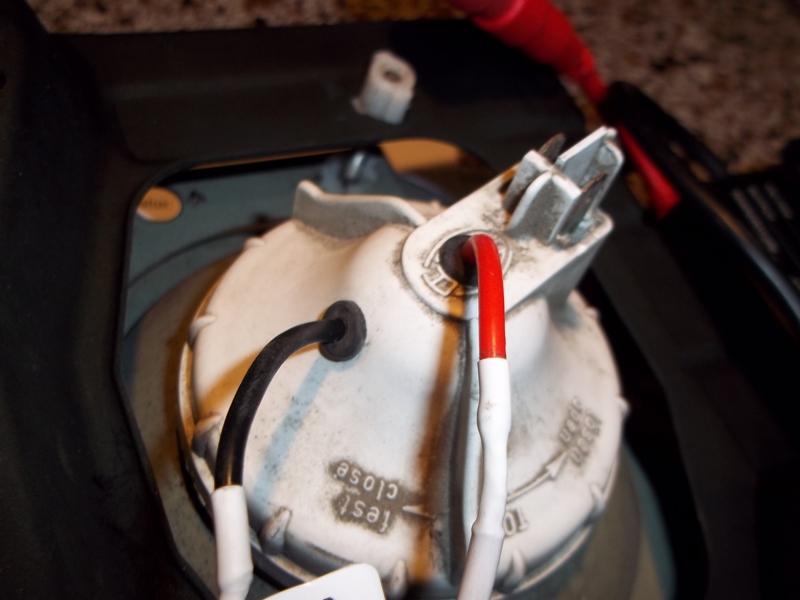

The only thing I haven’t figured is how to seal the spot where the bulb enters projector from behind the housing.

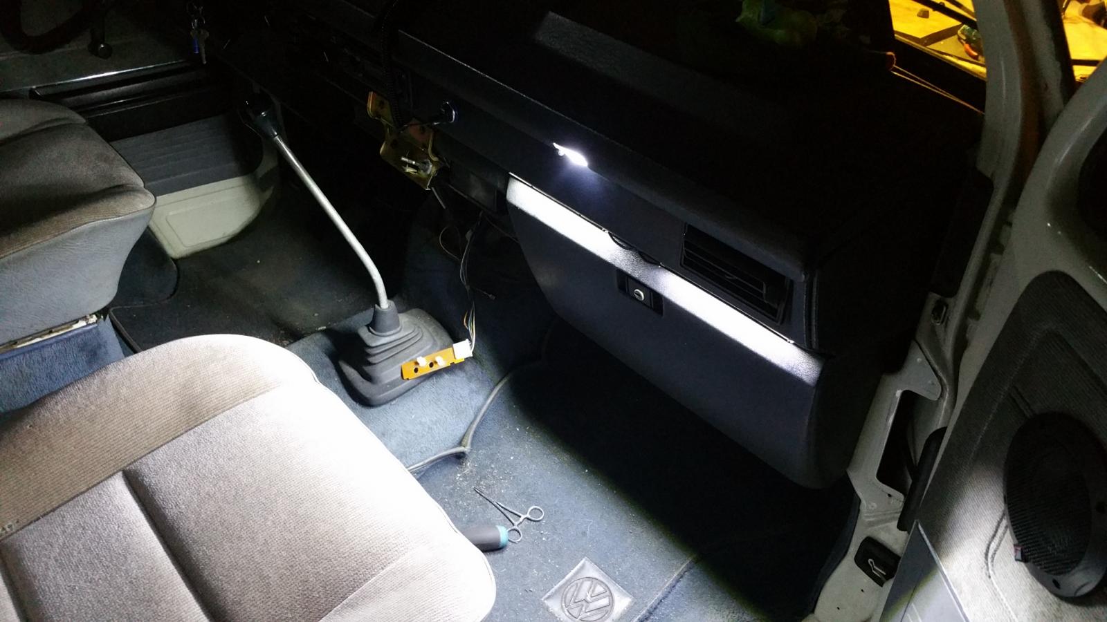

Dome lights: 3x42mm festoon 16 surface mounted LED
Map light: 1x3mm festoon 6 surface mounted LED
Instruments: 4xT5 B8.3D 1 SMD LED – brightness WOW!

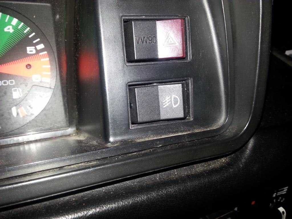

Heater controls: no spec, got these from GW. As a hint you can change rear heater control bulb easily when instruments are out. Main heater control knobs break easily when pulled, grab them at stalk not by the head.

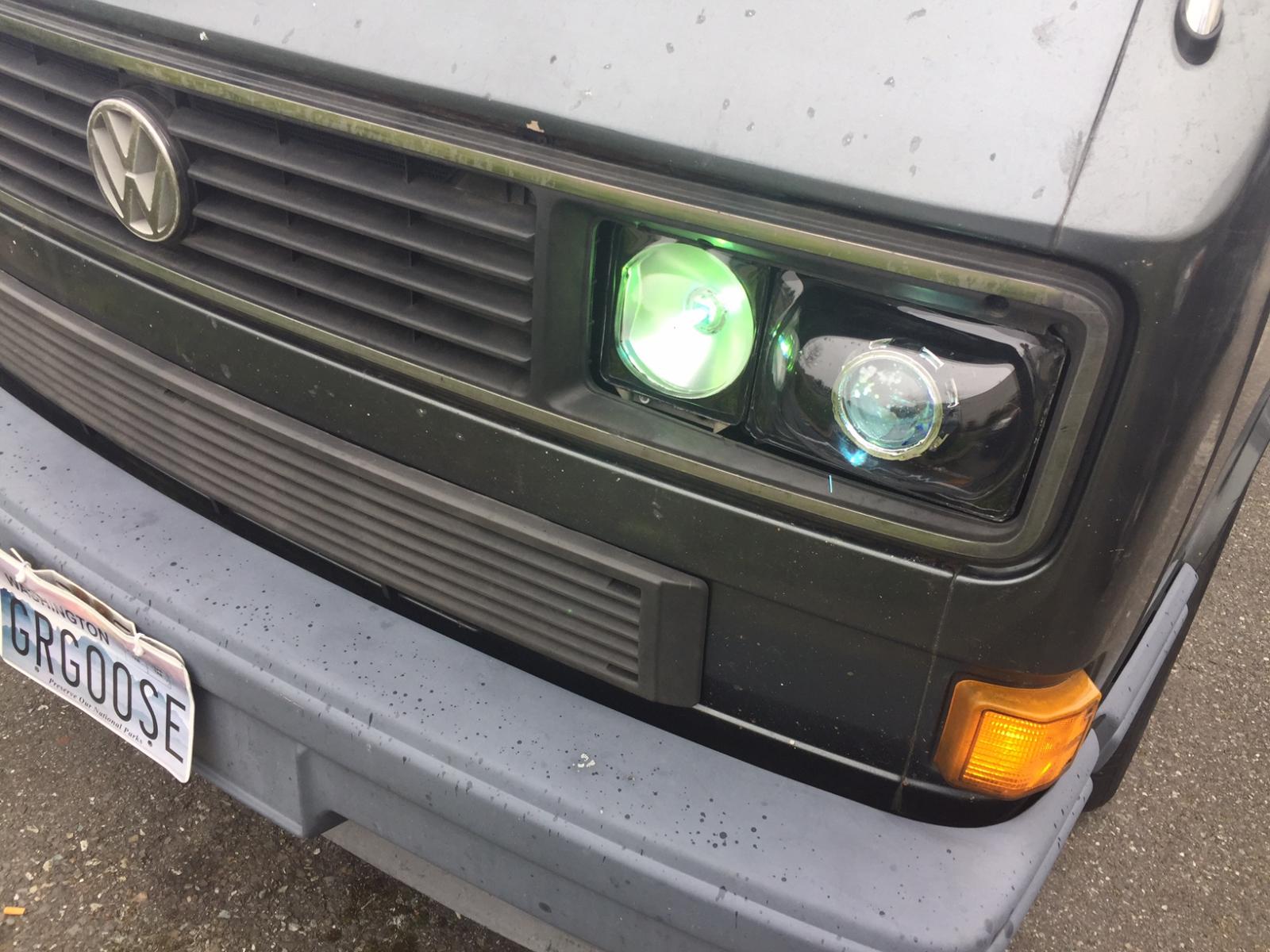

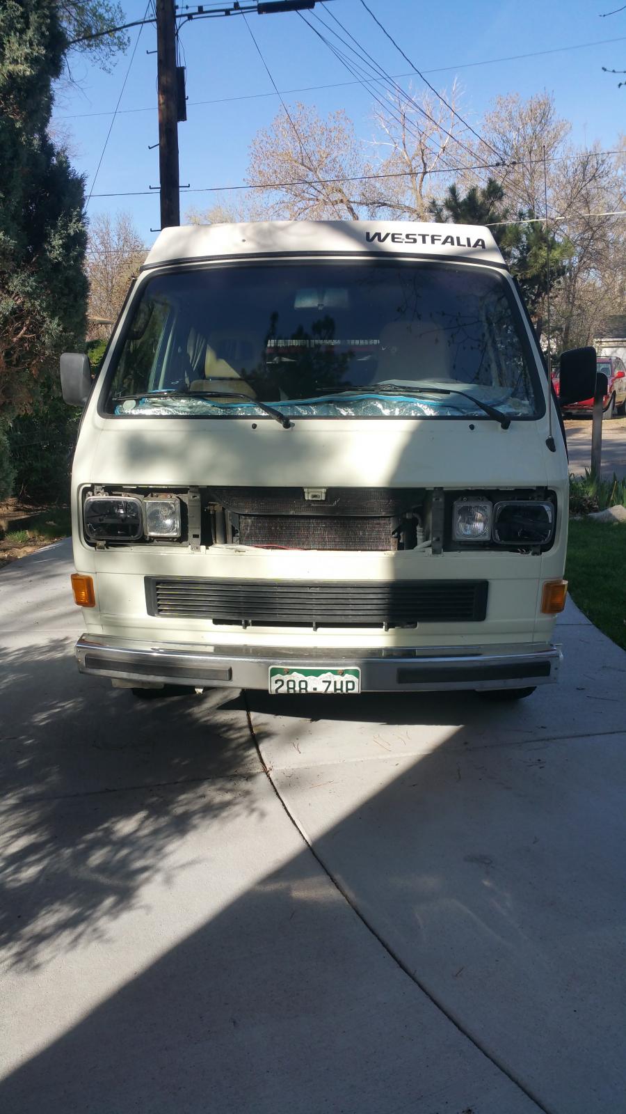

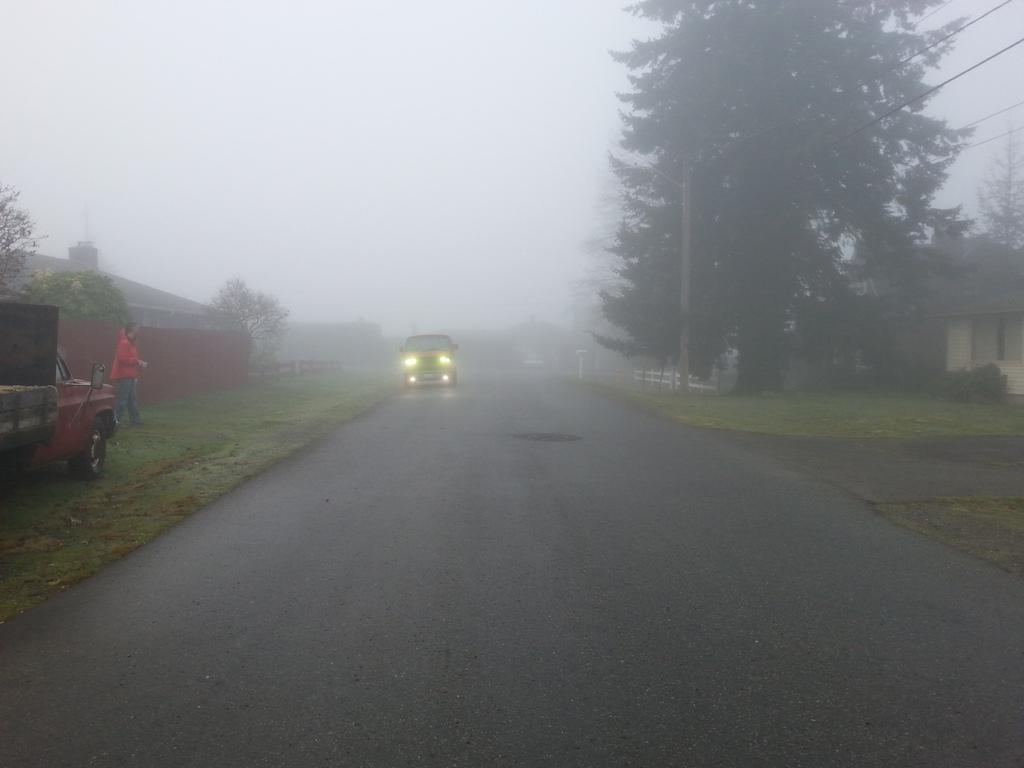

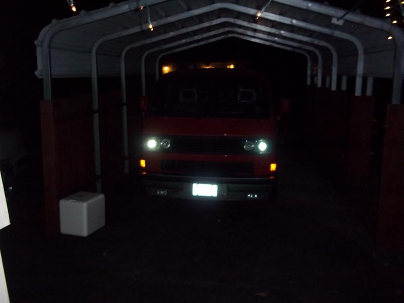

Here is a shot head on:

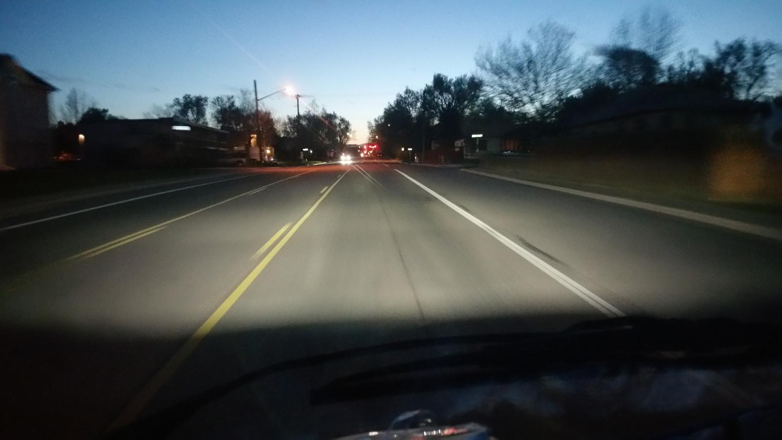

With flash so the light is a bit neutered:
Original lights and in need of adjustment. This is almost total darkness!:
HID in action, I'll try to take some better pics next time:

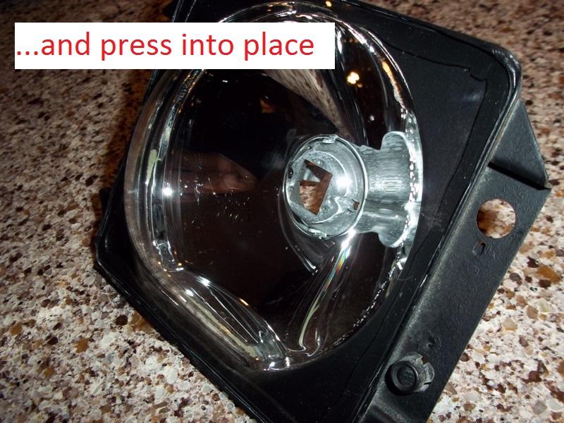

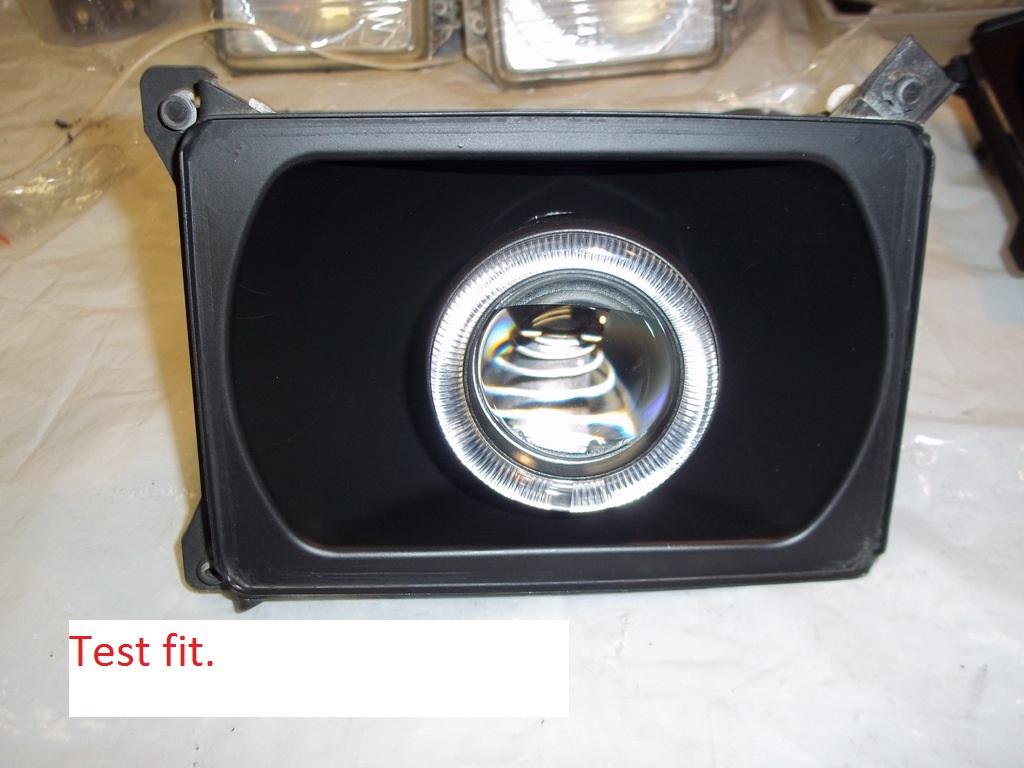

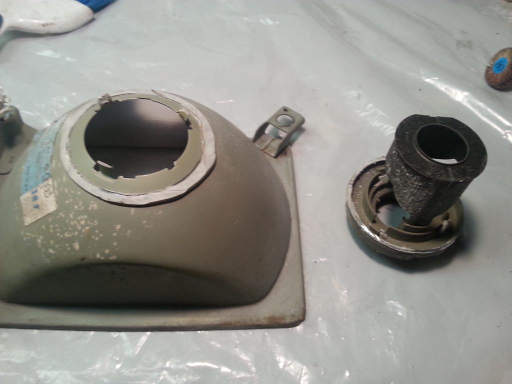

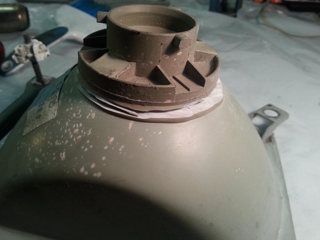

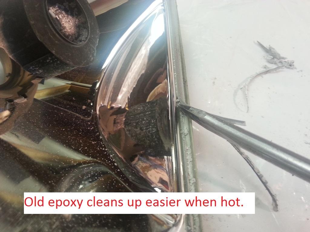

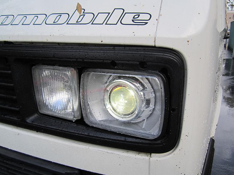

The fitment in the bucket was easy. You grind off the original epoxy and pull the 9004 receptacle out. That leaves three tabs to hold a properly sized washer in place. Tack weld it, 5 minute epoxy to seal the washer to the bucket. Projector has a threaded end with a nut, position it and lock it in place.

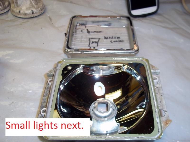

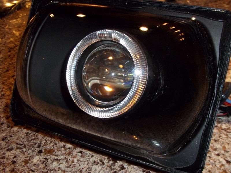

Here are some pictures from current conversion to a bi-xenon projector with integral halo. I'll post more as I go of course.

Haven't figured how to seal the last place. Need something like the rubber boot behind the turn signal but smaller. For now sealed it with rubber tape.
Headlight assembly starting to take shape.
Testing the lights in the garage. Ta-da...
Next time we'll set beam and check the performance! _________________ If happiness is being a mechanic, owning a Vanagon is nirvana.

Posted: Tue Jan 21, 2014 1:10 am Post subject: |
Try some self fusing silicone tape like Rescue Tape to seal everything up on the back side of the housing. Shouldn't have any problems with the temps and doesn't leave a sticky mess, since it only fuses to itself. _________________ Jay Brown

IdahoDoug Samba Member
Joined: June 12, 2010 Posts: 10357 Location: N. Idaho
Posted: Tue Jan 21, 2014 9:21 am Post subject: |
Nice - correct way to upgrade by using full assemblies and factory reflectors only for mounts. Look forward to results. So the LED at vehicle center - a DRL strategy? I was thinking of similar on a couple classics I own. How's that for brightness in daytime, beam, etc? Source? _________________ 1987 2WD Wolfsburg Vanagon Weekender "Mango", two fully locked 80 Series LandCruisers. 2017 Subaru Outback boxer. 1990 Audi 90 Quattro 20V with rear locking differential, 1990 burgundy parts Vanagon. 1984 Porsche 944, 1993 Toyota LandCruiser, 2002 BMW 325iX, 1982 Toyota Sunrader |

svenakela Samba Member
Joined: July 19, 2006 Posts: 776 Location: Ekerö
Posted: Tue Jan 21, 2014 9:56 am Post subject: |
I can't really decide if I like it or not, but sure it's an upgrade and I actually think the grill all of a sudden looks modern. Sort of.
Is there any space left behind the reflector? If the lens could be moved further back, the front "glass" could be made more flat? I think it would be looking more natural then. And awesome.
Unfortunately it's not a doer in the EU. Only vehicles with factory installed automatic light height adjustment are allowed to have projectors. Of course you can make some and don't give a thing about it. In my area the donuts are like eagles on home made HID conversions. Easy target for a fine I guess... |
