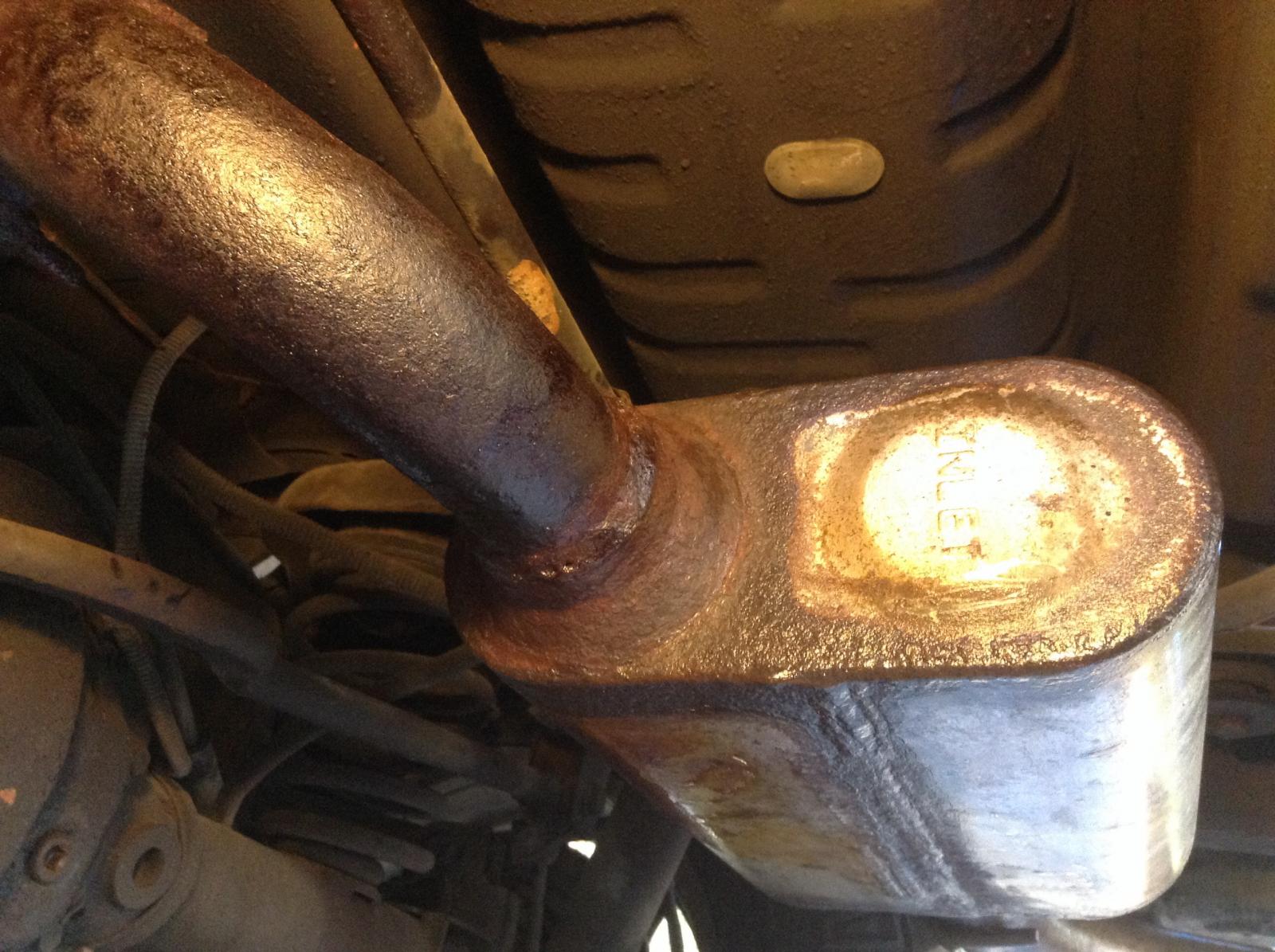

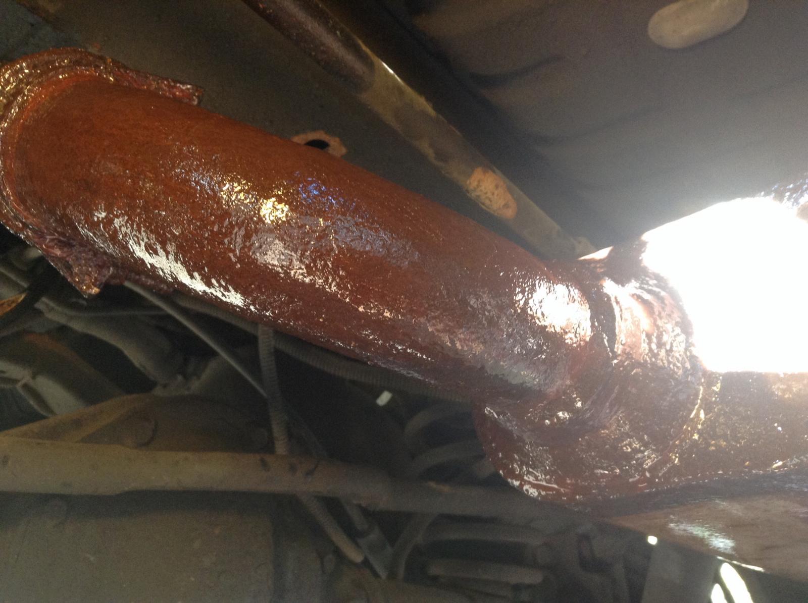

Second application of peanut oil on all the exhaust system.
Second application dryed up after half hour drive.
The bend is getting darker, as stated before by TK and Dylan.
The rust is getting well seasoned! Cool Cool Cool
One more application tomorrow...
Pedro

PostPosted: Mon Nov 16, 2015 7:18 pm    Post subject: Re: Peanut oil exhaust anti rust treatment Reply with quote
Thanks guys Wink
Tomorrow third coat.
Then we will see how if it works this coming winter with road salt... Think

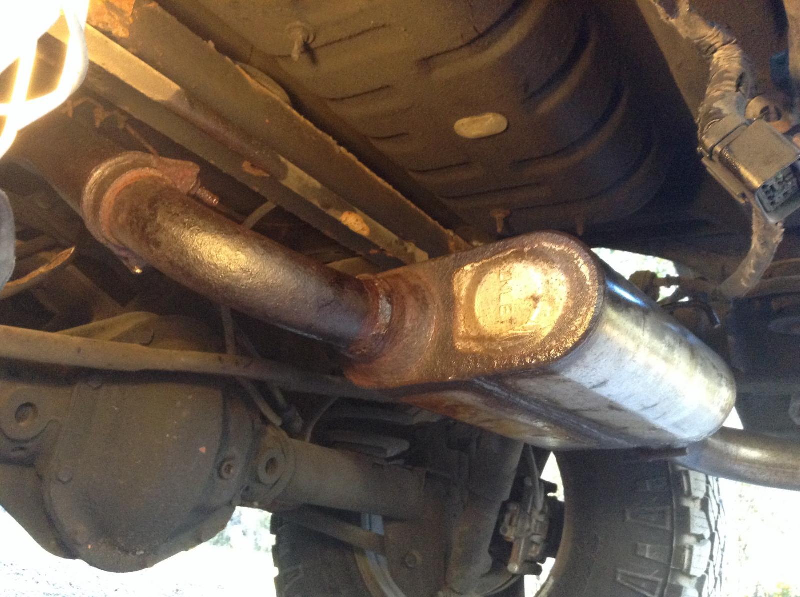

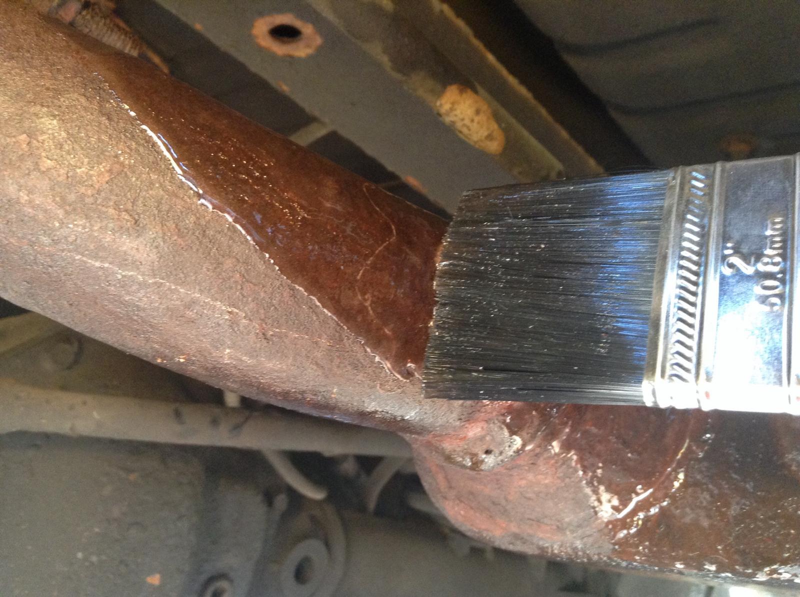

PostPosted: Tue Nov 17, 2015 3:47 pm    Post subject: Re: Peanut oil exhaust anti rust treatment Reply with quote
So i drove once yesterday, then this morning going to work, then driving back home. This how it looks like for the second coating of peanut oil.
Now applying the 3rd coat.
And after a half hour drive.
Pedro

pedrokrusher wrote:
We need someone to do his own experiement on a vanagon waterboxer exhaust, preferably a vanagon used during this winter.
That would be extremely easy as all tubing is well exposed and all that the rear! Anyone? Anyone? Bueller?
Just picked up my supplies on my lunch break.
Great White aka Trusty Rusty Syncro with his smooth running WBX and stock exhaust will be stinking up RT66 on the way home this evening.
Pics to follow.
