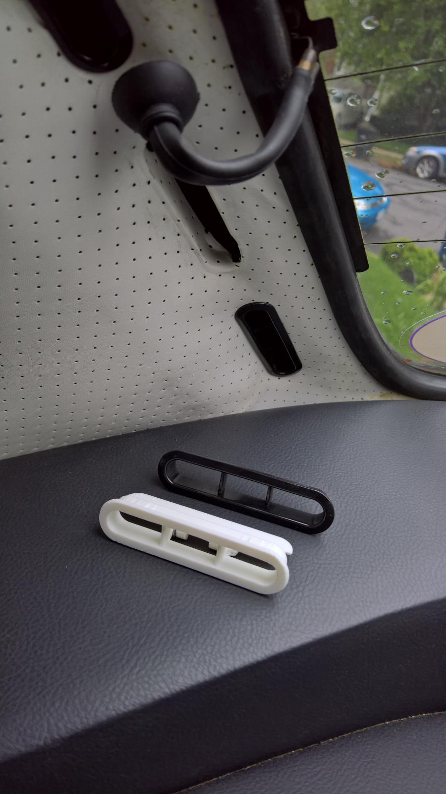

Here's CWave's vent next to an after-market one I bought from an online vendor many moons ago -

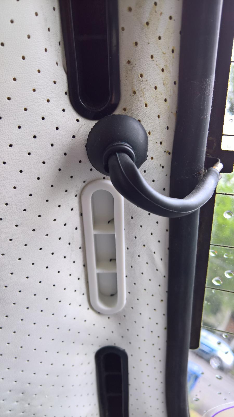

Here it is installed.
(Note to self: clean glue residue off headliner. Rolling Eyes ) The flap is very cool, but I'm not sure if I oriented it correctly. I installed it so that the flap's [EDIT] hinge up or towards the glass. The only original I've ever seen was in this Super. I fished it out of the c-pillar when I redid the headliner last year, semi crumbled.
The fit is good, but a little loose. The black aftermarket one has a snugger fit, and the outer edge feels slightly rounded or thicker compared to CWave's flat edge. All-in all, I think it's pretty nice and I would buy it in black if you could print them!

Hey vanram, looks great in your car.
So, if you could provide me with a summary of specific improvements you'd like to see in these vents that you think would make them fit better, and look better, let me know. I'd like to make them perfect before I start making sets for other people and you.
Most colors will be available (including black).
Looking at the photos, you installed the vent exactly as I had expected them to work best.

Perhaps thickening the wall so that it's a tighter fit. The visible rim is also a little thicker on the repro unit. Other than that...let me know when you have a black one to test with!

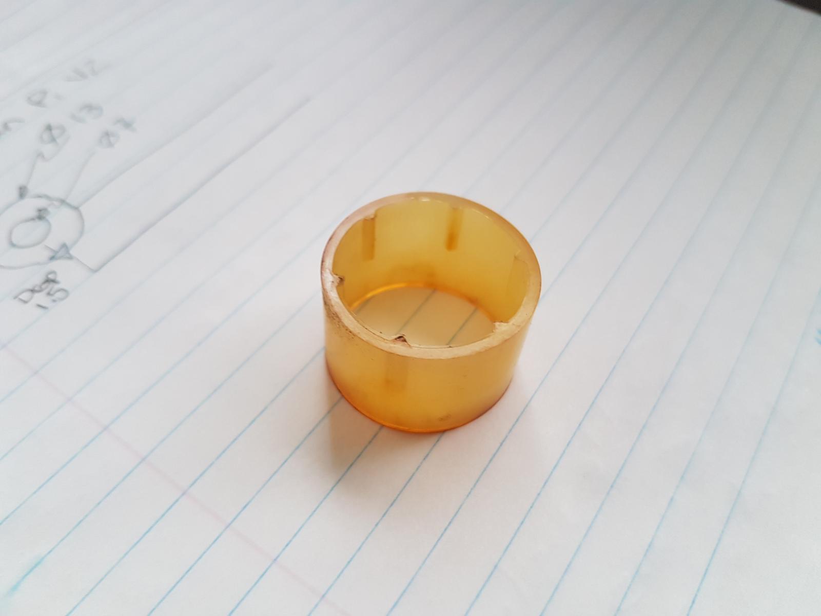

Checking in on your 3-D printing. Have you tried printing the steering column spacer that's about an inch or so in depth and thin? I'm looking for one as the one on my '72 Super recently crumbled when I replaced my turn signal assembly.

Also, that steering column spacer you're looking for. I think I just pulled out the spacer out of one of my spare columns that you're talking about... but can you confirm? Here's the picture.
If that's it, I will model it tonight and make one that fits. Will post photos here.

CWave, that's the spacer that crumbled on me. They're hard to find, i'd be very interested in one. I know there's someone already selling them online, but I don't remember the site or how I came across it....several months ago I think.

As for the spacer, I'm going to model that for ya. I'm going to initially (for testing), print it in PLA, but I think for the production piece, I'm going to print it in nylon. I think that should hold up much better. Will let you know how it goes.
