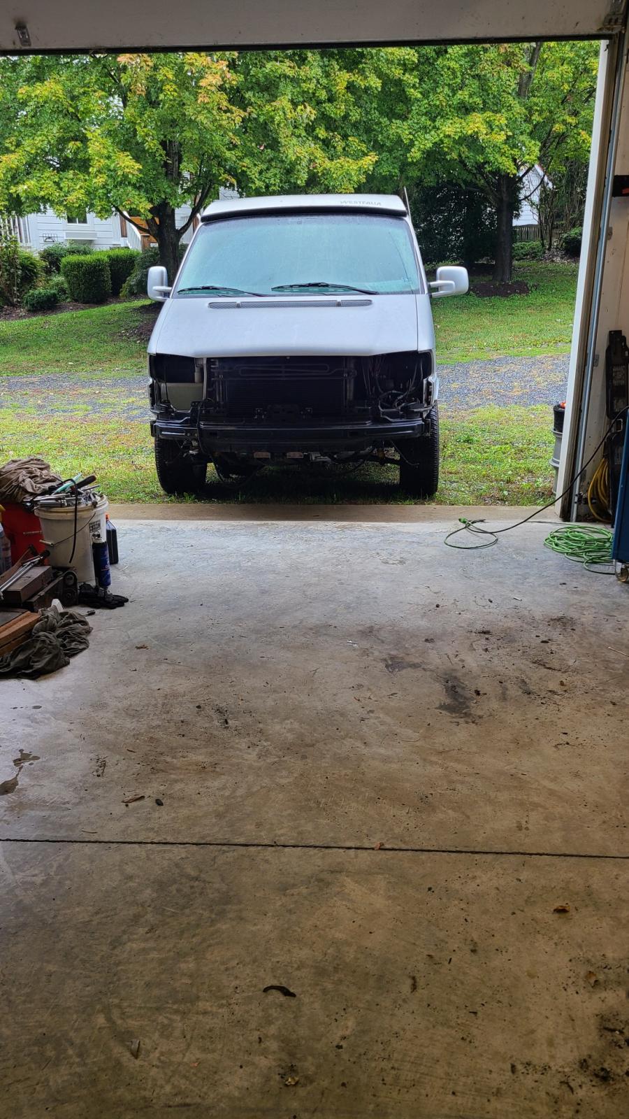

PostPosted: Sat Sep 23, 2023 11:24 am    Post subject: Re: Iglaaq, the 2002 MV Weekender Reply with quote
Lots still to do, but nice to see it out in the rain. Under its own power, even.

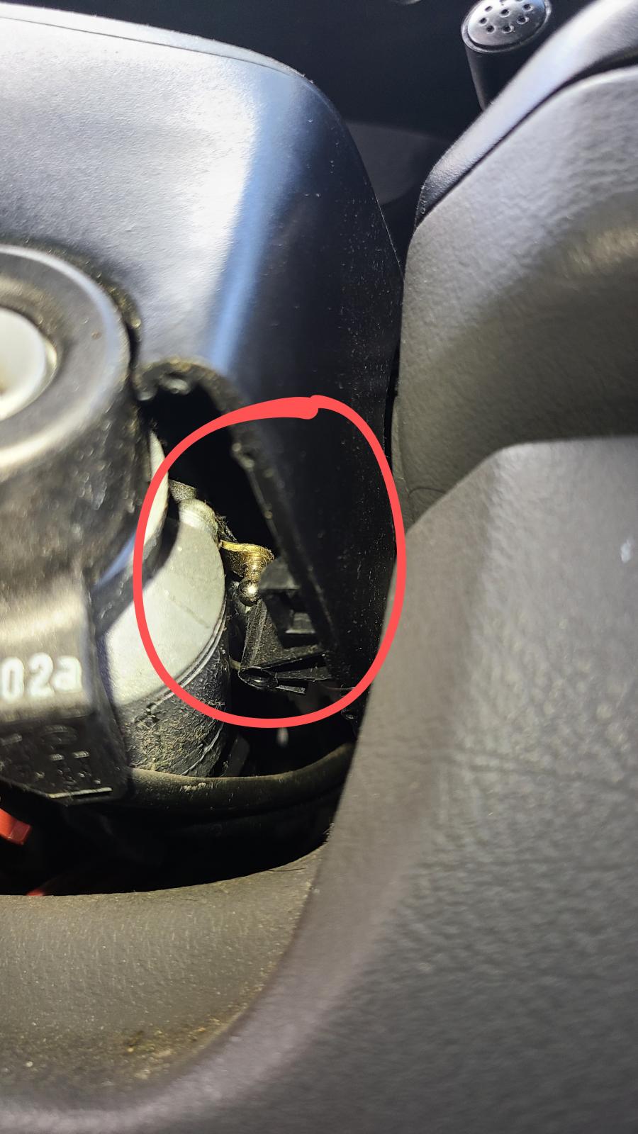

I had just left the ignition interlock cable lying free under the shifter boot, but occasionally it must have moved a bit and the key would be hard to get out. Popping the cable off the lock itself keep this from happening.
