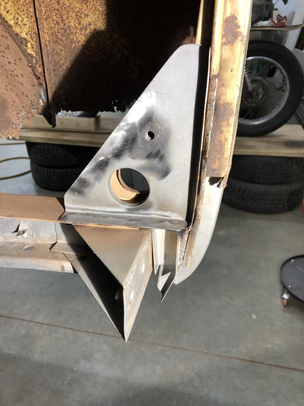

Burlyhammer wrote:
indented hole in the center is pressed the wrong way.
Amazing what the brain can ignore sometimes Smile
I would jam a block of wood in the hole and hole saw out the lip section, flip and weld back.

PostPosted: Mon Aug 17, 2020 5:53 am    Post subject: Re: 1959 Mango walkthru metal rehab. Reply with quote
sgellis wrote:
Haha. Don’t get me started with my brain...
I was thinking along those lines myself. Can’t leave it.

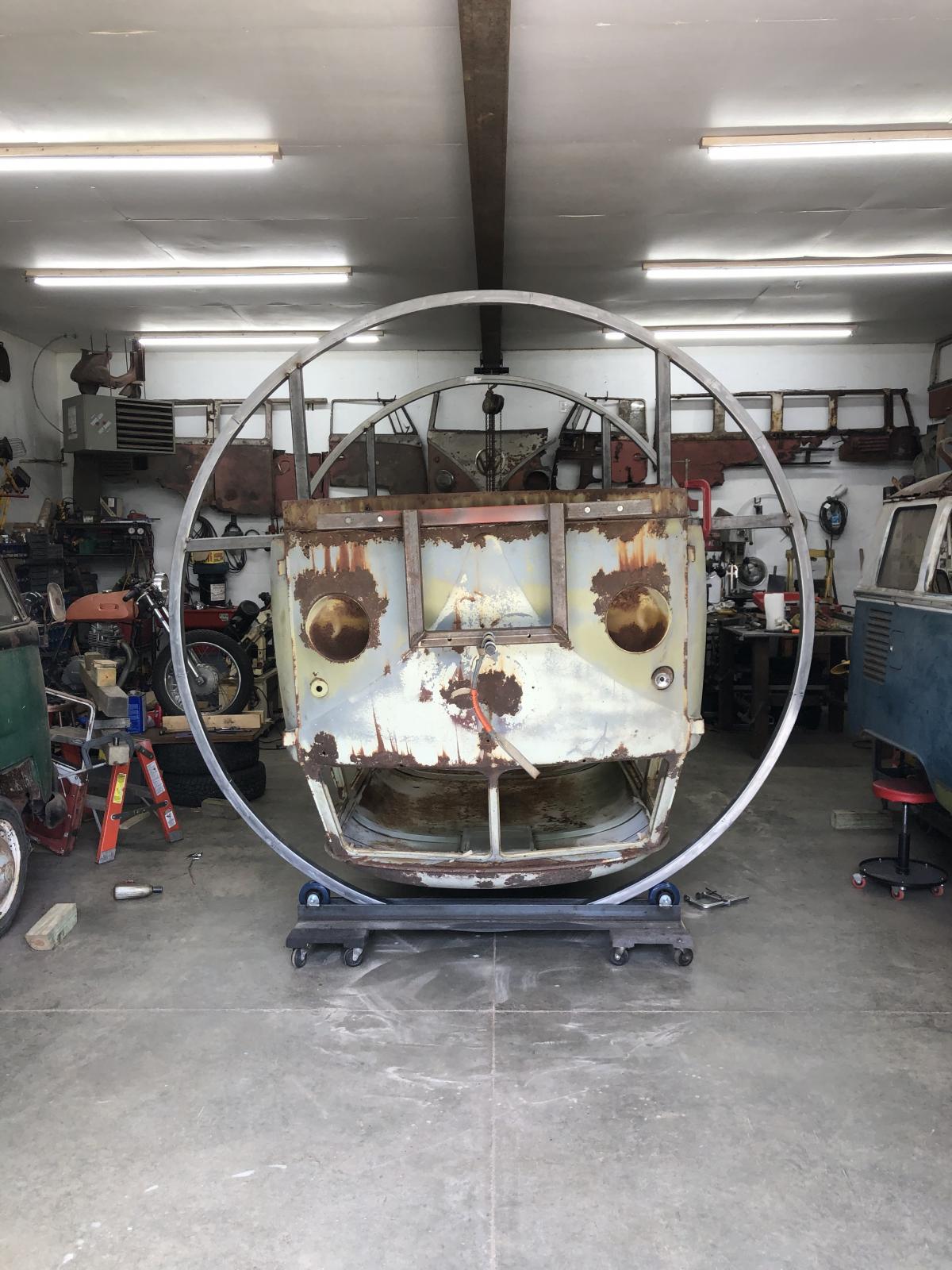

I took last week off from work. I planned to go on a road trip with my chums similar to what we did last year. This year I couldn't go, so instead of moping around, I worked on VW stuff. My plan was to sand blast the chassis and inside of the bus. Matt, the owner of the bus came up to lend a hand. We used 800 pounds of sand, and made quite a bit of progress between rain storms:
While I was blasting, Matt got going on the rotisserie we had planned to make. There is still some blasting left, but we did make this:
Now the fun can really begin!

Great job on the rotisserie, where did you have the hoops made?
Burlyhammer
Joined: March 07, 2002
Posts: 1734
Location: Great north woods Maine
Burlyhammer is offline
PostPosted: Tue Aug 25, 2020 7:18 am    Post subject: Re: 1959 Mango walkthru metal rehab. Reply with quote
We had the hoops bent at a local fabrication shop. Each hoop is made from three separate pieces of 2" stock. One hoop had to be sectioned in several places to make it round and "flat." When we first got the pieces, I did not think they were going to work out, but Matt spent a lot of time configuring, and splicing to get the hoops where we could use them. They aren't perfect, but definately a step in the right direction.
Thanks boulderz!

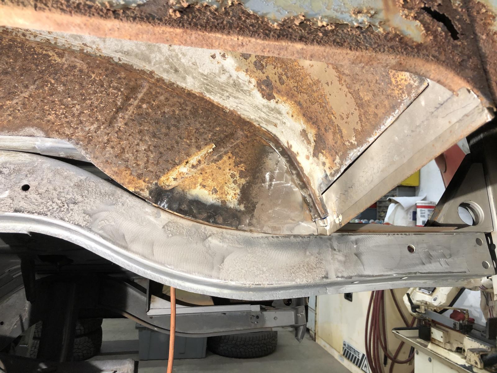

Fixed this:
Working on the back end. I made some progress this morning:

Finished welding, grinding, and moving over to the drivers side:

Moving on to the drivers side:
I copper welded the repair section for the drivers side fender. well While the paint was drying, I moved back over to the passenger side to start in that rear fender well:
I am going to cut the remaining flange off of the inner fender, I just want to make sure I get my radius right on the replacement panel first. When we were sandblasting, we postponed blasting the inside of the bus, and some of the rear sections to be done a little later. It rained several times while blasting, and the metal was flash rusting. Now all of the bare metal has been treated, there is no rust concern. Hopefully we will finish the sand blasting soon. Can't wait! Rolling Eyes
