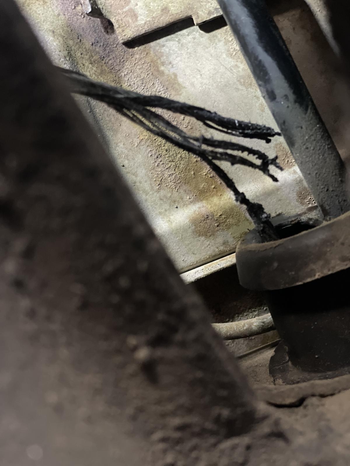

Yesterday, all was good and the car was running great. I dropped my son off at school and pulled up to a very busy intersection. The light turned green and we were off. 1st gear, perfect, clutch in to shift to second and pop, on more clutch. Oh shit. I quickly got it in 3rd and had to make some decisions. I got off the main drag and took an alternate route with less lights. Next light, made it, next light was red. Had to turn it off and start it in first to get it going. Went 1st to 3rd to 4th. Hey that was pretty smooth. Made it to the neighborhood, had to down shift, hey 4th to 3rd was pretty smooth. Phew, Made it home. 10 miles with no clutch in rush hour traffic, not how I planned on starting my day. Once home, I fired the bus up and drove that to work.
I would imagine the clutch cable broke, but I have t been able to look at at yet. I should have time next week, if it doesn’t snow.

Well, unfortunately it’s not the clutch cable or the throw out arm return spring. Seems like it’s gotta be pressure plate/throw out bearing related.
Total bummer. I guess I’m gonna put it back together and wrap my head around pulling this motor. That’s gonna be a lot of work outside in the cold. My DC is taking up the garage and it’s on Jack stands.

A stab in the dark but, is it possibly a broken clutch cable tube causing this issue?
I've never experienced that but, it's worth looking into before pulling the engine.
Lift the rear seat and have a look under the inspection plate to see if there is a broken weld there.

67rust gave me the motivation I needed to take it all apart again. I pulled the rear seat and the access panel, everything looked good there. I was stumped. So I decided to pull the Bowden tube and just pull out the whole cable. Upon pulling the BT I found the frayed section of cable. Looks like it was possibly rubbing on the metal tube, the end of the BT had a bunch of shit in it so I’m guessing it wasn’t fully seated. Who knows.
I headed to town and ordered a new one from Autozone. It cost me $14 after the $20 credit I had and it will be here on Monday.

Let’s talk about the root of the problem. The Bowden Tube was not seated on the clutch tube which cause the cable to run on the edge of the clutch tube and fray. I did not install this BT, it was installed when the transaxle was rebuilt 7000 miles ago.
I went to re-install the Bowden tube and realized that it didn’t fit over the clutch tube, I put it on the vise and used a 1/2” drill bit to hog out the female end of the tube. After this 2 minute modification the Bowden tube fit perfectly. I thought it felt pretty good before, but obviously there was an issue. Now it’s buttery smooth.
