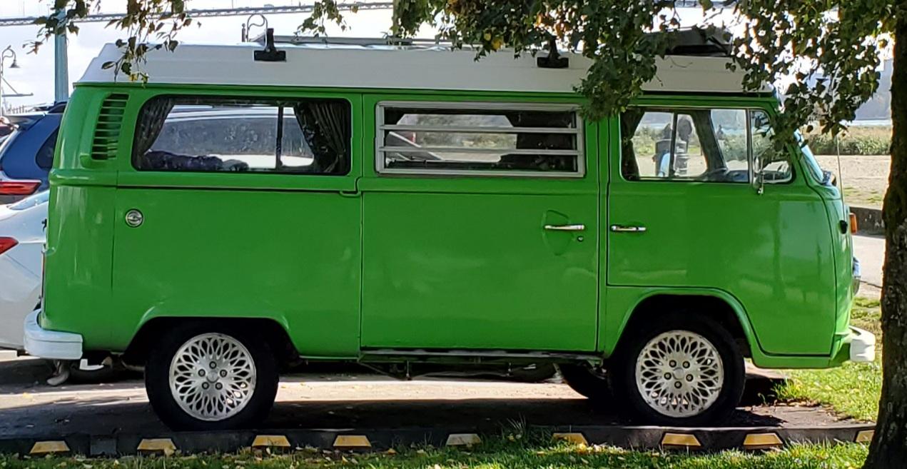

The first pic is with p205/75/14

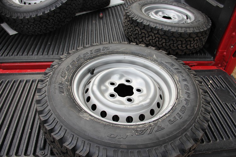

What size are the tires?
I have a doka to put them on.
if they are 14's - which they look like - then they are now unubtainium in that diameter and discontinued. 15's on the other hand.......

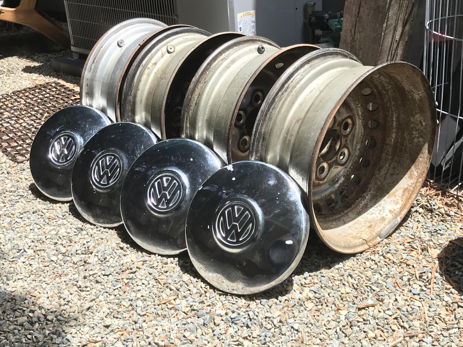

I picked up a set of wheels that came off a 71 westy, with the intent to widen them an extra inch depth wise (14" x 6.5"). I've located a place that can do it here in SoCal, but was wondering if anyone has rocked a similar set up and had any experiences with it? Gonna comb through both the tire sticky thread and this one, but I just wanted put the question out there before I start searchin'.
This is the set I picked up for $40, caps were thrown in as well as a spare wheel...

Take lots of measurements. You should be able to get them exactly where you want them to be if you measure and document carefully.
Looking forward to the outcome of this.

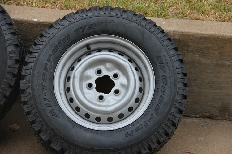

I am way late to the party. Yes, 195/75/14 BFGs. They last forever. I still have them, just on different wheels on a different bus. Id buy them again if i could.

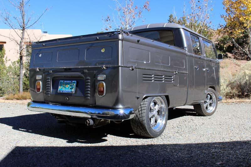

It’s Spicoli, you know fast times at ridgmont high? Thanks for the compliment!! So these wheels still have winter tires on them when I got them from an Audi A6
They are winter cat 215/50r17. They are standard load (passenger). I will replace the with LT load tires when I buy new ones. My van is not a camper, just a transporter. I’m not too worried about sidewall. I only have a rear seat in the back. I had to bore out the center of the wheels to fit over the front dust caps, wheel spacers for the rear to clear the spring plate. I bought longer lug studs from T3 Technique. Thanks to Samba forums I didn’t have to figure all that out on my own. I ended up painting them white because I couldn’t match the chrome-ish color. I have always wanted bigger/ different wheels on my van. I’m really stoked I finally got them on! I still have the original wheels, and the hubcaps still fit over the longer studs.

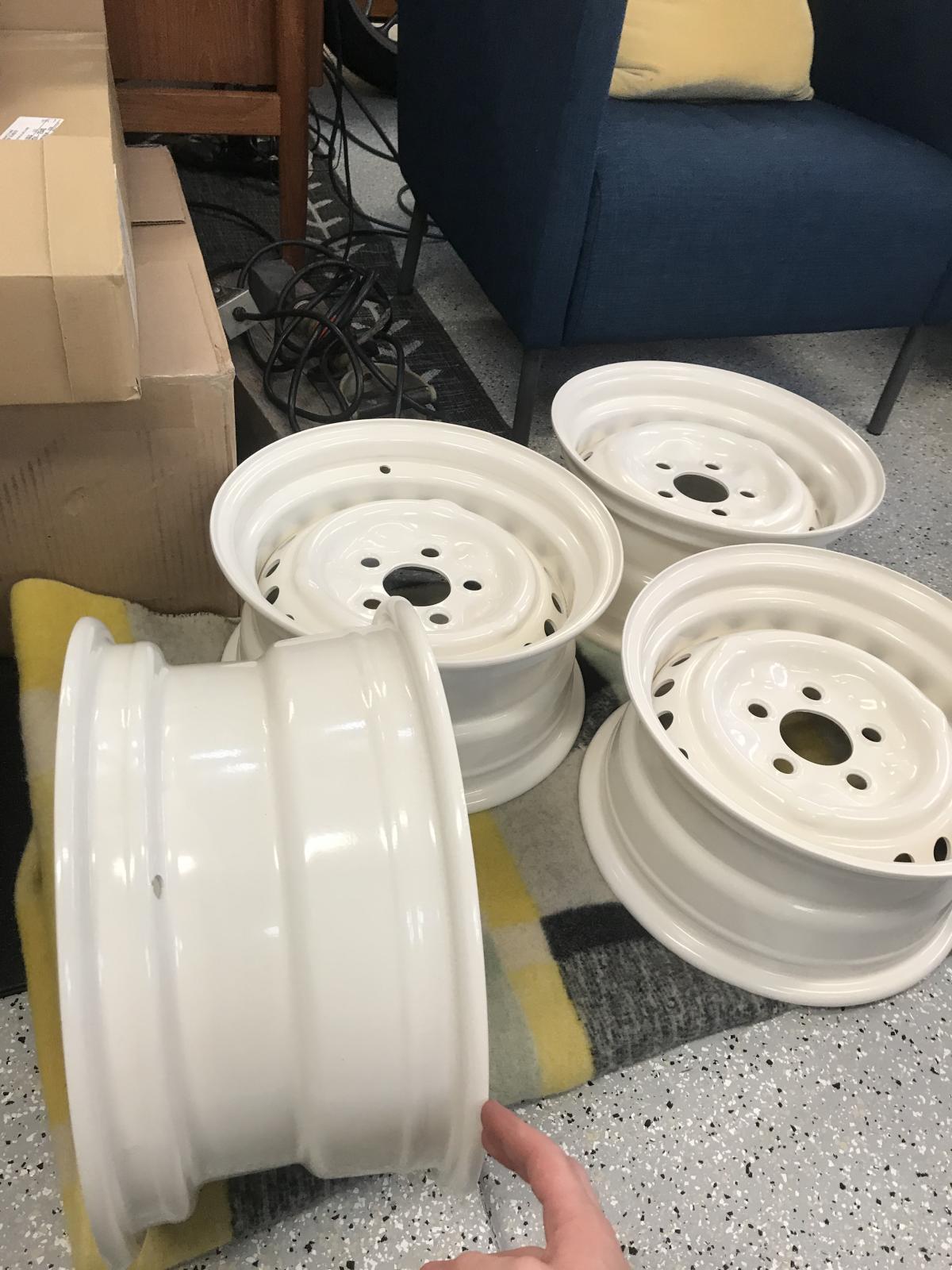

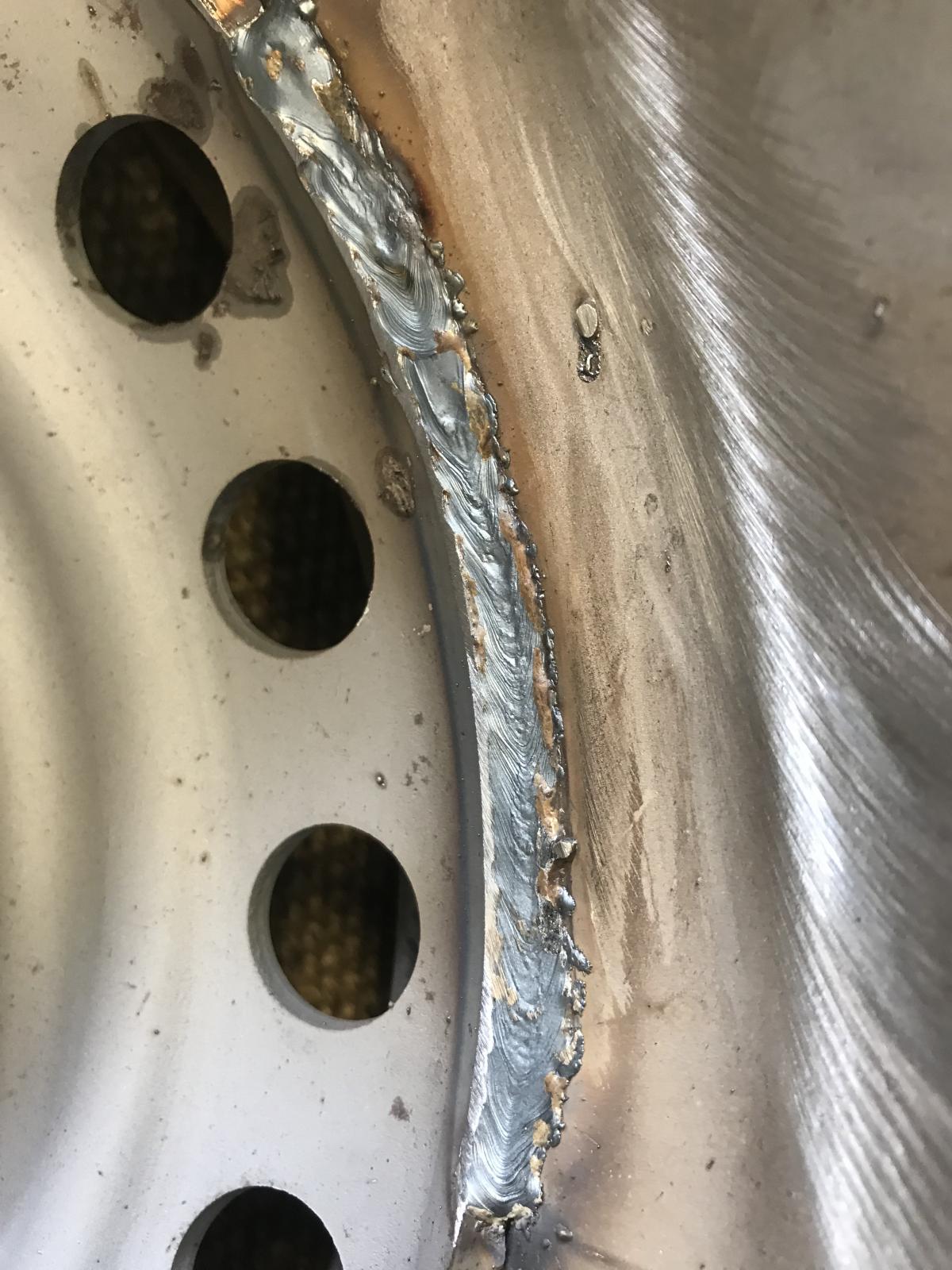

Update: Wheels have been widened and powder coated. Getting some quotes on tires this week, hope to have a photo of everything said and done by then.

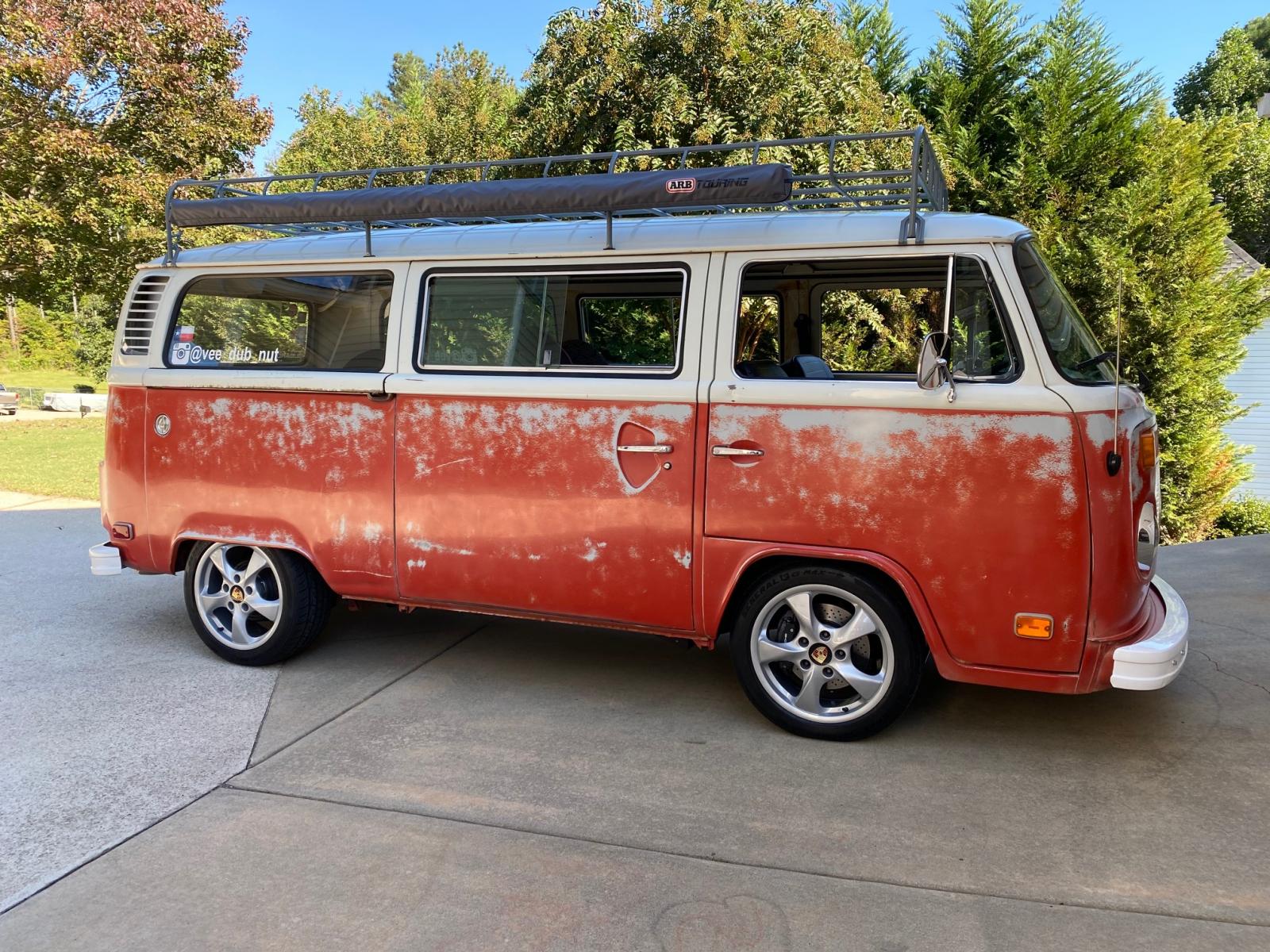

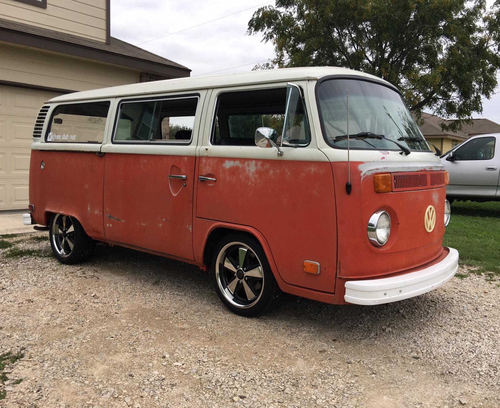

Vee Dub Nut wrote:
Here are mine:
17x7 repop Fuchs wheels from CIP
Wagenswest Slambay Special (4" beam, 2.5" spindles, 3.25" drop plates)
Fronts: 205/45/17
Rears: 205/50/17
Ride quality as good as stock. No rubbing at current height (even loaded with a family of 5). Full lock to lock turning up front with no rubbing.
Any lower up front and you would need to tub the front or run shorter tires. Any lower in the rear and you would need to notch the frame for the CV shaft.
Figured I'd update my setup.
Now running Porsche Boxster wheels (Razor twists I believe??).
Front: 17x7 et55, 205/50-17 w/Porsche Cayman brakes
Note: I gained +16mm from the 944 front hub, so this would be roughly equivalent to a 17x7 et40 on a stock disk setup
Rear: 17x8.5 et48, 235/45-17 w/stock drums redrilled to 5x130 & 13mm spacers
Note: I had to round off the leading edge of the drop plate ever so slightly with a flap disk because the wheel hoop just kissed it in one spot. This is just about all the wheel and tire you can reasonably squeeze under the stock fender well. No modifications have been done to the fender lip with this setup.
Still Wagenswest Slambay Special (4" beam, 2.5" spindles, 3.25" drop plates)
Front tires now being a 50 series get a little rub on the bump below the seat stand at full lock. Did not do that before with the shorter 45's on it. No rubbing in the rear at all. Again, this is at its limits with lowering unless your going to notch the frame and tub the front.
More pics in the gallery
