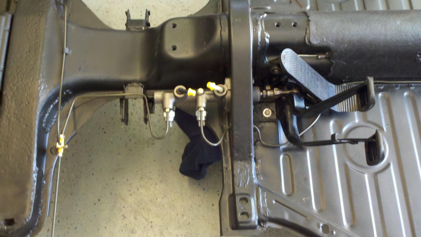

PostPosted: Tue Sep 25, 2012 5:11 am    Post subject: Reply with quote
I decided to go with a gloss black paint on many of the components and a gray for the transmission and axles.
I ended up replacing most of the bolt on stuff. I kept the drum back brakes but added a disc conversion up front. I thought the extra weight I was added would need the extra stopping power of front discs. The front suspension is mainly from Topline and everything is set to be about 1.5 inches lower than stock (we will see once everything is loaded?)

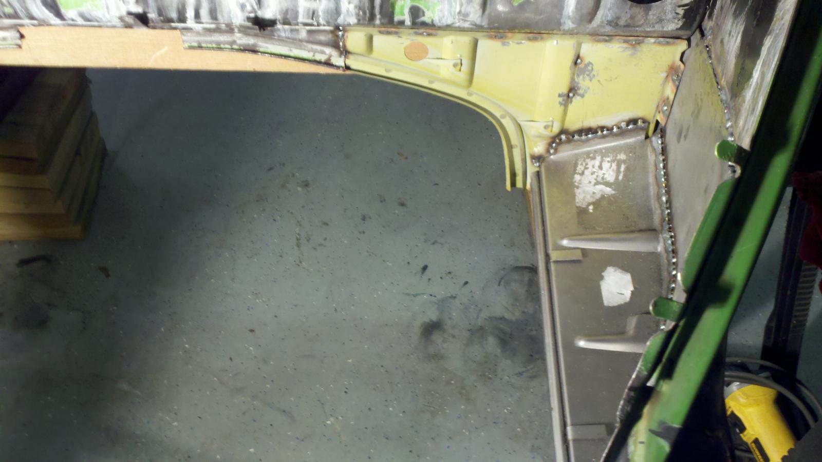

I made some progress on starting the rust repair of the body over the last few weeks. I started with the front of the vehicle and used a grinder with a knotted wire wheel brush to remove all the paint (and hopefully all the rust too). The corners were the tough locations so I used a drill with a small wire brush attachment which worked ok. Some the areas were only accessed by hand and a small brush. Most of the front end was in good shape except for the area that contacts the pan at the very front on the passagers side (bottom of the arch). Sorry, I don't know the panel names...
I purchased some repair panel steel in 16 gauge and 20 gauge for the different areas. I don't have a metal break so I bought a cheep harber frieght shearer which ended up working great. I used cardboard as a template which was perfect. I little time with the cardboard saved a lot of trim time. With everything ground down, I tacked the repairs in place and then completed the welds. All the welding was covered with Eastwood seem sealer before a final coat of paint. The trunk area was in good shape with surface rust and a few holes. I tried Por 15 in this area for the first time. It seemed to work well (we will see). I plan to prime and topcoat with paint shortly

The area at the back wheel wells had some previous repair work performed by the previous owner. Most of the work looked pretty good. Some of the repairs were made by brazing instead of welding. I'm not sure but brazing may be a lost art.

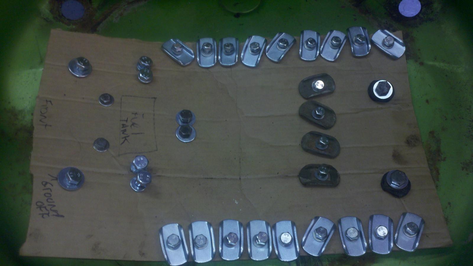

I found this photo and thought I would share how I kept track of the body to pan bolts.

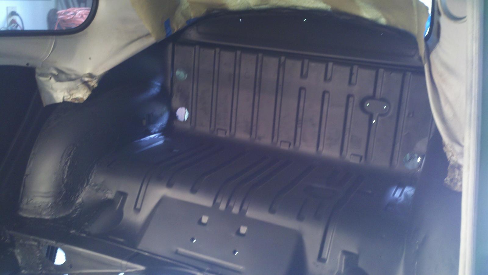

I finally finished removing all the rust in the engine bay and cutting out the
remaining rusty panels. I purchased replacement panels for the engine guard at the back of the engine bay and was surprised when they were delivered. The left and right panels look fine but don't extend to the middle of the bay far enough to replace the whole guard (I know it isn't called a guard but I don't know what else to call it....maybe surround tin at the back). I ended up cutting out the rusty tin and leaving small sections of the existing center tin and mathced them up with the new surround tin.
I ended up replacing the entire left side of the engine bay since there wasn't much left. I cleaned all the rust away and sealed the area with POR 15. Man....does POR 15 smell bad when you weld to a panel close to when it was applied.
The left side of the compartment hat rotted away at the area where the rear apron attaches. I found some nut plates the right size and fabricated an extension to fix this area. I first attached the left fender to make sure the nut plate location was correct. I do plan to put both feners on to mark the correct location for the new apron.
