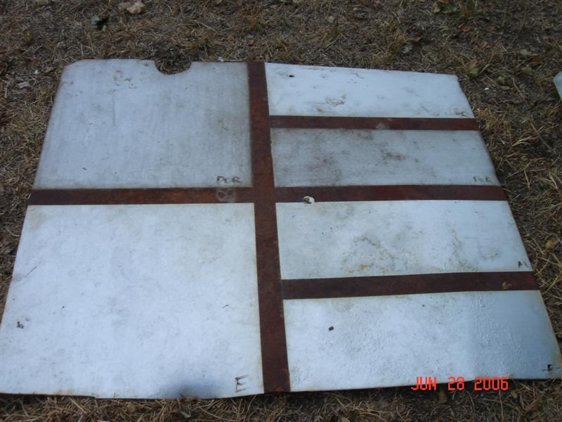

I've been following Lee's experiment as well and referred others to it. It is a very useful test.
Thanks for that link - That's quite interesting as well.
Lee.

PostPosted: Sun Feb 19, 2006 10:04 pm    Post subject: Reply with quote
chubbydude wrote:
Thanks Lee for doing this excellent comparison.
I was wondering what the score was, or when you are planning on doing an update!
I have seen a similar unbiased comparison on the net, and POR won in terms of stopping rust creep.
http://www.drjing.com/Mini/BLOG/SideBySide.htm
I'll get some pics up tomorrow. I threw a bunch of de-icer all over them a few weeks ago.

PostPosted: Tue Feb 21, 2006 3:32 pm    Post subject: Reply with quote
Thanks guys.
No change except the small ones are bubbling a little bit.

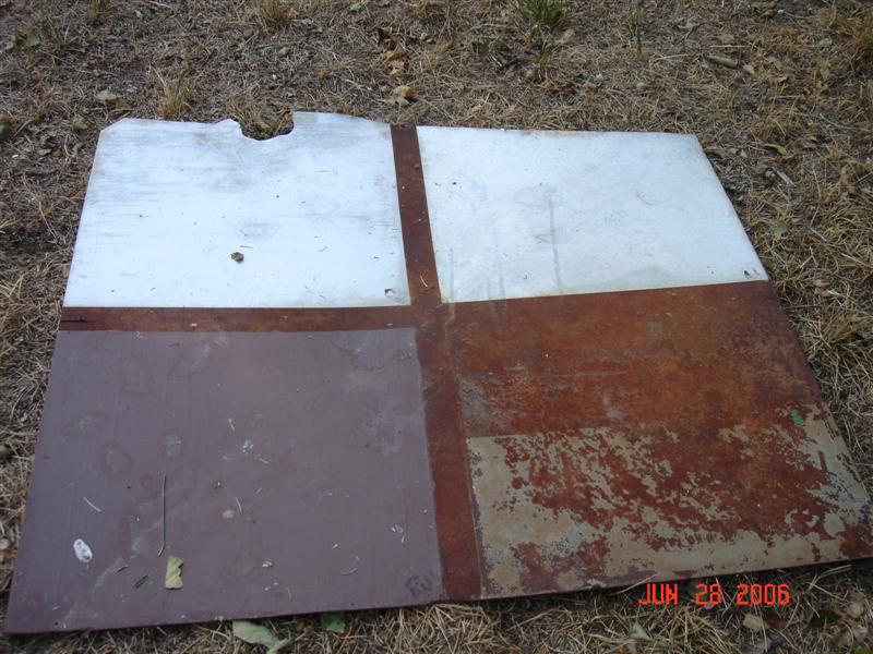

PostPosted: Thu Jul 13, 2006 6:00 pm    Post subject: Reply with quote
No changes in the big panels. All of the smaller samples are starting to bubble pretty bad. If they had been topcoated with paint. It would look like crap.
I have them set up to get hit for 20 minutes a day with the sprinklers for the rest of the summer.

Lee. is offline
PostPosted: Tue Jul 25, 2006 12:54 pm    Post subject: Reply with quote
redbug68 wrote:
OK! I cant wait any longer....
if you had to choose now which one would you say is in the lead.
I need to do something for the pans I just installed beofre rust attacks!!
I just went out and looked. Por & RB are doing a little better than the others. I would say go with RB because it's a little cheaper.
Make sure to get the metal as clean and as rust-free as you can.

PostPosted: Wed Aug 16, 2006 12:34 pm    Post subject: Reply with quote
Spentzos wrote:
Is you sample piece in the sun?
Yes, they have been in the sun the whole time.
Today, I dropped a 10# rock on each sample. Dented the metal, but, no other damage. I also poured a quart of brake fluid on the samples. We'll see what happens.
