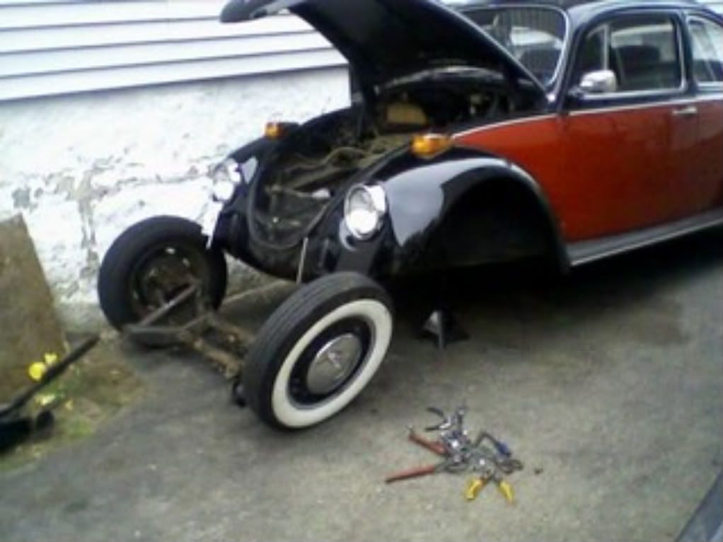

car drives nice now except when i get on the highway and once i get up to about 60 mph the front starts to bounce like crazy......................
what could it be...ive replaced all the shocks and damper...

PostPosted: Mon Oct 19, 2009 8:30 pm    Post subject: Reply with quote
It's because stock does that.

Really? Mine doesn't.

Vespaboy200, what size tires you got up front? And what pressure?

most likely tires. are they balanced? how old are they?

PostPosted: Wed Oct 21, 2009 4:11 pm    Post subject: Reply with quote
vespaboy200 wrote:
What I have noticed is that the bounce only starts after hitting a bump on the road and it gets worse as the car accelerates ...
That sounds like bad shocks.
Max
All new shocks... the frame head pan is weak...
Lets just hope the car doesn't all of a sudden just lower itself while driving then Laughing
