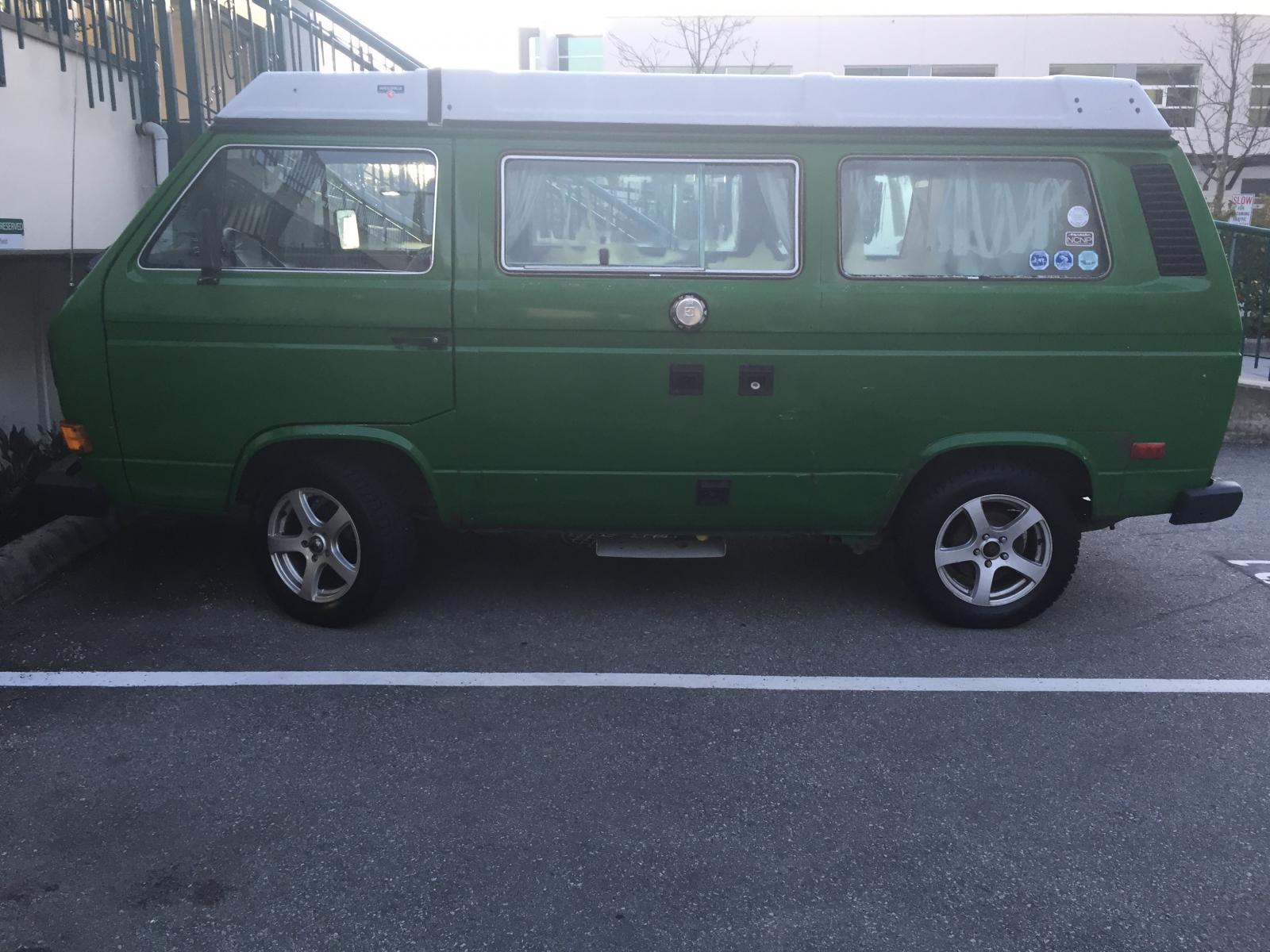

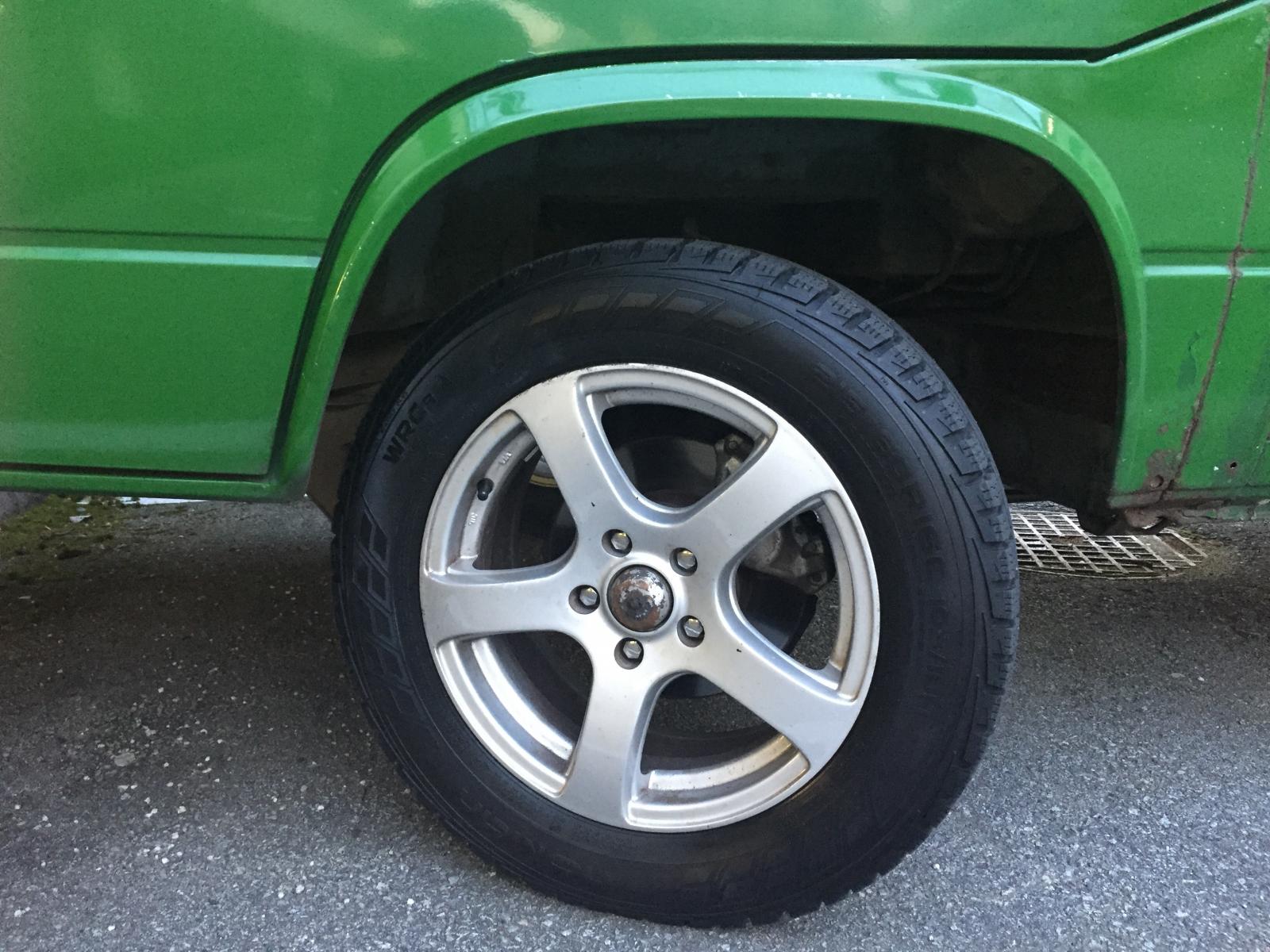

nearly ALL Audi rims should have a spacer at least in the front.
do you have a 2wd or a Syncro van?
remove the wheel and tell us the sizes cast/stamped into the rim
there is an ET##
and an 6J or 7H or sumsuch too.
but plan on 8mm spacers and longer front lug bolts (if 2wd)

Thanks, Dan and Jim.
I'll have the tire shop inspect the Audi wheel information, Dan, and I'll post the outcome. I'll ask to see if the previous owner knows the wheel information; they may.
