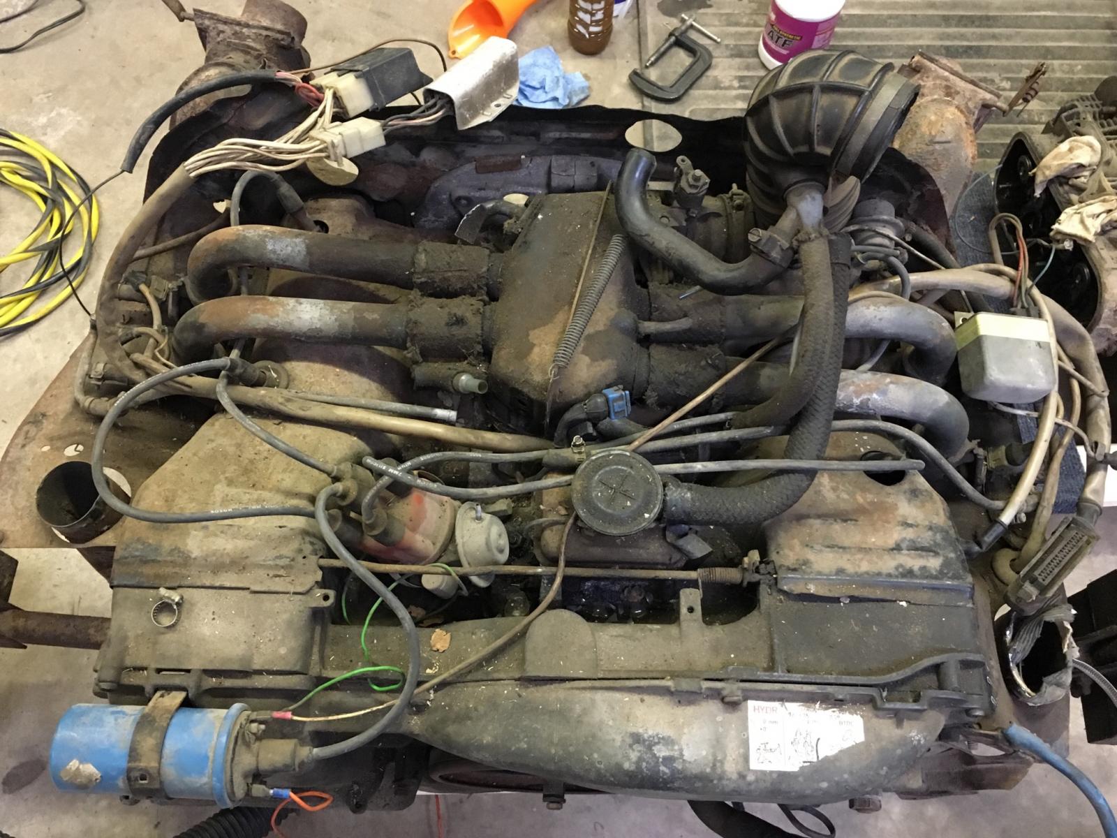

Here is the believed to be complete GE coded type 4 engine with all the original Fuel Injection items:
Before removal of components:
Here are the items removed from the engine case, a light degrease, and laid out as they function on the engine:
Anything jumping out to anyone as missing?

From my puny phone screen, the CSV and TTS appear to be missing. Also check for a decel valve, TS2, and ECU. I’ll check again later. Smile

The FI barrel nut on the throttle cable is flanged, unlike the common ones that are sold for carbs and heater cables. (Looks like yours is missing too.)
What engine is this going on? A factory FI engine should be good to go, but with a factory carbureted engine, you’ll need a few upper case bolts swapped out so they’re long enough to hold the plenum and TTS. The carbureted firewall tin also needs drilling to take the throttle cable, left fuel line, and FPR.
Also, make sure the EGR blockoff is airtight, and sell the EGR stuff to a Californian bus owner.

Missing CSV on original engine pic for sure.
