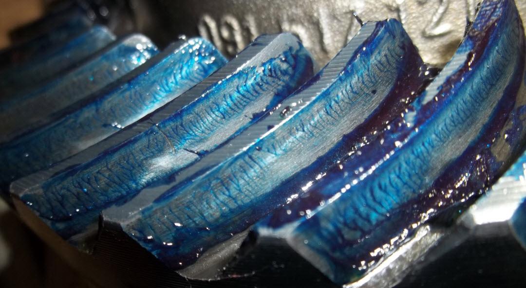

While my transfer case has symchros just like types 1, 2 and 3....my final drive is hypoid. In cross section ....say....looking from the drivers side, an 091 has its pinion intersecting the ring gear at the 9 o'clock position. My ring gear comes from the left side just like the 091....but intersects the ring gear at about the 5 o'clock position and maybe closer to 6 o'clock. It is hypoid but as they say it's a lightly loaded hypoid. |
Pretty sure than the 002 and 091 are both low offset hypoids, which is what GL-4 hypoid oil is specced for. |
Mmmmm....not really. They have a spiral bevel gear. It may have a VERY slight offset but is not hypoid in its tooth contact "action". If you want to consider that "hypoid"...ok....but barely.
One key visual is that most hypoid final drives have a "bell shaped" or reverse cone shaped pinion gear which is opposite of what the 091 has.

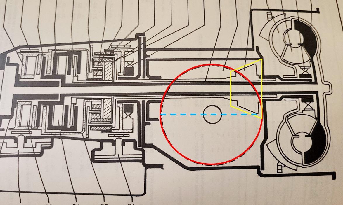

This is stolen from Ratwells site so I am not sure whether this is a 002 or 091.
I outlined the pinion gear in yellow and the ring gear would be where the red ring is. The blue dashed line "should" be the ring gear centerline if this cross section sketch is accurate which its pretty close.
The pinion contact offset from the centerline of the ring gear is very small.
This next one is from a 003 automatic. I am trying to find a similar exploded view of the 004 I have....but books are few. The 004 from a 412 has the nearly identical pinion position as a 003...I recalled that it was down around 5 oclock instead of up around 2 oclock like the 003....but its not. Its up around 2...but it also has the distinctive reversed bell shaoe of the pinion.....both of which are splined onto the shaft.

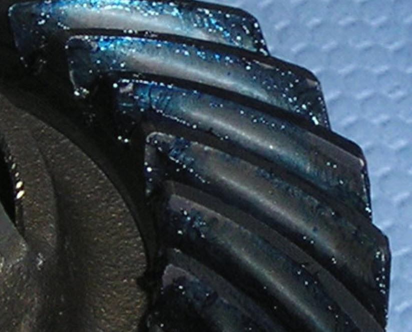

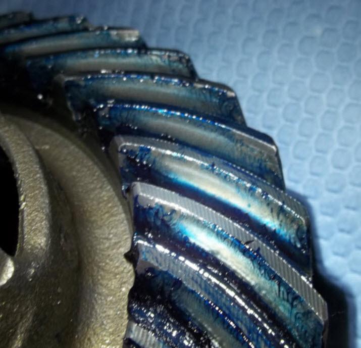

Also the very tight spiral of a hypoid pinion is very noticably different from a spiral skew bevel.
Here are two shots of the 004 pinion gear. The teeth are very deep and have very thin outer edges. A lot of tooth contact and sliding friction.
To be sure that you understand how different this is....that ring of bolts on the right are the bell housing just forward of the pressure plate.

Correct....Technically...sure...the 091 and 002 are BARELY hypoid as I noted. They are barely off-axis. A lightly loaded hypoid gearset....which is why it can use GL-4.
However, don't fall into the poor practice so many automotive people have by instantly seeing "spiral bevel" ring gear and calling it hypoid. Not the same.
Yes....and axis the offset they are speaking of is the pinion ceterline axis that it rotates around versus the center ring gear axis that the ring rotates around.
So as I noted......sure....if you really want to split hairs, the 091 and 002 may BARELY be considered as hypoid. However what it IS is a spiral bevel gear with a very small level of off-axis mesh.
Meaning, it (the 091) has a lot less tooth contact and spiral pitch (which also makes it more efficient than what is generally considered hypoid)....but is not really considered "hypoid".
This is also why it does not require the additional EP additives of GL-5.
Here is soemone else who gets it as well. Very simple explanation.
https://www.youtube.com/watch?v=DhCyz7k7ifQ
Wiki explains it very well. And make note...the first paragraph is defining "spiral bevel"...which it should be because ALL of our differentials are spiral bevel as a baseline gear tooth "type".
And....the first picture IS of a spiral bevel gearset and its almost a dead ringer in layout and offset to the 091 and 002.
The second paragraph is gear tooth "handedness" and the third paragraph is about "Hypoid Gears"....and the illustration is EXACTLY what I am speaking of. NOTICE the "cross hair" drawn in the center of the ring gear?
The horizontal axis line ...which the pinion is clearly below...is the "offset axis" that makes the gearset HYPOID....and not JUST having spiral bevel gearing
It clearly shows the offset off the pinon gear. And YES the degree of offset is important.
https://en.wikipedia.org/wiki/Spiral_bevel_gear#:~...ng%20gear.
Its a very short, 1 page wiki. Its worth it to read all of it
The visual excerpt: The red arrow points to the axis line of the ring gear/diff and the red line shows the axis of the pinion shaft and gear. Once those are no longer in line....the gear set is hypoid.
Another clear visual:
And the degree of offset is critical and ideally...should not exceed 25% of the ring gear pitch diameter from this MIT document about calculating gears for production.
https://www.mitcalc.com/doc/gear7/help/en/gear7.htm
Quote: |
It is recommended that positive pinion offset be used because of the increasing diameter of the pinion, higher face contact ratio, pitting and bending load capacity. ln general, due to lengthwise sliding, the offset should not exceed 25 % of the wheel outer pitch diameter and, for heavy-duty applications, it should be limited to 12,5 % of the wheel pitch diameter. |
A good explanation as to why the 003 and 004 hypoids have the pinion shaft crossing over the rin gear and the pinion is reversed. It is because this keeps the same maximum offset but increased gear surface mesh (and sliding andfirction to some extent)....but allows having a reduced diameter for the ring gear (compactness). It also makes them much more smooth and quiet.
So is the 091 and 002 "hypoid"...yes...technically but not to a significant extent to where they require a higher level of EP additives.
Ray |

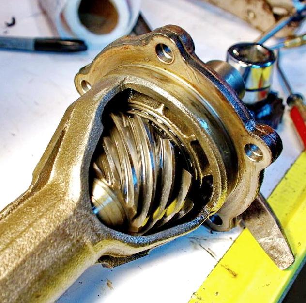

I don't know if these show enough detail. One area of concern for a bus trans is that the area where the diff is, is cut off from the gear area by only small openings for the gear fluid to move back and forth. As a result there is reduced cooling on 4th gear and the nylon/plastic needle cages melt with sustained high speed driving in hot weather. The plastic distortion captures the needles which in turn stop rolling and flat spot /spall. That damages 4th gear and the main shaft. It is why new old stock main shafts for these are made of unobtainium, and why they are reproduced today. I know that when I was looking for one many years ago, even then builders like Rancho had many transmission rebuilds on hold trying to locate 091 main shafts. Getting the correct gear lube and grade is very important on these buses. They are survivors but nothing lasts forever.
Wow....that's actually a little worse than what is on the 004. I think we get some of the same issue....rearward slosh from forward inertia when moving so you get high oil level in the diff and low level in the gear section.

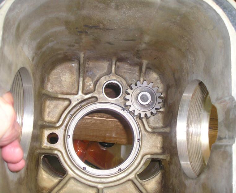

This is a photo of 091 gears. You can see the brass synchros sitting up against each gear and slider
Ray - here is a photo of the needle bearings that came out of my 091. They got so hot from the PO's driving that the plastic melted. Some late bay and vanagon owners who use larger HP water cooled engines have to modify their 091 or 094 to install an oil sprayer that moves gear oil thru an external gear oil cooler then sprays 4th gear with the cooled fluid to keep the temperature down on long grade climbs. The only needle replacements available now are steel caged ones that Weddle sells (2 photos above). They are designed to not melt. This is not a problem when someone is running around in a 1600 single or dual port early bay because there is not enough HP to fubar things. But later bays have more HP and heat. Of course the speed limit was 55 mph back then so high speed use was not really the problem it has been since 1995 when that speed limit was lifted.
