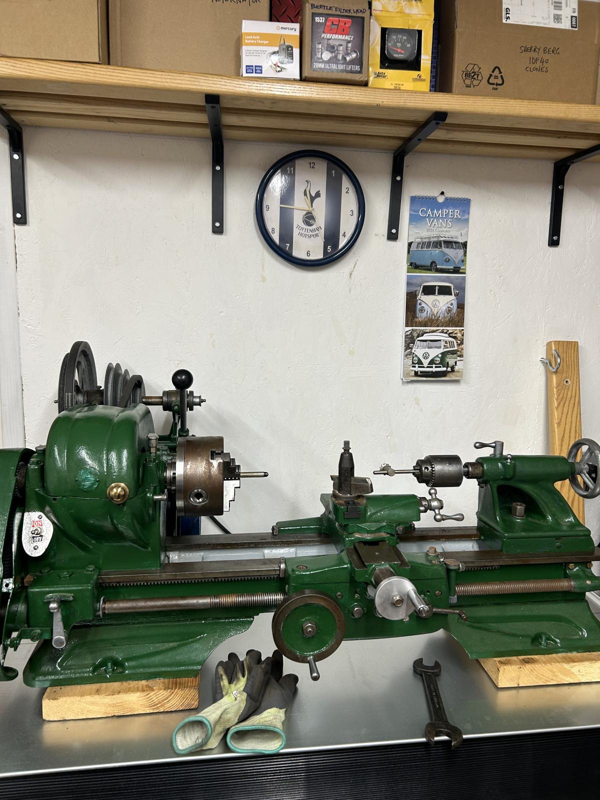

I am now the proud owner of the Atlas 10F-28 Lathe, and collecting it tomorrow. I am getting myself the manual, and hopefully can start practicing soon.
In the meanwhile though, and this is SPOOKY, Zed999 alluded to hearing from a friend of a friend or being in the right place right time ? Well chatting to a mate down the road in our village, and he said he knew of an old guy who used to race and build motorcycles, anyway, I rang him, and just went to see him. He knew exactly what I needed, and is going to do these cylinders for me, he said that he's done this loads of times and is 100% confident that he can take the 0.010" off as needed for all 4. He's a real old character, and a pleasure to talk to. He even said he could show me some of the basics

Yes, @Zed999, he was amazing, just as you'd expect, a sort of old grateful dead hippy type with a big baggy comfortable woolly jumper and a big woollen beanie hat with the beard and the long grey hair, and a sort of air about him. God know what we will do with all that old knowledge gone ? sad in some ways, but as you also said, yesterday I didn't know he existed, and a chance conversation this morning with my neighbour led to meeting ? Weird

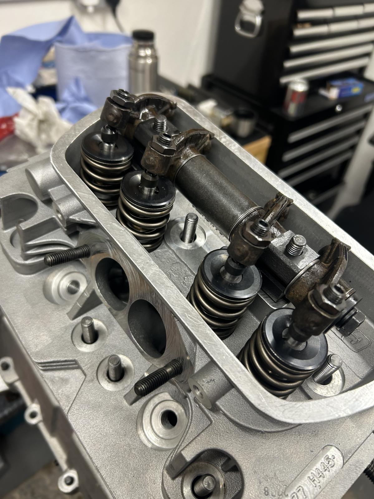

I have been carrying on with the mock up, and DH is 0.040” on all 4.
I have put on the head on the #1 and #2 side to look at the length of the new studs, and popped on the Rocker arm just to have a look at it, it’s new CB solid shaft, stock rockers that I have back cut and TP Adjusters. I need to torque the head, and do the final rocker adjustment.
As I say this is all just mock up, I’m miles away from this engine seeing any Glue Laughing Laughing

So, when I originally measured DH, I was at ~0.050” on all 4. The Cylinders went in for 0.010” to be removed.
Today I am still mocking up, and still looking at things like stud lengths, rocker assembly etc and decided to measure the D/H again and I have got the following Rolling Eyes
Not sure what has gone on here, but I have been over an hour confirming this and I have
#1 = 0.040”
#2 = 0.041”
#3 = 0.039”
#4 = 0.038”
Averaged out to 0.04025”
I’m pretty disappointed with the 3/4 side, but I guess it is what it is ? What is the consensus on this? Am I overthinking this one again ? If I am perfectly honest I may have had a tiny deviance in my first measurement when I was at the 0.050”, and assuming that the machinist did remove EXACTLY 0.010” off each cylinder, it just brought that deviance with it.
Anyway, I’m thinking that I am OK to continue ?

PostPosted: Sun Dec 07, 2025 7:25 am    Post subject: Re: My 2007cc Bus Engine Build Reply with quote
Nothing ever comes out exactly, to the thousandth all round, first time...
Everything has a " machining tolerance".. it's one of the first big hurdles you start to understand when you build engines.. it's not going to fit together like lego... you have to make it fit together, with tolerances you believe will work... different applications, and different people!! Shocked Have different tolerances they'd like to see...
You never stop learning about this..
The skill... is knowing when you're at a close enough tolerance "for your application", that the extra work won't make a difference...
Where were the parts made? To what quality standard?
Did you move barrels, pistons, rods around?
What temperature was it when you measured originally?
What torque on the hold down plates?
How accurate/expensive is your torque wrench?
How good are your measuring abilities/eyesight?
All the above and more can cause error in your new measurements..
You are 4 thou out over all the holes.. importantly only 1 thou difference on each side though.. heads should seal, deck will do the squish thing very nicely, and if using good components and building carefully nothing will hit...
I would be pretty happy with that... I've seen far far worse over the years!..
You could take a wisp off the case on the 1/2 side if after perfection, very doable, but can be a dangerous game to play.. or indeed the barrels, but I don't think you're set up for that quite yet..
Imo yes, you're fine to continue..
Also... as an aside.. do you really want a consensus?! You think theres a way to get most people on here to agree?! Very Happy ...
