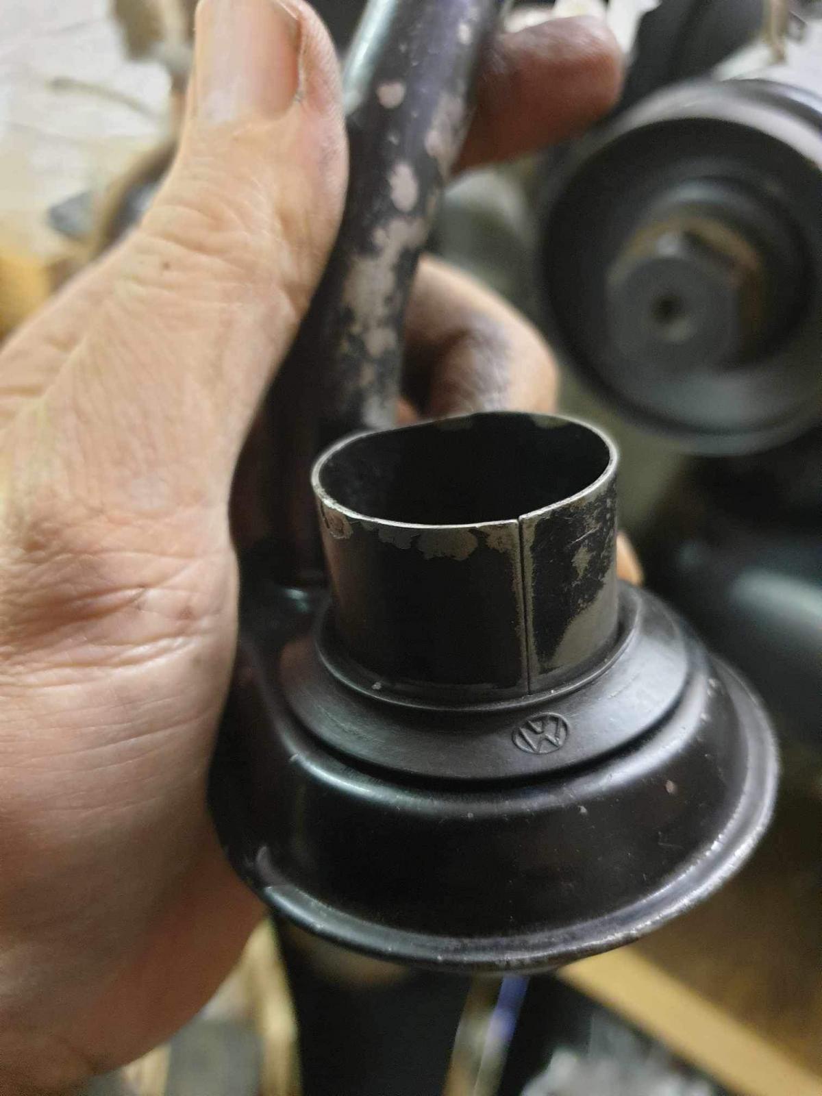

^Thanks. Appears unstamped
VW logo on oil filler seal
14mm Kamax on the generator strap
I have a Verbus bolt on a second strap I have, off a slightly earlier engine

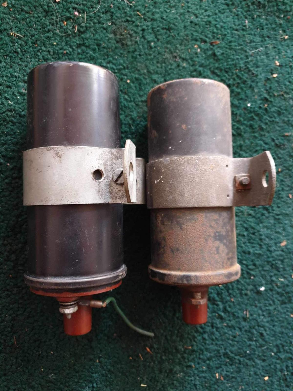

Two holed Bosch TE6A3 coil brackets
The left bracket has two holes to the rear too

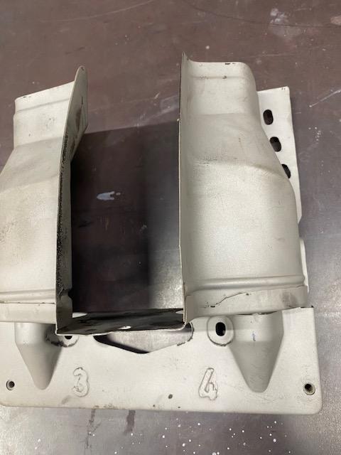

Cleaning up a '54 motor I had sitting and while glassing the tin noticed that the 3 and 4 cylinder top tins had been double stamped? Maybe a mixup at the stamp machine?
'58 Beetle - L245 Bronze
'73 Vert SB - Dove Grey
'74 Sedan SB - Tropical Green
'72 Bay Panel - Pastel White
Posts: 71491
PostPosted: Fri Apr 05, 2024 5:58 pm    Post subject: Re: 1954 & 1955 engines whats not correct! Reply with quote
Weird but very cool.
I guess they had the numbers backwards?
