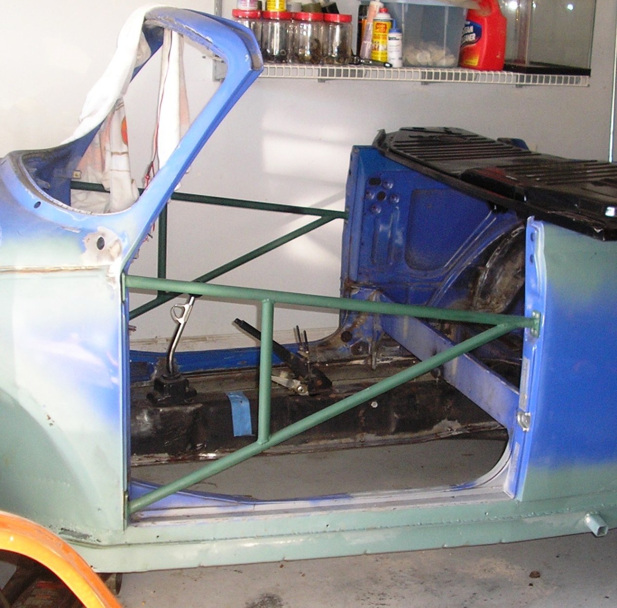

Here is a picture of a set of braces that I bought from a company called BUGSTUFF in West Brownsville, Pennsylvania. (BUGSTUFF can be contacted at (724) 785-7000 or [email protected].) The braces mount in the existing locations where the door hinges and the striker plate mount so that no welding is required.
Thanks `Bugs and Pugs,` I bought a set of the `door bars` and they fit perfectly. My rails are in place so I have my rails for half price on theSamba classifieds.

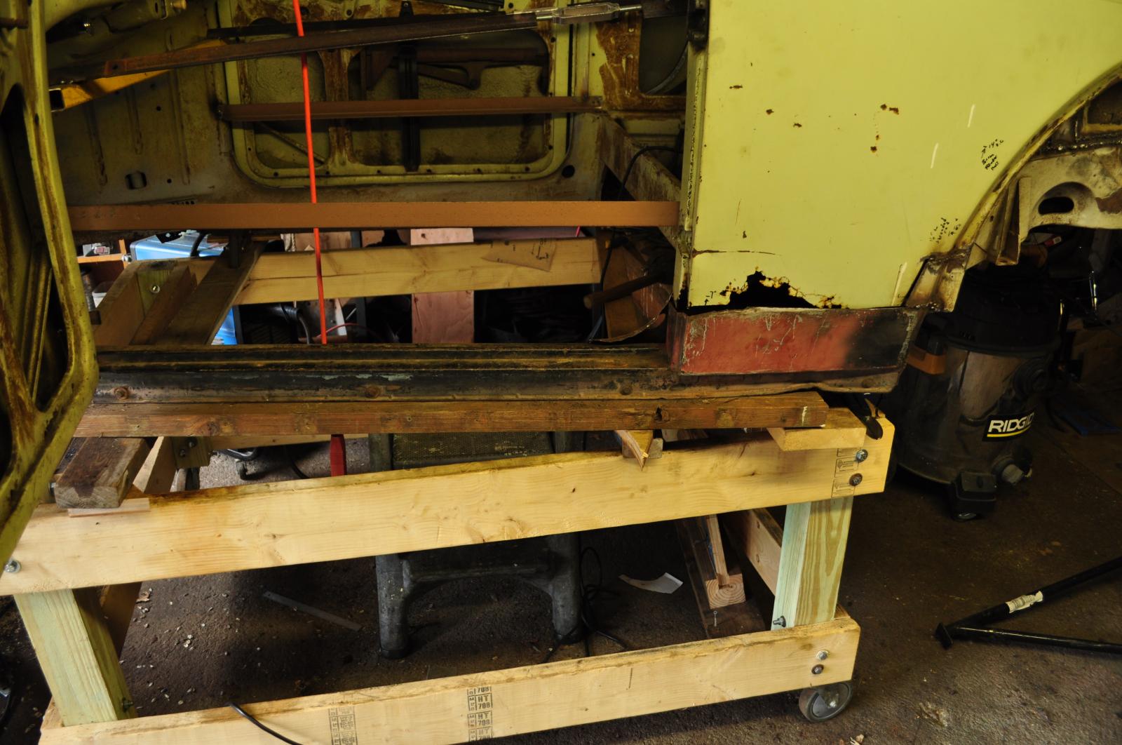

Working on my 63. I replaced the drivers side heater channel but haven't done the support rail yet. Here's my issue when I open the drivers side door it drops a bit. To close it I have to lift up on it and then it closes and is lined up. My question is when I do replace the support rail will that make a difference so the door closes properly without lifting? Any help is appreciated.

That sounds more like a worn hinge causing the drop. I would fix that first before I do the channel so then you can line it up accurately.

PostPosted: Tue Aug 06, 2013 5:01 pm    Post subject: Reply with quote
Thanks Bryson
I think my pins and hinges are ok. There doesn't seem to be any play in them.
I'm about to place the car back on the pan to see what happens with the body rear mounts. I'm hoping maybe a little shimming at that point will do the trick.
I'll post the results after I get some help lifting the body back on the pan.

Figured out the issue with my doors. It was simply that the body was not level on the cart. One side still has the support channel the other side is rusted away. Embarassed Once I leveled the entire body both sides work great.

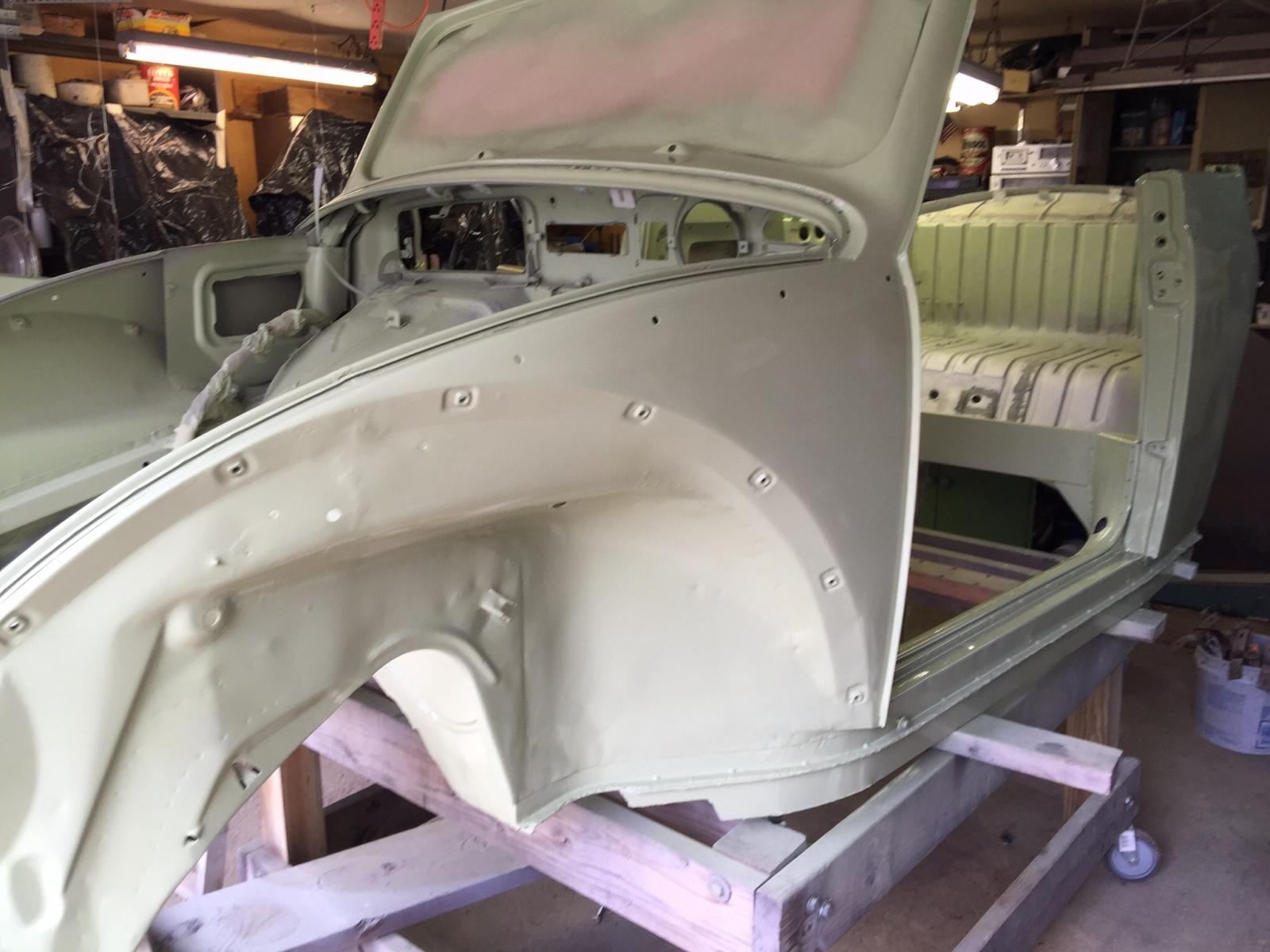

PostPosted: Tue Sep 22, 2015 1:50 pm    Post subject: Reply with quote
Support rails are in. Finally got the body work done. 63 beryl green convertible finally in a coat of paint.
