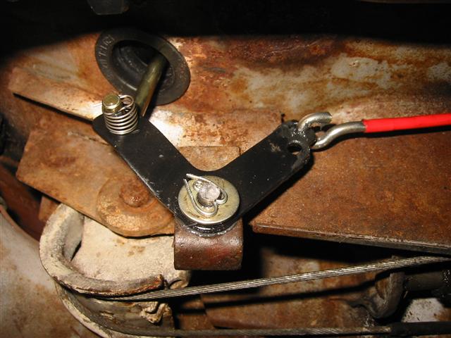

burwin wrote:
you should mount the L piece that the rod from gas pedal goes to,outside of the J piece welded to frame,instead of in middle. it will function better and no binding.

Bendango
Joined: September 04, 2005
Posts: 603
Bendango is offline
PostPosted: Sat Jul 09, 2011 2:32 am    Post subject: Reply with quote
Yeah this leaver does'nt really seem up to the job. I was thinking about keeping it inside the "j" but spacing it out with washers?
If I put it outside do you mean held in place just by the split pin or make up a new axle/stopper combination?

PostPosted: Sat Jul 09, 2011 11:29 am    Post subject: Reply with quote
From the gallery:

Bendango
Posts: 603
Bendango is offline
PostPosted: Sat Jul 09, 2011 3:52 pm    Post subject: Reply with quote
ok but that little acc-spring no one seems to have it

PostPosted: Sat Jul 09, 2011 3:56 pm    Post subject: Reply with quote
It comes in the accelerator pedal rebuild kit, or you can pick a spring up from the hardware store and make it work.

bill may is offline
PostPosted: Sun Jul 10, 2011 7:32 am    Post subject: Reply with quote
is it even important?
used on flap setup that are in fan housing or wolfsburg west sells them.the pedal repair kit from WW has new L piece,springs,the rod from L to pedal,pin,washer and the springs. about $10...... some vw parts carry the kit also and by putting new kit in you get more pedal travel due to pivet point slight change in linkage.
