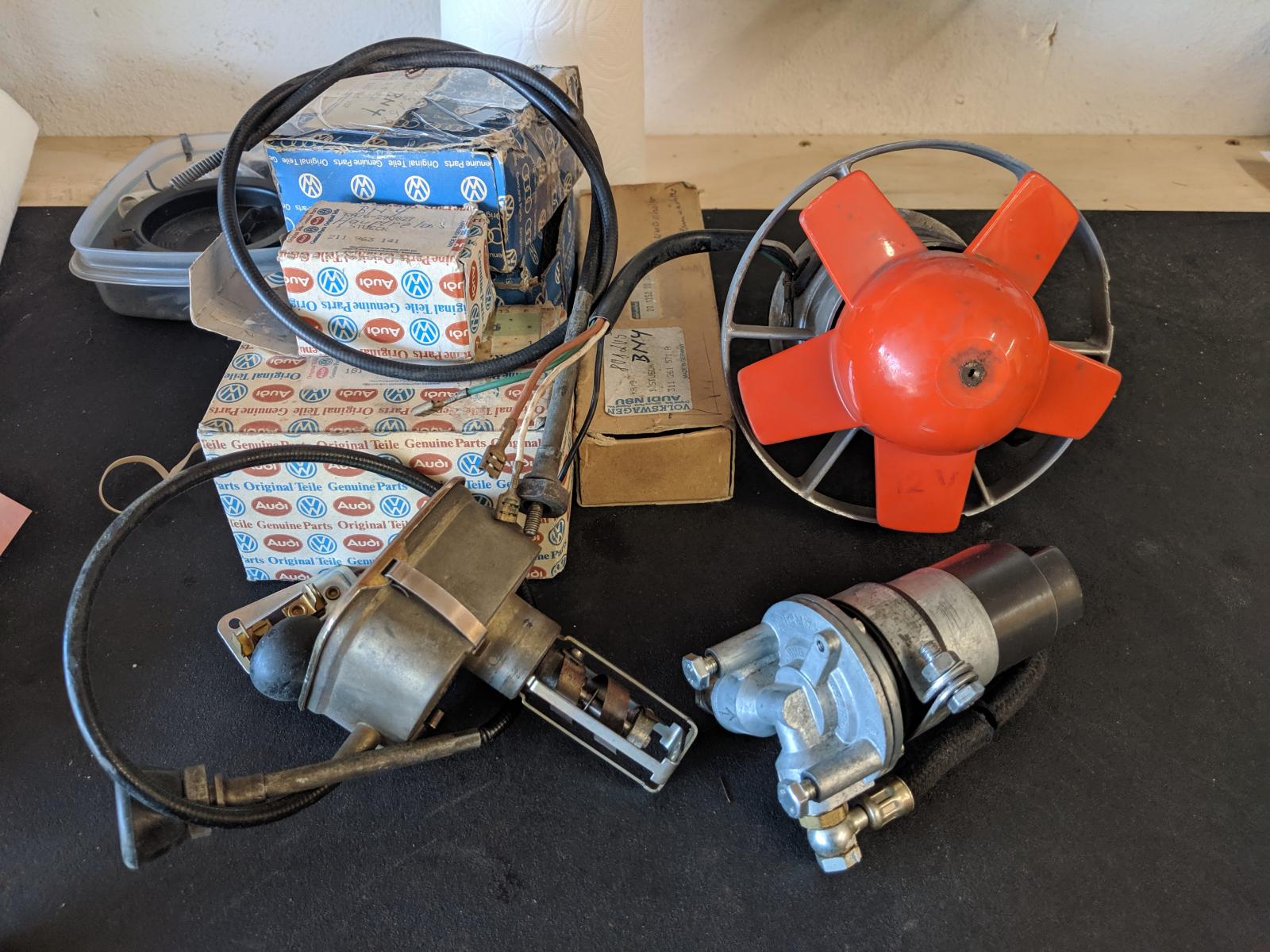

Picked up some Eberspacher goodies. Ill be selling the Thing thermostats with cables for $180 ea if anyone is interested.

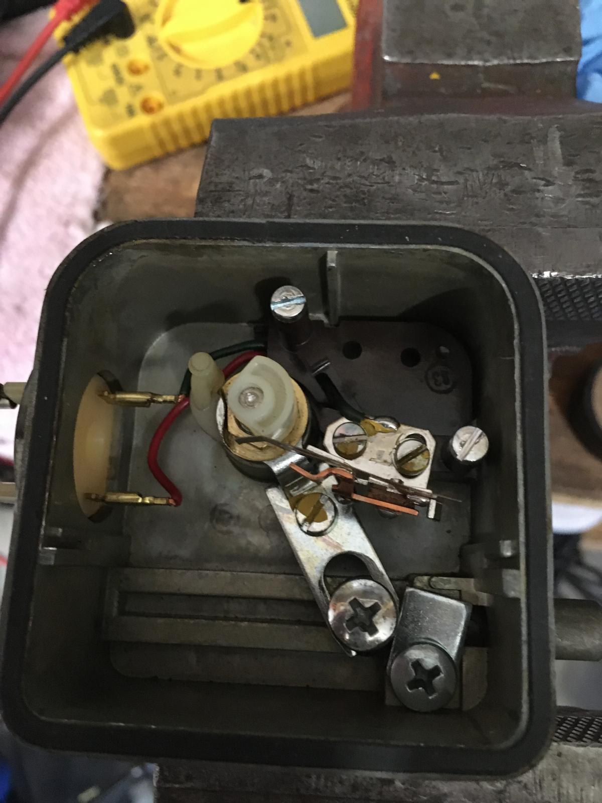

Can someone direct me to information on setting up the Temperature Regulating Switch. I think I have read all the FAQs and I'm on my way to memorizing the manual. I have mine freed up and I see how it works. I'm just not sure how to properly set the switch. I guess I'm not really sure how the "switch" rides on the cam to regulate temperature.
Thanks,
Frustrated in South Carolina!
72 forever project Bug
03 Boxster S
18 Tiguan SE
73 Thing
81 Caddy w/2.0 liter ABA
Every VW has some Porsche DNA and every Porsche has some VW DNA. Sorry boys, they started as hopped up V-Dubs.
notchboy
Joined: April 27, 2002
Posts: 22688
Location: Escondido CA
notchboy is offline
PostPosted: Wed Oct 07, 2020 7:37 am    Post subject: Re: Heating FAQs - BN4 Gas heaters & heating related topics Reply with quote
Thanks,
The metal spring/band around the probe that sits inside the outlet air side gets expanded and contracted manually when you push and pull the TEMP knob inside the cabin. Heat causes the spring/band to expand and contract while the unit is on. The pull knob cable either increases or decreases the springs ability to expand and contract while the unit is on.
It doesn't change the heat cycle output much. Its a relatively short window difference from knob all in or pulled all out.
In this vid - I only show the output right before the spring gets hot enough to shut off the fuel pump. It then lets the fire die, cooling down the spring, then clicking the pump back on, igniting the fire, heat comes out, cycle repeated.

Thanks Notchboy. Great Vid. Now I have a very specific question. I have the square temperature regulator. How do I set the points so the heater will cycle? I have never seen a "good" regulator so I do not know where the plastic cam should be in relation to the "points".
I have freed everything up so it moved free. I can set it so power goes off as the spring contracts (heat gun). It moves freely into the "get hot now" position from the cooldown position. I can't figure out how the points ride on the cam to regulate temperature.
Frustrated in South Carolina. It's not cold here yet but it's coming.

Notchboy, I finally watched a You Tube Video you posted on this thread that shows the inside of the Temperature Regulating Switch. SCORE!!!! The cam inside my box lines up with the cam in the new unit installed in the video.
Now I just need to learn how to set the temperature limit.
Not so frustrated in South Carolina!
