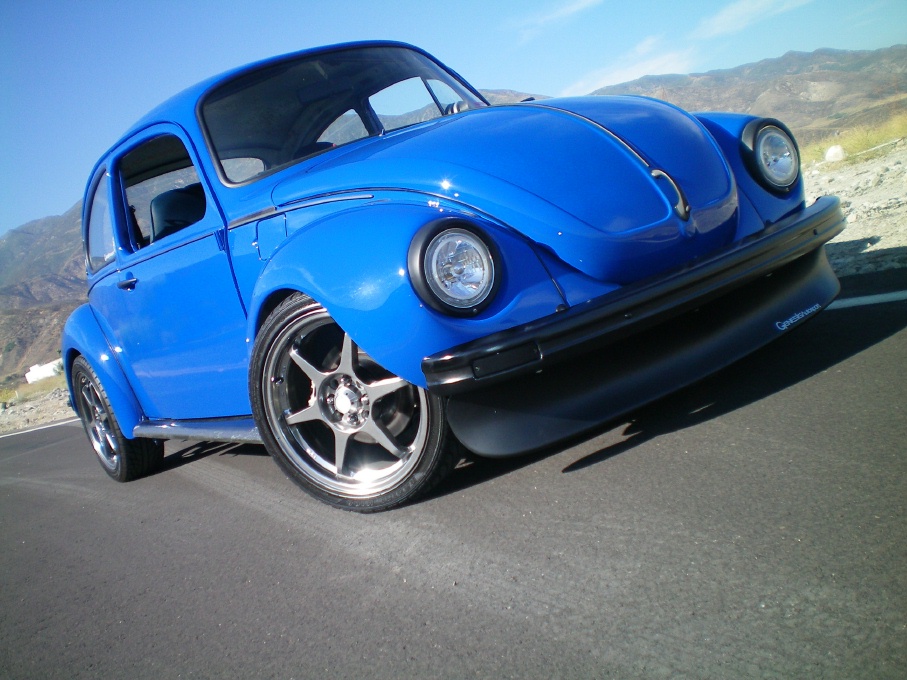

My son (this is his car) wants to go deep metallic blue. Something like this:
1975 LaGrande Super Beetle Build Log / Farm boy hinge pin puller / Farm Boy Chassis Rotisserie

Excellent colour choice.
It really suits curved windscreen Supers
Quick little bug, you got a Porsche motor in that?

Cool pictures Smile Do you have any information on what the vents on the first bug are used for?
Yep, its the mythical Porsche powered bug everyone talks about at bars.
Seriously though...
it's got a 911 flat 6 shoe horned into the back.

I like the blue, but I think the orginal green is awsome. The paint on the inside of the trunk looks really good, I'd love a close up of the orginal paint, if you have the time. I'm not a purest buy any means, but the orginal paint would be really retro cool IMHO. If the car was orginally white, I'd say paint it blue. But I'm really diggin' the green, just my .02 cents. Great build BTW.
