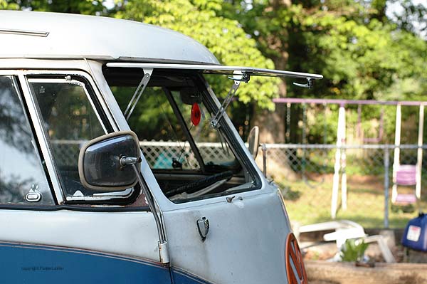

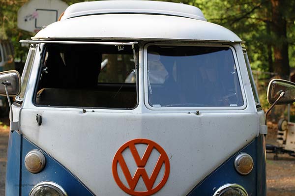

I purchased the white powdercoated set. My initial review was quite favorable. A very well made part, that seemed to have no apparent manufacturing defects with very good craftsmanship. I was very happy with my purchase at this time.

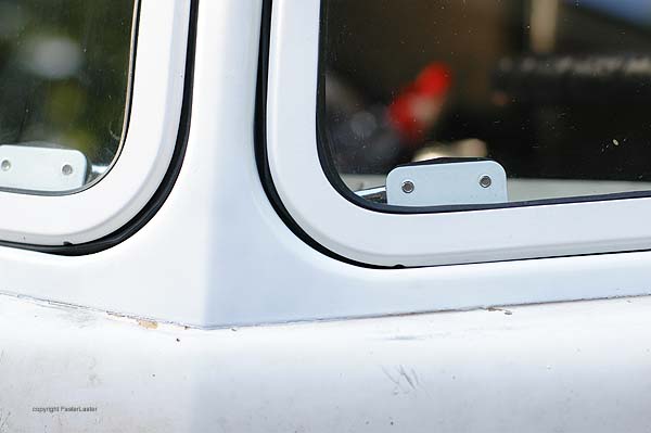

The install was quite easy. There are two ways to install the windows to the upper window eve. One is to screw it directly w/ the included screws. The other is to use a safari window plate to give a stronger mount. I chose to use screws. The install instructions did not have the correct drill size listed, but fortunately I first did a visual w/ the recomended drill size and went down quite a few sizes. The strange thing is the drill size recommended in the instructions was 6/32". Not only is this too big, but my math teacher from middle school would have a heart attack for not reducing the fraction to 3/16" Wink I believe I used a 9/64" bit for a good size. Other than this the rest of the instructions were easy to follow and the parts all seemed to fit.

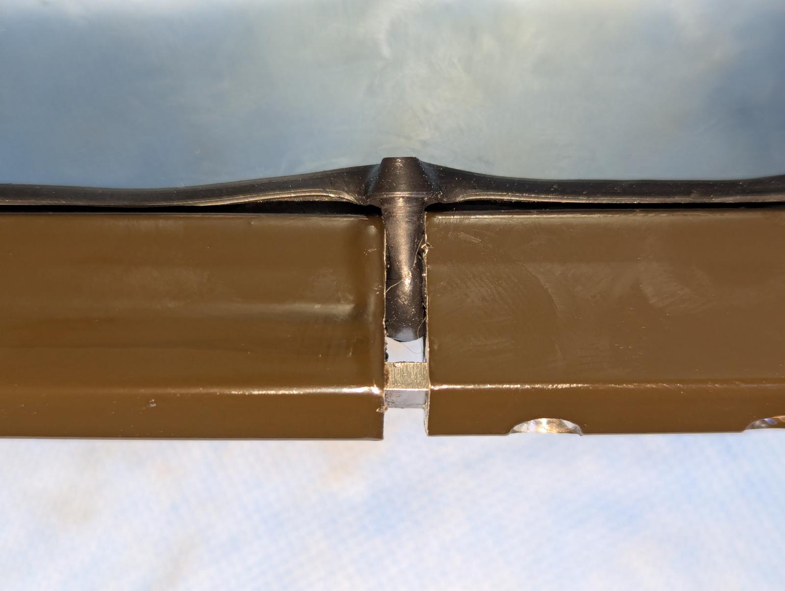

After I got the window centered in the hole it was time to fit the rubber seal. The seal seemed to fit ok, but around both bottom corners it didn't want to completely seal to the body on the outer lip. I was unable to really get it to seat to my satisfaction, but went ahead. It does however seem to seal very well to the window. The rest of the install with without any problems untill I finally got what I wanted. A rockin' set of safaris.
So that's the good stuff. Below I'll try and include any issues with the kit and pictures. One thing that is just not correct is the angle of the bends. They are very close, but not 100% you can see the taper in this
and this (although it's a bit hard to make out)
Also here is a shot which shows the bottom of the window quite close to the body, but the edge next to the body window pilar to be much farther. Looking closer you can also make out the inconsistent seal to body lip on the pass window.

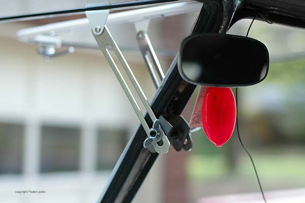

The support and locking hardware seems to function quite well. I was a bit worried when I iniatially locked them down the first time. It really felt like they were way to tight, but nothing broke. The next morning it was much easier as the rubber started to break in. Other than the installers lack of welding skill the locks and supports work and look good.
When I first got the supports installed, I noticed that the arms wanted to rub against the rubber seal and try and pull it off it's track. This was not a good thing. Looking at the tabs on the windows it sure looks like they were not assembled w/ a jig. All were a bit off, and different amounts. The good thing is that after the hardware is attached and some tension put on the wing nuts the windows open easily and do not grab the seal, so that issue became a non issue.
It hasn't rained here since installing them, so I cannot comment on how much they leak. I will report later after a bit of precipitation falls.
The first test drive was nearly orgasmic! I can't believe I have waited this long to purchase a set of safari windows. What a fantastic way to add something to a vehicle I drive everyday. I love how it looks and the way adjusting the windows will adjust from a plesant breeze to galeforce head winds (and bugs). They performed very well at many different angles up to 65mph. Quite solid, with very little vibration and only at certain speeds. There is also no noise from them like whistling or that sort, so hopefully my future report will state it doesn't leak much.
Here it is from the front winking at me Wink
So, what was the final judgement. I would say this is a very complete kit that could only use a bit of tweeking in the initial jig setup during manufacturing to be a world class kit. I will also say that It's possible my window holes are not 100% stock shape. Anything could have happened over the course of nearly 40 years. It's possible that these windows fit perfect in a straight bus. I can only comment on what I have seen. I would not hesitate to purchase these again. I would like to thank Evilbus for giving me a thumbs up on the quality of the product, so that I went ahead and took a chance w/ Izzy. Hope you enjoyed it.

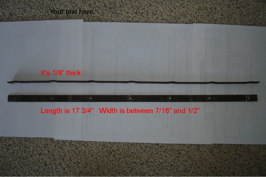

Nut plate information:
abuspilot wrote:
Here's a pic of the og mounting plates.
Thread:
Safaris - installing a threaded plate?

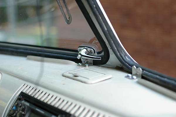

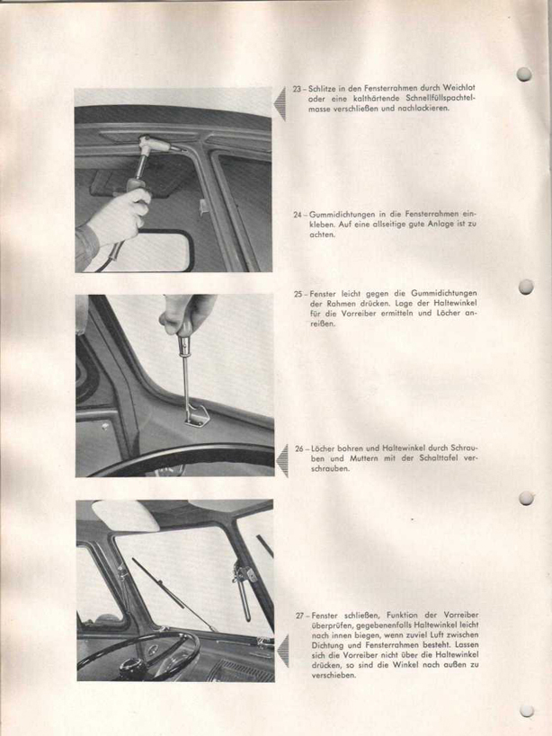

Isn't that latch on backwards?
HamburgerBrad wrote:
Bongo
Joined: December 03, 2004
Posts: 872
Location: Egå, Denmark
Bongo is offline
PostPosted: Tue May 10, 2005 9:00 am    Post subject: Reply with quote
I thought so too Crofty, but was too chicken to say as I don't really know for certain! Embarassed
1964 Standard
1962 Single Cab
2002 Golf St.Car
faster-laster
Joined: February 09, 2004
Posts: 288
Location: Cedar Park, TX
faster-laster is offline
PostPosted: Tue May 10, 2005 9:55 am    Post subject: Reply with quote
not compared to the safari instructions. take a look at step 27. it's the only picture that shows them installed, with both handles pointing out instead of in.
seems a bit funny, but that's how the picture shows it installed.
62 Mouse Grey Deluxe
66 Westfalia SO-42 "Tigerbus"
mynameismud
Joined: October 23, 2002
Posts: 5937
Location: Middle of a corn field
mynameismud is offline
PostPosted: Tue May 10, 2005 10:02 am    Post subject: Reply with quote
hard to see, but they point inwards #27..

faster-laster
Posts: 288
PostPosted: Tue May 10, 2005 10:40 am    Post subject: Reply with quote
I should clarify. They point outwards in respect to the individual window it latches. That is the outside latches of both windows point towards the doors on the same side, but the inboard ones point towards each other.

Mr. Twisted
Joined: January 31, 2003
Posts: 205
Location: Tennessee
Mr. Twisted is offline
PostPosted: Tue May 10, 2005 7:26 pm    Post subject: Reply with quote
Ya know, I was gunna say something about those latches too. But step 27 don't lie! I'll be.... I just went and looked up the directions that came with my CE's, and they have them pointing toward each other, not away, as shown in the org. installation guide. I sure thought you had 'em in wrong. Guess I do. So is there a right and wrong way, any purists out there ever see what an original install looks like? Or did it just depend what day it was on the assembly line?
